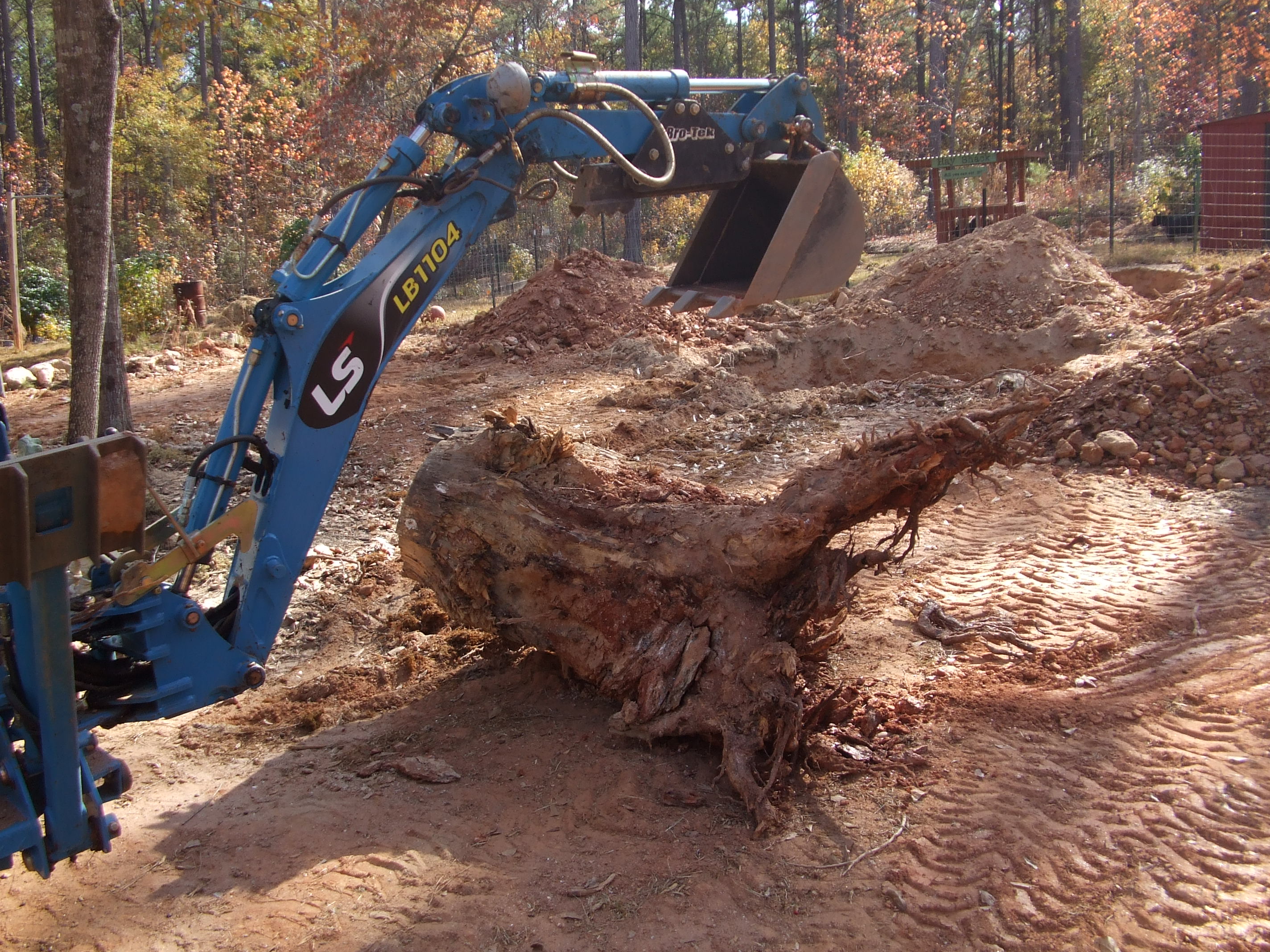

I got a total of six stumps out over the Thanksgiving holiday weekend. Here is a pic of the last one, #45.
It was some type of hardwood, possibly an oak and a real PITA to get out. Took about 10 hours total and I had to chainsaw through several roots to finally get it free. Stumps like this make you wish for a bigger tractor.

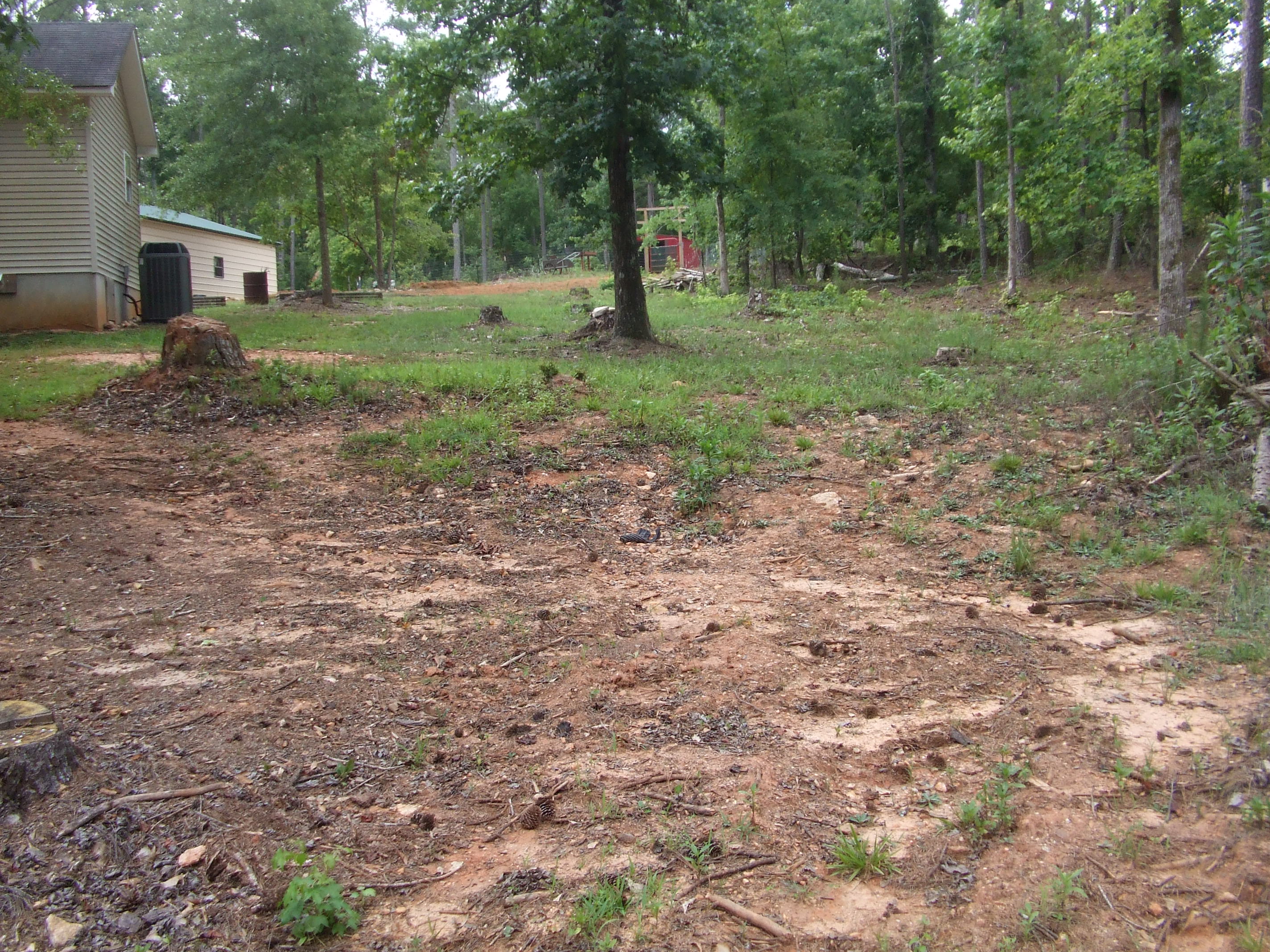

I'm a couple of weeks late posting the before and after pic's of our property. I'll post the Before pic's in one post and the After pic's in another post.
Before July 2016

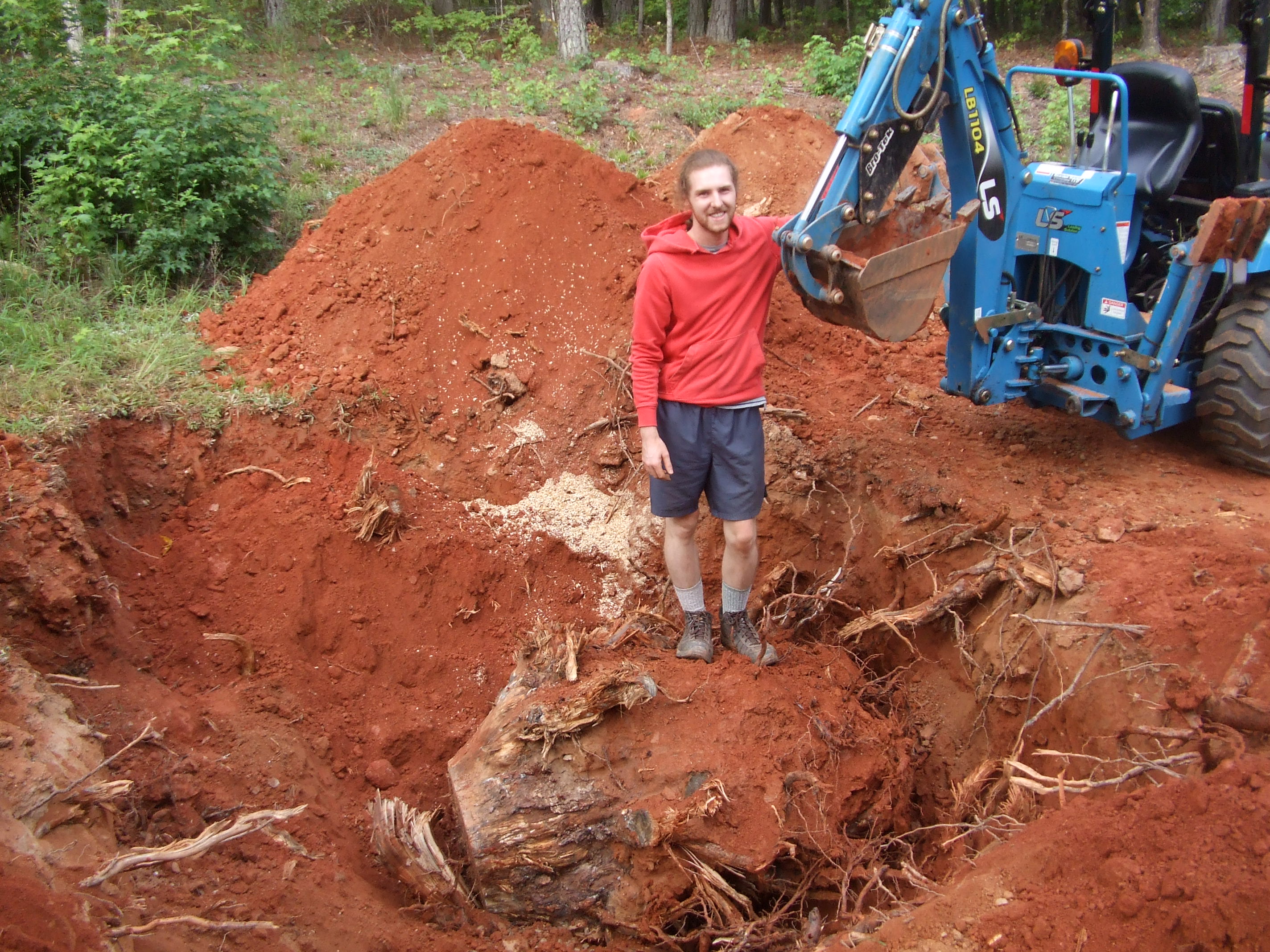

Holly smokes ... you've been working that baby! Looks good! Pretty impressive!
So how long did it take to dig out that big stump in your first post? I've not attempted to dig one out that big before.

Thanks Hutchman
My first large stump took me about 20 hours, including filling the hole back in. But I was just learning to use the backhoe and tractor.
After all the practice I've had, I can now dig out one that size in about 8-10 hours, including filling in the hole.
It looks like you have the R3039, which is quite a bit bigger than my XJ2025. I would think it would take you about half the time it takes me to dig one out that size.

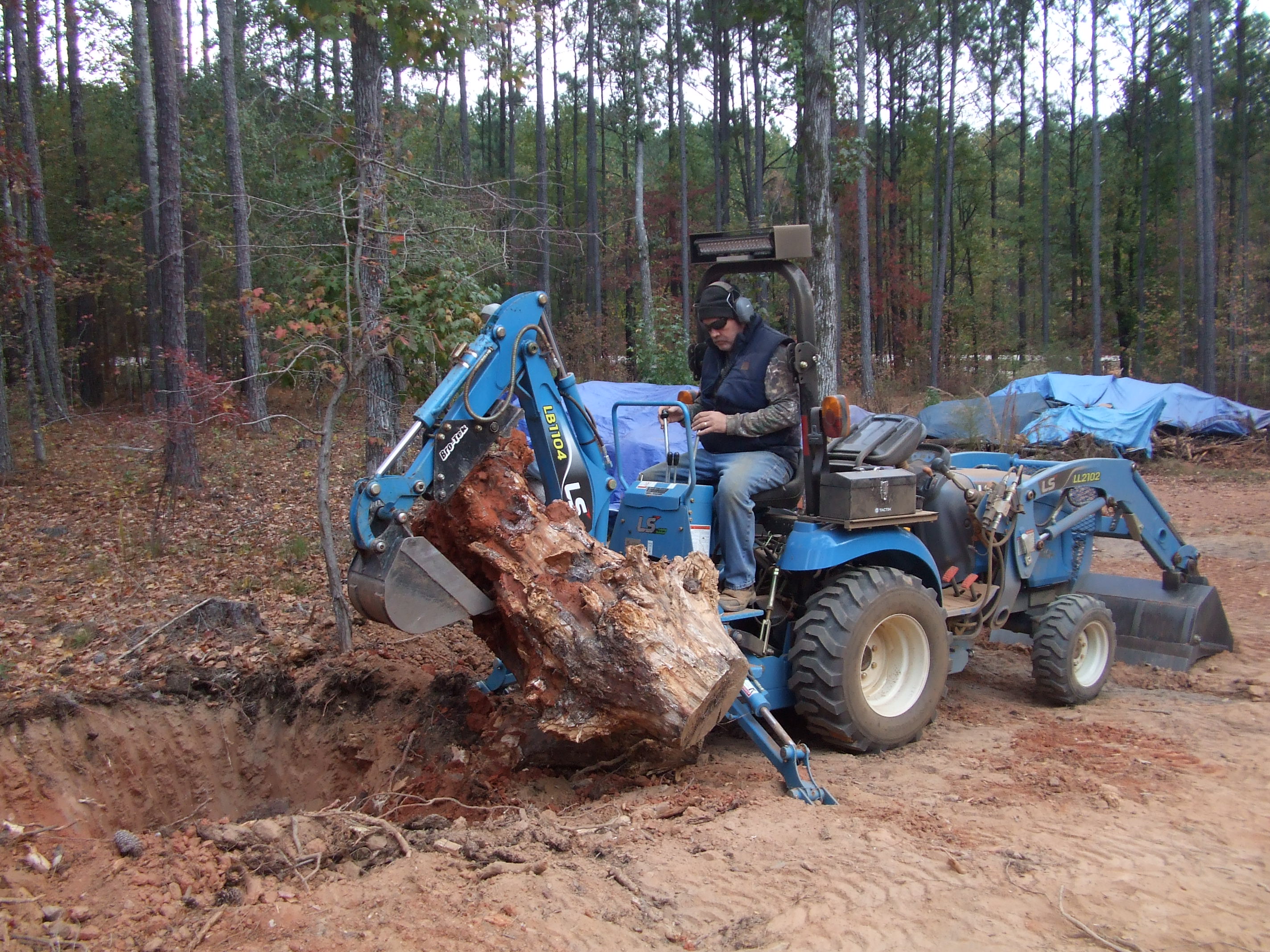

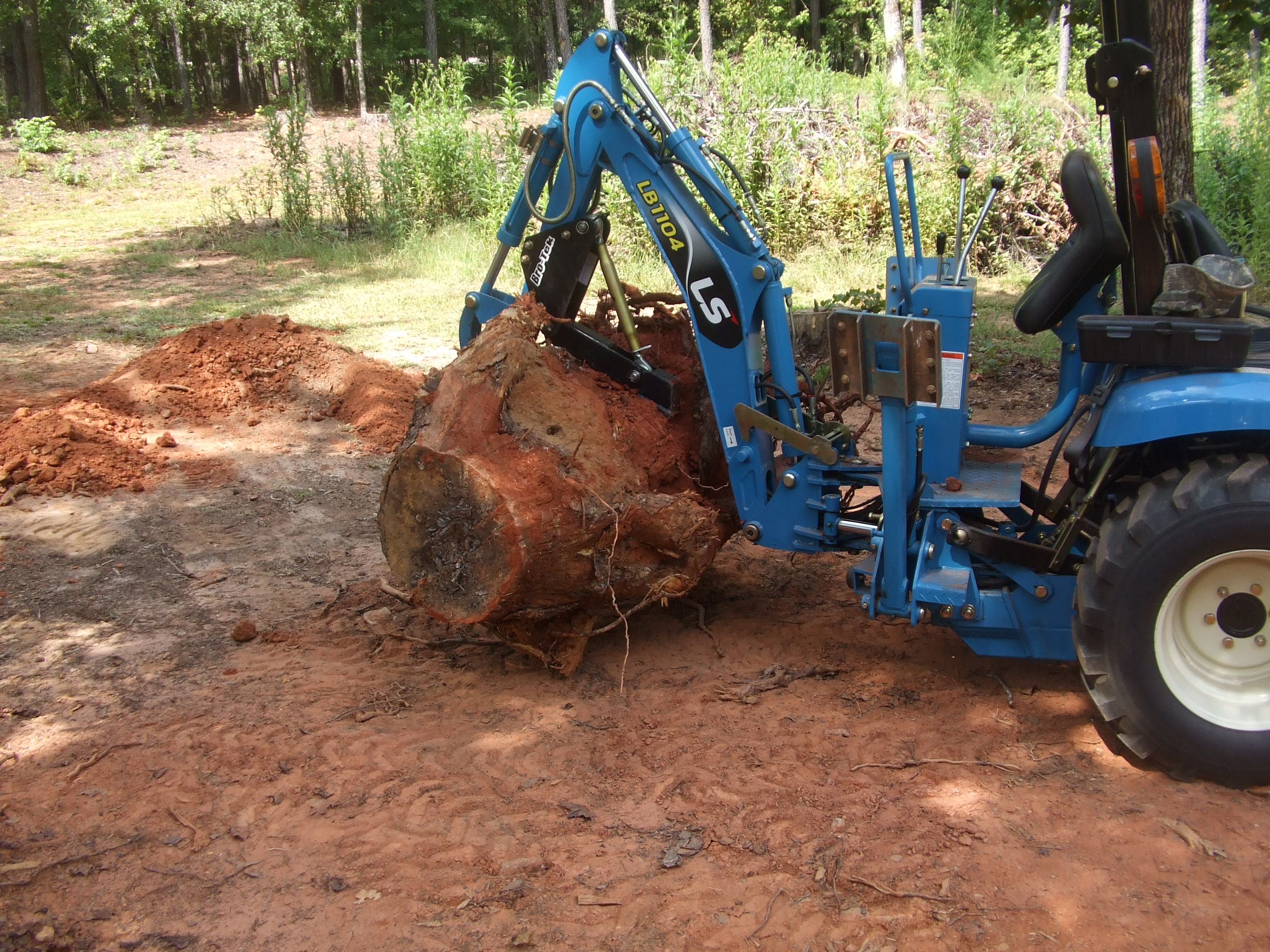

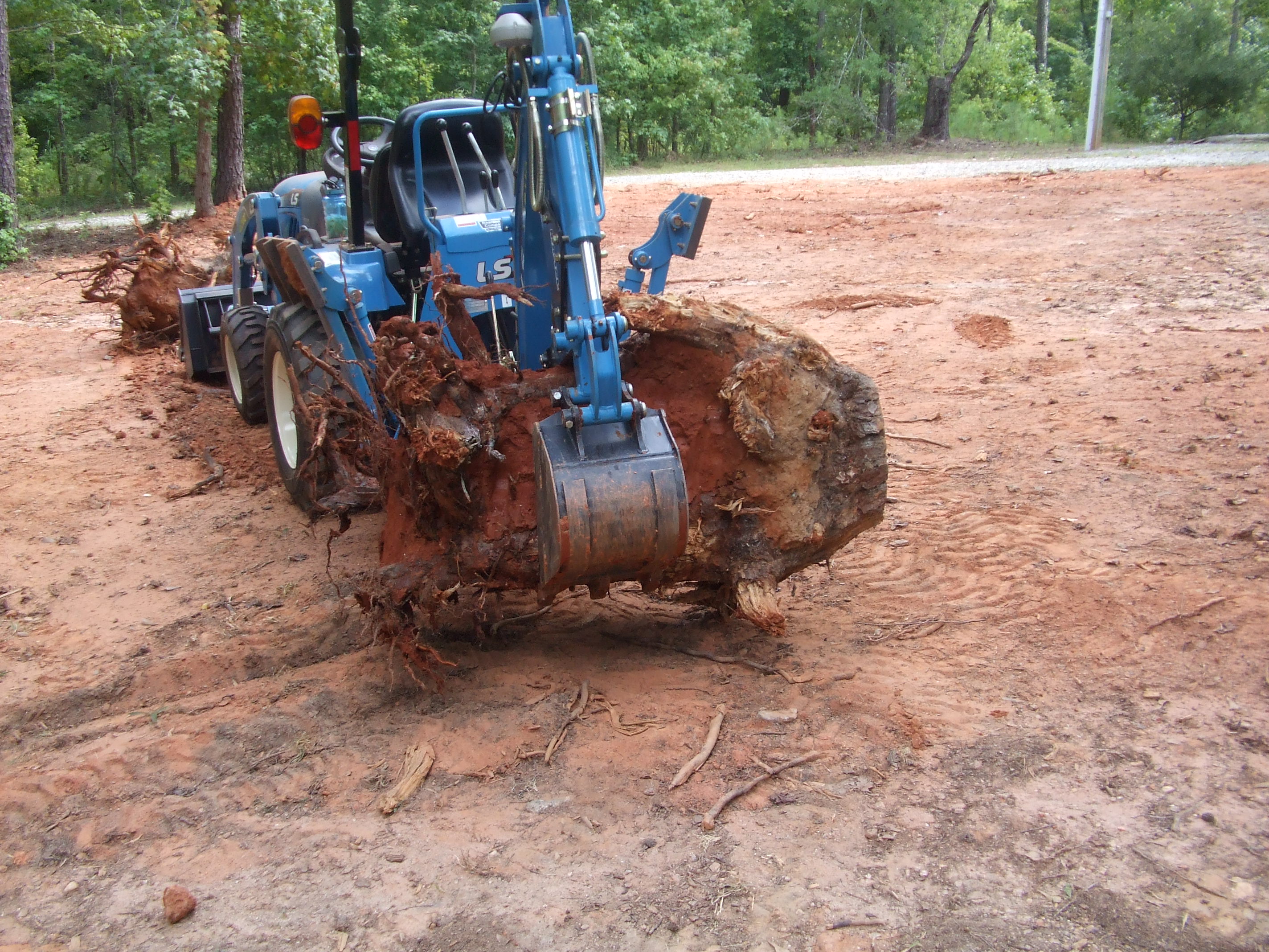

I don't have any pecans trees that I'm removing. Most of the stumps I am removing are pine, thank goodness. There are several hardwood stumps that I have to remove scattered about and these are the worst.
I have had several stumps that were to heavy to lift out of the hole with the BH, once I got them broke free. On those stumps I push the stump around to a corner of the hole to get it out of the way and then dig the hole deeper until I've got the hole deep enough that I can move the stump to the deep part of the hole and bury it. Sometimes I have to re-position the stump several times in hole to get it out of my way while digging the hole deeper
I have had to roll/push several of them fortunately none of them have gotten away from me yet.
