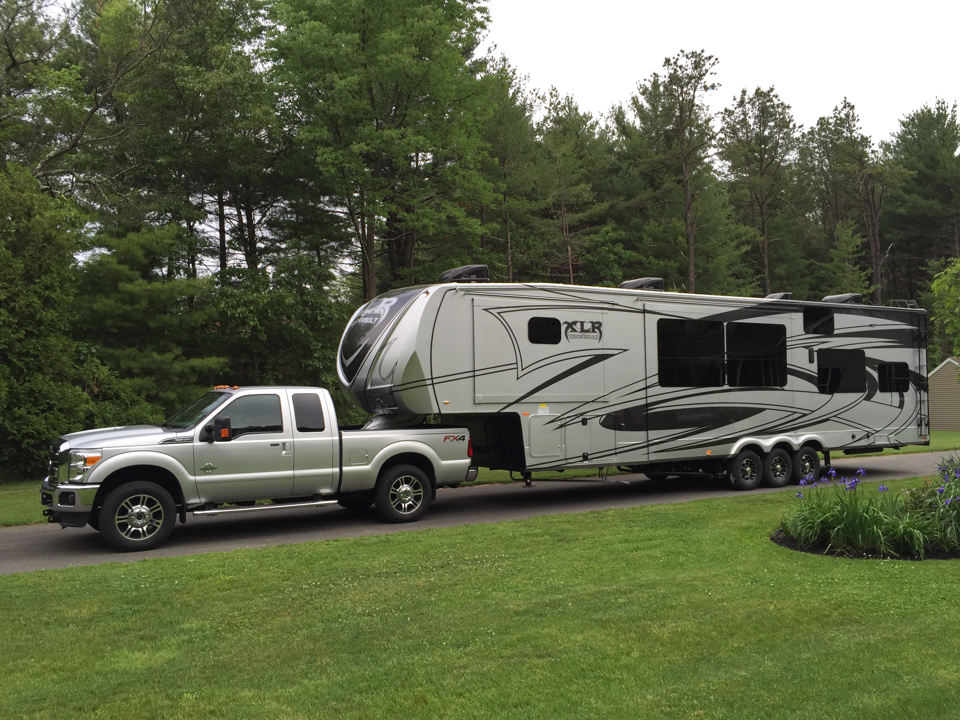

Small world indeed! It a good package all around...
Here's my current setup:

What does a trailer like that weigh ? I had briefly thought about getting one, but my tow rig would be a 2015 F350 crew 4x4 gasser. It does fine pulling a 7-8k pound load with minimal hills, ..never towed anything with it in the mountains.

On the trailer, it's a toyhauler and can vary a lot in weight depending on whether there is anything in the garage or not. I've scaled it at 17k+ with the garage empty and close to 20k with the water tanks full and the garage loaded... Definitely diesel territory.

On the F450, they make a nice towing rig. I have two F550 4x4 with the 4.88 ratio and tow my equipment in the mountains without problems.
