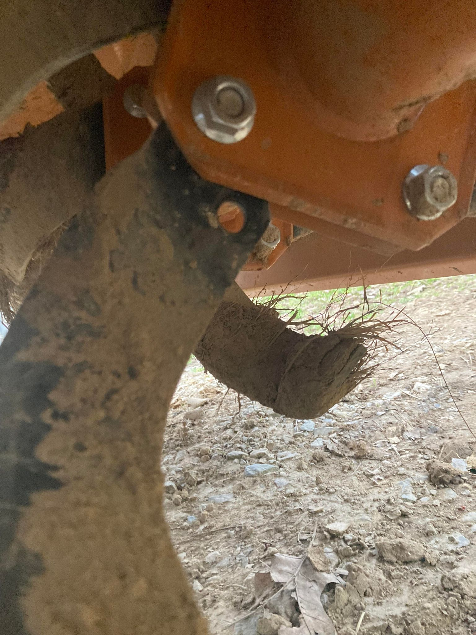

fwiw, the woods single bolt uses a grade 8 bolt there. when set properly it rides against a protrusion on plates. yes it will loosen, the loosen warns you by the noise. slip clutch plate on pto (if set right) will slip before any breakage.
is it a HD commercial unit? no prob not.
but anything expensive that can break is in gearbox and 5 yr warranty. all other stuff 1 year.
bolts are cheap, tines can be fixed if needed.
I actually do hours of tilling each week in, as stated, rocky soil.
my average rock is softball size or larger at approx 4" depth and are many of them. I do normal vegatable gardens (mine is 40x75ft), strawberry, cultivated blueberry, blackberry (those suck due to roots) plots. I've had no issues.
buy the item that works on your tractor for the needs you have and drive on.

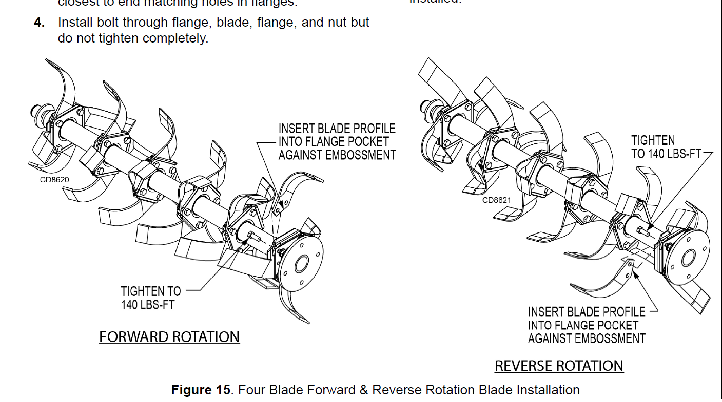

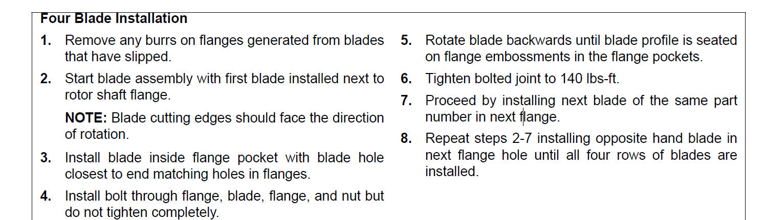

This system relies on a double flange so the blade is not mounted cantilevered on one flange. It reduces stress on the bolt. The blade also sets against the rotor tube. This system is more durable that the 2 bolt mounting system on the past two tillers I used prior to buying a Woods RT model. I believe they mentioned this was patented for this reason. It has been working good in hard conditions for 5 years.
/ New Woods tiller problem..... #49
woods manuals for RT/RTR 42.30 to 72.40 specifically state tine should NOT be resting against tube.
smack that tube hard at bad time and things get expensive.
Rotate blade backwards until blade profile is seated
on flange embossments in the flange pockets.
the embossments are not next to tube.

Thanks for commenting. I'll tighten those up today.....but I'm with sawyer rob ...I feel like running away from this one. I'm going to feel uneasy every time i use the unit. If they loosened that soon after use being brand new seems like it will happen all the time. Not sure if I want to keep it or not.
