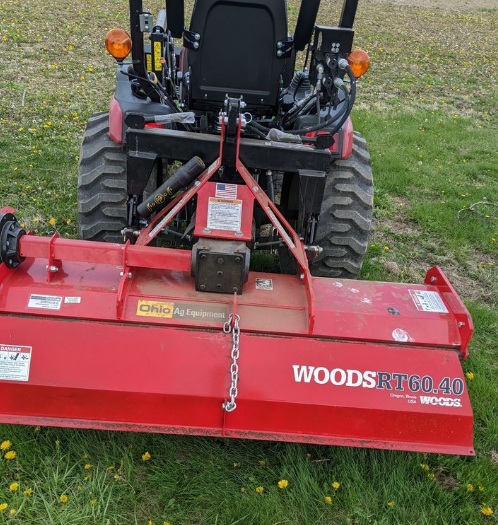

I'm going to break down this year and buy a tiller.
I'm looking at Woods because it is who makes my blower and what my dealer carries.
Question is, will the GC handle a 60 inch tiller or do I need to go with a 48?
Manufacturer says I should use the 48.
With the spacers on my rear wheels a 48 inch tiller will not completely cover the wheels (~50.5")
I'm assuming that I can use 60 inch - PTO HP is listed as 18-40 RT60.40 – Woods Equipment
PTO HP listed on the 48 is 15-35 RT48.30 – Woods Equipment
GC1725M PTO HP is claimed to be 24.5 so it should be able to run either.
Just want to see if anyone thinks I'm missing something here?
Do you think the 48 will work or should I go with the 60?

woods 48.30 here with the right side offset, I run 2" spacers on rear and tiller covers the tracks fine.

Thank you, that's what I was looking for. I will go with probably the 48" tiller and save some money. I was just worried about coverage and was hoping that someone else had what I was looking at for their GC. I have 2" spacers so if it's working for you then it will work for me.

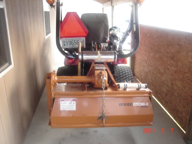

I've got a Woods GTC40-2. It covers the tire tracks well, but I don't have spacers....

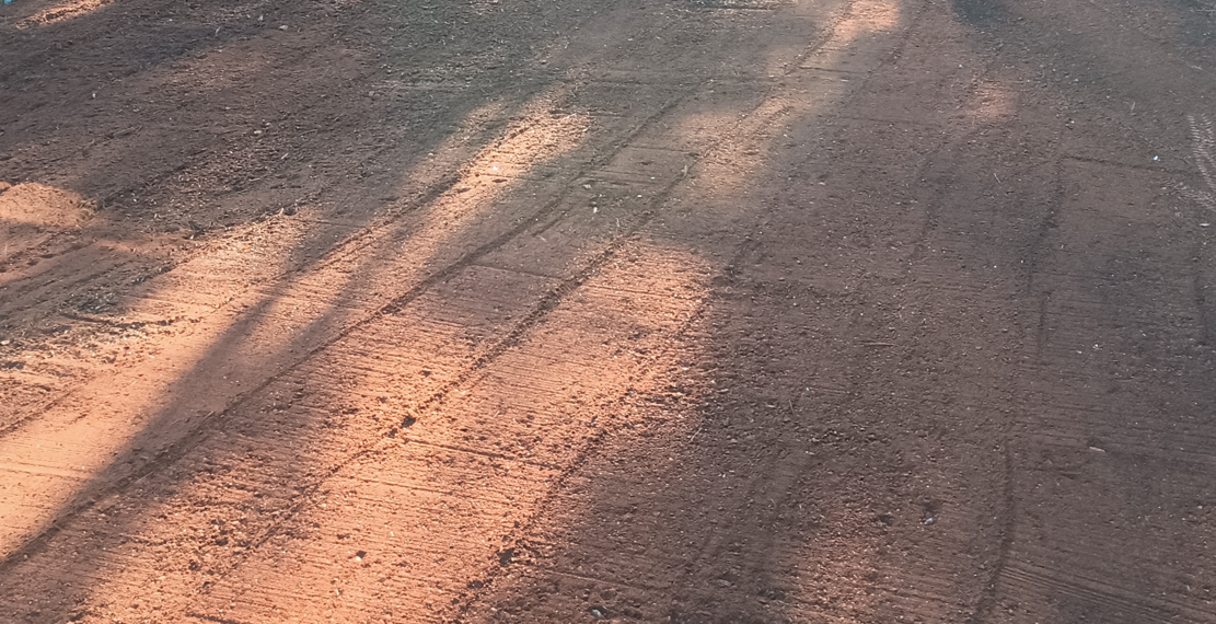

I run a 60" Woods on my 25hp Yanmar SA425, no issues yet. I personally feel the Woods is one of the best out there (Get your wallet out, they like their stuff) but there are other good ones. I think it may depend on soil type and if you are willing to slow down you will be fine. But honestly didn't feel I had to go that slow when tilling with it.
Can't speak for the Massey but I would expect it might be similar. Land Pride makes a real nice tiller that is 50". The bottom pic was from one of those and my little Case IH (sold them both).

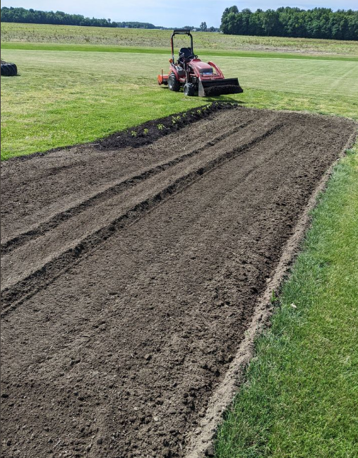

I have the Woods RT48.30 on my GC2610. The tiller has an offset and recommends tilling in a clockwise direction.
Here's how it did last fall after I purchased it used. Because the ground was heavily packed from using a skid loader, I did a couple of passes - one with shallow depth then increased the depth for the next pass. Went slow to allow the tiller to really break up the soil.
