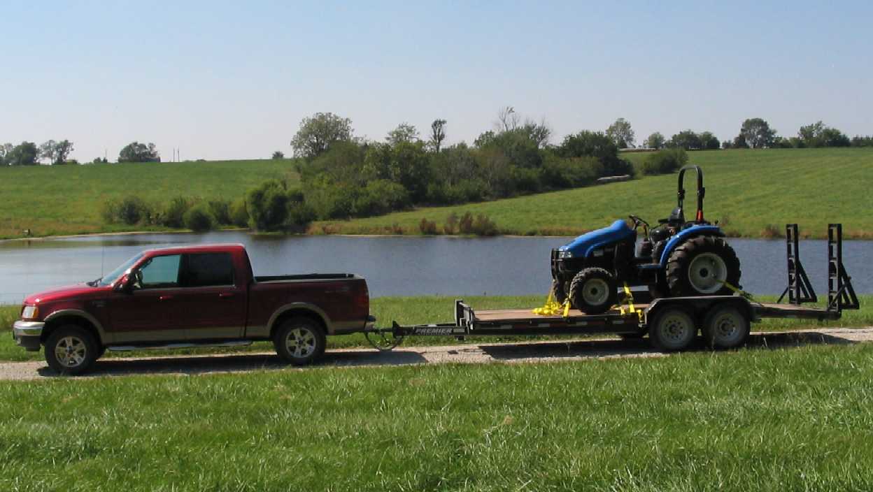

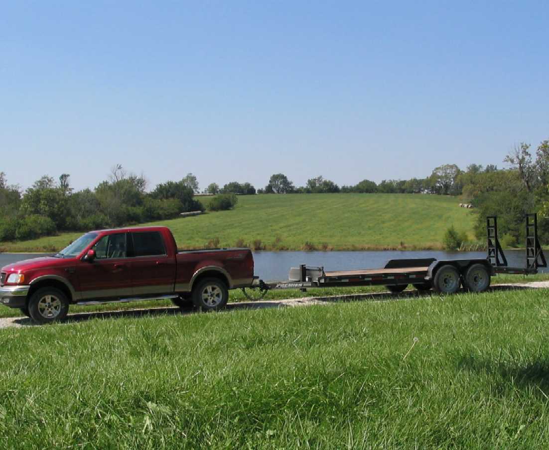

</font><font color="blue" class="small">( Hi All,
Initially, I was just looking for a 10K trailer but all they had were 16/18 ft ones. It was just a few hundred more for a 20 ft/14K trailer with dovetail and adjustable, spring assisted ramps.
So, today I picked up the trailer attached. It is rated for 14K and has brakes on both axles.
Thanks, )</font>
Great looking trailer. I'd like an open trailer instead of the enclosed one I have. But, I need the enclosed trailer for cars, so I make do by folding the ROPS when transporting the tractor.
Caution: If I interpret your 14K correctly, you've got a 14,000 lbs GVW trailer. Different juristictions handle enforcing laws differently, but you've got a rig that requires a Commercial Drivers license. It doesn't matter what the weight on it is, what matters is the rating.
Check with a friendly peace officer. If you get stopped, do they check the truck capability also? If they do, they might make you disconnect and leave the trailer where you were pulled over. Well, you wanted a new truck anyway. Maybe sooner rather than later.
This thread covers Goose Neck trailer pulling the topic. Look for "DavesTractor's" posts. He got a citation for doing exactly what you are doing. Some of the others point out you can take your test in the rig you own.
I've got a covered car trailer that weighs 3,500 lbs and tow it with a new 4x4 F250 diesel. You can tell the trailer is back there, the trailer body drag is noticeable. You'll be happy with the newer truck, except for the mileage. The worst I've gotten with the diesel is 14 mpg towing the trailer on a round trip from Sacramento to Los Angeles. Empty on combined local use and modest distance trips is 18 MPG.
