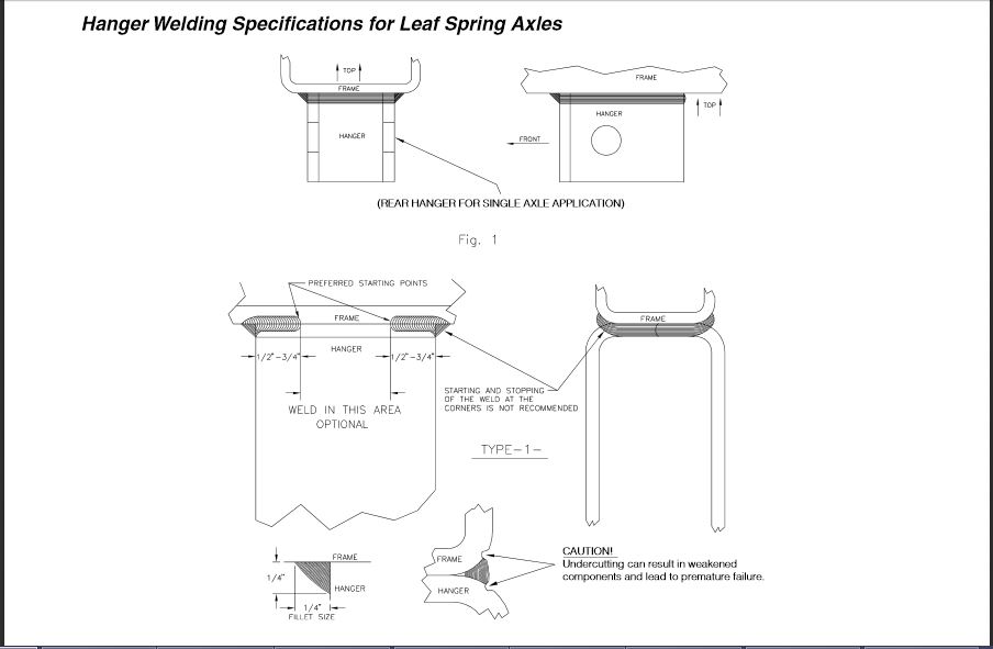

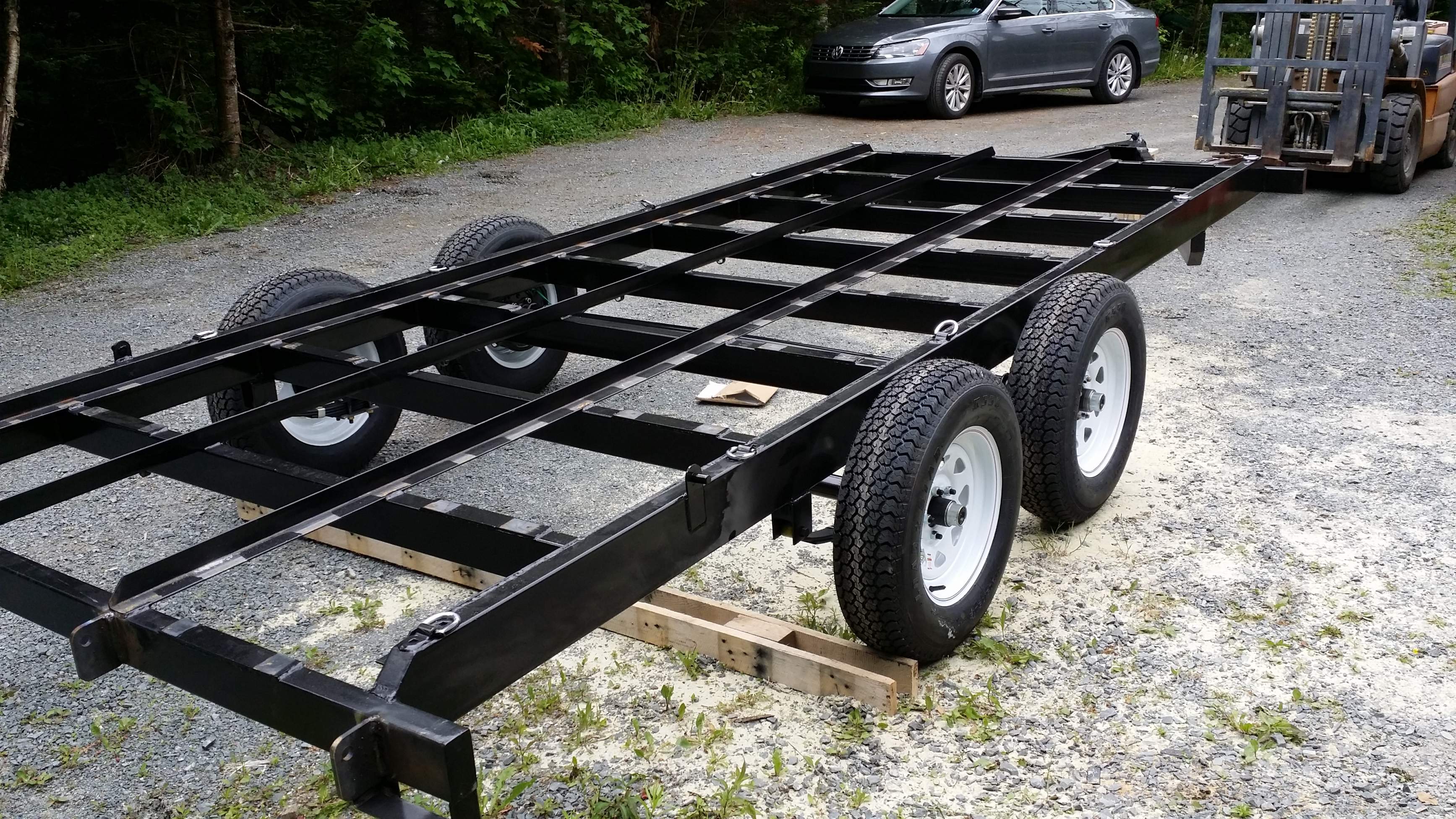

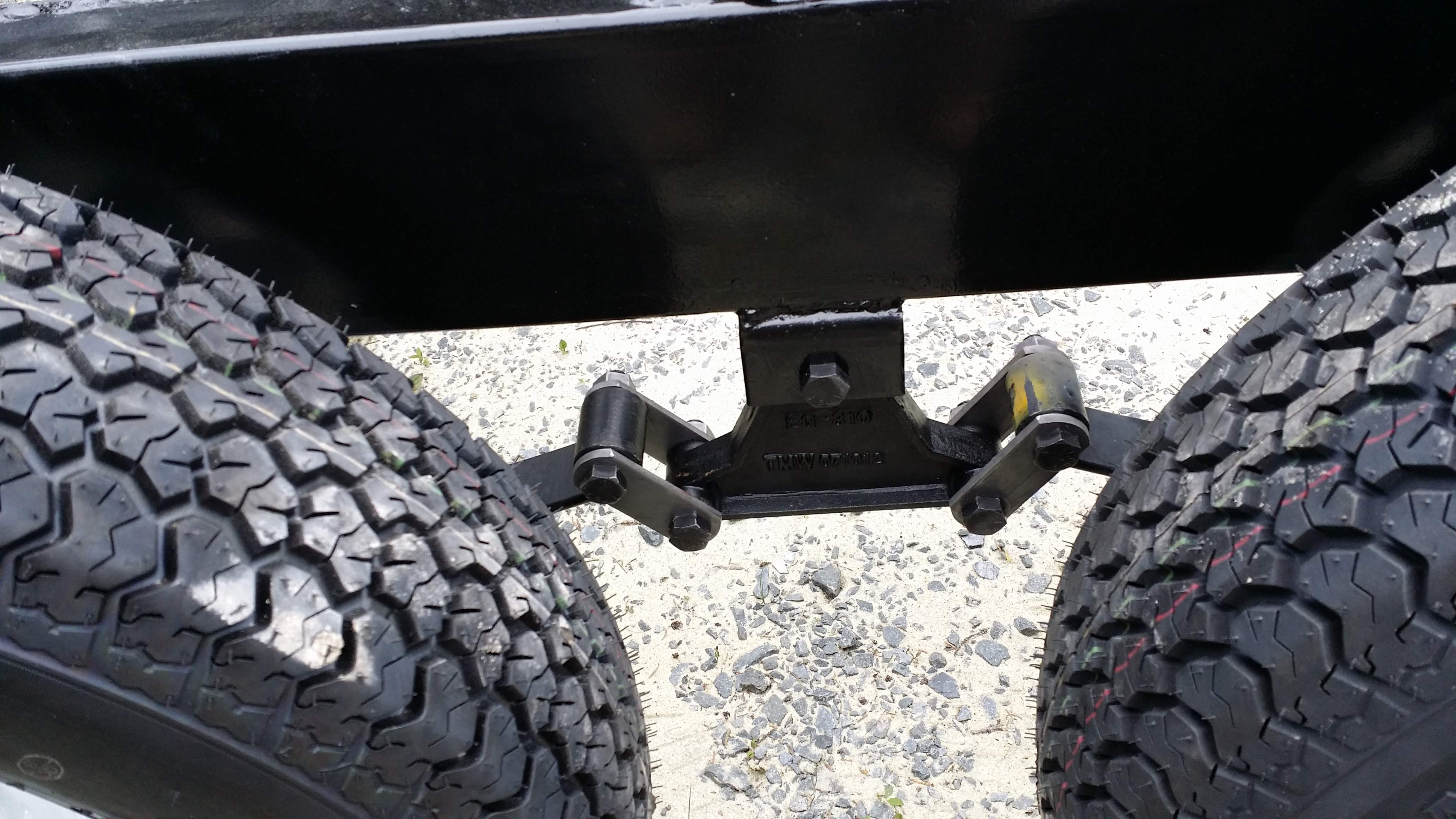

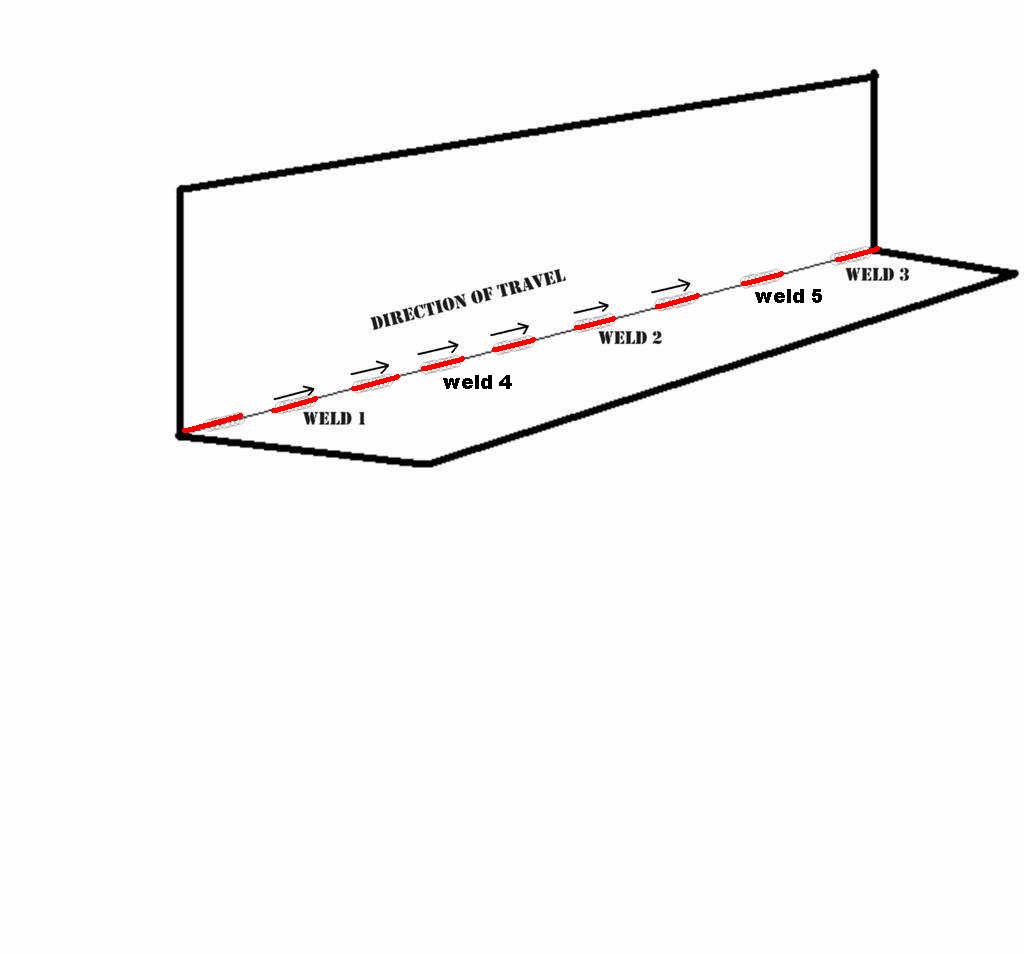

It's amazing how much draw you can get from mounting three spring hangers.
Square tubing and pipe are very reactive to heat.
In the 1970s I built 200 of these bus shelters. The legs had to be with in 1/8-inch. A lot of heat shrinking to keep them with in tolerance

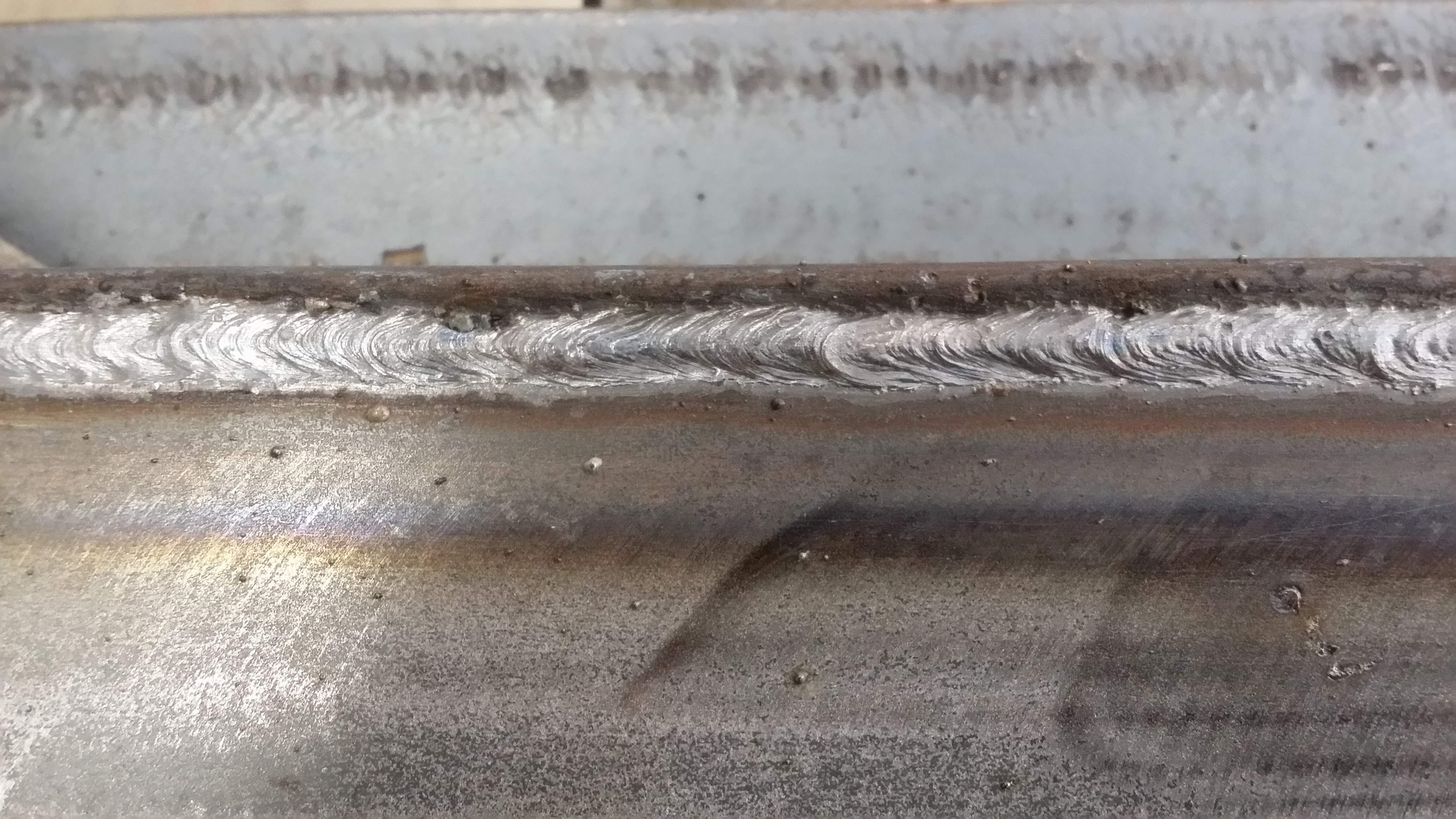

All of the manufacturers of spring hanger kits that I have used say not to weld the spring hanger down the side....only across the ends. This will also draw your trailer up.

Mark, thanks for the info. My hanger manufacturer calls for welds on the sides wrapping around half to three quarter inch at each end with a full weld on the ends optional. It seems manufacturers each have their own best practice for this item. My 7600# camper has welds down both sides and 1 inch of weld on the ends. Go figure, there doesn't seem to be any consistency with welding hangers. The hangers on my camper look identical to one's on car hauler.

You are right, a full weld draws the frame quite a bit. I got mine back to straight by doing some full welds on the top instead of stitch welds.

Similarly to what PJB said on his manufacturer; My manufacturer had no such statement on the spring hangers. They were however very specific on the welding of the spring seats on the axles as to where you could weld and not weld.

You should carry the weld across to the side for sure so the hanger doesn't "tear" but the primary weld area is across the ends. Dexter does recommend wrapping around the side, but the full weld isn't necessary(a 1/2" isn't but half as wide as your(my?) index finger) so it doesn't have a tear point from side shear but if you are welding with tubing especially, you can seriously draw the frame out of shape and that's the primary consideration as well as the depicted undercutting issue on the side which happens a lot more than you'd think, even with experience. (I don't risk it or waste the time or metal to go all the way). I learned that the hard way and figured something could be right, and had it figured out and then read the directions. Al Ko has told me the same.
A trick to welding the hangers on is to pre bow the trailer slightly over the axle hangers just by letting gravity do it's work by putting a support jack (or shim if you have it under the table) right under the hanger area when welding...Not much, but apply a little pressure on the bottom side as it is welded. Won't draw as much if any.

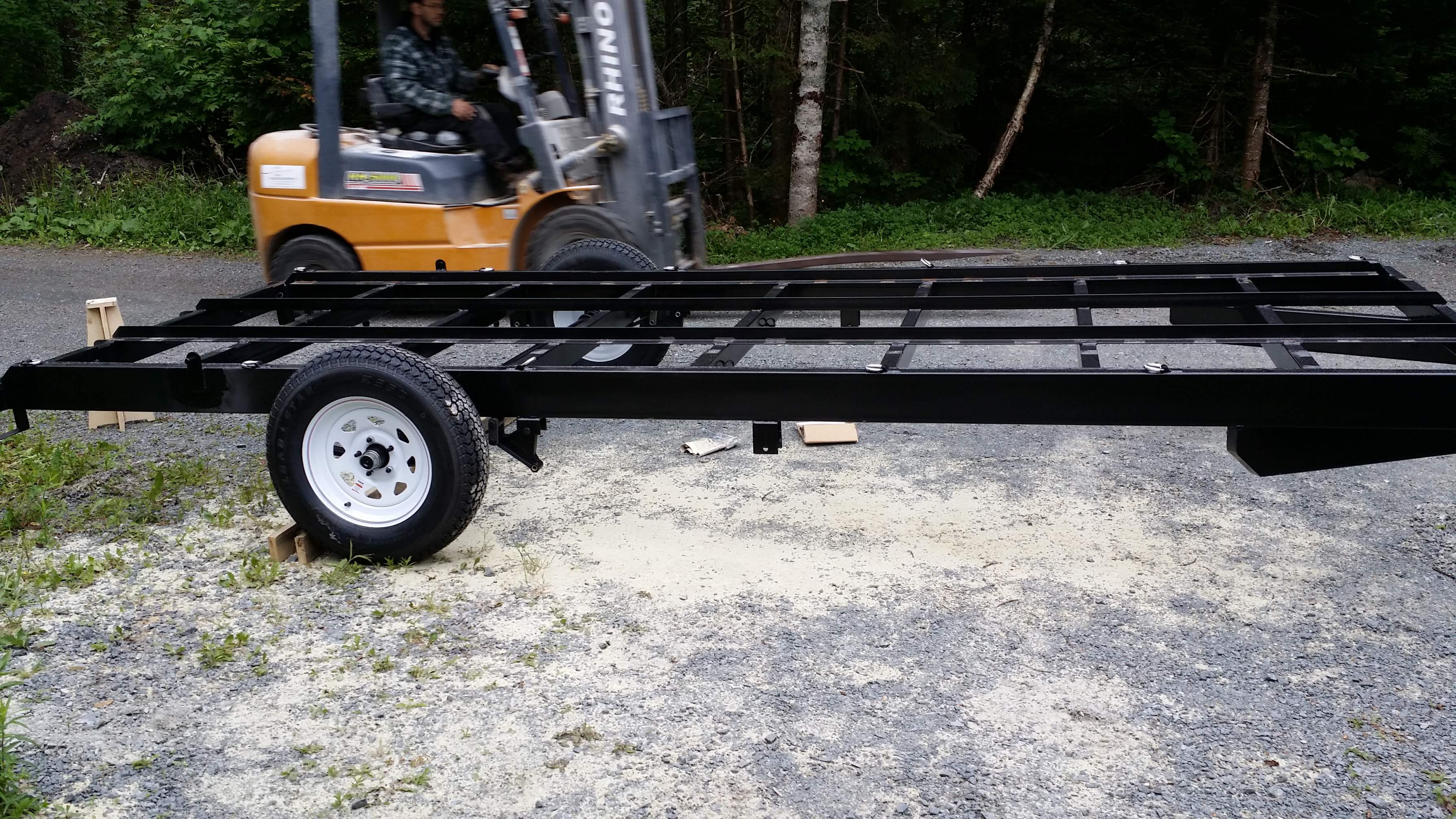

The trailer is looking good. Is it going to have an open center?
