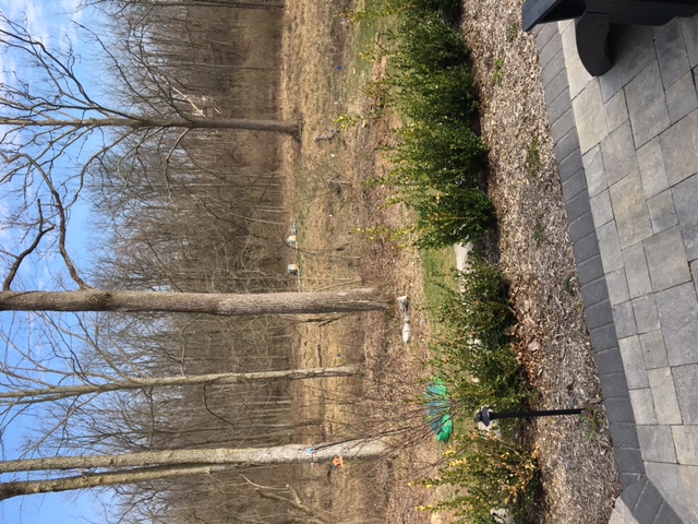

Hello,
I have been looking at buying a tractor for about a year and have done my research but wanted to consult with actual tractor owners first. I own 5 acres, that is primarily wooded, with a creek and an open meadow that has a high water table. Water collects in old skid steer ruts. Frogs etc. It does dry up in summer though. Creek divided property into two. Back acreage has a ridge but then flattens out. Pictures attached of meadow.

Thanks. Yes, I've tried to do my homework on this. I am going to dig the lowest spot of the meadow out and make a small pond. No aeration but will try to add plants to help clarify the water. Its really just a central place I can get water to run to to hopefully dry out the rest of the area. I'll excavate some trenches to the "pond".

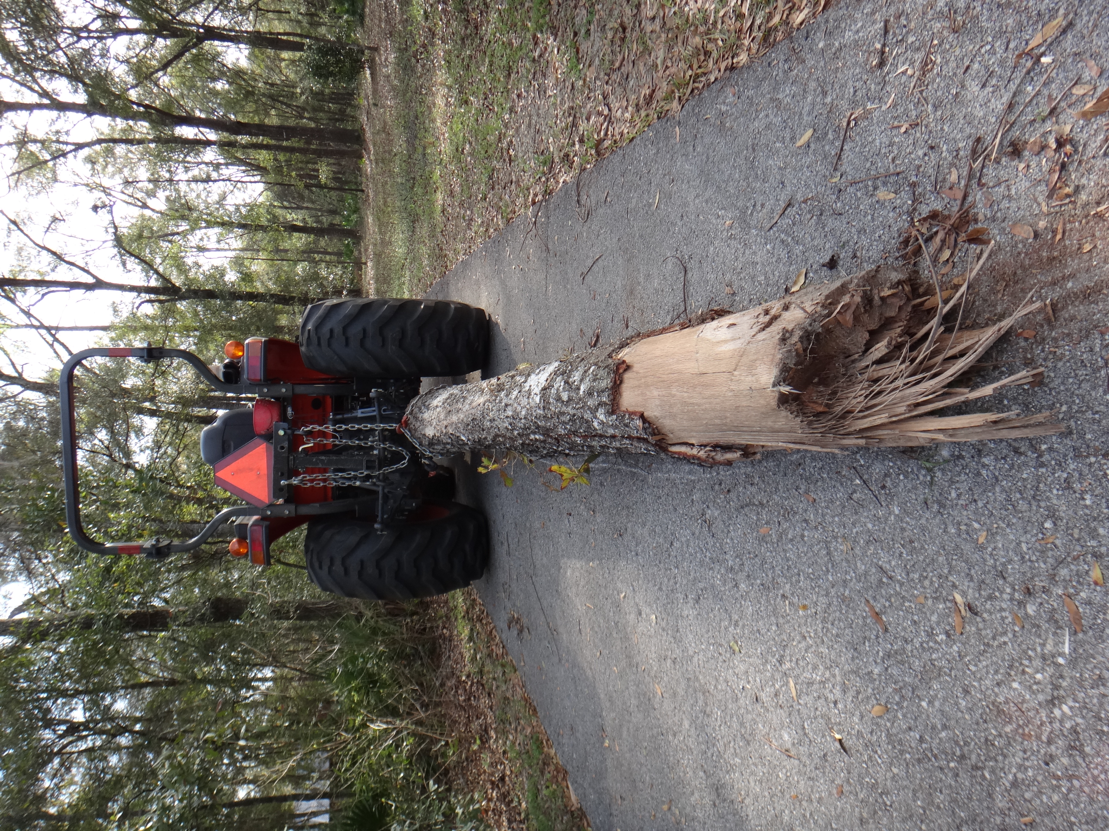

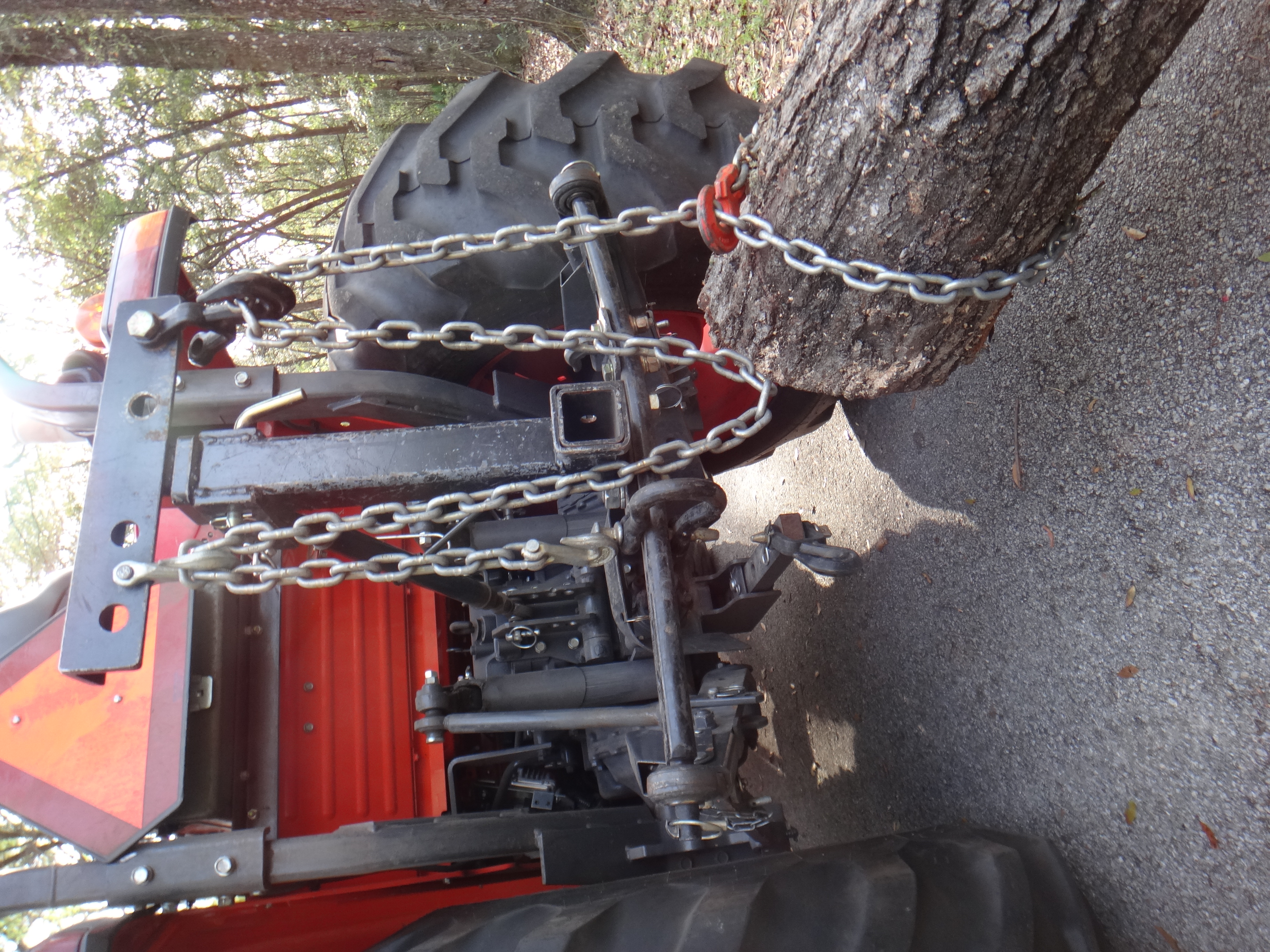

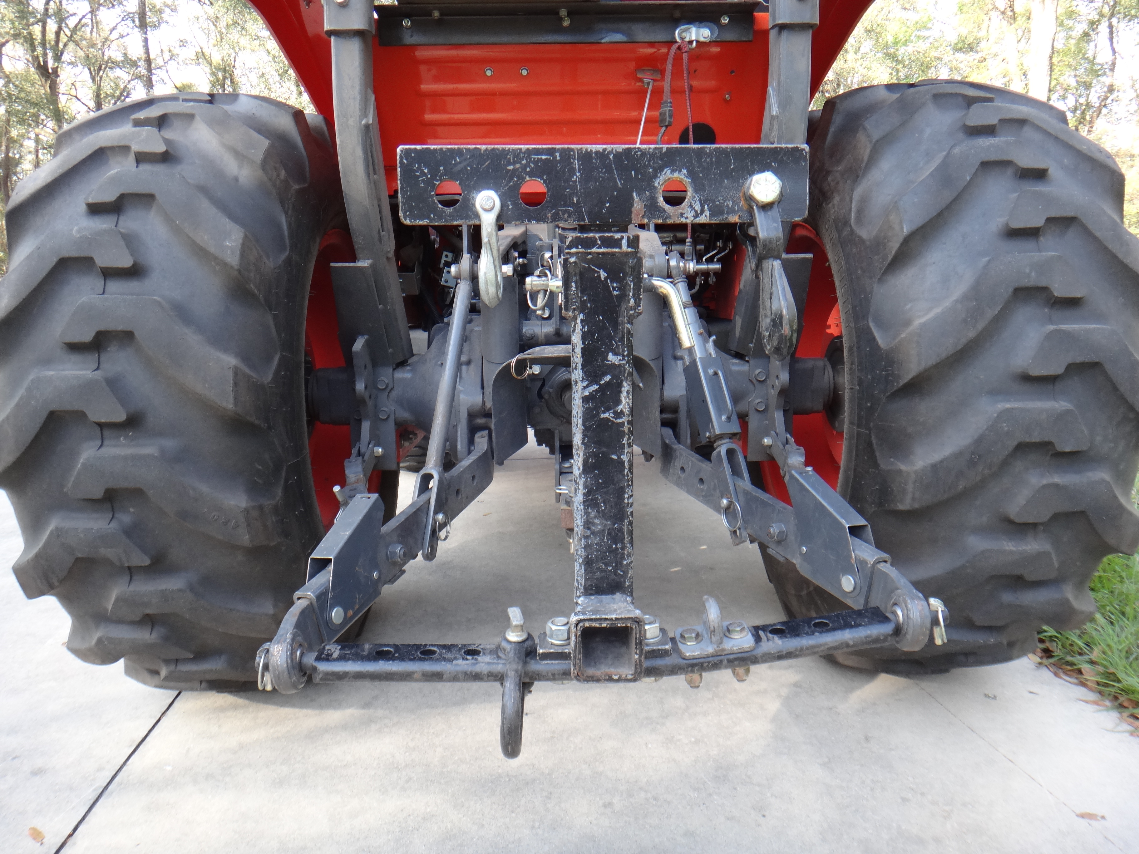

RE: transporting tree trunks
Many pull tree trunks from the rear/center drawbar. Sometimes I do too. Logs get pretty dirty, which dulls saw chains quickly. (Carbide saw chains remain sharp much longer cutting gritty wood but need a diamond wheel to sharpen.) If you pull from the rear/center drawbar on hard surface roads tow chain in road contact will abrade rapidly.
Better to use a cross-drawbar and short boom (also known as a hanging tree) on the Three Point Hitch, allowing you to elevate trunk butts. This reduces trunk friction against the ground and keeps logs 85% clean. Elevated, a small tractor can pull large tree trunks. Judiciously positioned tow chain preserved from road abrasion.
Mount one of Ken's bolt on 5/16" chain grab hooks on the cross-drawbar. Much more convenient than threading tow chain through a clevis fitting. ( Also Ken has THE BEST FORESTRY HOOKS.)

Regarding the pond and wet ground. Before you dig make sure the area is not a protected wet land. You can get in a lot of trouble if you start messing with those.

We built on the lot a few years ago and I dont recall any restrictions on the land. Its not even considered flood plain for some reason. FEMA must've been asleep.
