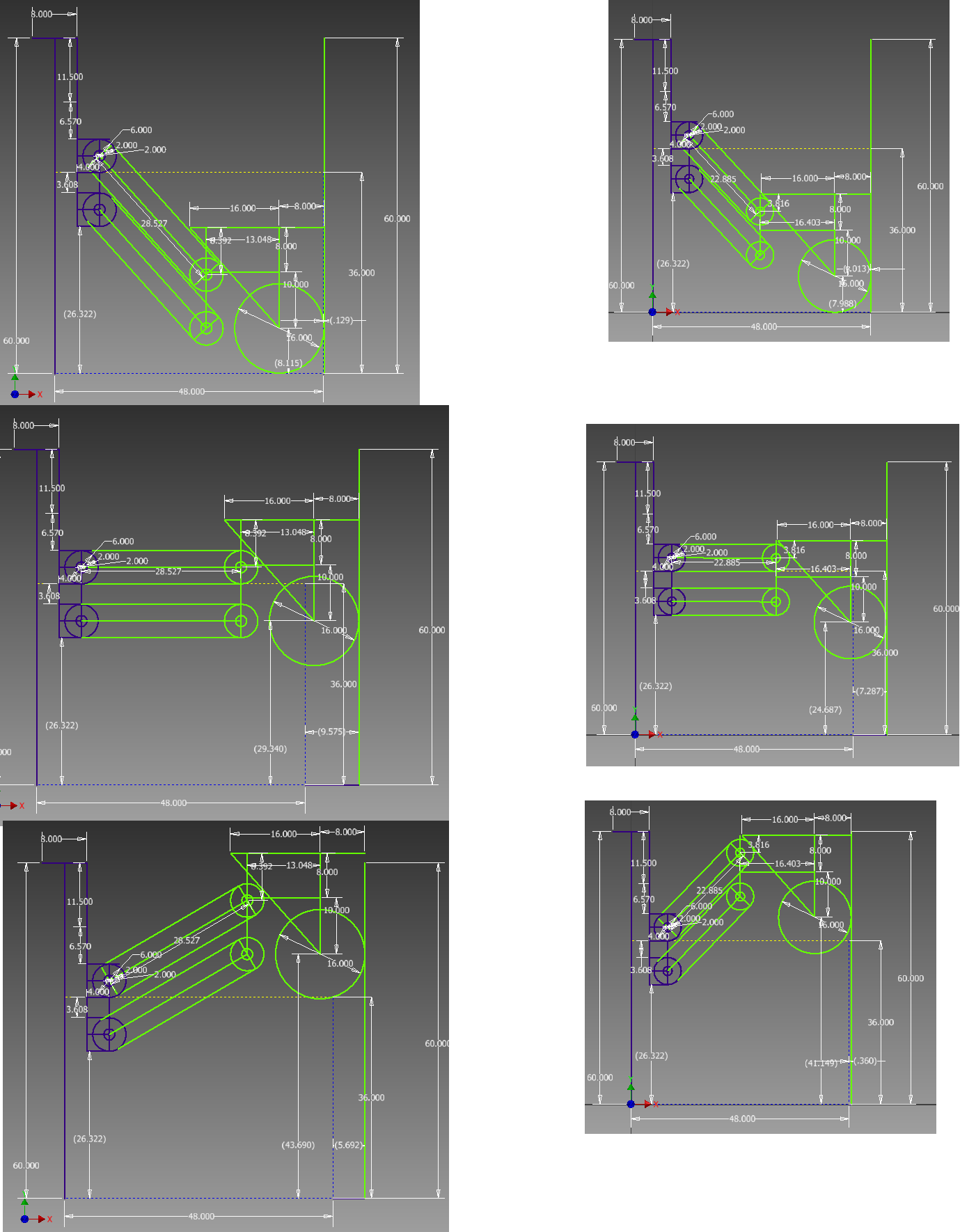

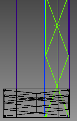

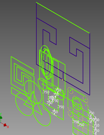

the 360 joint has taken a life of its own....
after getting fed up with constraints. i backed down, to just using parallel and perpendicular restraints. and using variable names, as dimensions are entered. slow going, but so far AWE! *looks relieved* less head aches...
was not really liking how far the last diagram in post 206, was poking up into the air. above the 360 joint. little bit different design. with 6 channels of bearings, and 6 seals. but looking much better and possibly a little bit more compact. still working on the new design with 2 Fluids (1 inlet / 1 outlet) and 1 compressed air.
various random diagrams. as i attempt to learn autodesk, and get something done for the 360 joint.
p.s. going to need to get a new keyboard, with higher raised bumps for F and J keys i keep sliding right over the bumps with fingers... :/

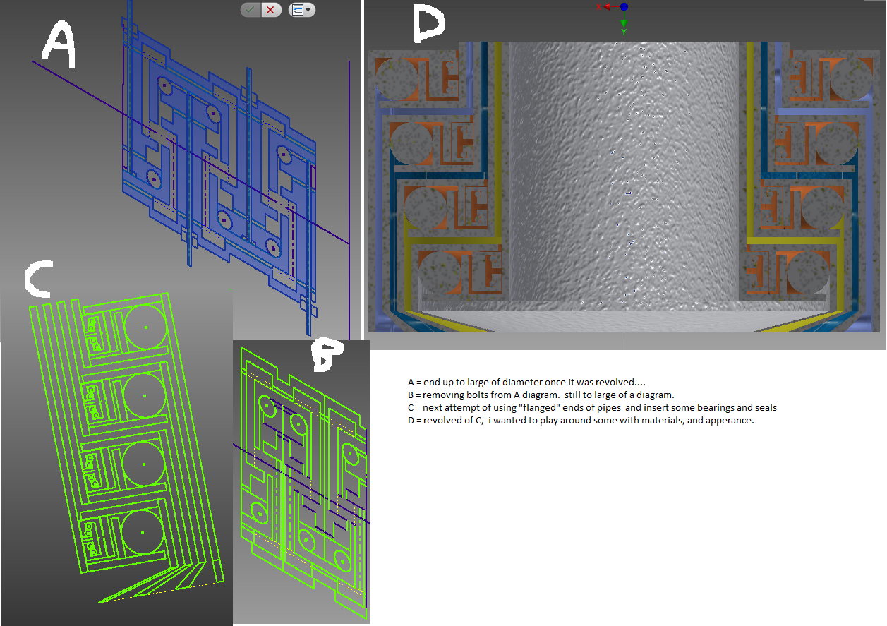

16 to 20 hours shot.... on that idea. awe well.... time to try again on a different fluid / air going through 360 joint.
problem, to large of of overall diameter once done. it gave me a few ideas...
below might work out nicely, would imagine, there already some sort of ball bearing and seal combo i might be able to slide right in. without to much fuss, if not, should be able to find seal that would fit in, along with some ball bearings.

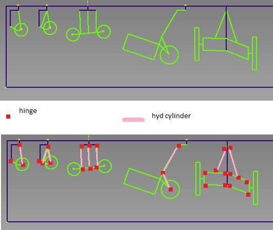

starting to get the hang of things better.
scissors like a scissor lift might use is no good. forgot all about. how scissors change sizes as the extend up and down. was more hoping for "fixed" points. and avoid and sort of track setup.

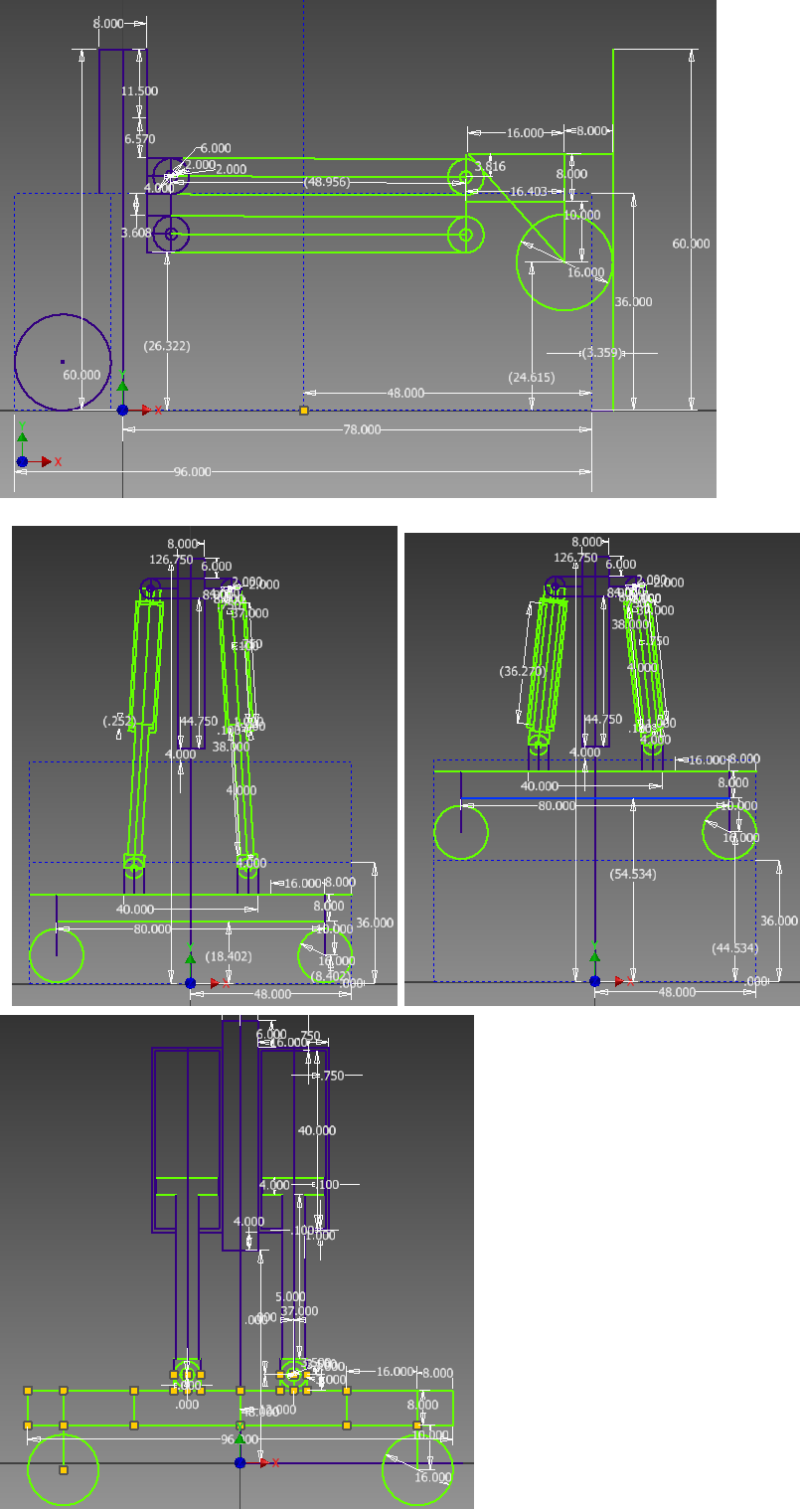

getting a tad aggravated, every time i get close to finishing something up, autodesk inventor crashes, or causes computer to lock up tight.
it took me a while, with autodesk to figure out how to create dimensions at an angle vs horizontal or vertical. as soon as i did it, i accidentally grabbed a hold of one of the dots and dragged a few things out of proportion. so was like COOL! so i started to draw up some lines for linkages for transport wheels, to get a better view point of how things would happen. after first couple diagrams. it turned into a "hang man" game. not joking! couple of the diagrams, when moving, looks like someone hanging upside down, with there feet tucked in, and doing sit-ups.
without getting to carried, i am able to set so many dimensions and angles, and then leave any were from 1 or 2 dimensions as "unknown" to act like hyd cylinders. and leave angles between lines left alone to act like hinges.
i am stilling having a rough time, of what to go with. more so the "arc" or path that transport wheels make when raising and lowering them.
and then dealing with trying to dimension out right at 8 feet. to deal with being on the road in transport mode, then switching over to field mode.
the other issue is amount of hydraulic cylinders.
been going back and forth. to deal with spacing tires for "row crop" i think i am down to placing a bracket on each side between 2 sets of transport wheels. and then the clamps or brackets that mount up on the SSTT main spine of a frame. making some extra holes there. to adjust wheel spacing. 10 to 20 bolts. if figure 2 bolts per bracket, should not require any other machine, besides a farm jack (4 to 6 foot tall farm jack) to slide things over. and extra thought placed in length of hoses and wires. to allow for wheel spacing and not having to redo them. be kinda like redoing wheel spacers of 6 or 12 wheel current age tractor. well transport wheels could do a min of 90 degree angle turn. may not even need a jack. just a chain binder or like. to help do finial adjustments to align holes up.
so down to how to place cylinders.....
would like to try to keep it down to 1 cylinder per set of transport tires a set = 2 tires aka duals. like a narrow front end tractor set of tires. it would make things that much more simpler to go with 2 cylinders per set of transport wheels. to allow virtually unlimited positioning. problem is complexity....and points of failure raises not doubling but exponential i would think.
off to autodesk inventor. and look at 2 cylinder options. and see about some mockup 3Ds

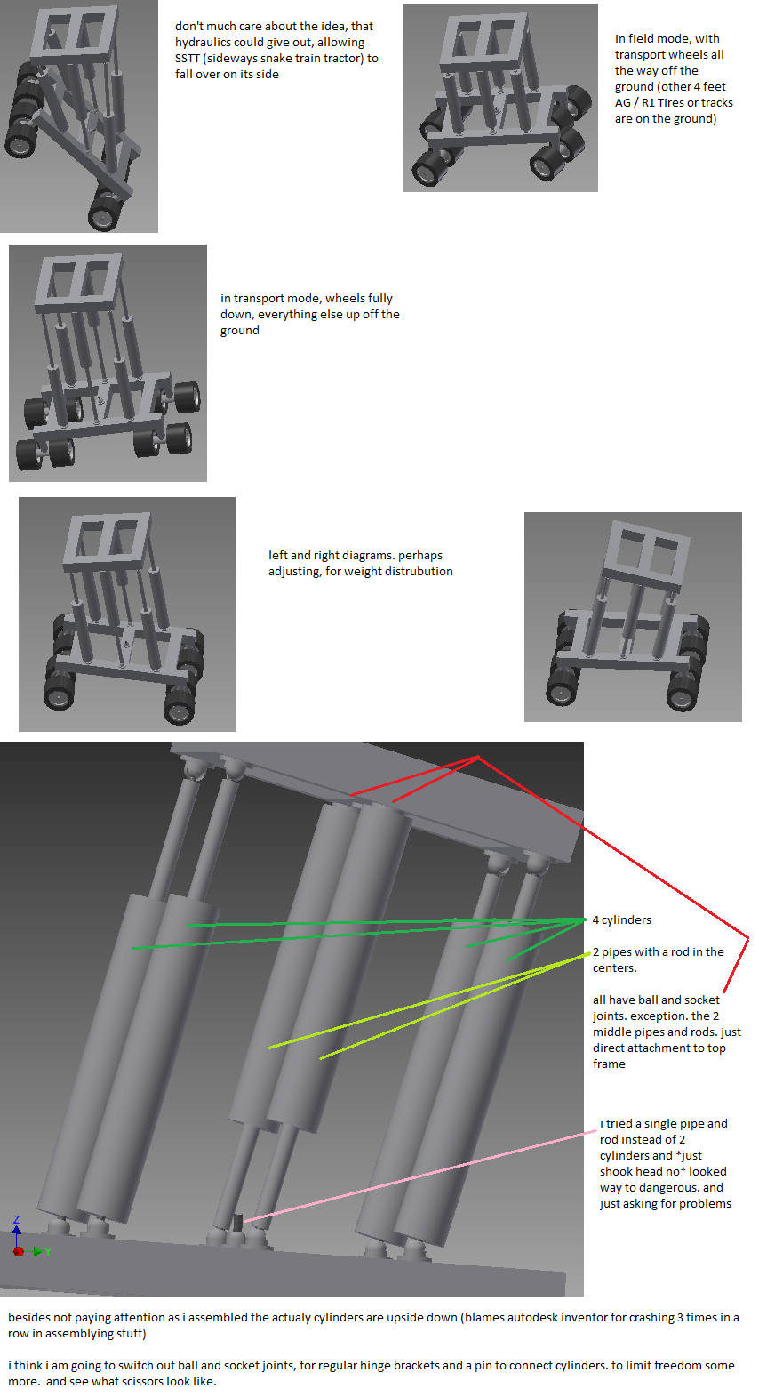

not much done today. been fighting autodesk inventor constraints. and taking 1 step forward 3 steps backwards :/
for the transport wheels see last diagram above. thinking of just mounting the cylinder portion of a hyd cylinder. directly to the main frame. so the cylinder is not able to actually freely move in any sort of direction. and lust let the Rod go down and connect to the sub-frame that the transport wheels are connected to.
other solutions for transport wheels in this thread. just causes to much free play. and end up chasing tail around. something bends here, or holes wobble out, pins slightly bend, and things just start falling apart. and binding up on to one another. then the "swing out" of other solutions for transport wheels. is a big problem when it comes implements. more the transport wheels "swing out" further the implement has to be swung out. so the implement does not bind up and come back up on the transport tires, taking both tires and portion of the implement out at the same time.
trying to figure out what might be the best approach to "beef" up things. so the rod of the hyd cylinder does not need to be overly sized diameter up beyond comprehension, let alone $$$. also need to come up with a better solution than using approx 40" inch extend/contract hyd cylinder.
thinking C channel metal bar. with wheels in it, that first come to mind, but i am not about to fight a stinking little wheel. that is catching and tearing things up. on a conveyer belt ok. enough little wheels mass produced. but beefer wheels for the C channel track metal bar for transport wheels... first reaction, is.... see how much explosive it takes or how much needs to be cut out, in order to get things operational and in working order.
i am a little on edge with using a pipe inside of a pipe. not actually a hyd cylinder. but just a pipe inside of a pipe. to help transfer forces between transport wheels and the main frame and vise verses. but with pipe, once you start to get a bend and pipe begins pinching. ya in trouble quickly. on other hand pipe inside of another pipe. allows nice even surface all the way around to absorb and transfer stresses and force from multi directions.
perhaps a I (capital i) or T beam, inside of a C channel beam. and toss some grease zerks in. i would get away from pesky wheels in the track of a C channel. gain strength in 2 different axis (X,Y, and not Z). Z = hyd cylinder itself. if something does begin to bend to pint of pinching. it would most likely cause the C channel beam to open up some. and some relief valves for the hyd cylinder go off. but would most likely still be able to raise and lower the transport wheel. it may be on its final leg. but perhaps enough to get things back to the shop so it can be repaired.
I or T beam inside of a C beam, i like it.
but what sort of configuration to put them in, and placing the hyd cylinder into the mix........
off to autodesk inventor.... to hopefully draw something up that is possible.

just been doodling some for extra frame work to go side by side with hyd cylinders for transport wheels.
been trying to create 2 C channels that interlock and slide in one another. but having hard time actually drawing it out. i see it in my mind. but so far been unlucky. i think most of the want is more of wanting to learn how to do it in autodesk inventor like a challenge
though looking at triangle setup 2 pipe sliders, and 1 hyd cylinder. welded or clamped together in a triangle formation at the ends.
also I beam and C channel on each side of a hyd cylinder. and it just hit me. like DUH! there are 2 hyd cylinders. and i can count on frame work on each hyd cylinder. to help deal with twisting and forces / stresses... alright. that makes sense. back to autodesk.
