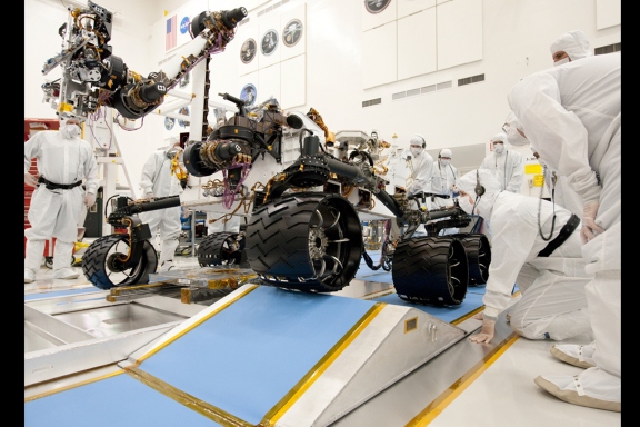

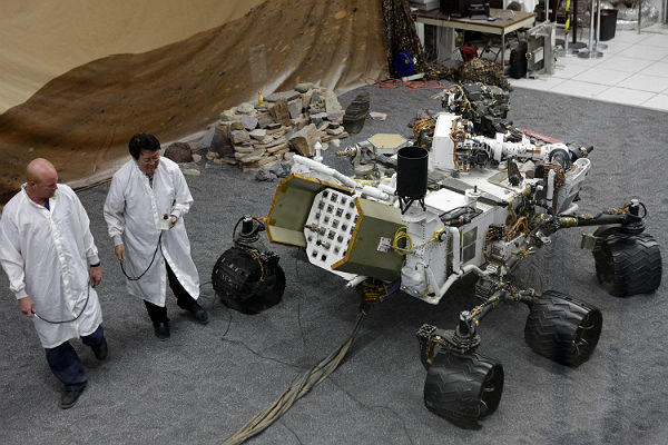

You bring up a good point regarding motor cooling. In order to keep the motors small, water cooling maybe the best solution. I agree air cooling is no good.
A good application of sealed water cooled motor to study is underground mining equipment. These motors must be sealed due to potential explosive gas encountered in the mines. Water is pump through the miner into water jackets that surround motors and then sprayed out onto the coal or ore to reduce dust. This is a very effective system.
Your system could use a similar set-up as the mining machine... except you would recirculate the water (closed loop) to a radiator. The system would be 100% sealed.... so no issues with mud getting in motors, etc. The motor can be directly attached to the wheels using a planetary gear train. Very rugged and very simple! Modern large dump trucks, wheel loaders, etc use this system. If you can use a brushless motor... all the better!
I believe the hydro system will have too much power loss on a machine as large as you are talking about. And will be especially limited at higher speeds. Even a small hydro compact tractor (5000 lbs) must use a 3 speed gearbox to compensate the hydro motor for different speed and load conditions. And they only have a top speed of 14 mph! Your tractor must have major pulling power and I'm just not "feeling" hydro drive for it.
Electric or Hybrid vehicles are exposed to extreme conditions during normal operation. Water is always an issue. Hybrid vehicles use a cooling system to keep the motor controllers and motors cool. The systems are fully sealed and have no issues when operating in mud and water.
   / new tractor idea possibly.... #193
Great example of electric motor hubs operating in extreme conditions.... Of course in this case the machine isn't cheap! :laughing:
Looks kinda like your SSTT ey? ;)

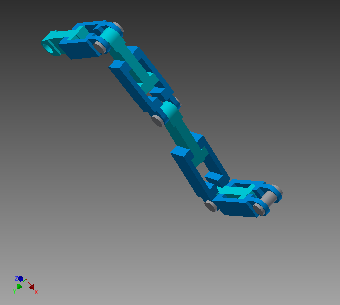

autodesk inventor. finally getting through "restraints" and figured out YA!
but... collision detection..... not looking so good. for what i was hoping for. as far as programming a simulation. when i get over into "autodesk simulation multi physics" program. maybe something there. but not enough time to go through it.
also going to need to pickup "microsoft excel or office" 2003 to 2010 license, in order to do much with inventor. well i should say, keeping track of all the parameters (length, width, height, diameter, etc...) openoffice does not work, due to how autodesk inventor and microsoft excel "talk to each other" to update things parameters.
i have downloaded a few other autodesk app's (auto cad mechanical, simulation CFD, autocad electrical), and i am going to need to go through them, to look at simulation, but at moment it is not looking to promising. as what i was hoping to find, for simple collision detection. that could be used as a constant / variable set parameter. though, that maybe, the newbie of me speaking.
collision detection... *grinds teeth* ggggrrrr....
using autodesk student edition. trying to learn.
4 cylinders. (errr ok modified generic flat cylinders)
hhhmmsss i thought the image was suppose to have a "autodesk student edition" markings on the image....
the 3 different "angle" constraints. are giving me problems. in wanting to set 1 to 2 of them. and only allow freedom of moment so much in one direction, and then setting another constraint to be able to move so far in the other direction.
was actually hoping for "collision detection". to work better and spit out how many degrees and other parameters, when something happened. but... i am not finding/seeing the info.
going through "constraints" videos on youtube, and came across this video.
a bar that fits into the end, of a cylinder, and is used to determined position of the rod of the cylinder. *shrugs* something to remember. vs the gear / toothed bar, from an earlier post.
https://www.youtube.com/watch?v=QkEvE7SqsMI&feature=related
