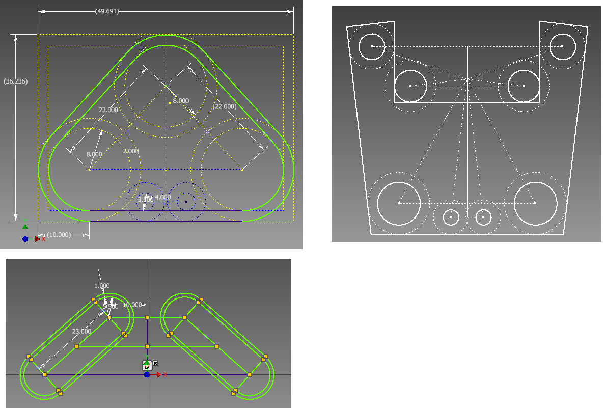

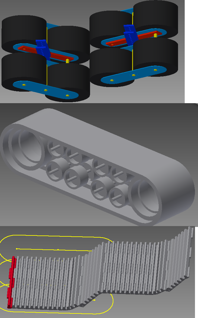

i think it would be easy enough to add a "triangle" track setup...
but problem is limited to about 4 foot long. just not enough space to squeeze anything longer in between implements located on both sides of the SSTT.
so i thought about adding some extra wheels / rollers, so the track could be "folded" up and at all times keep the tension placed on the track. so it would not fall out of alignment with sprockets and groves that the track ran on. that idea lasted long enough for me to get frustrated trying to draw something up. and trying to find space that was not there to begin with.
then thought about 2 tracks approx 3 feet long for total of 6 feet. i am hoping i can find enough room. for this. were i can "flop" each individual track upside down to keep everything inline. when driving in one direction. and then do another flop, to allow tracks to be driven in opposite direction. and keeping the tension pulley/wheel/roller going in correct direction vs driving/powered sprocket/wheel. or at very least. i could state track adjust to ground slope. and allow for weight distribution.

been chasing my tail for most part of today.
going to need to go through "pathing" tutorials for setting tracks or chains on sprockets. tried on my own but never did get it figured out quickly enough.
went for 4 sets of tracks. thinking i might be able to pull it all off. but before tracks even got applied over the wheels. i am looking at "transport wheels" without the tracks on them and no 360 joint.
after a few days, since transport wheels. i am a tad lost on dimensions of what i am limited to. i think i am going to tackle a generic main frame for the entire SSTT. and begin attaching wheels / tracks / implement linkages. and do a little fine tuning on actual dimension of things.

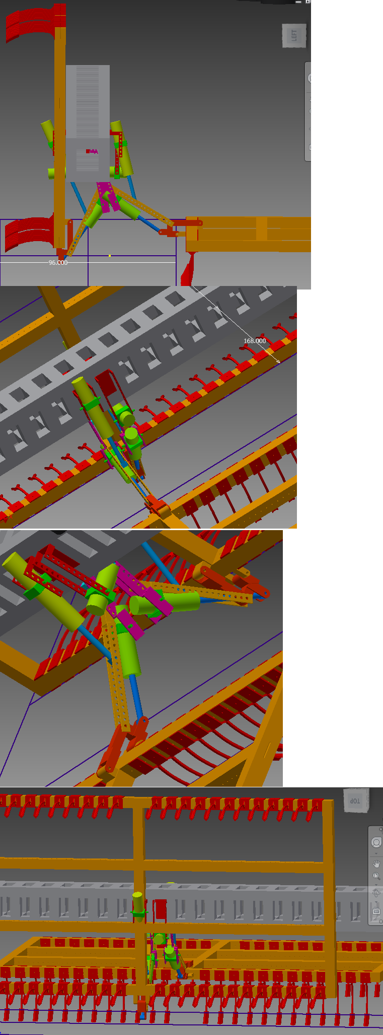

weekend and monday never got a chance to work on the SSTT.

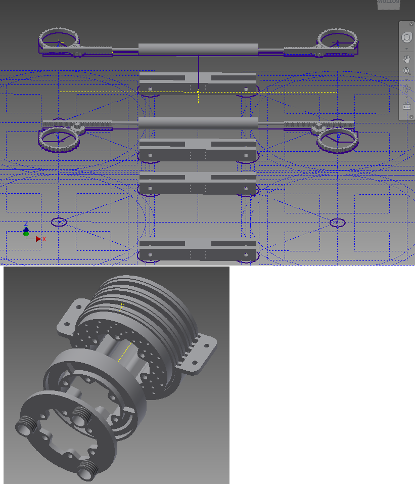

today, ended up re-drawing all the cylinders, and brackets, and a 60 long, 2 wide, 2 tall (main frame) for implement linkages. thought i could squeeze out a few more inches. to allow implements height to get upwards of almost 36 inches. vs 24 inches that i originally was going with.
but if ya take a look at pictures, trying to place brackets so everything freely moves without ramming into something as implement folds in/out and up/down. is getting a bit nerve racking. of constantly changing dimensions. and re-starting from scratch for brackets so things do not bind up.
going to hold off from another run of brackets. till i get the transport wheels at min added to the overall assembly to double check min/max height i have to work with for implement linkages.

started to re-draw the transport wheels linkages and frame for them, one more time. and haphazardly drew up some gears, a straight bar, and a hydraulic cylinder. wanting to finish out the frame, decided to hit the 360 joint one more time for were 2 hydraulic oil lines, and 1 compressed air line runs through it.
360 joint going to take more time than i thought. to shrink everything down even further. and i think it is finally starting to take shape. both in overall width, and height that it takes up.

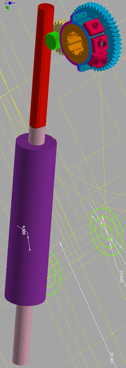

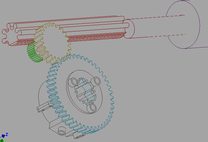

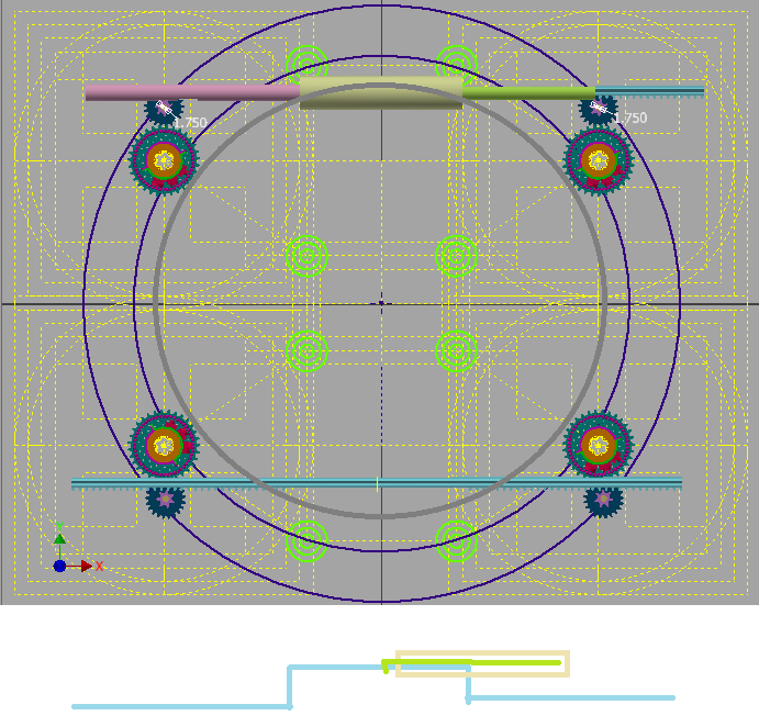

at movement trying to figure out. how in the world, i am going to handle the "toothed" bar. that is used to rotate the transport wheels 360 degrees. or rather i should state rotate approx 200 degrees in each direction.
i need to keep tooth bar tight up against the gear, and at same time keep the tooth bar from bending. along with rotating and twisting (keep teeth aligned up and not end up at some odd angle))
i am not really seeing bearings happening at all to keep tooth bar lined up.
i thought about just dropping a 1/4" to 1/2" thick wall pipe around the tooth bar. and notching it out. were the gear is. and i may still do that.
though last brainstorm thoughts, is possibly doing something like a belt and pulley setup. or rather make that. instead of a belt on a pulley, the round toothed bar would ride in 2 to 4 pulleys to keep things ligned up and up against the gear.
the problem with above ideas, is i almost need some sort of "rail" to keep the tooth bar from "rotating off and away from the gear. i thought about tossing some fins onto the tooth bar. and add some tracks for the fins to ride in. and i may try that.
i may end up going with a thin flat bar vs round tooth bar. and making clearance for the round hyd cylinder rod. and just letting everything slide in a molded setup.
to note it, i had to go with a reduction gearing. with the toothed bar. simply not enough space. and limited to 8 feet width. once i remove, spacing for seals, 0-rings, bracing for a hyd cylinder. plus some extra bracing for tooth bars and a encasement for everything. i end up loosing say foot.
then tied into a needed diameter of the main slew gear. and really can not make it much smaller than what it already is.
i would imagine i might be able to pickup a different gear ratio, putting a few more teeth on the tooth bar. to pickup a few more degrees of rotation of wheels. but math behind figuring out type of teeth and how to dimension them is above me. but even then, i do not think those few degrees would give me enough degrees that would be needed.

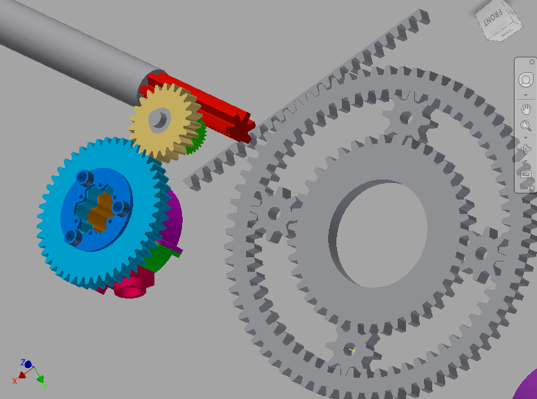

Medusa head for toothed rod. ok maybe that would be expensive to actually make. perhaps, going with something like a PTO shaft end, that sticks out the rear of tractors. vs a wave of arcs. hhmmsss that could work.

*rubs chin* my mind is getting a tad foggy, if a planetary gear setup vs reduction gear could work. way to much math for my brain to handle at moment. let alone finding the math. for basic generic calculations.
for the toothed bar, i don't know yet. looks way to complex still. along with needing to get oil or grease or lubrication in between the bar and the track it goes into.
part of wanting to see if planetary gear would work. is another attempt to reduce overall height the 360 joint takes up. though looking at things. not sure if it would be needed, i may still go with reduction gears as now, but possibly add a couple ring gears into the mix. na.... will just beef the living daylights out of things if need be.

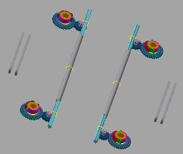

rack and pinion, to deal with rotating the wheels for turning purposes. is becoming problem-matic. re-thinking of how what other ways everything can be ran. including arc's to bending the pipe, etc... to get around the raising / lowering cylinders of the transport wheels. to running another gear for a angled across things.
so far not real happy, and trying to visualize things in my mind, to keep lubrication (oil or grease) in. and still allow connection point of a hyd cylinder

back to the transport wheels.... at one time i thought i would be able to make it so there would be 4 wheels (2 lefts, 2 rights) would have there own set of raising lowering cylinders, and own cylinder for 360 joint to rotate it. but space is simply not there, without adding an extra 8 to 12 inches. and if i add the extra space, and transport wheels sink up to the axle other parts would be dragging and digging in as well, and just be one ugly stuck mess trying to get the SSTT (sideways snake train tractor) out of the mud.
but now it is look like....
2 front left
2 from right
2 rear left
2 rear right
total of 8 tires. will have 4 hyd cylinders to raise and lower them to the ground. and then i am not sure if i am going to stick with a single hyd cylinder or go with 2 hyd cylinders to rotate the 360 joint.
i have room to enlarge the reduction gears. and i might be able to either run a shaft between left side 360 joints and another shaft on right side 360 joints. problem is... keeping everything as low profile as possible.
WAIT a min....
that might work better, a hyd cylinder on left side 360 and a hyd cylinder on right side 360 joints. and keep all the ugly shafts from going from left to right side and vice vs....
hhmmsss THE PROBLEM.... needing adjust wheels for row / crop. doings. GGGRRRR. i guess go back at it and see what i can come with vs, shorting the idea out, vs seeing if it is even possibly by rough set of numbers.
