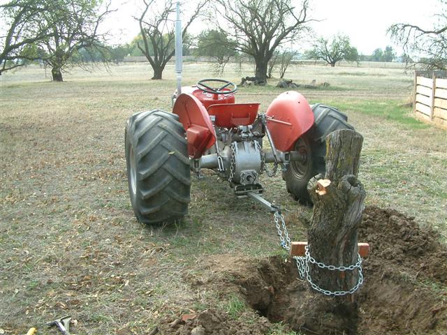

For hills and slopes there's no substitute for wide wheel track and low center of gravity.
My 1964 MF135 diesel tractor was modified to work in orchards where lower is better.
The rear tires are 18.4 inches wide for high flotation to keep from rutting the orchard.
These tires fit 16 inch diameter rims. They are used primarily for large farm equipment like combines, corn harvesters and grain trucks that work in the fields and need the high flotation.
The front axle spindles were shortened to keep that 135 level.
What's nice about that MF135 is that it's a straddle-type tractor (your legs straddle the sides of transmission) that helps keep the center of gravity low. Unfortunately, most new modern tractors are the other type that has the higher seat and a floorboard so the CG is higher.
Some mods like these are relatively easy to make on any tractor and might work for you and improve performance and safety for work on your hilly property.
Good luck

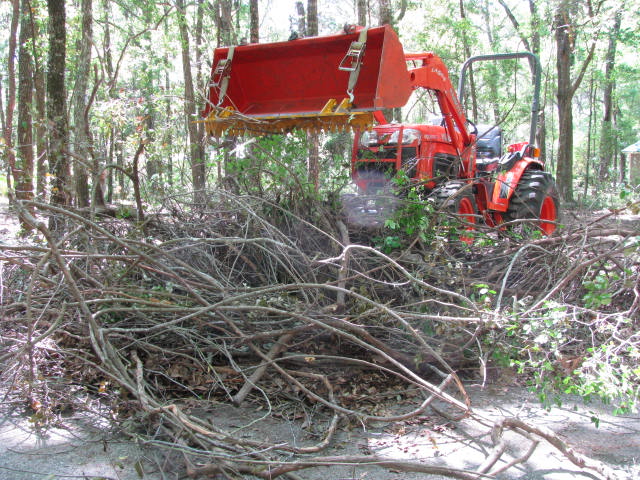

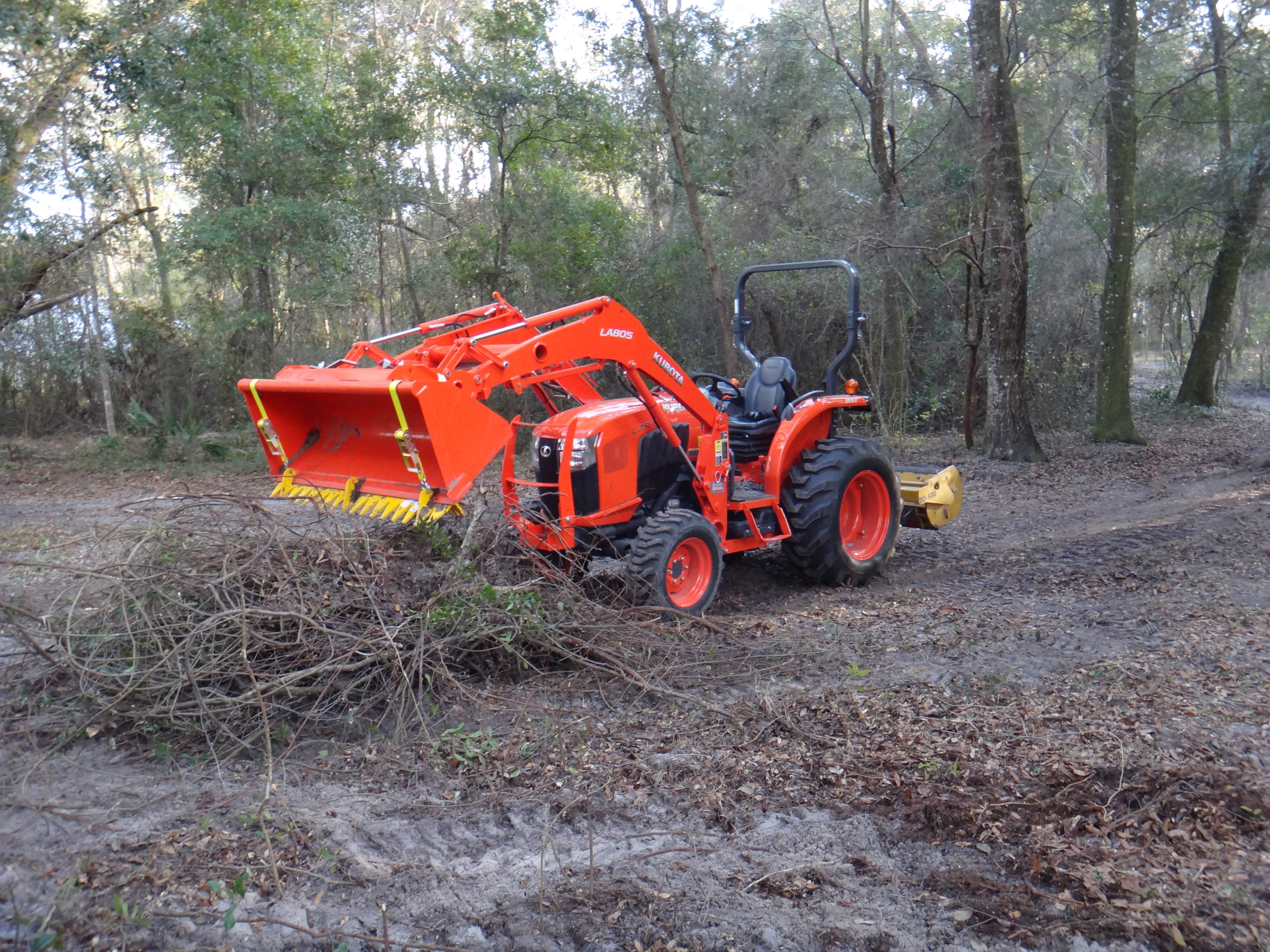

A Ratchet Rake bucket attachment is the best tool for pulling up brush. TSC sells the Ratchet Rake but not all lengths are consistently in stock.
You can order a Ratchet Rake from the Tractor By Net store, button at top of this page. Delivery by UPS.
A Ratchet Rake piles brush superbly. It is also fine for minor grading. You can use a Ratchet Rake to prepare a small garden.
To pick up brush, you need a grapple, pallet forks, debris forks, or a bale spear, all front mount.

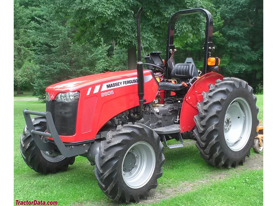

You know your situation best and you have some tractor experience. Having said that, in my experience, you are considering tractors that are too light. You need a tractor with a bare weight of 3,500 pounds, which in Kubotas are the 'Grand Ls' or utilitarian MX series.
Better a used tractor of sufficient weight than a new tractor that is too light.
Questions:
-is a B3350 more stable on slopes than an L3301?
B3350 = 1,896 pounds/bare tractor, 54" tire width
L2501 = 2,623 pounds/bare tractor, 55" tire width
Both are too light for work on slopes. Neither can safely operate a 990 pounds chipper. On even slight slopes, the chipper will take control of either tractor. Not only is the chipper heavy, it is cantilevered far to the rear of the tractor on the Three Point Hitch, amplifying the effective weight of the chipper in leveraging up the front wheels.
-is the lighter weight of a B beneficial on sloped soft soil so it doesn't sink in and tip?
No. The opposite is true. Weight increases stability.
-Can the wheels be moved out on Bs or small Ls?
No. For adjustable rear tire widths you have to buy a 'Grand L'.
-the R1s on the B7100 have worn, probably due to work on pavement. R4s would handle that much better. Do they also make the track wider than R1s?
Yes. About 3" on the Bs and small Ls.
How about floatation on soft soil?
Flotation not the key metric. The key metric is traction. Generally speaking, R1 and R4 tires exert approximately the same ground pressure. As tractors get heavier, tractor tire size also increase. In soft soil barred R1 tires have more traction. (R4s float slightly more than R1s.)
You did not state your altitude. Horsepower declines about 3% for every 1,000 feet of altitude over 1,500 feet. At 6,000 feet or more, a turbocharged tractor engine is advised.
Buy enough tractor.

For weight, a mid size Mahindra or Kioti would be a better choice, especially with FEL, you have 4,000 lb tractor, more with loaded tires.
