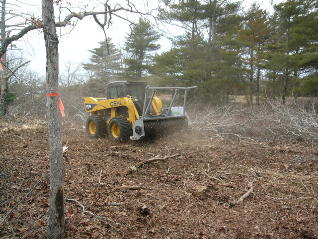

Often, the overheating problems seen on some attachments come from that they have a fixed-displacement hydraulic motor. These motors generates more heat because they repeatedly go in relief under effort. On a variable-displacement motor, when the attachment is under effort, the displacement of the motor changes to a higher-torque volume instead of going in relief. Granted, variable-displacement motors are more expensive. But you might end up saving on the number of skid steers you burn down. :D
Here's a picture of that first front-mount unit (DAF-180, now DAF-180E, which has a more robust pusher bar than the bent one shown here ;) )
Good luck with your business!

/ new to the mulching world #7
Frederic,
How does your head work in areas with lots of rock?
jb
