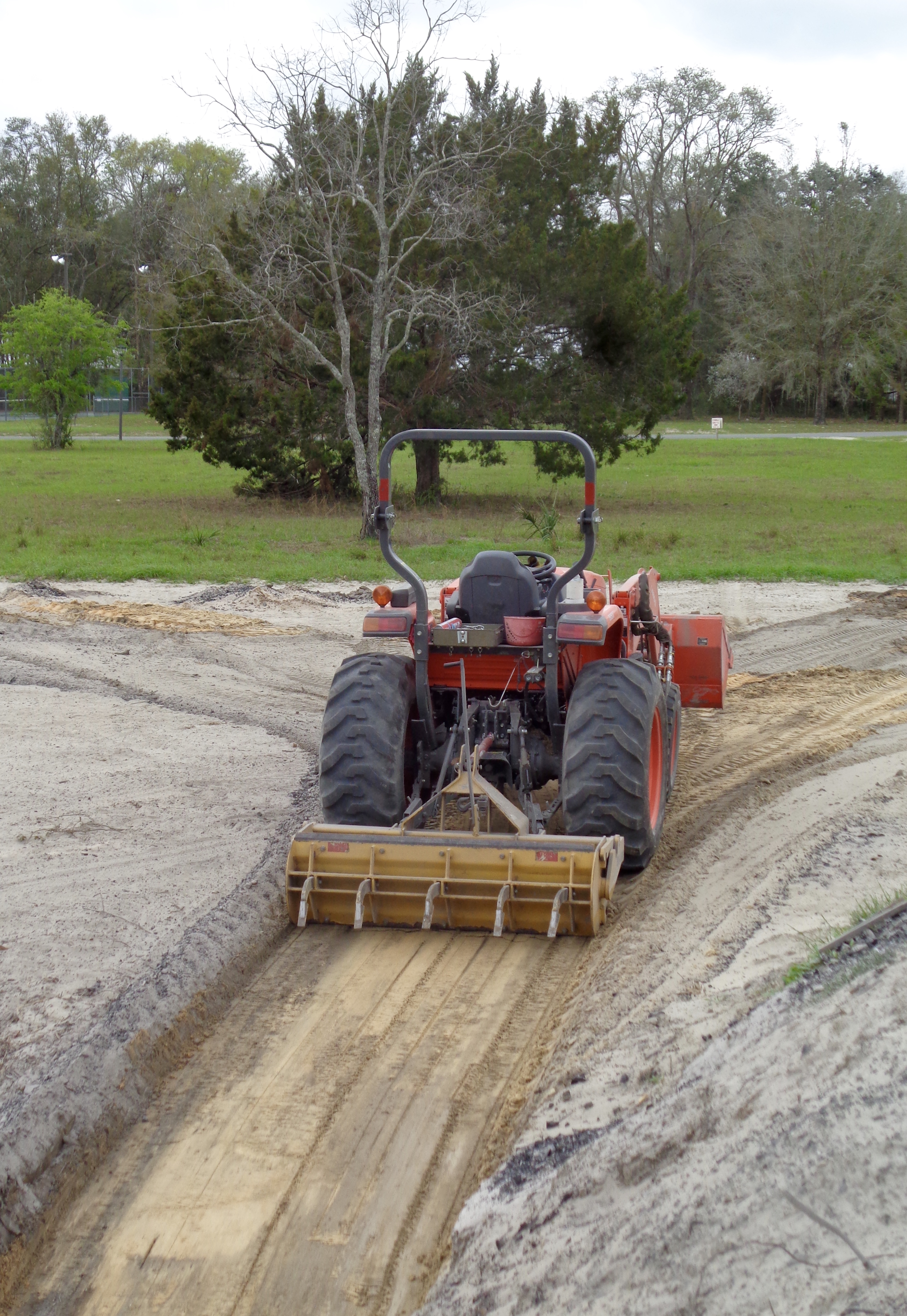

Consider a Rear/Angle Blade along with a Box Blade. Rear/Angle Blade and Box Blade can both crown, but crowning and maintaining ditches is easier with a Rear/Angle Blade. Both require quite a lot of (fun) practice to use efficiently.
Angle Blades are often used for snow removal when snow is too deep for removal with Front End Loader bucket.
ARCHIVE LINK: Rear Angle Blade versus Box Blade site:tractorbynet.com - Google Search
VIDEO: TRACTOR REAR BLADE CROWNING - YouTube
Simple and faster to operate, with the significant advantage of "recovering" gravel, also consider a Land Plane/Grading Scraper (LPGS) Probably more useful for your road maintenance than a Landscape Rake.
VIDEO: land plane grading scraper - YouTube

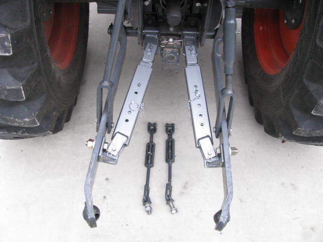

Photo #4 ~~ A Box Blade can PULL dirt with "chain"/turnbuckle stabilizers securing the Lower Links of the Three Point Hitch. In order to PUSH dirt with a Box Blade, which is handy, you must have heavier rigid stabilizers, which usually also offer desirable pin adjustment. "Chain"/turnbuckle stabilizers only provide Lower Link support when tractor is moving forward. Rigid Stabilizers offer equal support moving forward, "some" support operating in reverse.
VIDEO: Kubota Standard L Series L843 Telescopic Stabilizer kit (overview and install) - YouTube
I usually have my Ratchet Rake mounted on the bucket when I have either my rake or Box Blade on the Three Point Hitch. Photo #2 + #3.
