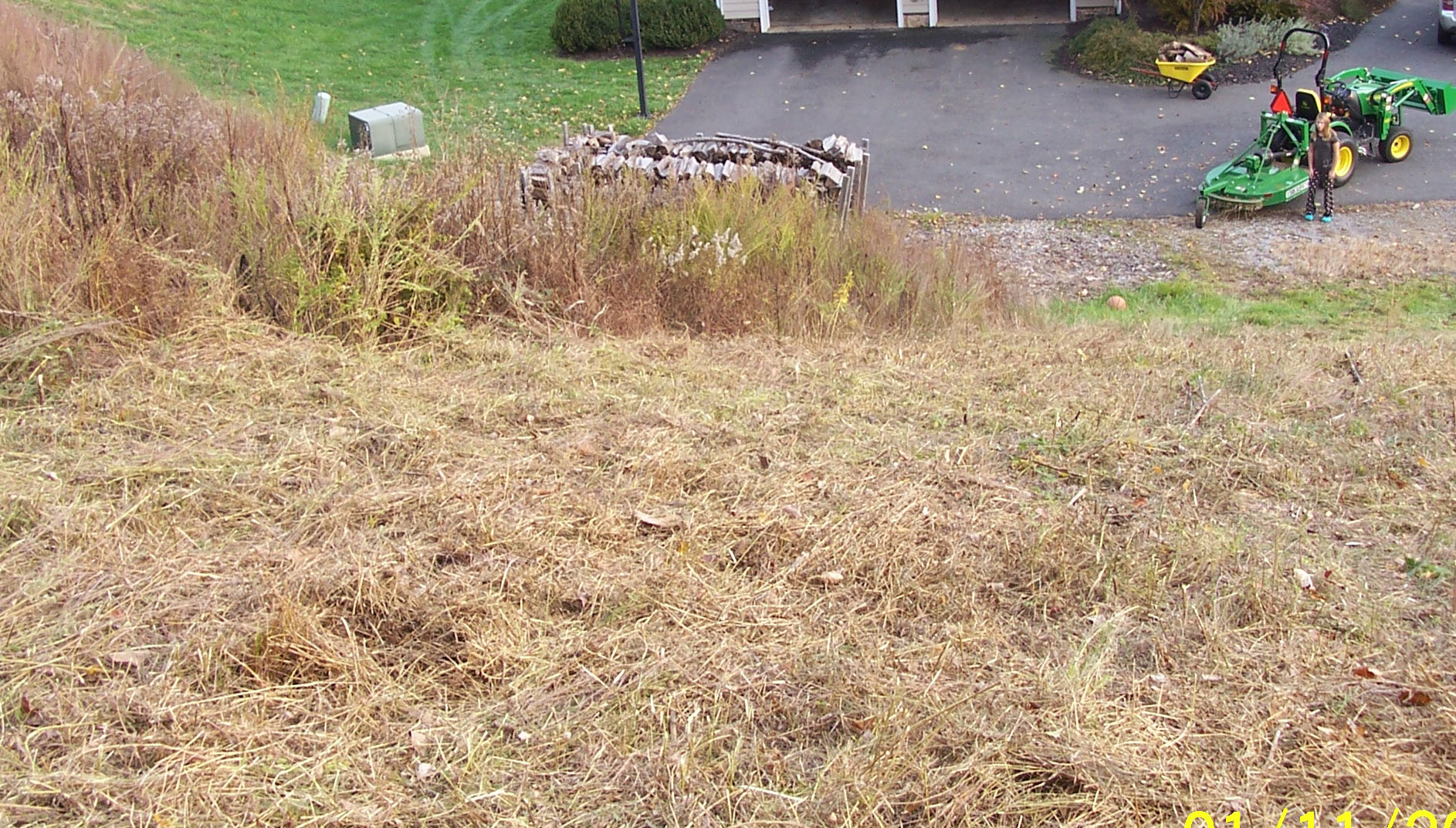

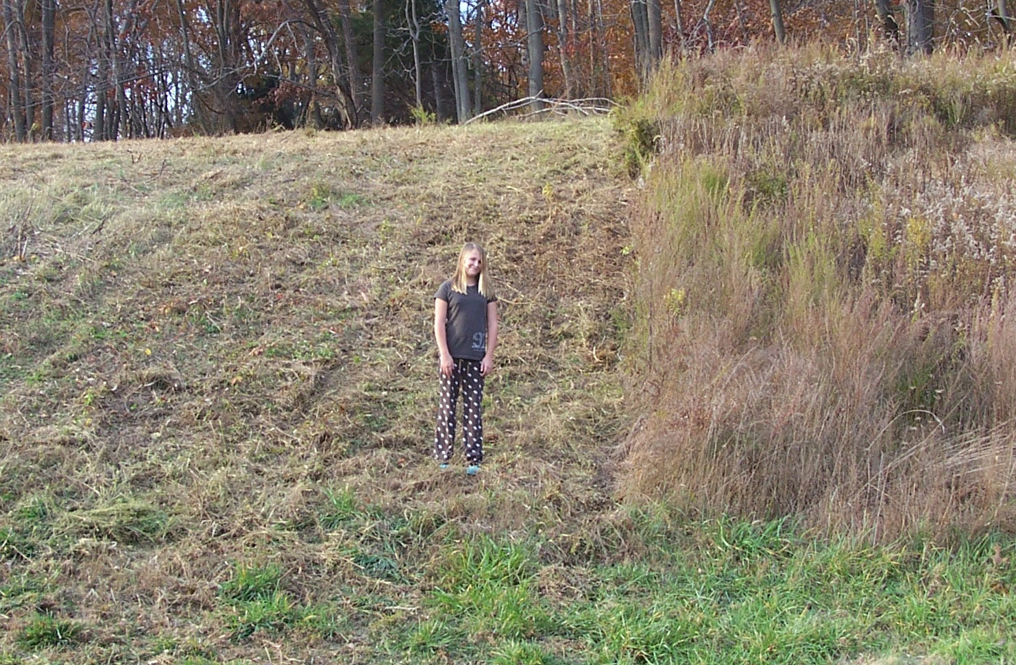

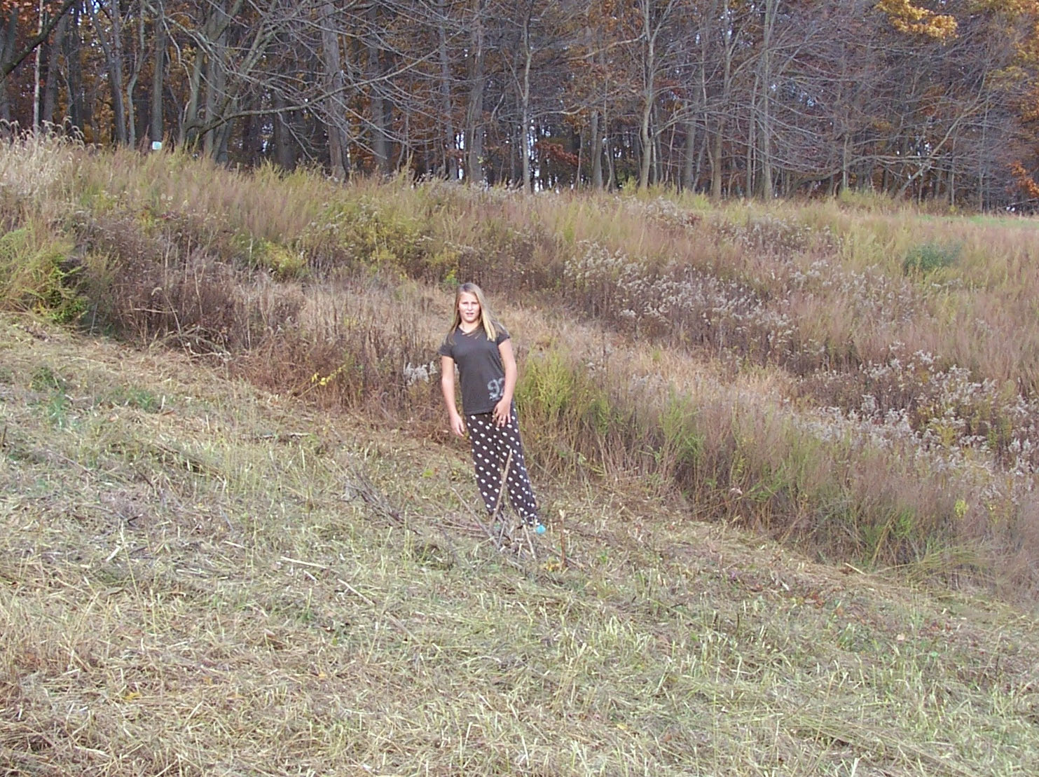

I used the advice from all of you and tried cutting one of my steeper slopes, about 20 degrees. I went forward; straight up and down in 4WD with loader as low as possible. Brush/ground was dry. I was using my Frontier RC1048 which did a nice job. Never felt unsecure; no pucker factor at all.
Uncut area in pictures has no room at bottom, and is wet due to a spring that seeps water most of the time.
Girl is my one of my daughters (5' tall).

Good photos - really can tell how steep it is!
I have some similar areas that I bush hog a couple times a year - once you do it once or twice, and get a good feeling of your machine on a certain slope, it feels better.
Glad you got it done safely.

The pics really do a good job of showing the slope. I'm not sure if it's too steep to cut sideways or not, but it doesn't seem to matter, you got it done!!!

Good pics!
As far as the uncut area, I'd try backing down. I think that will work for you.
As far as the wet area...as long as you go slow (low range, 4WD), I think you'd be OK. As written in my first response, wet grass is slick. However, go slow enough so the worst case is a tow up slope (rather then a runaway slide). Might be worth giving it a try...
