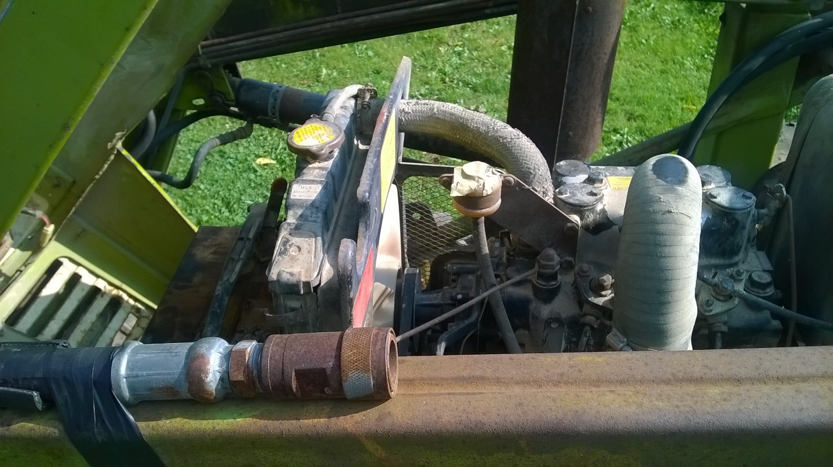

Anyone interested in my saga "Finding a Yanmar of My Own" can read the backstory in this thread. Since I've now found, and own, one now, I thought I should start a new thread.
The fellow I bought this from seemed honest. He admitted to not using it all the much and not being diligent about maintenance the last year since he replaced it with a skid steer. Nonetheless, things generally look good fluid wise. One of the FEL front cylinders has a pretty good leak and that explains why it was low on hydraulic fluid. I'm in the process of changing the fluid but I'll need to address that leak soon or I'll be constantly buying 'JD303' fluid!
In previous photos there was a 'white' appearance, which turns out to be fine sawdust. It's pretty prevalent (especially in the screen protecting the radiator and the radiator itself) and caked on in places. How do folks feel about pressure washing? I was considering that or some 'bubbly engine scrubber' to get things cleaned up. Though they really don't look bad at all.

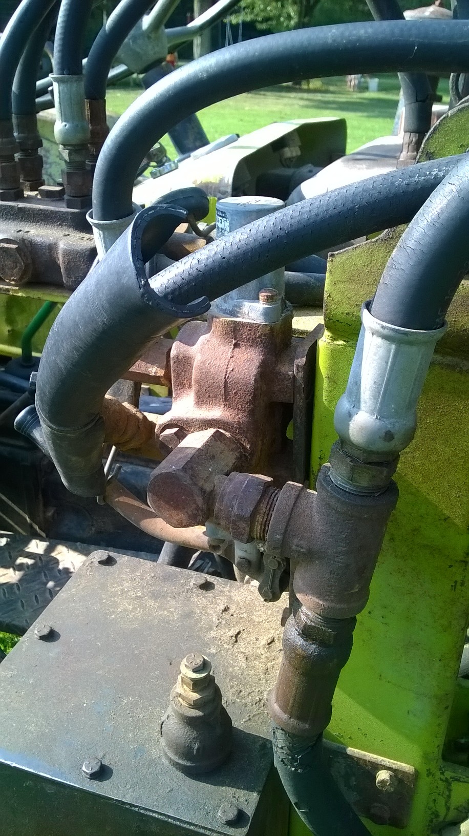

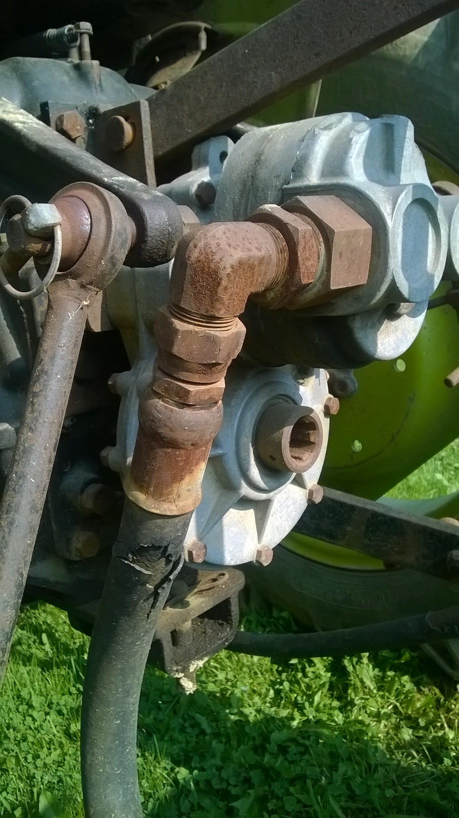

This machine appears to have been a giant mobile hydraulic pump/hose monster. In addition to internal 3PT hitch/loader hydraulic pump, there is the PTO mounted hydraulic pump and reservoir, and an additional pump on the front buried below the battery. This 3rd pump doesn't appear to be connected since there's a 2" gap between it and a shafting coming forward from the engine.
My goals today are to get the fluids and filters changed (oil and hydraulic), reverse the front wheels to avoid trouble with the front-end, and get that PTO pump removed. Some of it's finished but lots of work remains.

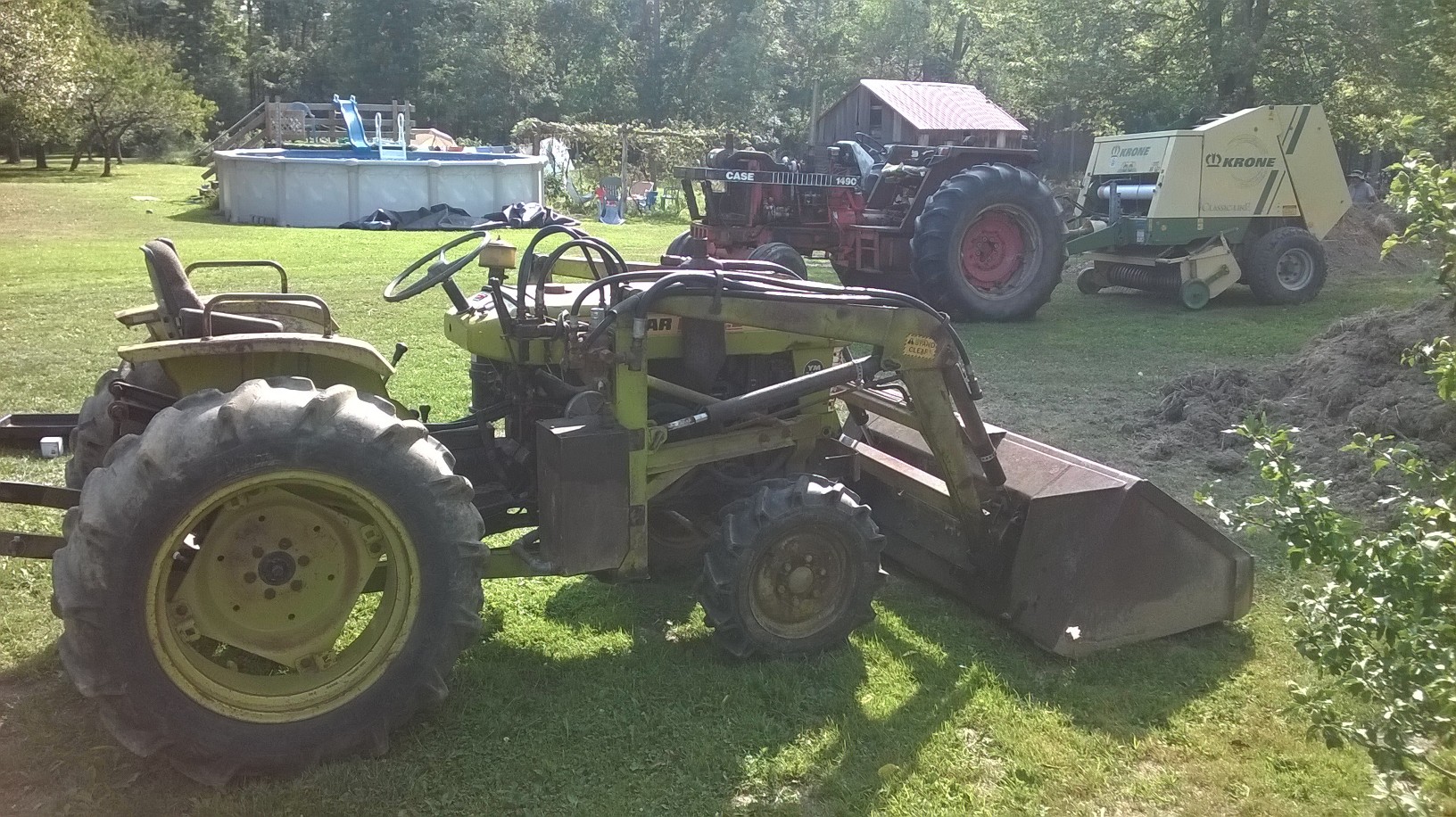

Here are some photos. WP_20150907_007.jpgWP_20150907_002.jpgWP_20150907_003.jpgWP_20150907_004.jpgWP_20150907_005.jpgWP_20150907_006.jpgWP_20150907_010.jpgWP_20150907_008.jpgWP_20150907_009.jpgWP_20150907_001.jpg

Congradulations. Thats a great tractor. Bet your glad you didnt already buy that plane ticket and go out to california!!!
I would remove that 3pt pump and hoses and put it in the shed. You may want it down the road or you could always sell it. I bet that setup is worth $400+?
Repack that cylinder or new boring or whatever it needs a d replace all fluids and filters including the screen (well just wash this in diesel unless its destroyed).
I would put new violent in radiator at 50/50. And clean the engine if you like. If the saw dust is oily in radiator I would spray some purple power or simple green on it then hose it off. If you use pressure washer on radiator use a light fan spray and or lower engine speed and spray from the front to not fold the fins over. If you want to clean the engine with the PW do so I just wouldnt go crazy with it.
Put a new fuel filter in it also. And if you have an axillary hydro filter do it as well.

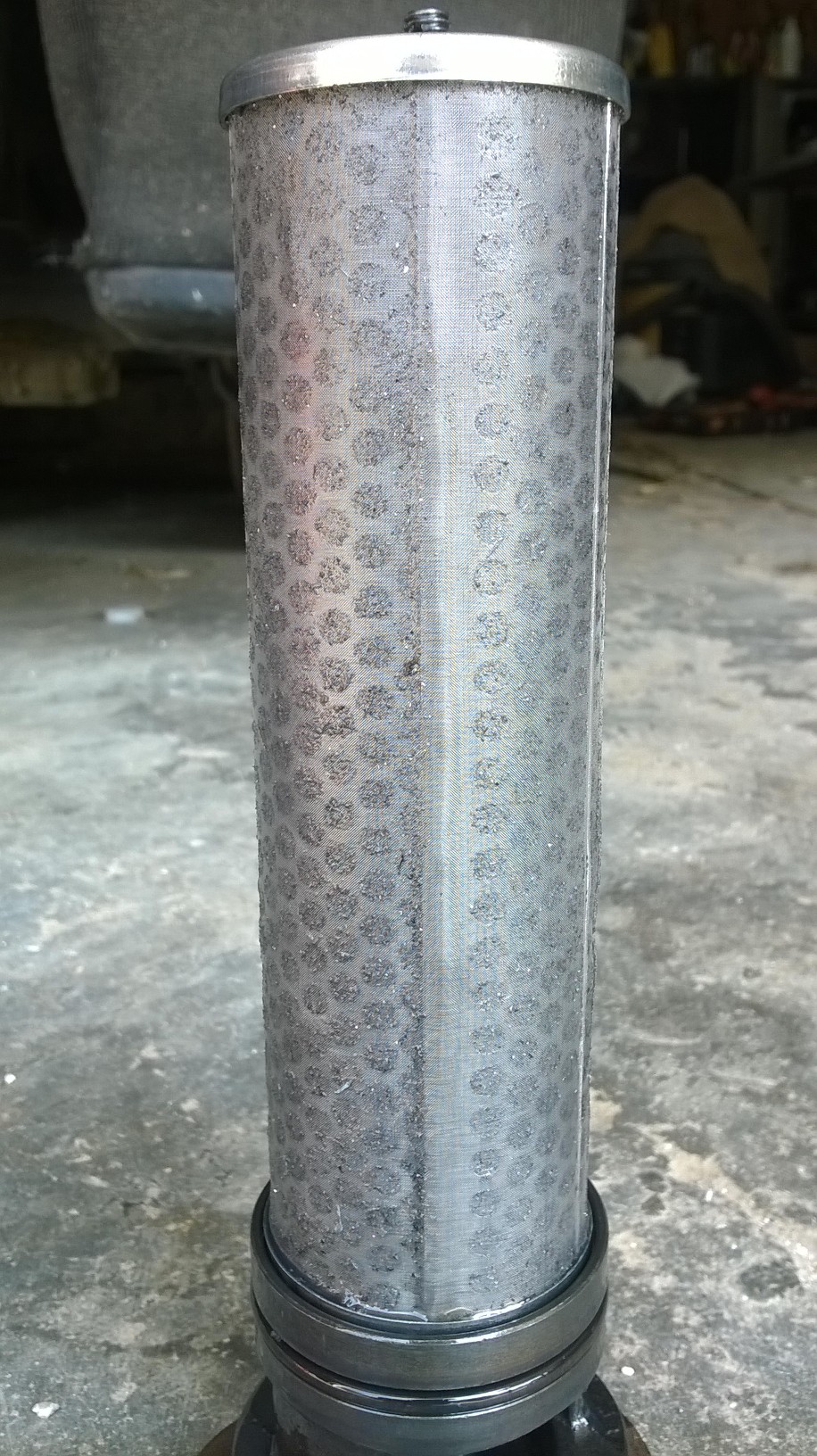

I changed the oil and hydro fluids and filters today. That went reasonably well, especially considering it was my first time doing it. I still need to flush and replace the coolant- should there be an overflow reservoir on these YM240s? I need to spray off the screen and radiator to get the saw dust out of it. I'd also like to drain and replace the oil in the front axle. What type of fluid should it be?
The bucket on this loader is enormous. It's nearly 6' wide and close to 24" deep. I suppose for dry sawdust it may have been fine, but the loader can't even get close to lifting it with dirt. I'm concerned there might be more to it than simply too heavy. Anyone care to guess what the lift capacity should be at the pins? The metal on the bucket isn't all that thick (probably 1/4" or less) but it could easily weigh 300lbs. The loader can lift me (150#) and the bucket but it doesn't seem to be able to lift any amount of dirt.

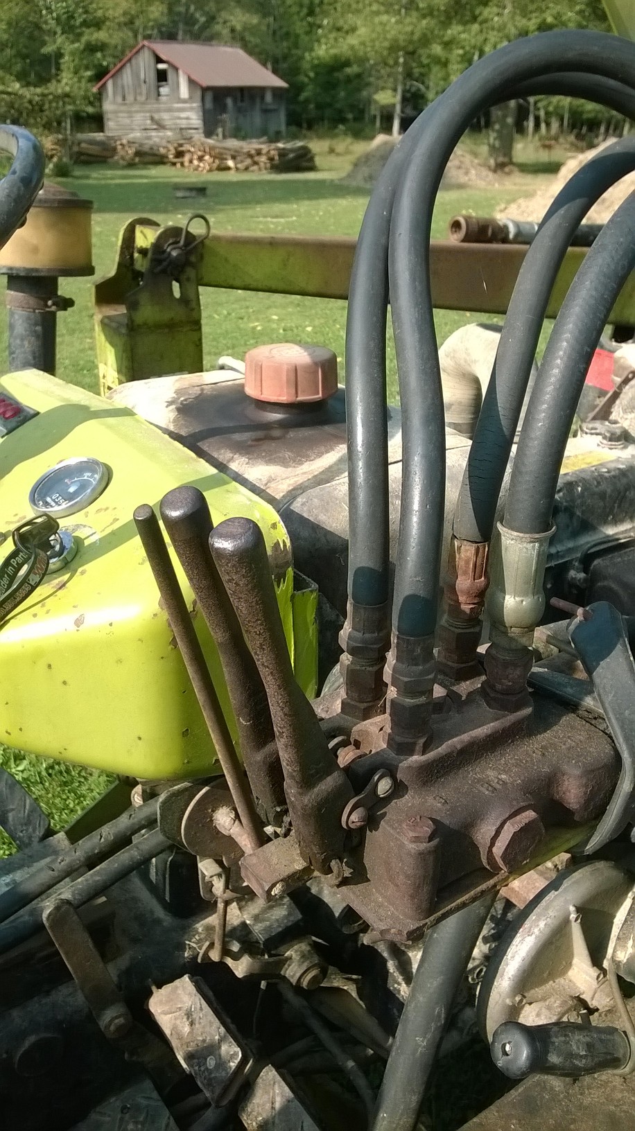

Where should I begin diagnosing the hydraulics? This tractor is going to be an education but I think she's going to be a good work-horse once I get a few kinks worked out.

She is going to look a lot better with all the excess hydraulics removed. That bucket is much to large for dirt work. No idea whether it would work or not but might advertise for a bucket trade on Craig's list.
Fredricks puts some koyker 120 loaders on the ym2000d tractors. Just thinking your loader might be comparable but don't know for sure. Something to ponder anyway. 120 Koyker loader loaders specifications

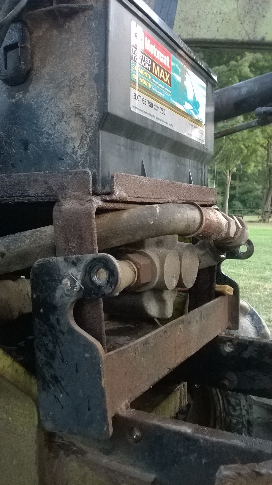

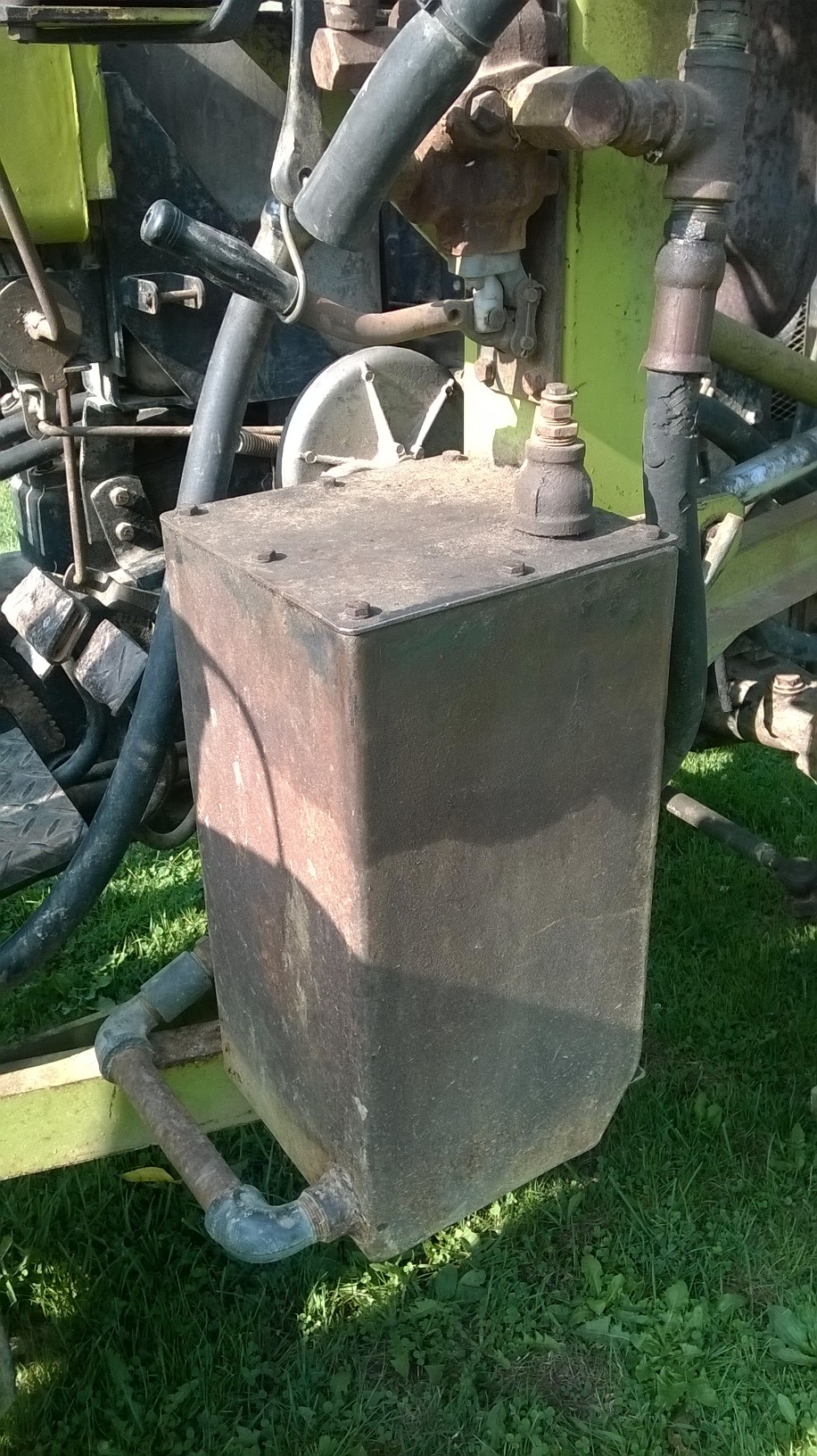

I like this idea. I need to figure out how to get that plumbed. Behind the front pump, sticking toward the engine, is a small shaft with a flange on it. Sticking forward from the engine there is also a shaft with a similar flange on it. The two look like they could mate together but there is currently about a 2" air gap separating them. So the front pump isn't actually running at the moment. It's a tricky place to take pictures but I'll try to get a photo of it tomorrow.
The front pump has two large lines that run over to a reservoir mounted on the righthand side of the loader. One enters the top through some disk shaped structure, the other exits the bottom of the reservoir. As far as I can tell that's all the plumbing there is for this. I don't see how/where it was actually being used. Maybe it never was? The loader control valve is fed by two lines that run along the center of the tractor beside the gear shift and end up in a small metal box with a metal line that runs into the top portion of the 'transmission' for lack of a better word. I should add that the hoses on the front pump are significant- 3/4" or maybe 1" OD. The lines that run from the rear-end are much smaller- 1/2" or 3/8". I only mention this because breaking into the that line and hooking it to the loader control valve would involve stepping down the pipe diameter, if I wanted to keep that controller. If I were to undertake this I might also try to get it setup so that the loader could be removed from the machine. Right now there are no quick couplers so removing the loader isn't really feasible without deconstructing the loader setup.

My pleasure. Here are a few more showing the tractor with the front wheels flipped so they aren't so wide anymoreWP_20150907_011.jpg, the hydro-frankenstien and tertiary hydro reservoir (the second was mounted on the 3PT hitch which I removed)WP_20150907_013.jpg. The upper, dual valve is the one that operates the loader. You can sorta see the difference in hose diameters in this photo. And finally, a not-so-great shot of the pump that's out front, below the battery. WP_20150907_014.jpg

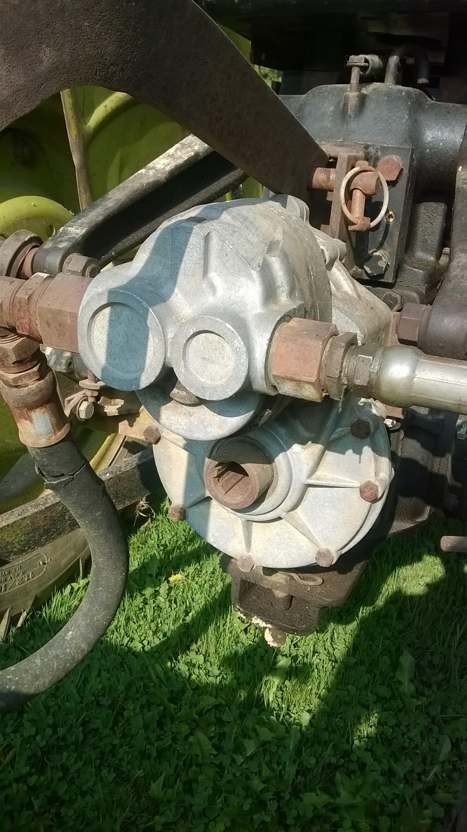

That PTO pump looks in decent enough shape - no fluids seeping out of it anyway.
Bottom line is your probably going to have to run it a bit to see what pops up.

Todd8665 made a good suggestion about testing the pump by putting a load on the rear 3PT hitch. I'll do that today and confirm that the pump is working correctly. The next step in getting the FEL sorted out will be repairing the dripping cylinder and possibly any others that are leaking internally. Once I'm convinced that the hydraulics are operating correctly, I'll have to address that bucket. It's ridiculous really! But if I can get it to lift 1/3 or 1/4 of a full bucket I can at least use it while I figure out how I'd like to get it setup.
Ideally, and if money and time were no object, I'd get that front pump going and plumb it with some quick-connect hoses for simpler removal and put a skid-steer quick attach plate on the front with a 48" bucket. Is that absurd? My PTO hydraulic pump, reservoir, and filter are officially up for trade! ;)

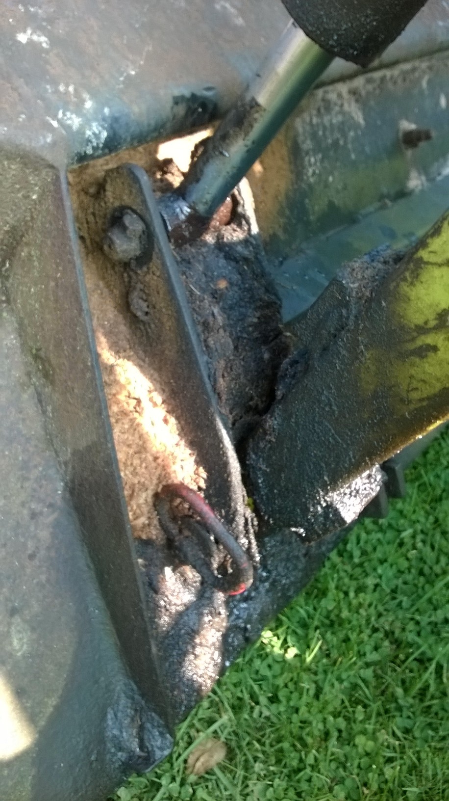

For the first cylinder they told me the rod was bent so they went ahead and straightened it. They said that's why it wore out the end cap seal, and the straightening was why the bill was double what I thought was a firm price.
I hadn't noticed that but a bent rod is possible, the end cap where the rod goes in contacts the loader arm at full-dump position and the concave dings on the back side of the bucket indicate the bucket must have been turned forward and used to ram things in the past. So bending parts is possible.
Anyhow I didn't see a bend in the second cylinder's rod and its problem was leaking down, not the end seal, so I just disassembled it and took in the soft parts. They went right to the shelf and pulled what I needed without looking in a book. Apparently there is a limited range of possible choices and these cylinders are industry-standard so their first guess for seals was correct.
For the hydraulic components of your rig you might want to post questions in TBN's Hydraulics forum. I got a lot of good advice when I went to replace my loader valve. It lifted ok but dribbled on my shoe under extreme loads. It was clearly worn out and I learned there aren't replaceable parts in those. In fact somebody in the Hydraulics forum might want to buy your surplus system, that's where the specialists hang out.
Added: just noticed your latest posts.
The stock Yanmar hydraulic pumps put out 4~5 gallons per minute (I think that's gallons they are rated in) and the existing loader hoses were I think 3/8 ID. So based on advice from the hydraulics forum somebody suggested a specific control to meet these criteria. That one is rated abut 9gpm and comes preset to the 2200 psi that Yanmar uses. I think these criteria are industry-standard for a tractor hydraulic system comparable in capacity to Ford 8N etc and the valve I took off was in fact widely used on 8N's back in the day. So choice of a valve fell in a narrow range of widely used replacement parts.
Then I cheapskated two features: Saved $100 for two loader sticks instead of single joystick. Saved another $100 by choosing the variant that lacks 'recirculation' or whatever it's it called that doubles bucket dump speed. I'm not trying to set production records. Moving that lumber or water tank is more typical of my loader projects.
The valve was available several places with a few weeks lead time then I found Amazon had it on the shelf to ship immediately. If you've looked through that thread you can skip over all my know-nothing questions and get right to the solution I ended up with, after a lot of good advice.
One point - there is a specialist there who insists plumbing a loader in series ahead of the 3-point will destroy the loader valve. Mine ran fine in series for 30 years and the new valve remains in perfect condition after a couple years use. The point to remember is don't lift the bucket and the 3-point at the same time, this can double hydraulic loads momentarily and does risk damage. Thoughtful sane operation respecting the limits of the equipment will avoid problems.
