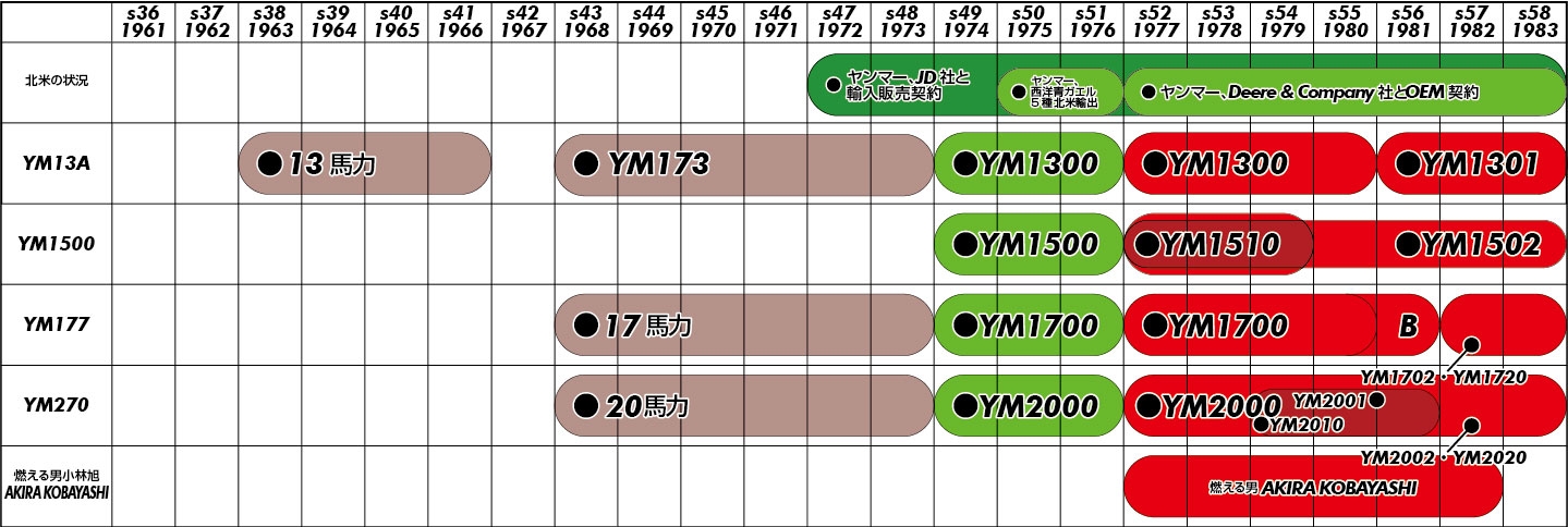

You have a YM1700BD. Originally made in 1977 thru 1982. After it was used in Japan, it was sent here as exported to the west coast. From there, a small outfit would then work on the machines to restore the machine. Some outfits were better than others.

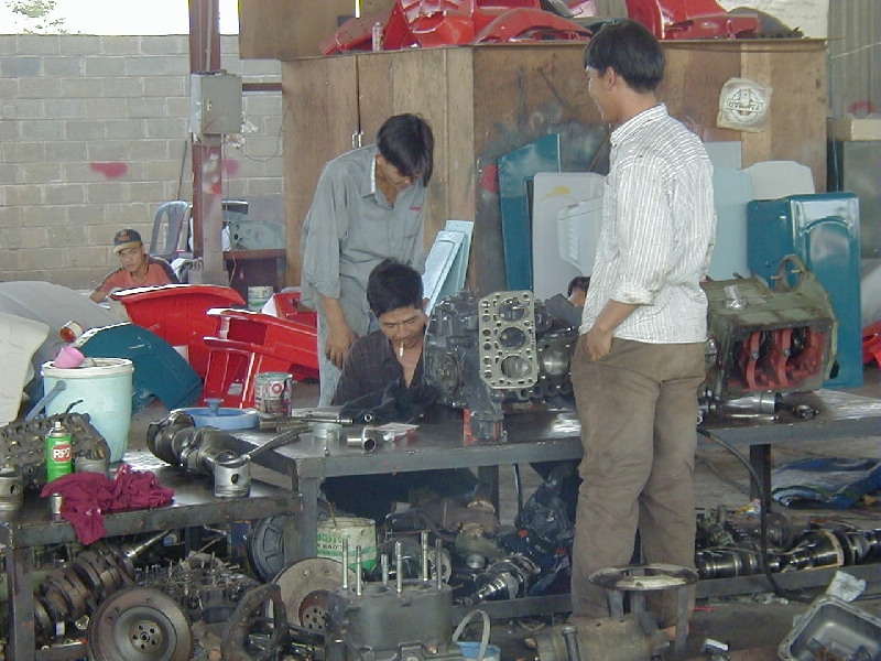

Well almost. Most of the Japanese Yanmars brought over several years ago were first 'reconditioned' and repainted - museum quality paint job - in VN. Likely following a second life there.
Photos I copied off Tractorco's website back before Yanmar-USA sued the US importers and mostly shut them down:
build-station-jpg.805658
enginerebuilds-jpg.805659

You say inherited, do you know when it was purchased in the US? Most of those were brought over about 1998 to 2010(?), at which time Yanmar-USA lost a liability lawsuit, and choked off import of used Yanmars that had never passed through their hands. Only Fredricks in Alabama escaped that lawsuit, and continues to import/refurbish top quality used Yanmars. If you happen to have one of theirs, you won the jackpot!
Yanmar quality is so solid that a rebuild anywhere likely comes out as good as new.
There have been cases posted here of 'Frankensteinmars', assembled with parts from various models, but you are not likely to encounter that with a YM1700 because there were so many of them.
Those shop photos likely show swapping parts around to build tractors where everything is within spec.

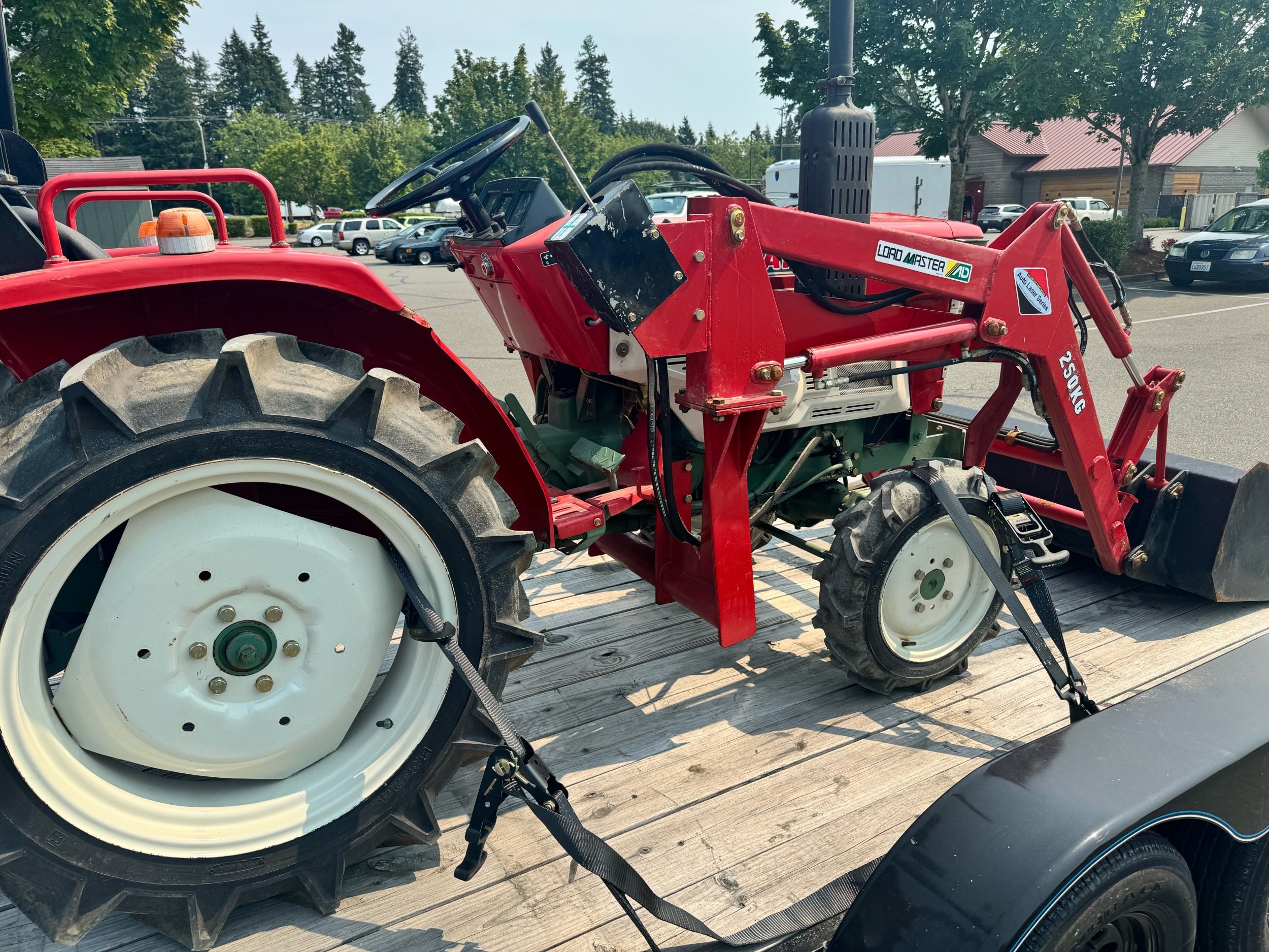

Finally was able to get a couple
Of pics up. I'd appreciate any and info any of you could pass on to me now that you've seen a couple Of pictures. Happy to put some more up if you'd like to see some specific things. Thanks in advance, again!!

Had to look hard but you can see the Red Yanmar on the Hood side decal. Just before the YM 1700BD. Behind the Loader arm. I have that same Decal for the YM2000 I was able to remove. Intact! Muffler side was in terrible shape. I say 1977. Pretty sure without much doubt your 1979 so that's Org. Very :cool:

Nice location. Not far from Fredricks Equipment which is a big plus. The parts for the YM1700 BD should be well supported by them.
