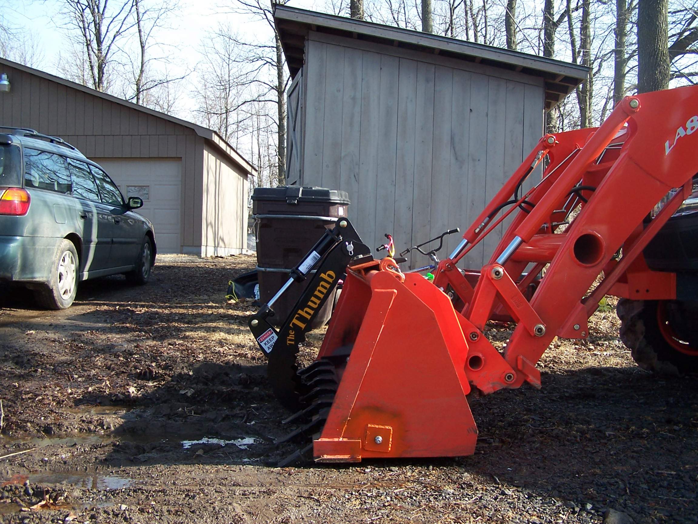

I wanted a grapple of some sorts but couldn't justify a full grapple.I added a Green's Machine Thumb and a tooth bar to my bucket.That combo works very well for me;the only down side is that it doesn't open as wide as a full grapple.
Great for brush piles or logs/firewood.
This looks like the set up I will need. I'm afraid I will need to do a QA as well. leonz-the back hoe is not on the 3pt. has a frame that runs all the way under the tractor. What are you speaking of when talking about not adding some type of grapple? I appreciate the help...I do have a rear remote, so..just need to educate myself as to the best way to go about this. Wifes gonna be so dang happy when I tell her I need to spend about 2 more K.

Factory third function was about $800 when I had it done;Green's Machine Thumb was $400 and I did that install along with the tooth-bar(maybe $150).
I have picked 20'long by 20" diameter hard wood logs with ease;primary use has been for gathering brush and it works like a charm(wish I had taken pictures).I can pick up a 1" thick flat rock with no problem.
I like your setup and $1400 aint bad, if I could get it all for that. Alternative- I believe (assuming 8 to 900 to get her plumbed, maybe 3-400 if I do it myself) I would be most likely around 2k for the beast grapple that for sure has more capability..so 2.5-3 k...bout what I figured. Maybe bucket grapple for now and wait on a craigslist list grapple that's sure to come as soon as the Irma debris is done for. maybe one will hit CL by the time shes ready..aslo got to consider the attachment QA. I know this thing has handles like a quick disconnect but I think I read where the loader might not be compatible> If anyone has anymore info on the Branson BL20 FEL attachment head, I sure would appreciate it.
