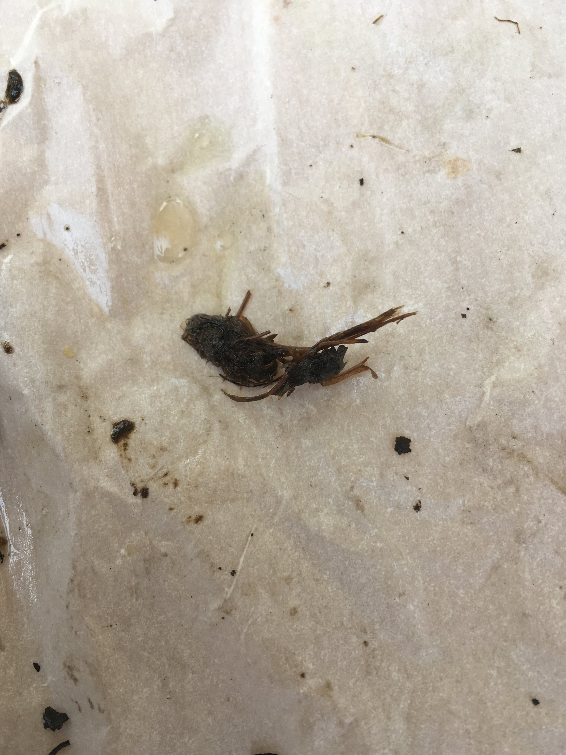

   / New to me TC29D cranks & won’t start #90
A bug in the fuel pump will cause that.
