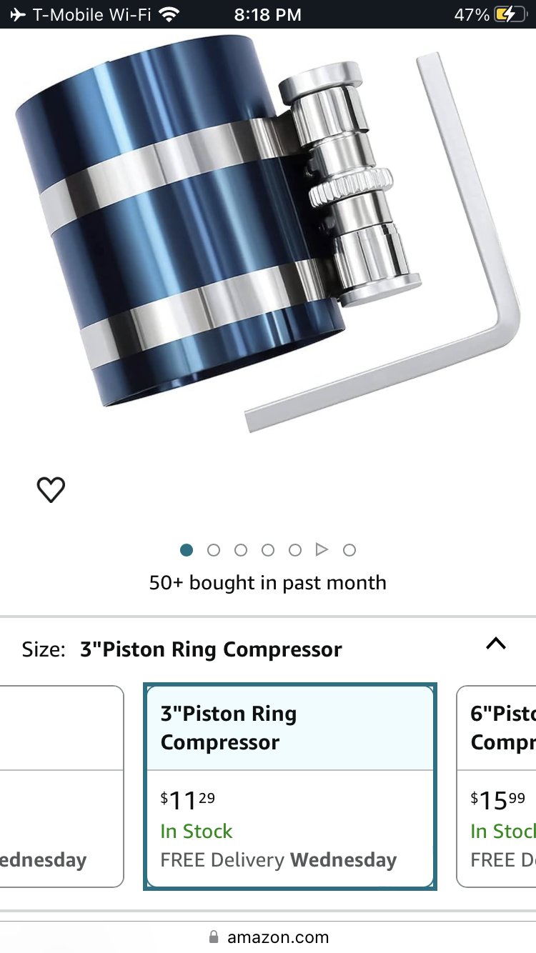

I’m watching YouTube videos with my free time tonight and this weekend. Any good ones people would recommend let me know regarding measuring cylinder removal ring replacement etc
I had the same thought referring to leak down test maybe being un necessary, knowing I have blow by and almost for sure low compression. Will retest once I get another gauge
Shopping list below sufficient or too cheap?
3” cylinder?
Also is a ridge reamer the same as a cylinder hone??
No. Ball hone in 2nd pic OR stone type hone in 3rd pic. IMO ball hone is easier to use and less likely to take off too much material.
Example ridge reamer:
May want to look at the "deck height" spec for your engine before buying one though. If zero or close you don't need one
