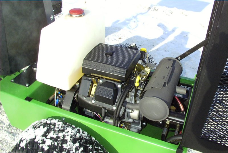

I have a 2001 PT425 with the Kohler engine. My muffler is a factory Kohler muffler that exits directly out the rear. I've never had an overheating issue with this setup.
How is your engine compartment laid out?
After you get a few more post (5, I think), you can post some pictures of it.
/ New to me PT 2425
My engine compartment is very similar to yours, instead of the seat hinging back mine hinges over to the passenger side. Also I don稚 have the plastic tank.
