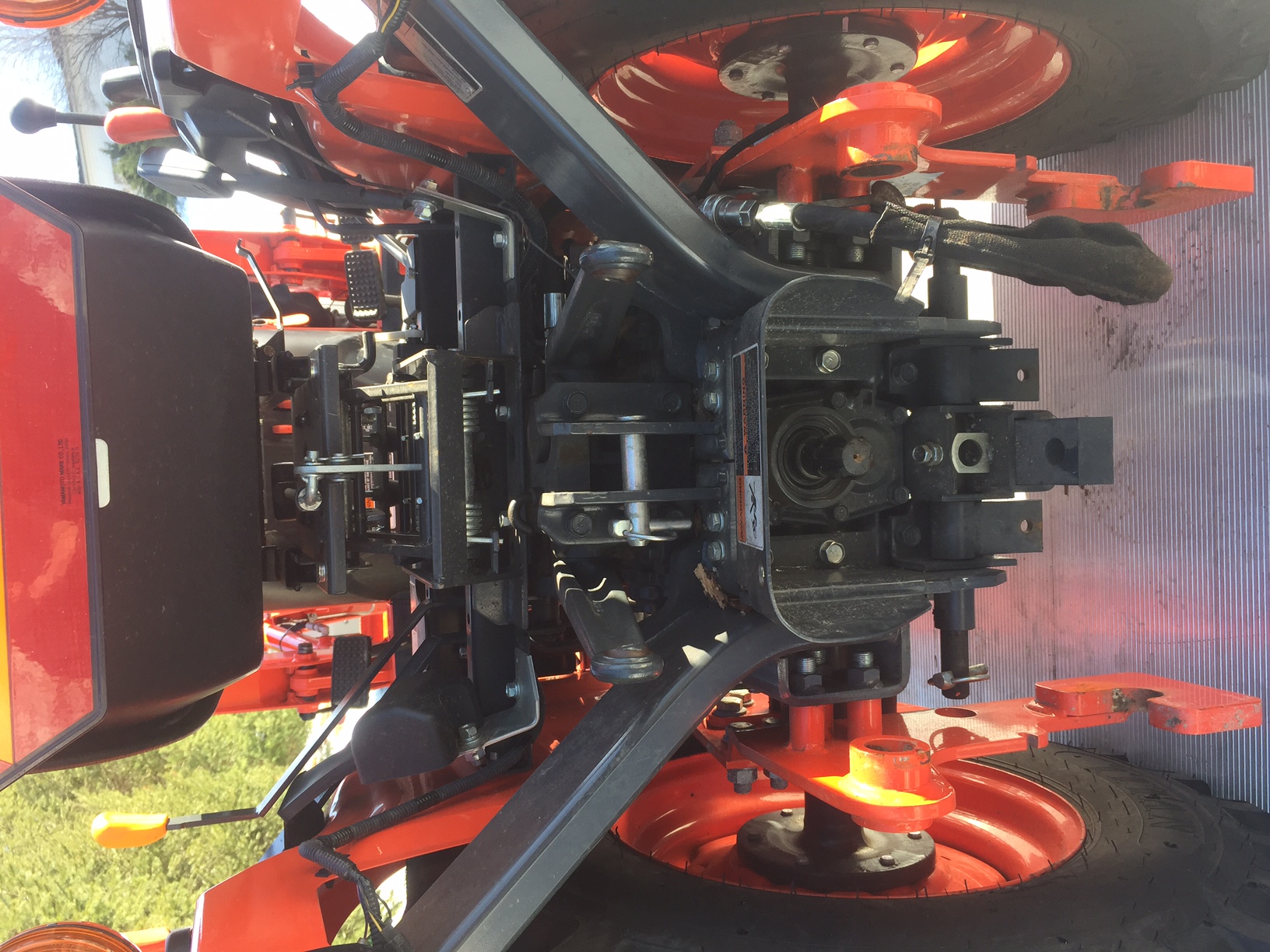

The only part I haven't been able to confirm will interchange is the verticle lift links because they weren't listed on the parts diagrams I found. Everything else will interchange.

I removed the backhoe today to get a better look and this is what I found. Some of the parts are there. The pin and spacers on the bottom as well as the draw bar are there. I'm hoping maybe someone will be able to tell exactly what I need from the photo.
