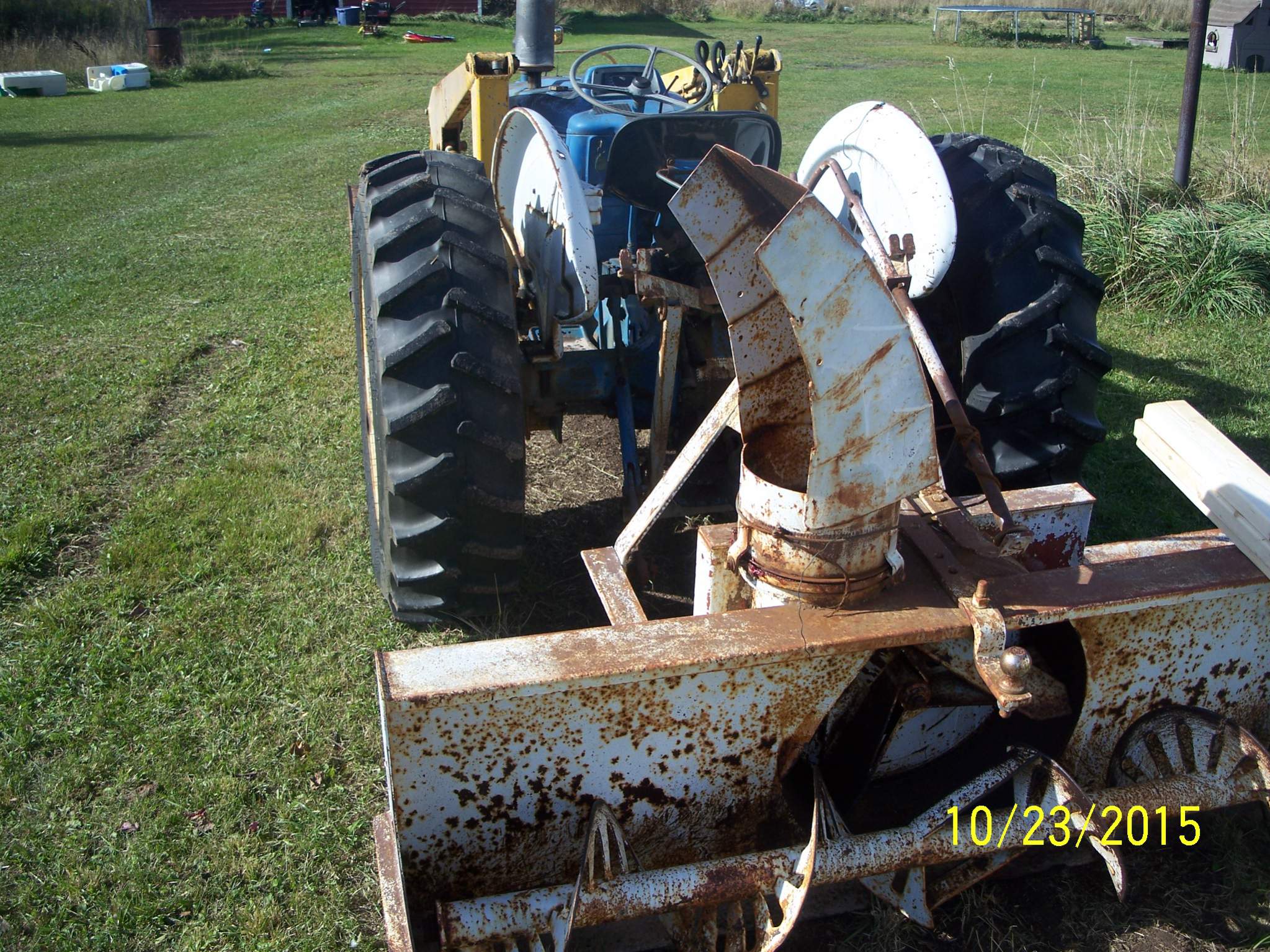

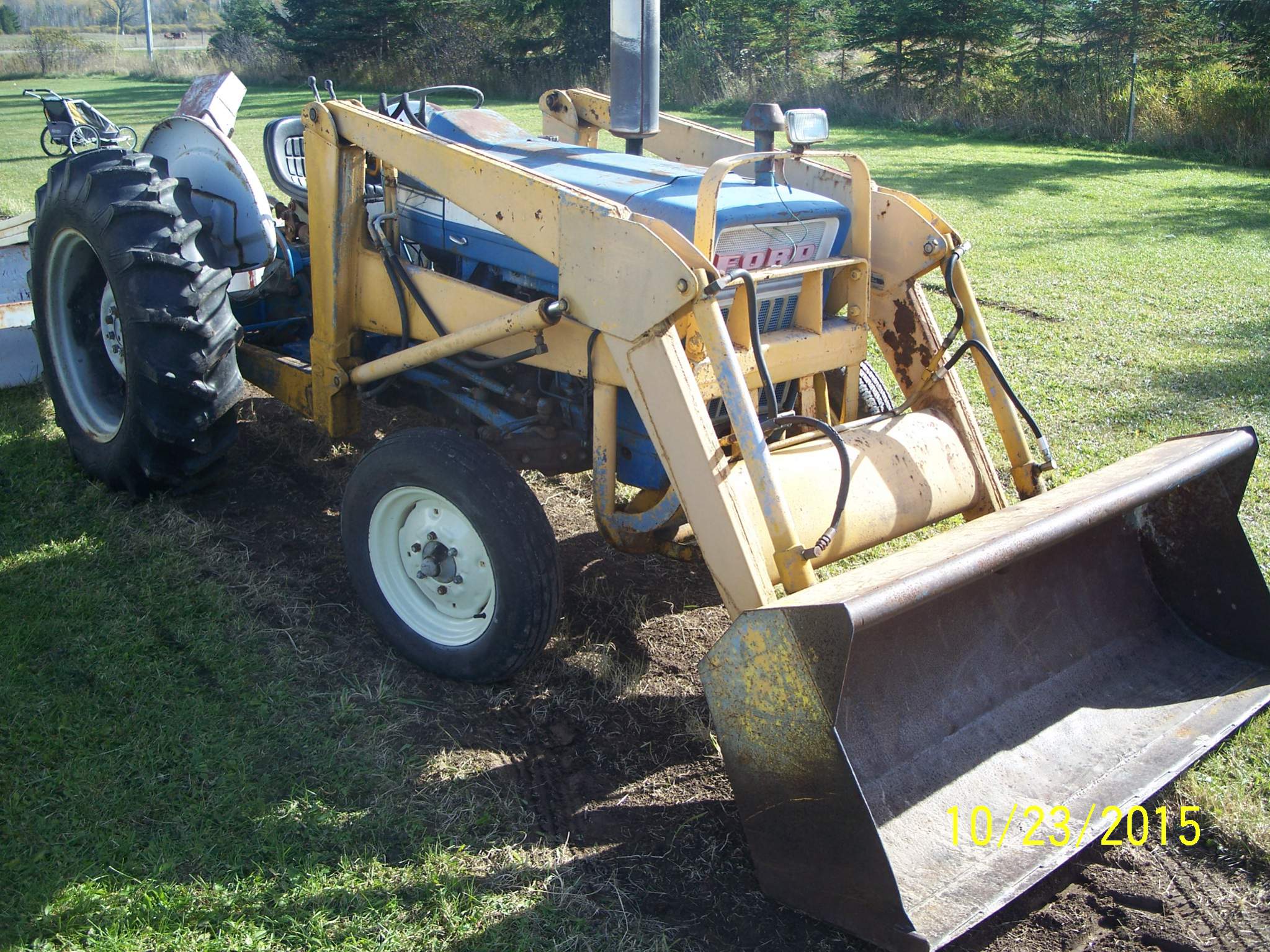

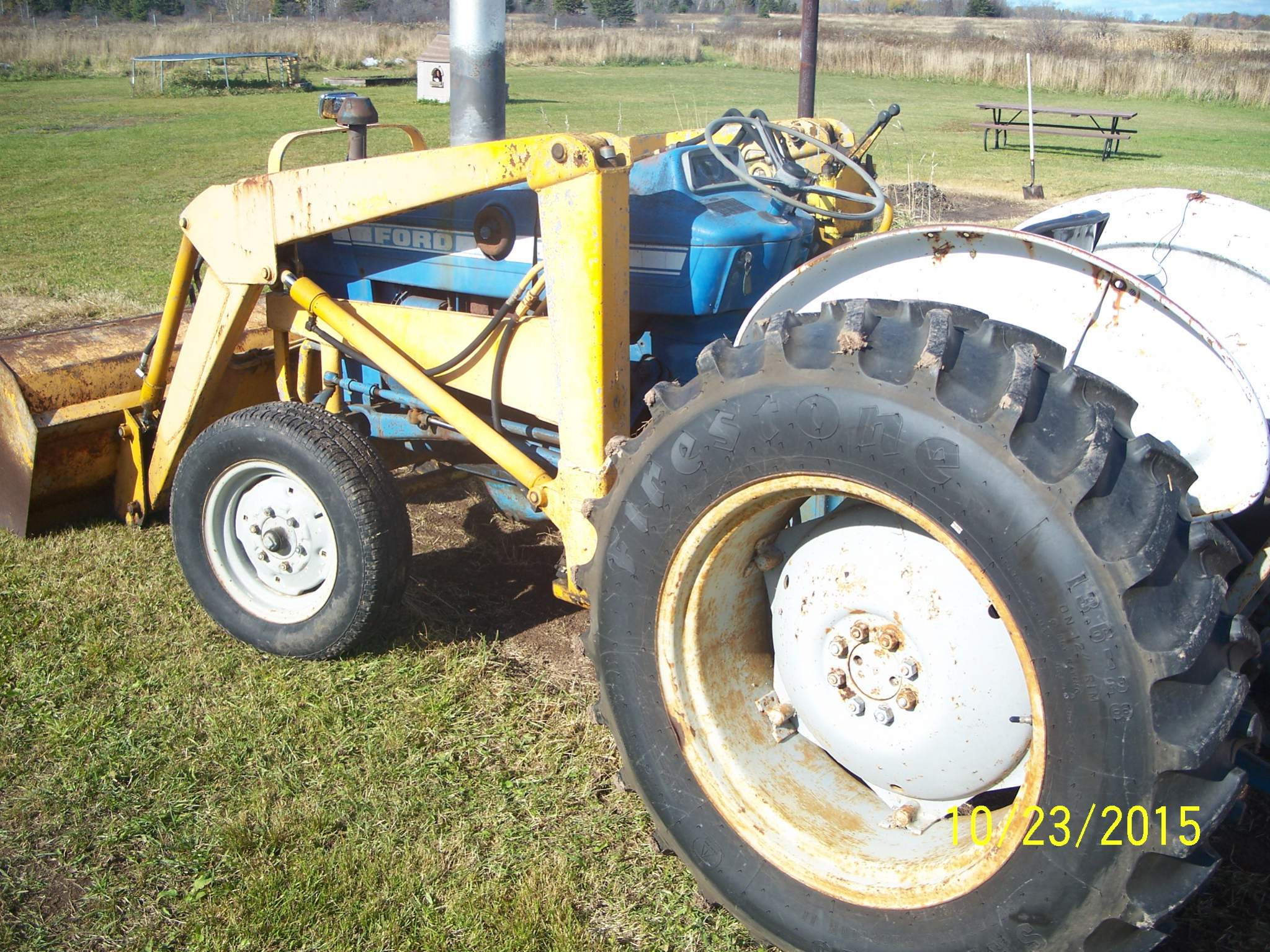

1973 gas 8 speed with power steering.
Also has a Ford loader and 6.5 foot snowblower.
Good rear rubber.

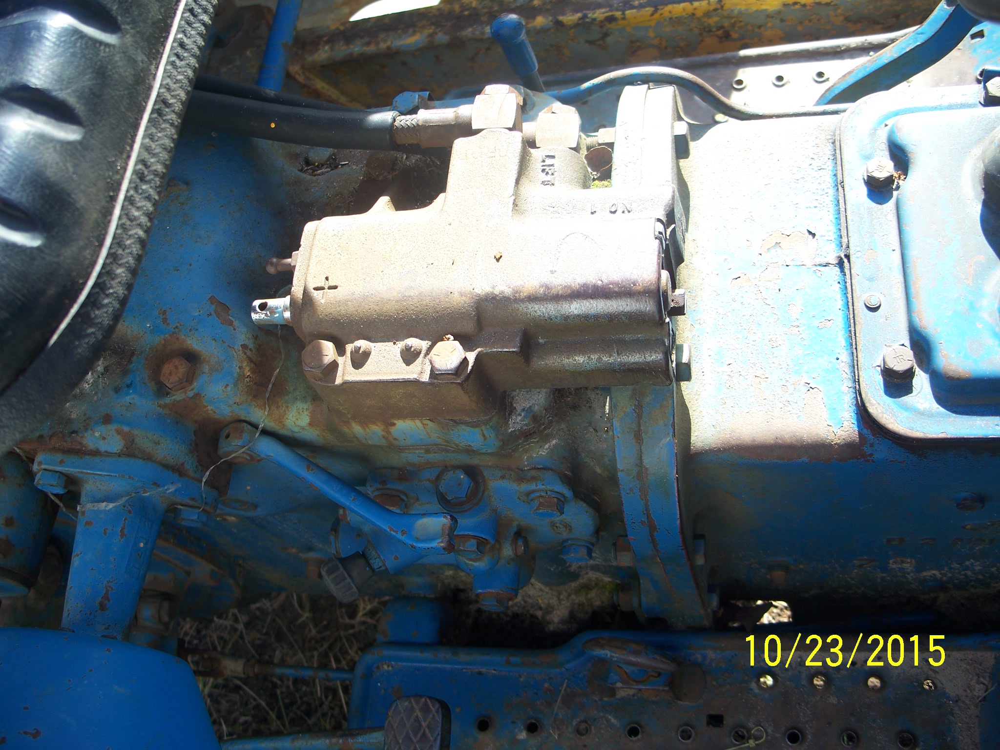

Has a control valve and one set of rear remotes. Haven't tested this, need a handle for the valve and a cylinder and hoses.
Not sure exactly how easy it is supposed to make steering turn, but it seems like once I strongarm the start of the turn it turns further pretty easily.
Needs steering tie rod ends.
Loader cutting edge is worn to the bucket at the outside edges.
Needs an exhaust manifold.
May need carburetor attention. Starts pretty easily. Occasional backfire when slowing rpms.
Tach needle is broken but center portion moves. No idea if it is accurate or not. Rest of the gauges don't work
3 point droops very slowly after shut off. The snowblower falls maybe 8 inches in 15 minutes.
$2700 delivered. How'd I do?

Would have been a great deal if it was a Diesel but for 2700. you still probably got your money's worth. Those are tough old tractors and there are plenty of parts out there for them.
/ New to me Ford 3000
Good. Winter is insanely cold and this machine's primary duty is snowblowing.
I only have ten acres and don't have any other diesel equipment.
I should be giving the loader a good workout over the next couple years filling in some low spots in the yard.

Change the fluid and filter in the Ps resv.
More revs help, especially on heavy front loads and worn pumps

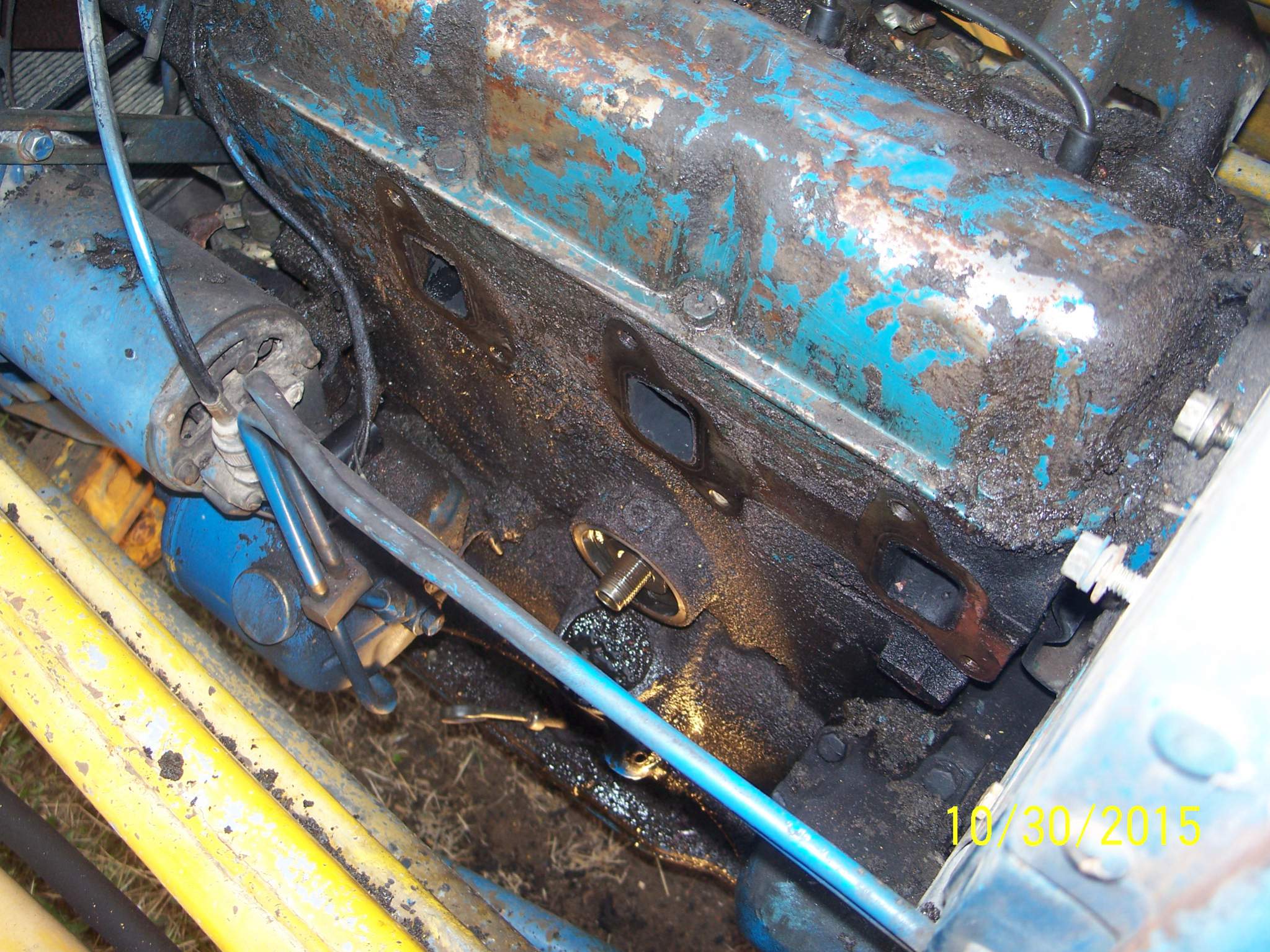

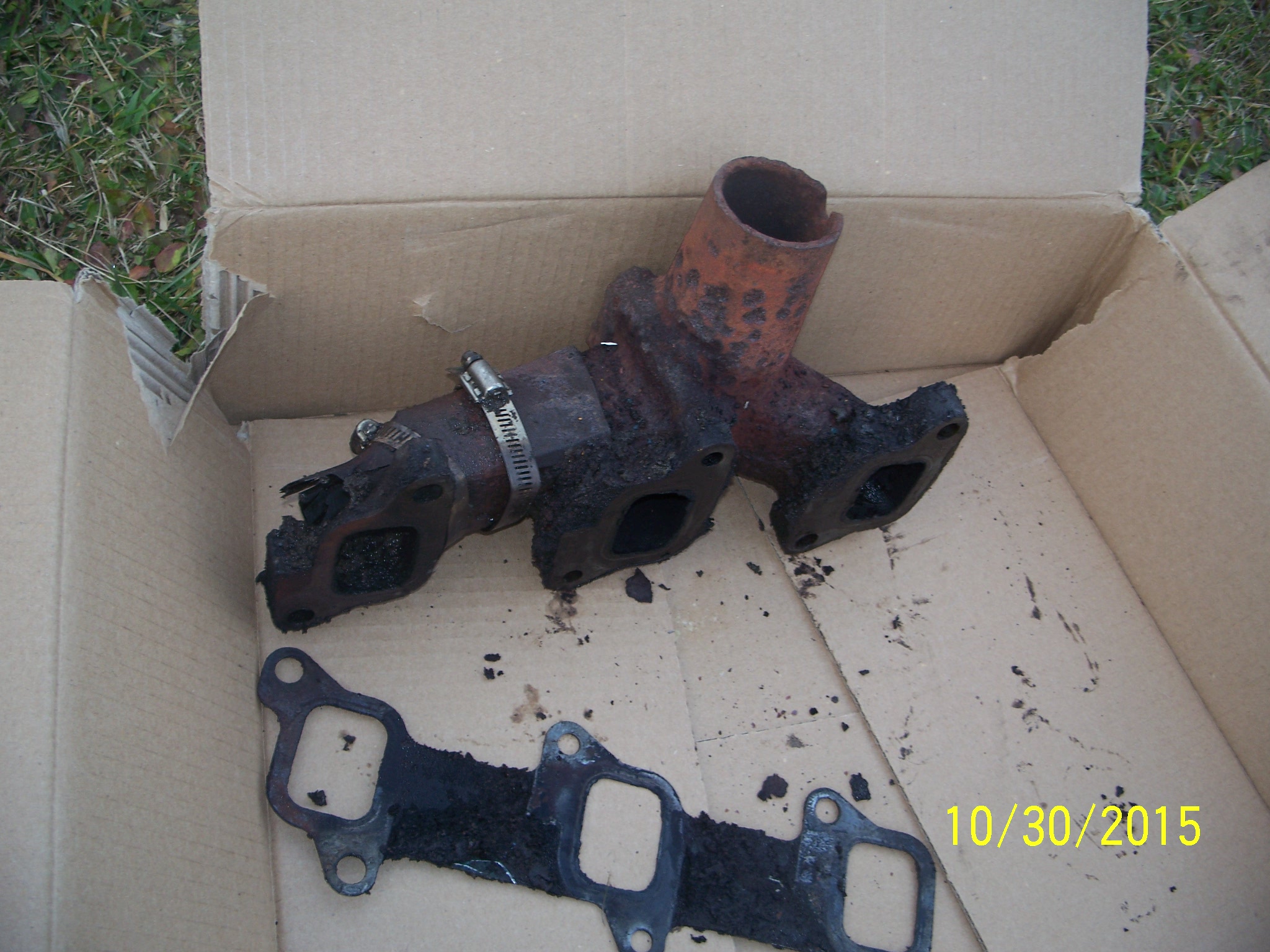

My replacement exhaust manifold and gasket came today. I took the top sheet metal off, scraped half a gallon of oil sands off the valve cover, and unbolted the old manifold. The bolt I thought I was going to have trouble with (half rusted head) came right out, but another was rusted oblong and rounded with the first try. I pounded the next smaller socket on and it came out fine.
No wonder it was loud.
Manifold removed but before scraping another quart of oil sands off the side of the engine. It's good and cleaned up, and I will be able to easily see a valve cover or head gasket oil leak now.
I hung the new manifold in place with two old bolts before running out of daylight. The new manifold came with very rough paint, full of crud, over the machined manifold ports. I wirebrushed the paint and crud off before putting it in place.

Things keep showing up in the mail. All that goop on the side and top of the engine was there because of a couple of cracks in the valve cover gasket that allowed a slow oil weep. The new one arrived today and is now in place
