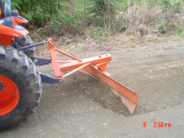

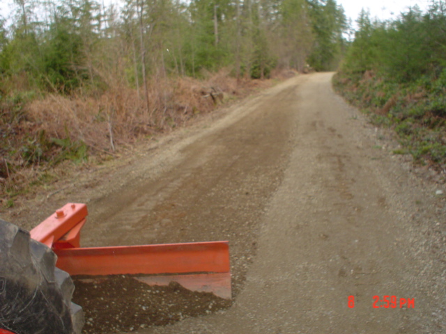

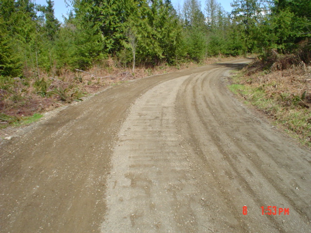

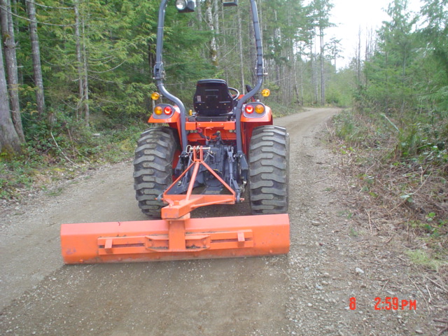

Last year about this time I bought a used home made backblade. It worked ok but you could tell it was home made, not the right holes for the angles etc. It was heavy 7 ft made out of ½ inch steel plate. Well a few days ago I scooped up a used one from Craigslist. I was the first one to call, got it for only $100.00. :D Tried it out today and it works very well, enjoyed my seat time doing our road. Here are a few pics of it working away, the good thing is I don't have to repaint it, already came orange. :thumbsup:
It is lighter weight than the other one, more weight is better???

Nice work:thumbsup: I noticed you have 6 foot box blade, how did it work for road maintenance.
/ New to me backblade #4
That was a steal with that offset feature. Talking about doing some serious side ditching you got the blade.

The boxblade is what I usually use for the road. There are a couple of areas that tend to go wavy on me. Have tried different ways to get rid of that. With the backblade I can now cut across the high spots, by angling the backblade, to get the road level. :thumbsup:

Nice blade. It doesn't look like it angles. But, you can always to that with your 3ph arm adjustment. Love the offset design. I have a woods and in order to offset it, you have to unbolt the whole blade and move it over. Quite the PITA.

This new blade does angle, 5 positons :D and can be turned backwards. The home built 7 ft I got last year could not be turned backwards. I will be putting this one up for sale today.

I mean angled relative to the grading plane. Thus, allowing you to mound/trench. Most such blades angle left/right/all-the-way-round as well as up/down to one side or the other. They can be adjusted 2 axes. I don't see how your blade supports up/down grading angle adjustment; it's simply flat relative to the plane the tractor is setting on. A lot of blades are like this. In such cases the angle can be adjusted by changing the length of the right 3PH arm using the crank handle on it.
#11
I mean angled relative to the grading plane. Thus, allowing you to mound/trench. Most such blades angle left/right/all-the-way-round as well as up/down to one side or the other. I don't see how your blade supports up/down grading angle adjustment; it's simply flat. A lot of blades are like this. In such cases the angle can be adjusted by changing the length of the right 3PH arm using the crank handle on it.
Sorry I misread your post. :( Yes the right (looking forward) 3 pt arm has a crank on it to angle the blade up or down (left or right) That way I can put a crown on the road or dig a ditch. :)
