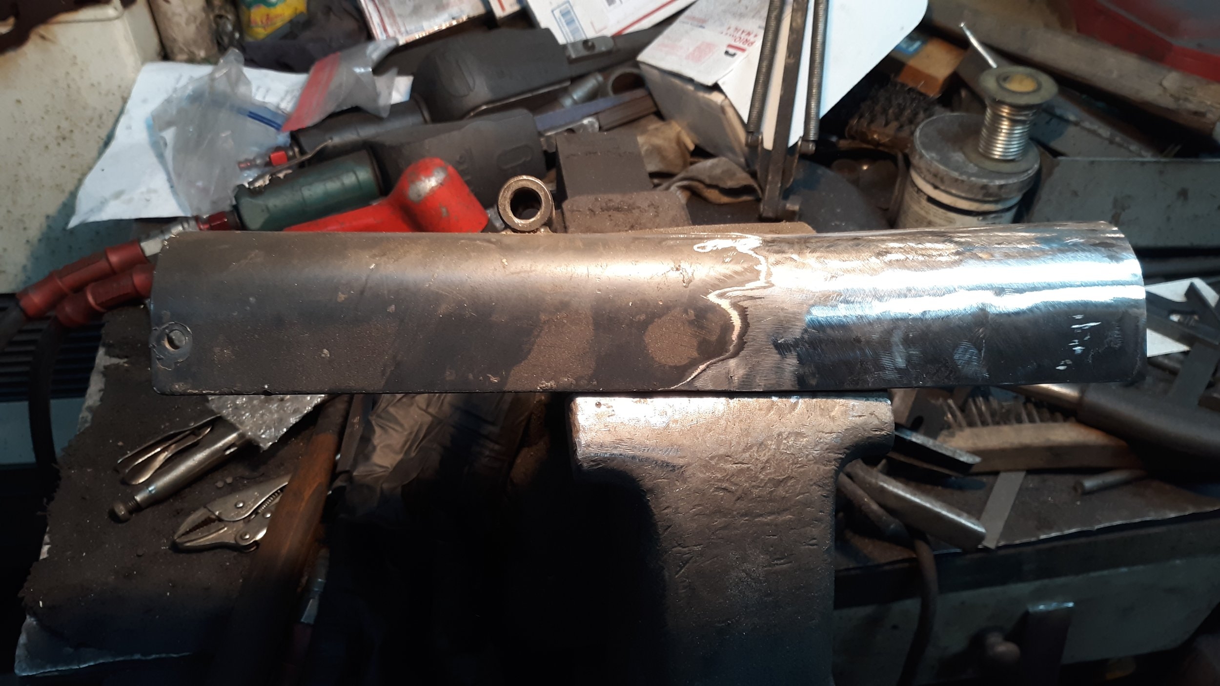

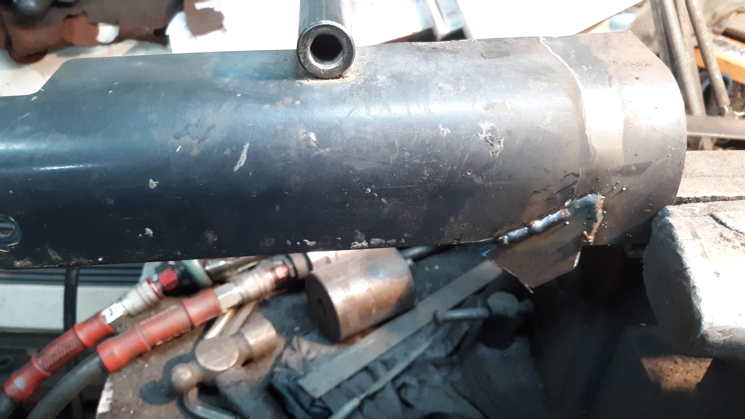

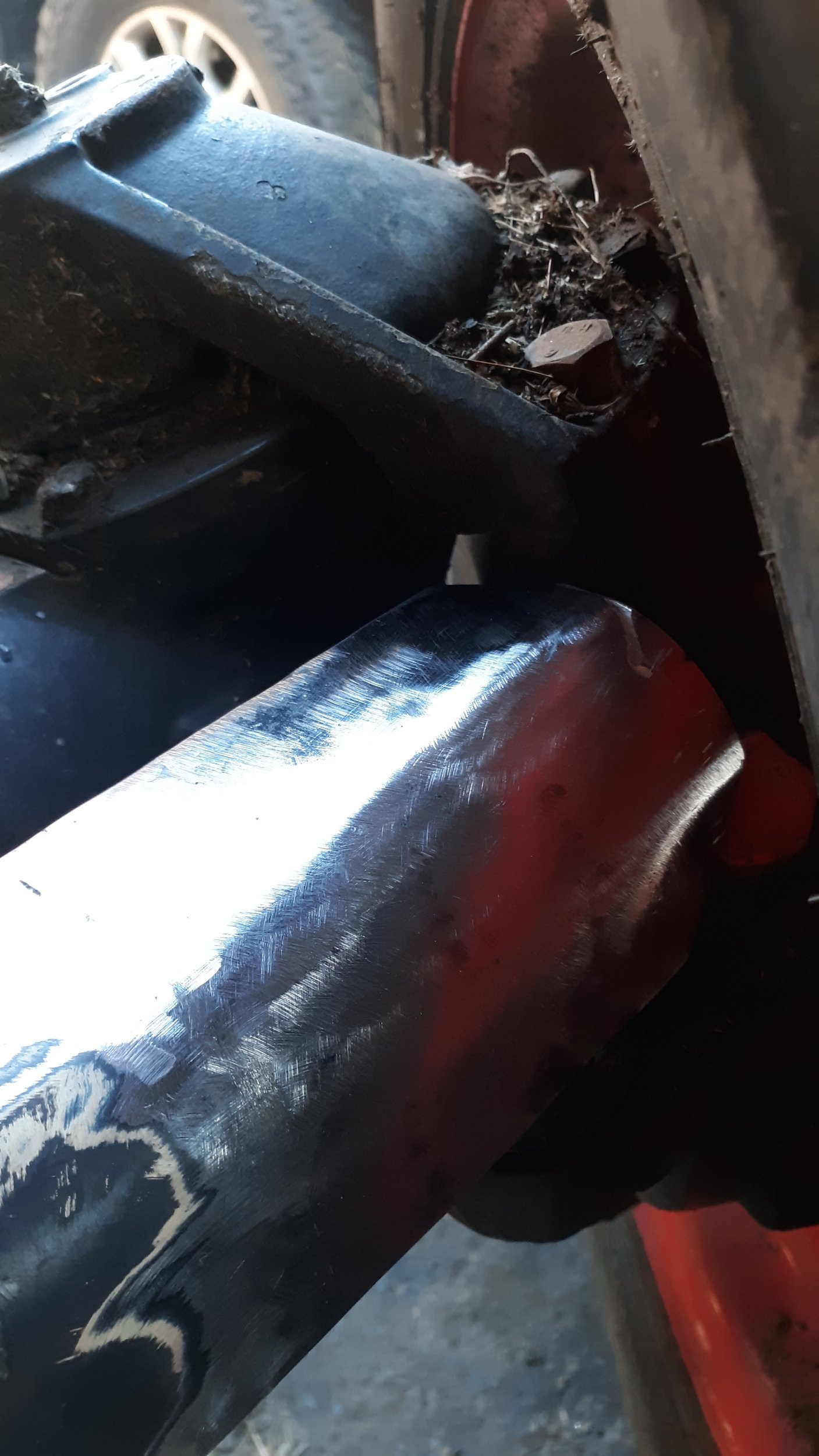

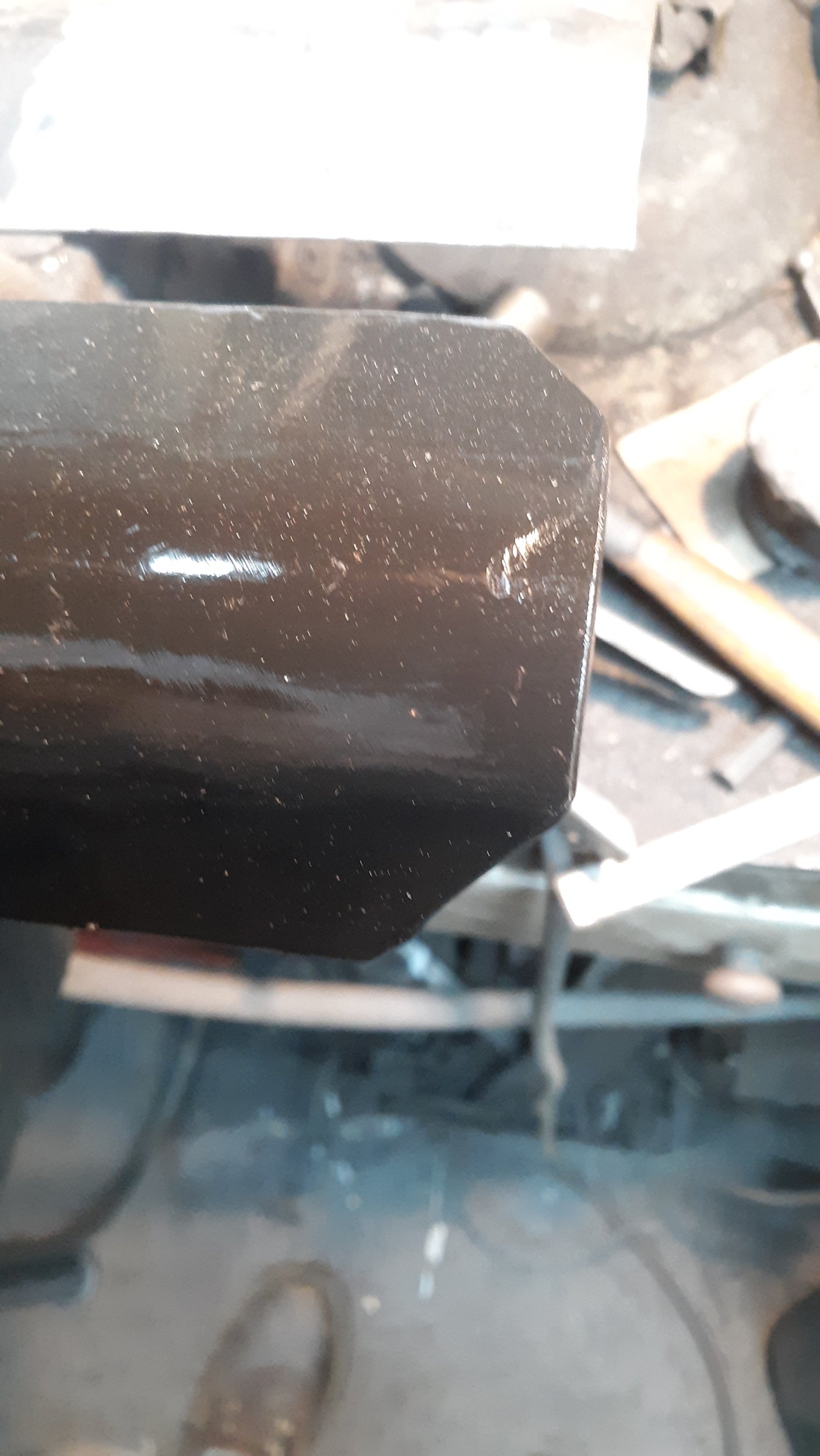

I finally made the new guards for my NX4510HST. I couldn't find a local fab shop to bend me up two pieces of 1/8" thick by 4.5" wide steel plates to match the contour of the original design. I bought a piece of 1/8" x 1 1/4" x 36" steel. Using my bench vise and a 2 1/2" OD socket I made up 8 pieces. Next task was to weld them all in place one by one. I also had to fill in the original angle cut in the guard. All edges were beveled for a better weld. I then cut 3/4" off the final length. Overall length now is 13 1/2". The ends have 2 45 degree angles cut. Top one 1.25" long. The bottom one is 1.5" long. If you don't cut these you will hit the steering knuckle on the top and bottom of the guard. These will work on all of the NX series tractors. The pictures show the wheel with a full turn in and full turn out. The tie rod rubber is now protected. Next project will be to make a piece to cover the underside. That should be simple and just a 90 degree bend full length and screwed to the face of this guard at the bottom edge. More on that when I get around to it.

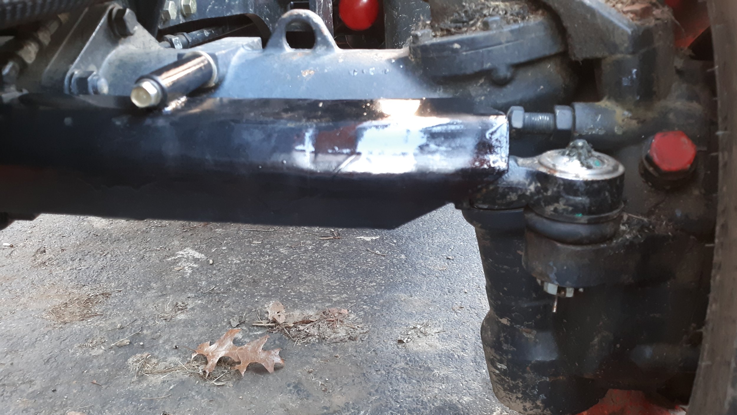

Update, the left side tie rod hit on the inside of the extended shield when turning the tires to the right. I modified both to fit. The top angle was cut to 1 5/8" long. The bottom angle was changed to 30 degrees and the cut was 2 5/8" long. I also added two 3/8" washers behind the guard for a little more clearance. What was weird is that the right side guard would have cleared without the added alterations. It appears to be welded to the mount slightly off from being square. This offset was enough to clear the outer tie rod. Oh well I had already modified them both. Here is the left side mounted with the tires pointing straight forward.
