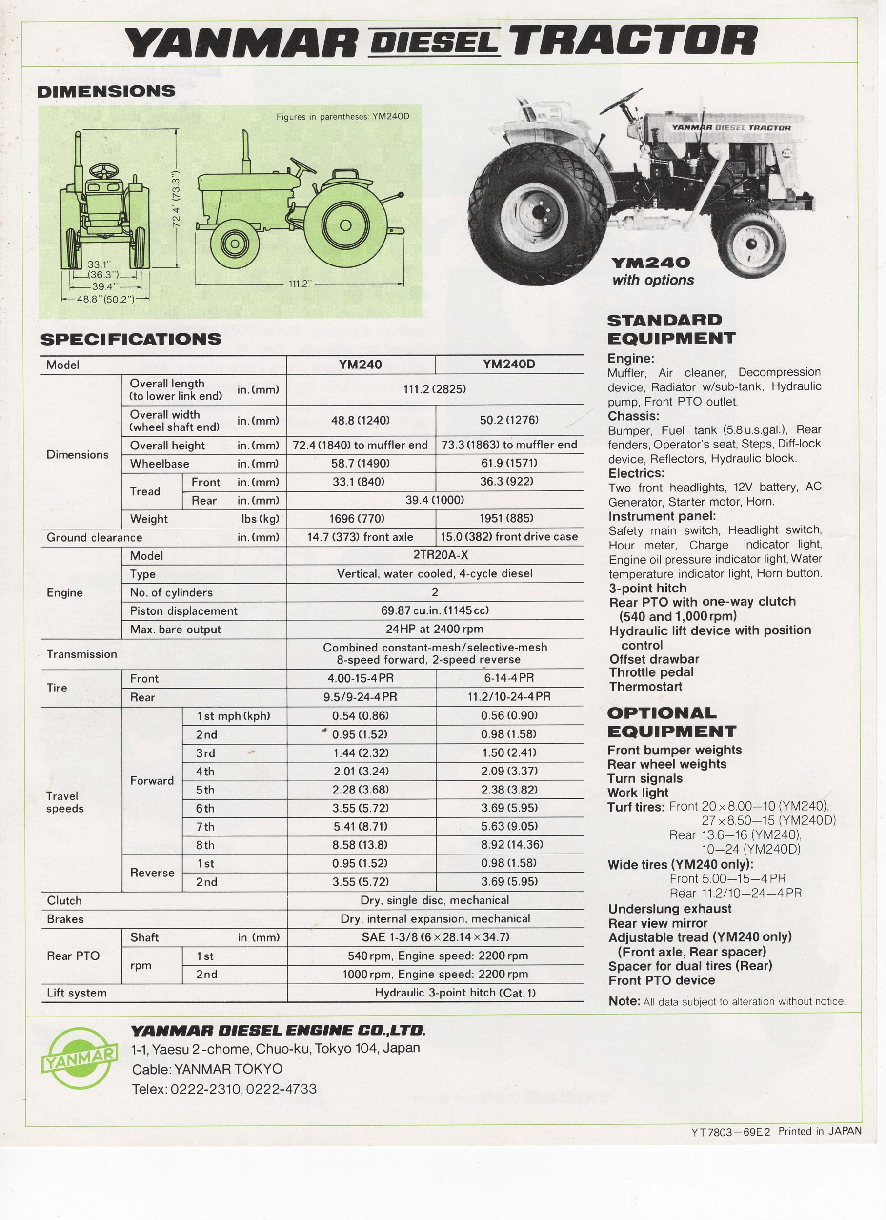

Slightly off topic but I recently bought some original literature for my YM226 and also got a brochure for the YM240 so I figured id share since its relative to your new to you 240.
/ New to me 240D #56
Well I'm still too longwinded. But here's another YM240 brochure.
