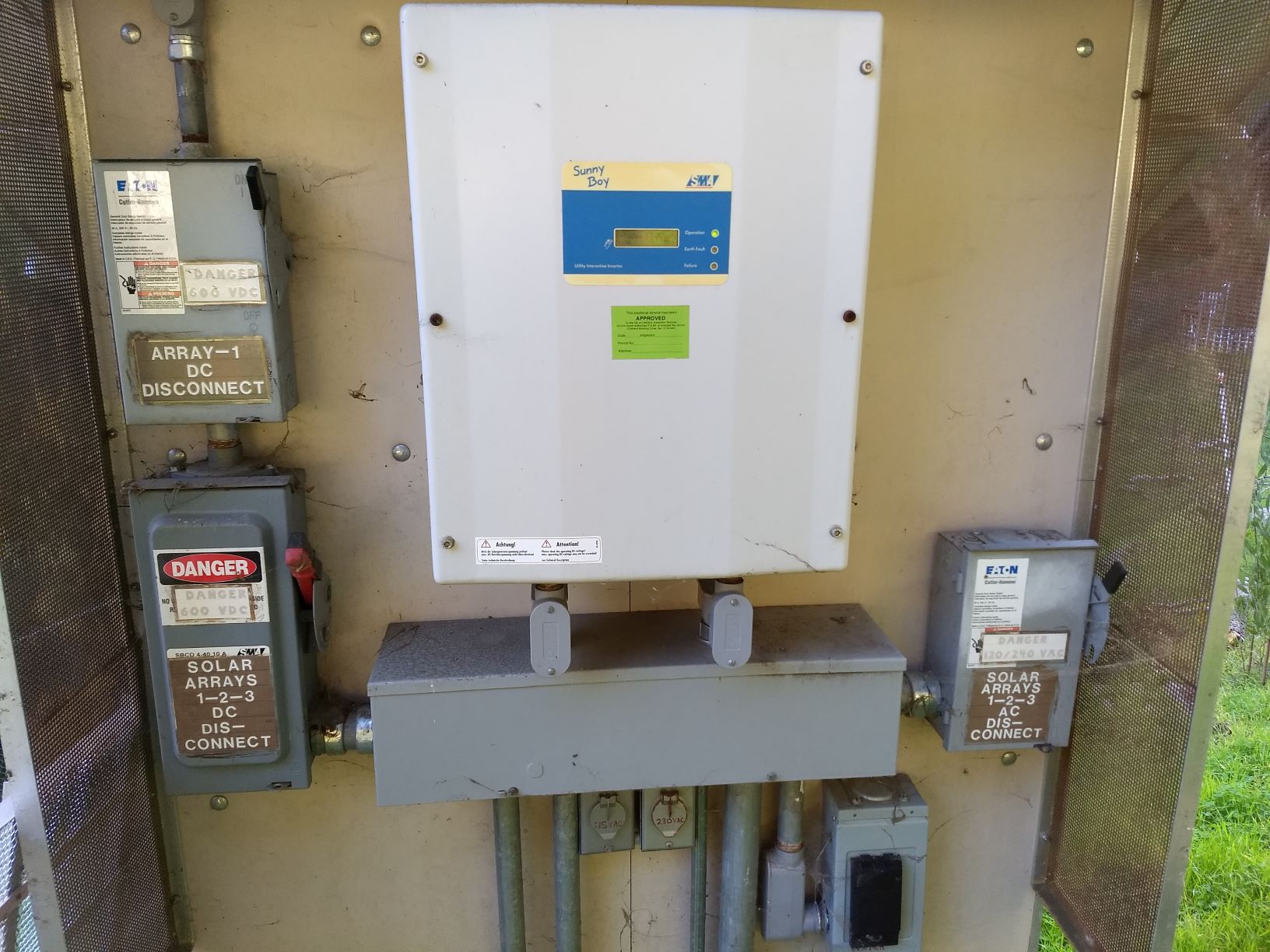

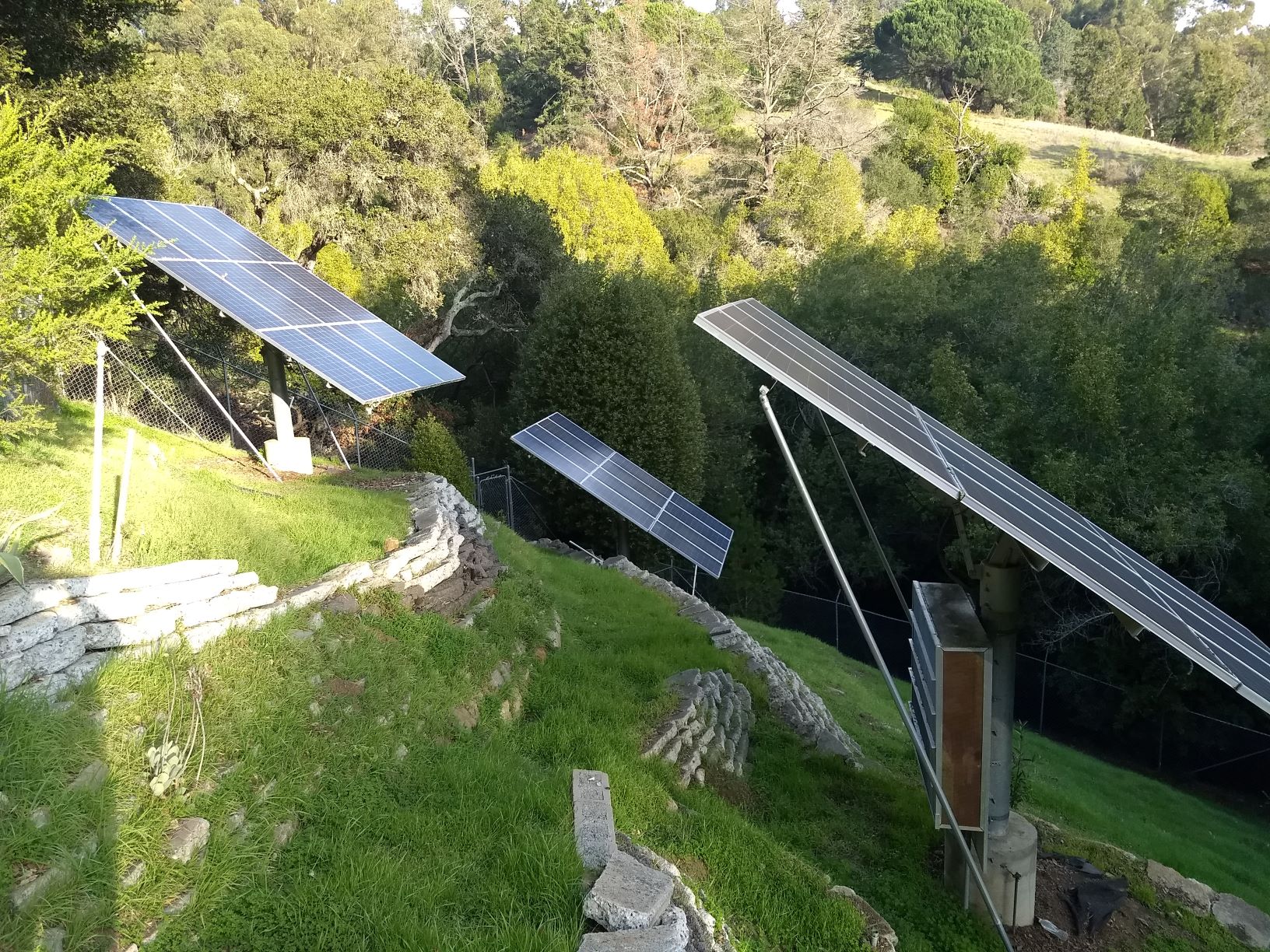

Yep... no display except on the unit itself which is field mounted... the array is on the hillside.
Plenty of labels on meter, disconnect, etc...
Looks like I will need to contact the invertor manufacture for specifics on the model I have... if it needs Internet there is none.
Pictures today if I can get there before dark.

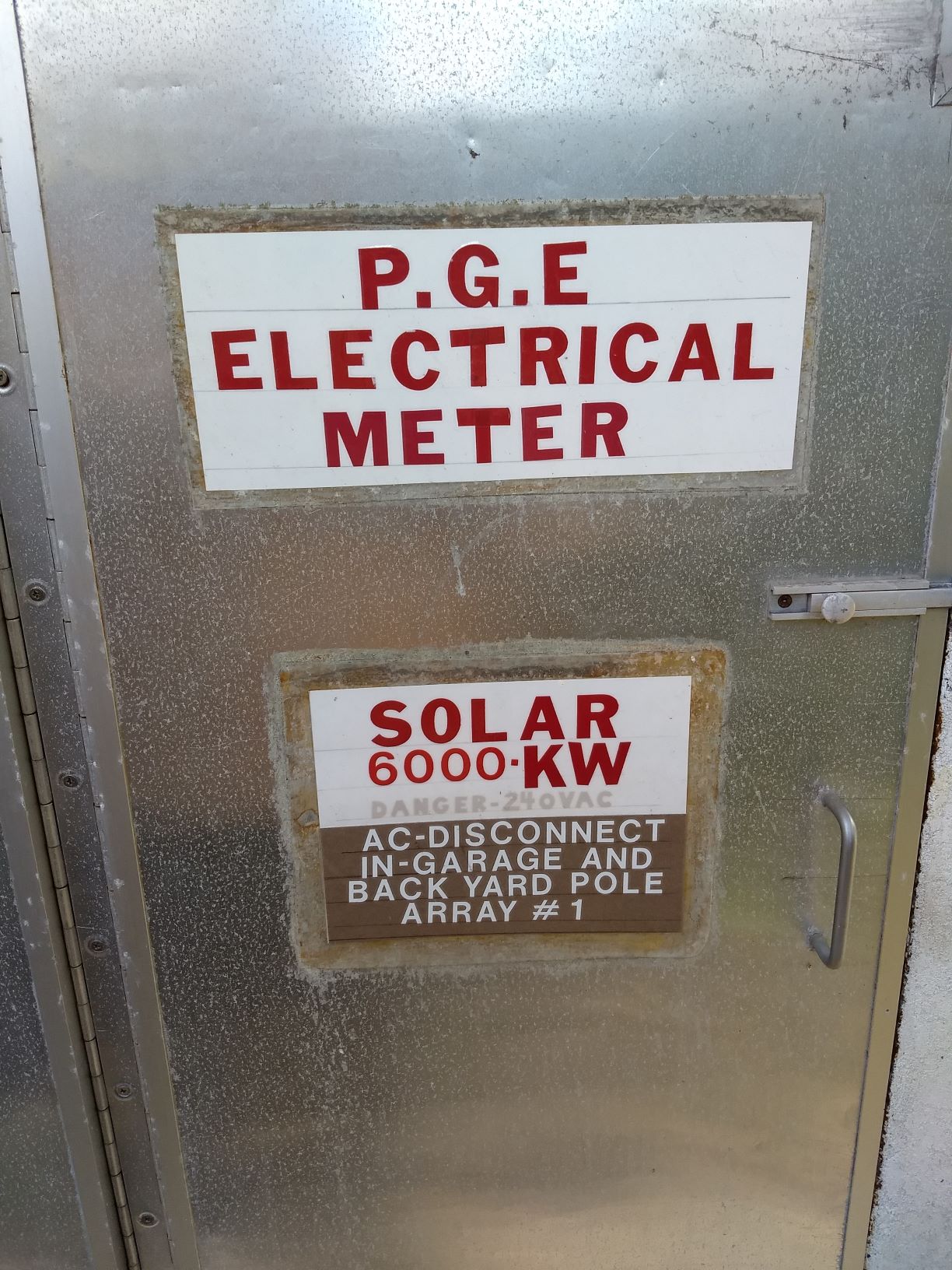

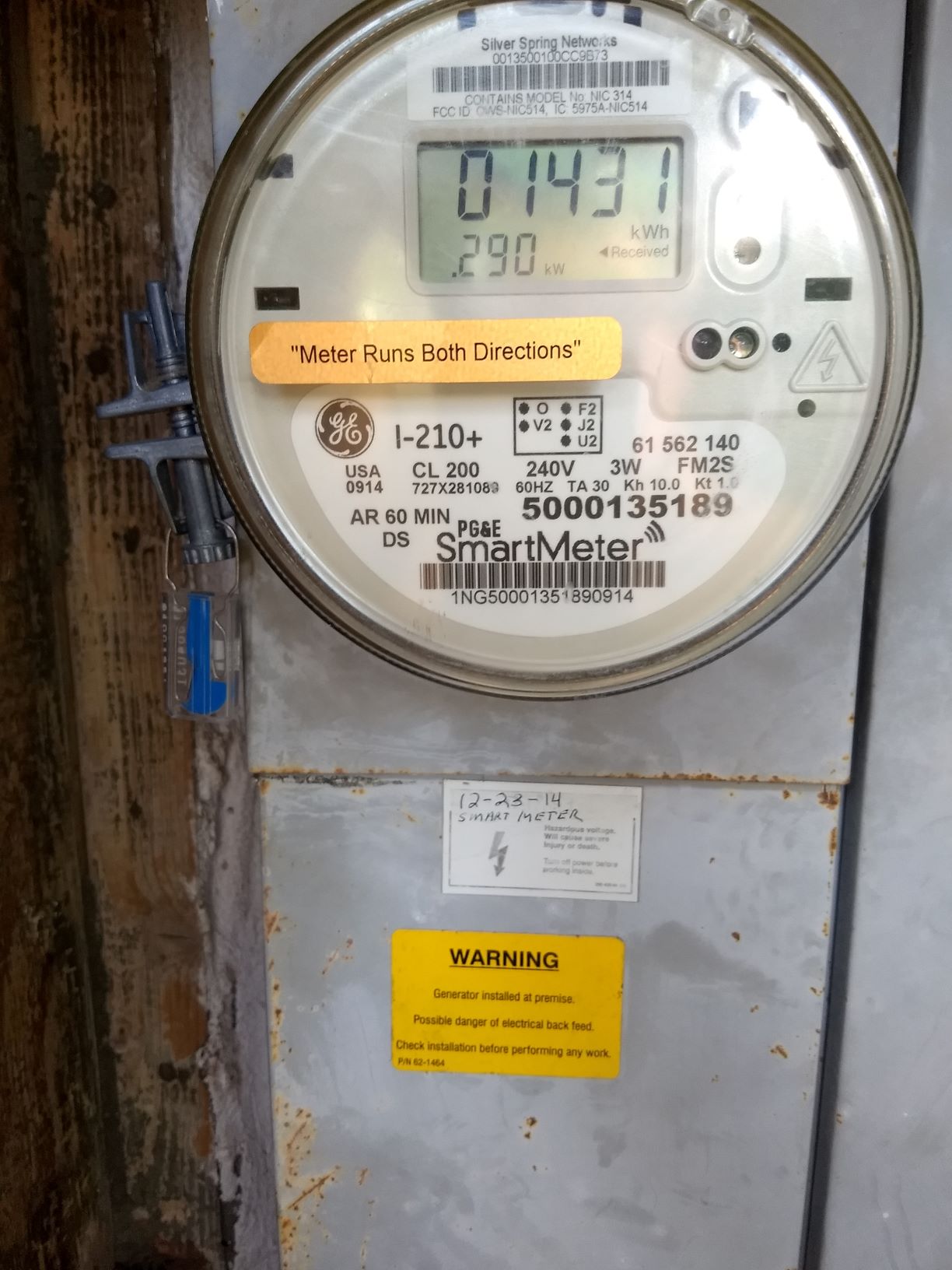

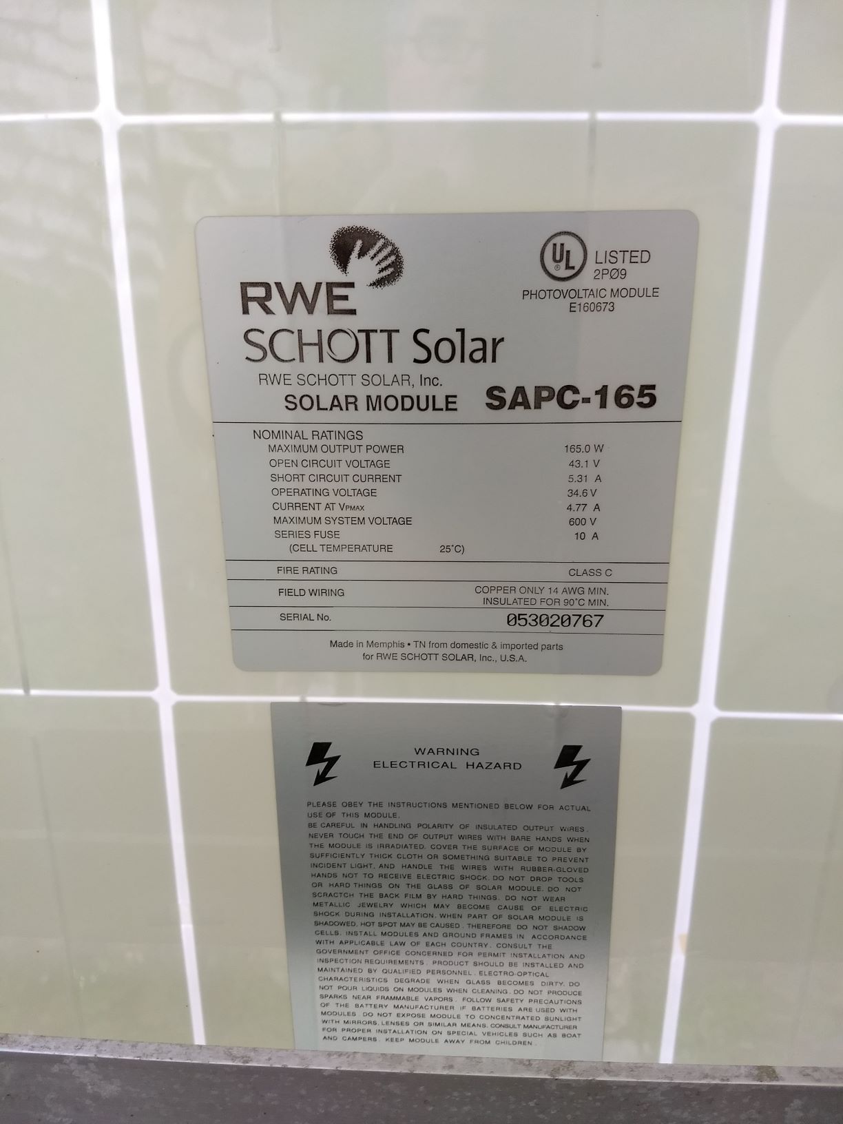

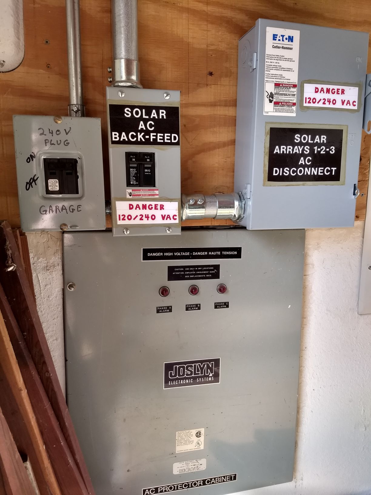

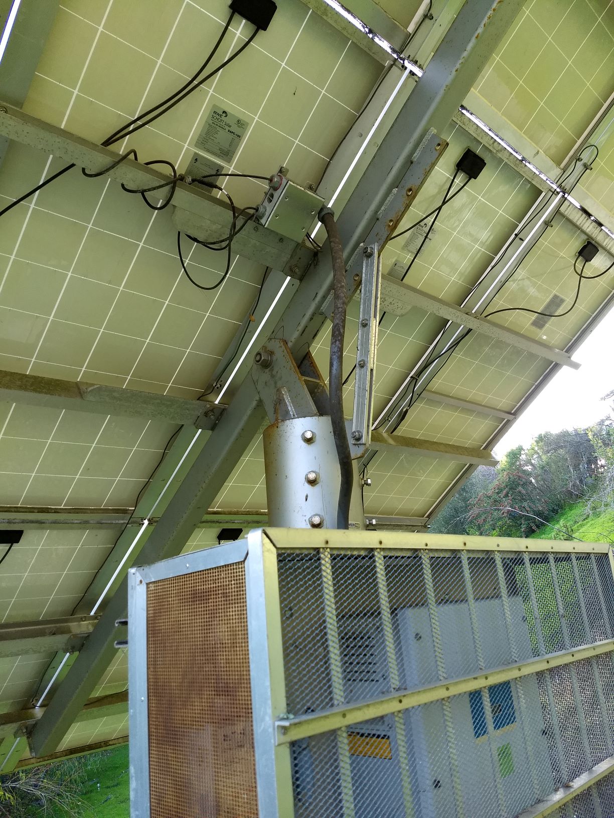

Finally able to take some pictures...
Today's winter production was just under 15 kW... for a 6kW array?
Sunny Boy Readout states 103,582 kW produced.
Pictures include the hillside arrays, Sunny Boy Invertor with Specs and Disconnects, Panel Specs, Utility Meter with 2014 install and Back Board.
