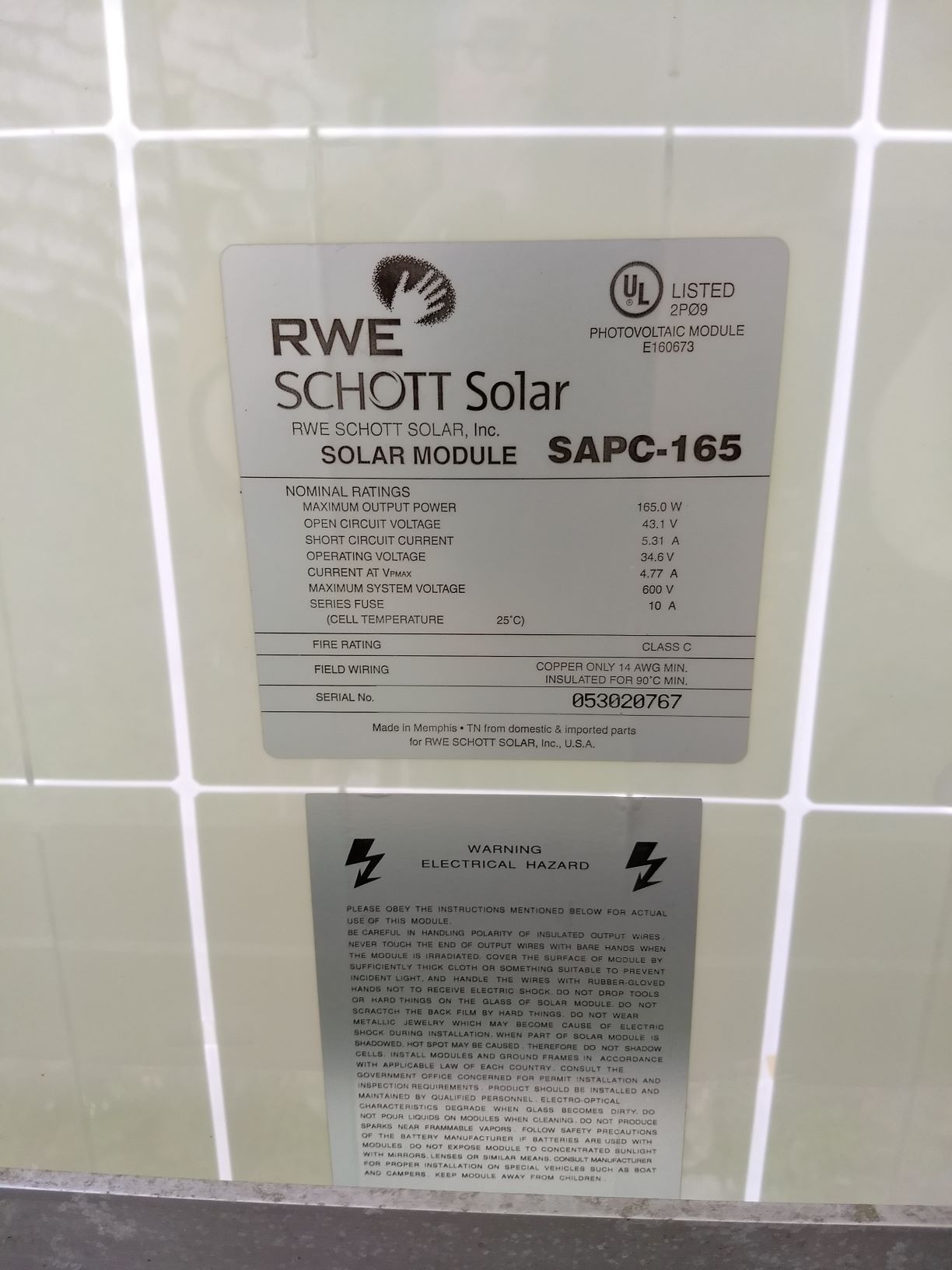

USA-California made in Rocklin 165 Watts per panel... here is the rating tag.
The manufacturer is very much alive and well but exited the panel business in 2012... ;-(
I would guess the 20-25 year warranty on power output isn't worth the paper it is written on... there seems to be hundreds manufacturers no longer in business or in the solar business.
Schott Exits the Solar Panel Business
As of 2012, Schott has withdrawn from the crystalline silicon photovoltaic business. Schott no longer produces the solar panels for residential or commercial installations.
http://abcsolar.com/pdf/schott165.pdf
