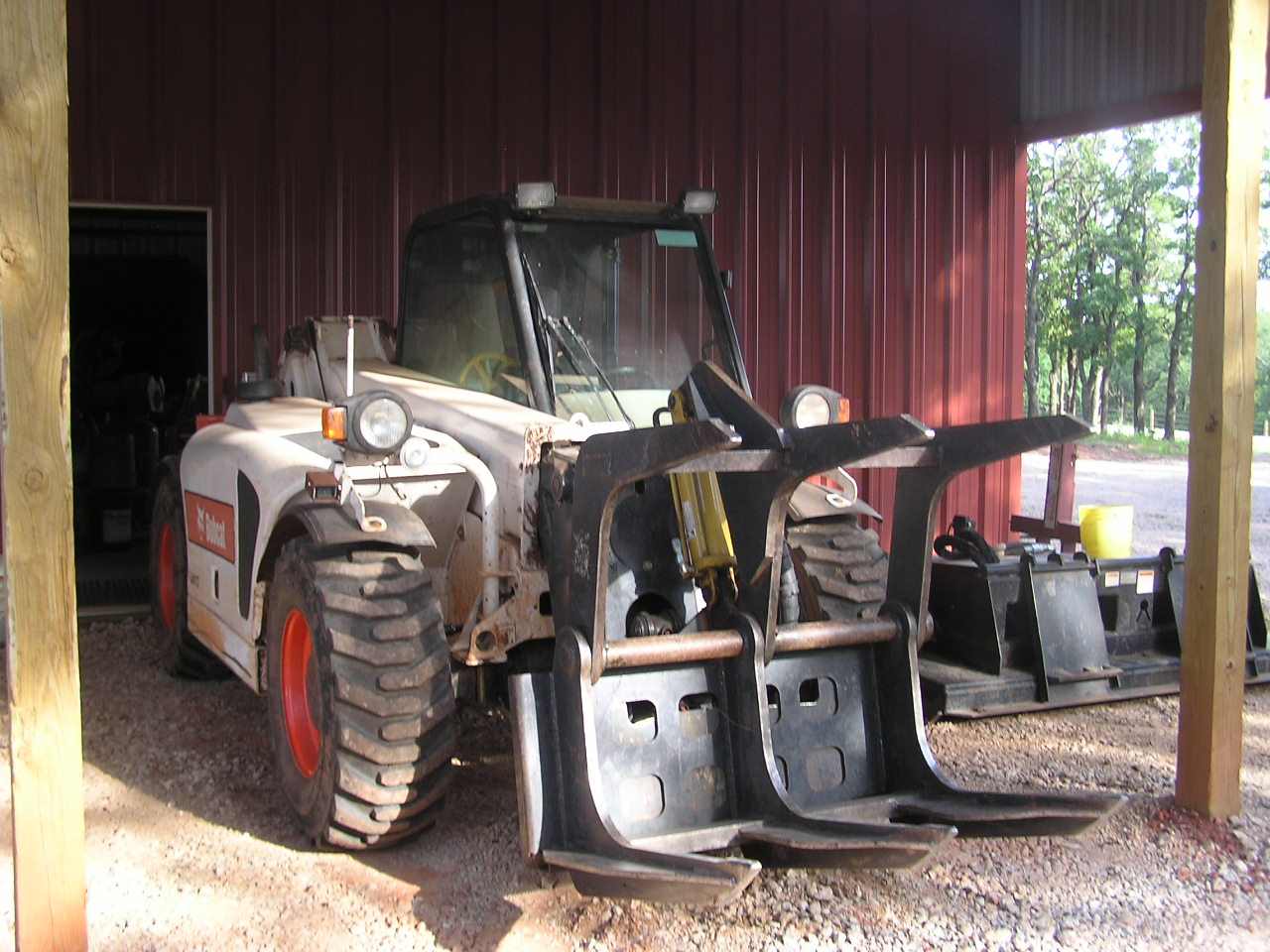

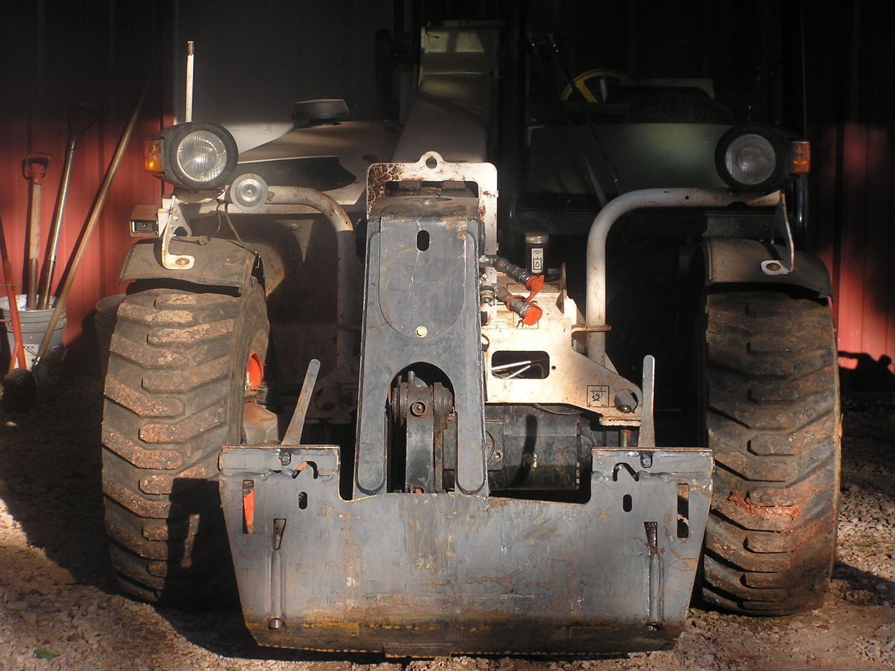

I also have 80 acres, lots of trees, mostly too many Cedars. Most guys on TBN say they didn't know about my V417, so I will post again.
It is 6' wide, 6.5' high and 13' long. 4 wheel drive, 4 wheel steer, 2 wheel steer and crab steer. Tire size is 14x17.5. Top speed is 15.5 mph, drawbar pull is 7,000 pounds and it will lift over 5,000 pounds. Has a SSQA and Aux Hydraulics on the boom.

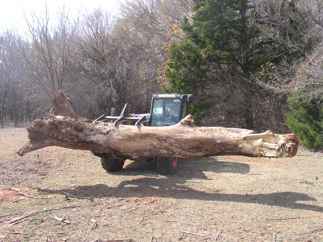

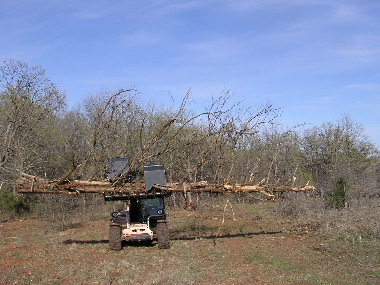

Much better view of front forks or grapple, than from a tractor seat.

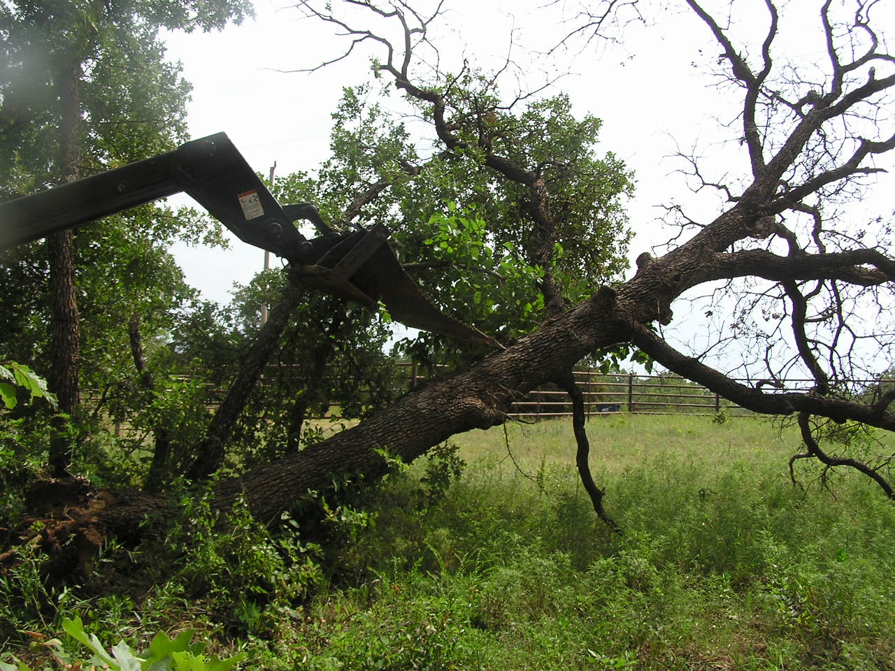

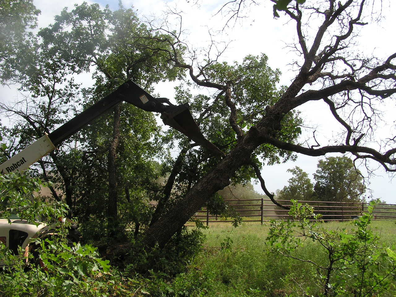

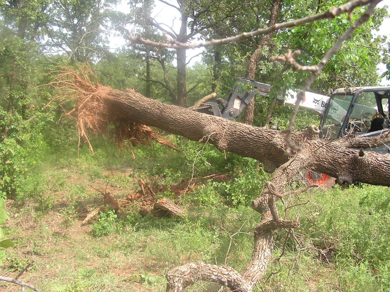

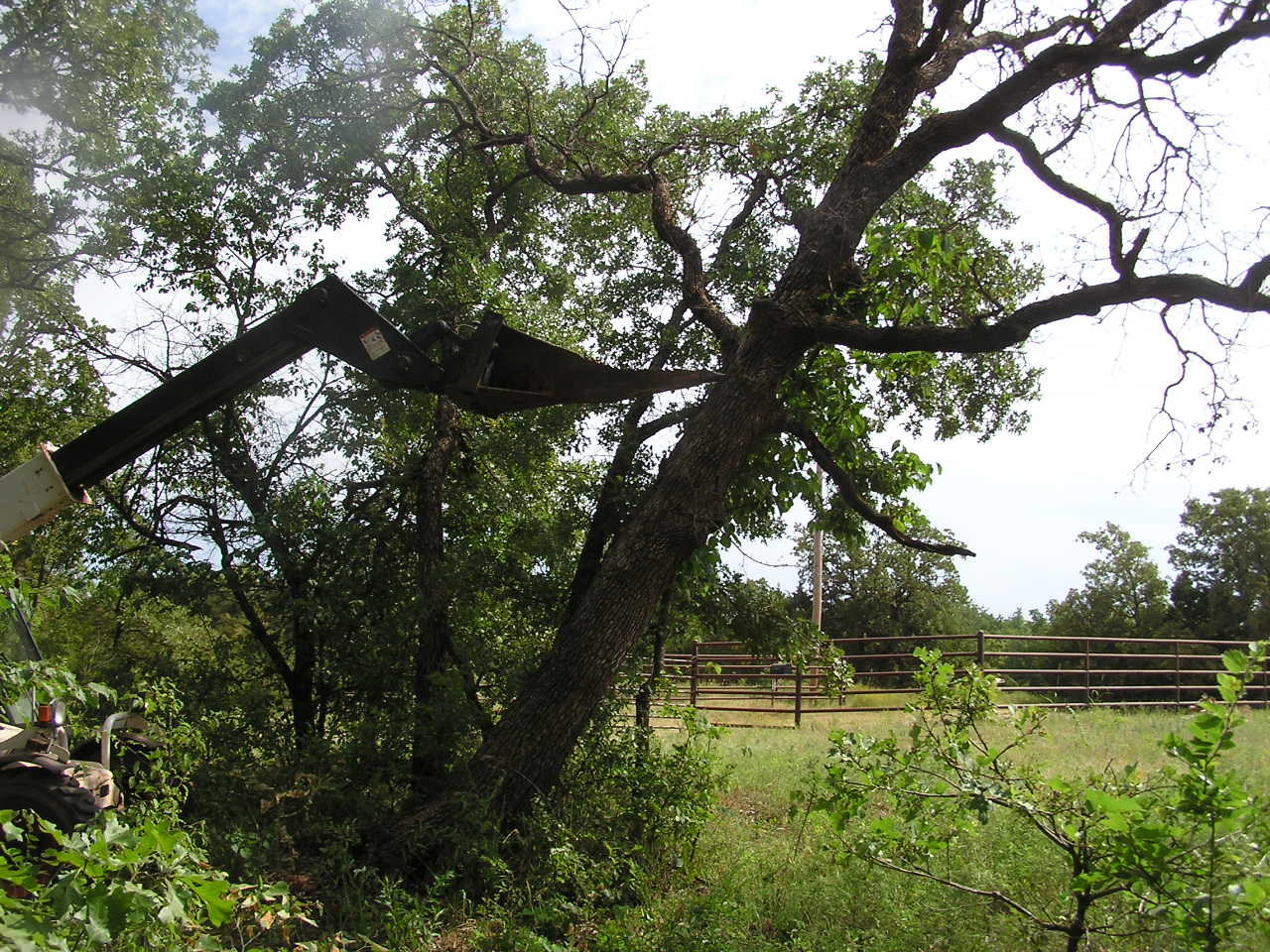

Will remove big trees faster than a backhoe, just push it over and pick it up.

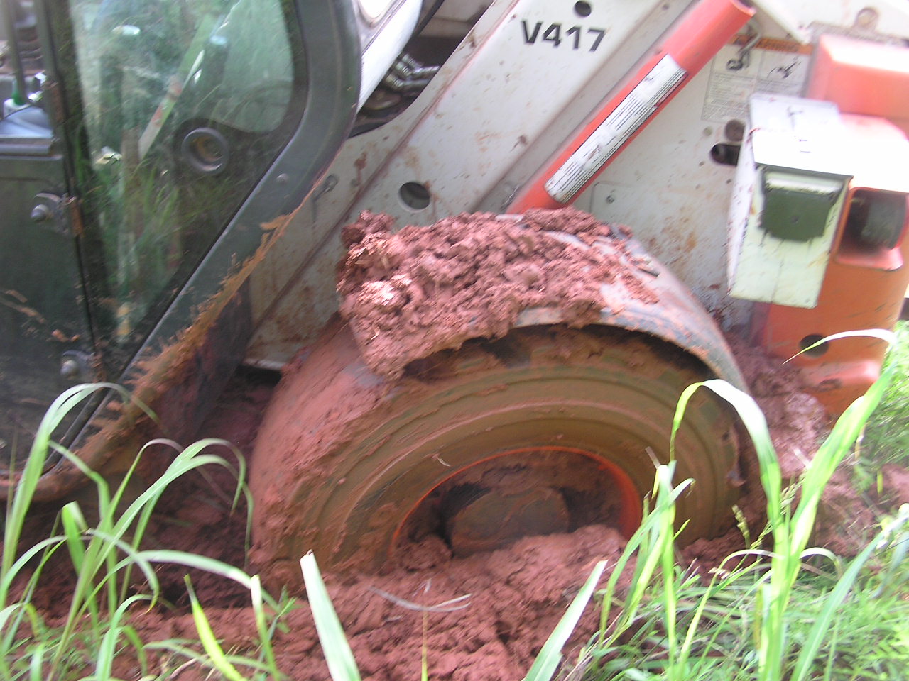

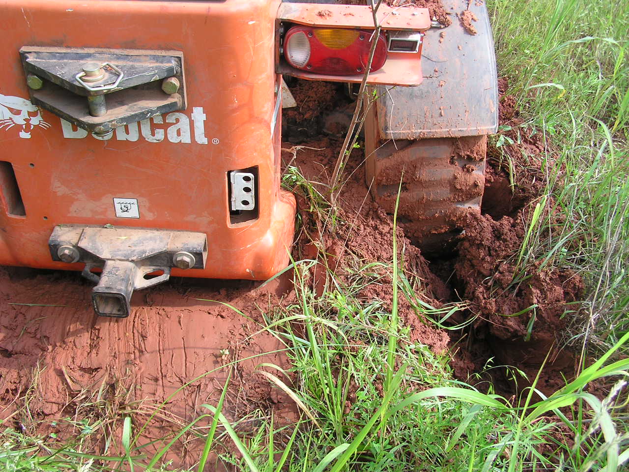

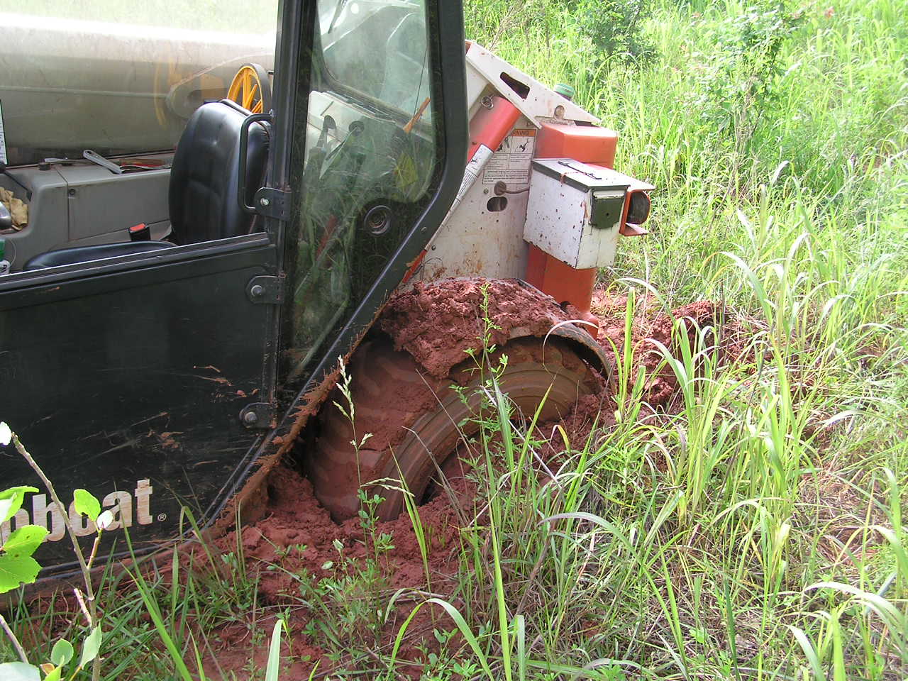

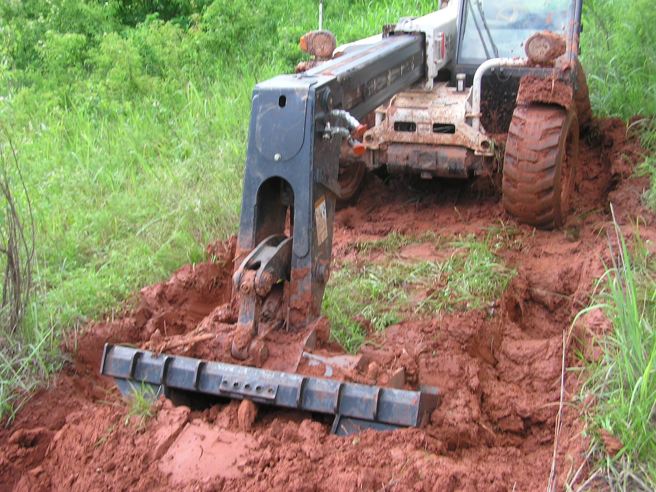

And it is UNSTUCTABLE!
