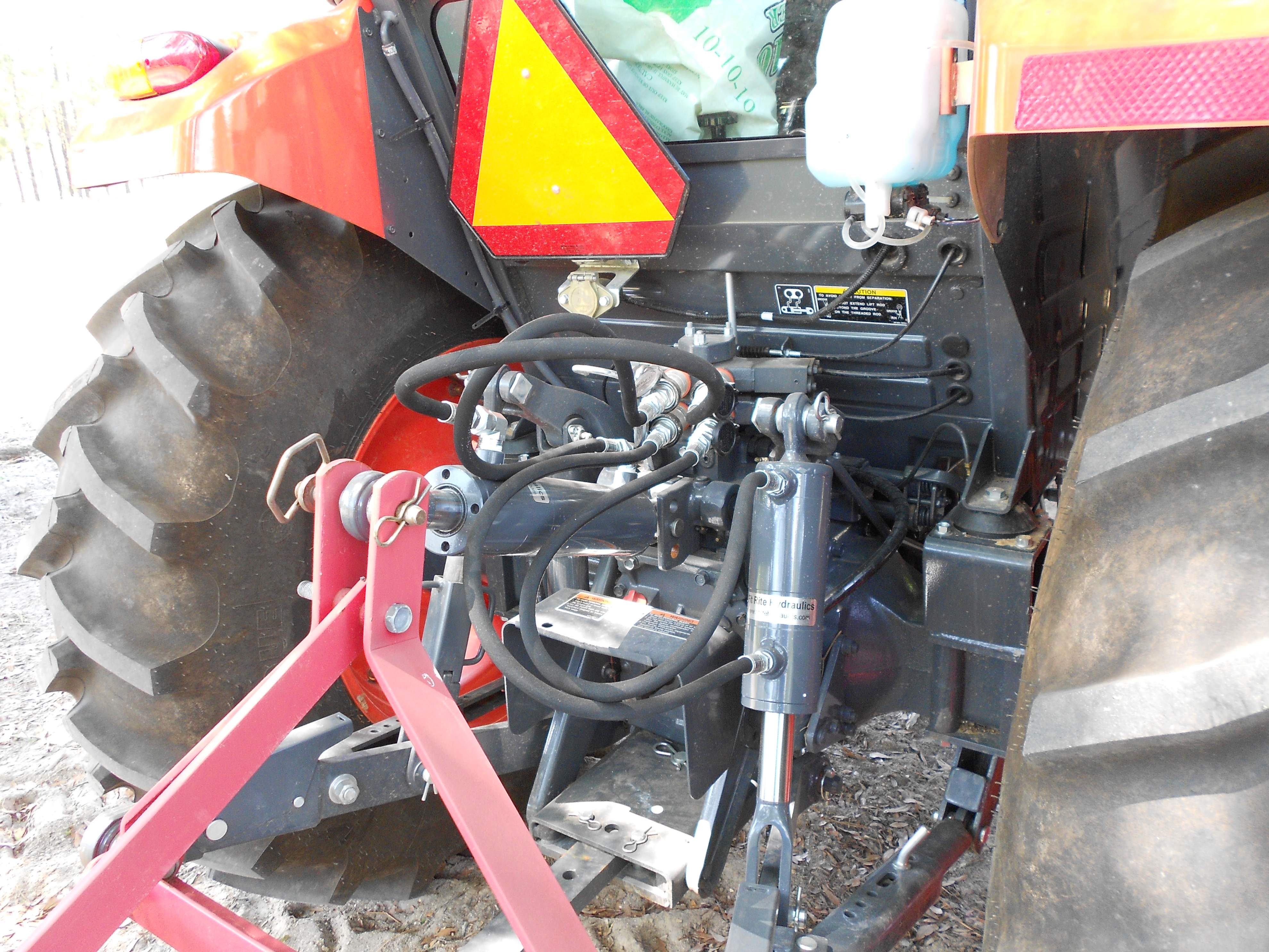

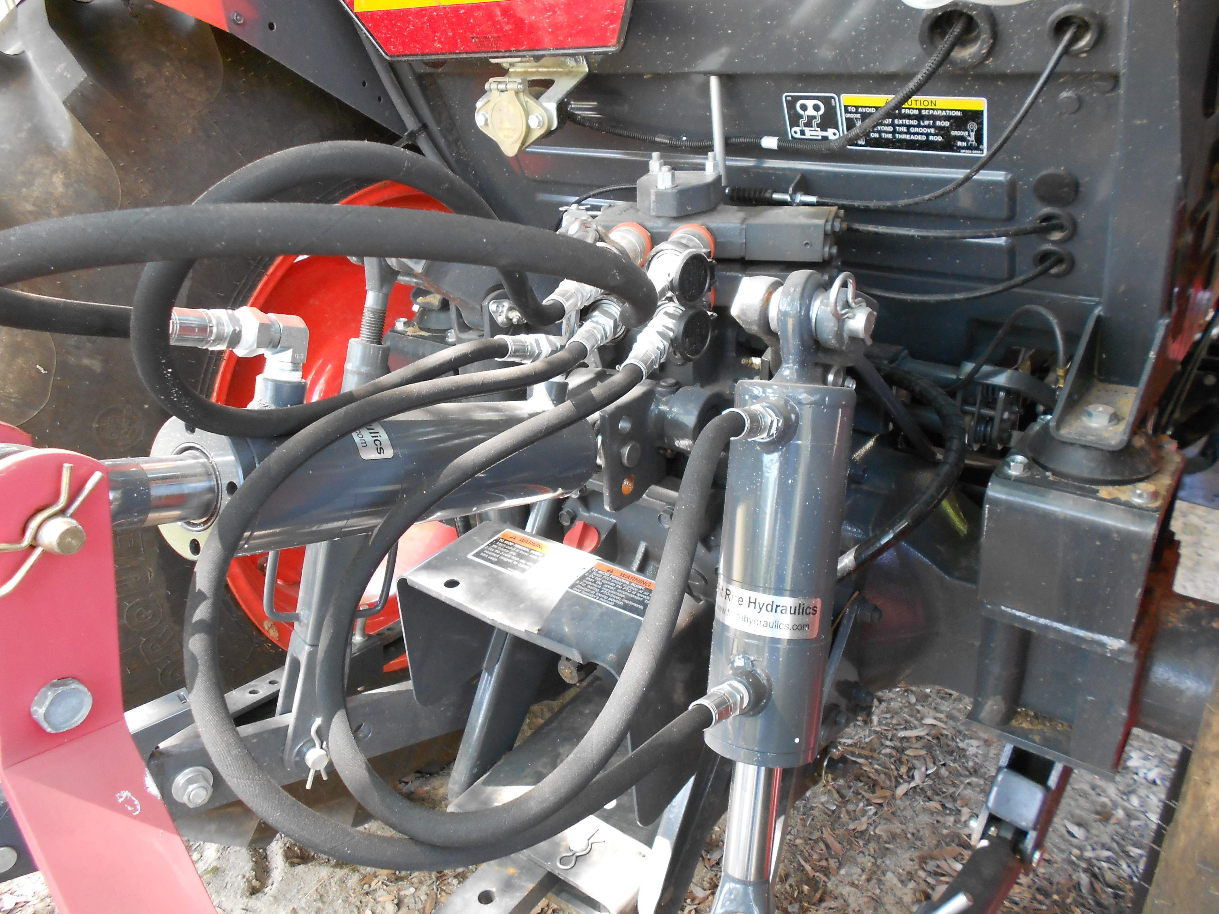

Installed new TNT from Fitrite on Kubota 7040 today that arrived Sat. Took about 30 minutes to install while partly playin with the dog. Everything as ordered 2-3 weeks ago and easy install. Worked fine and used with landscape rake for about an hour doing some yard work. Will try to get some pics later. Thanks Mtnviewranch.

danceswithdirt, You are going to love having the set. Makes using your implements ooooooooooooh so much nicer. :thumbsup: :thumbsup: Would you please try to get some close ups? Pictures are very much appreciated.
Thanks again. ;)

Sure will, they look great. Just using the landscape rake but the speed seems just right. Wife didnt know I had put them on and thought something was wrong when the rake started tilting over and changing pitch:laughing:.

Dont have the float detent but may fix it so it will float. I have read here you can alter the valve to do so. Not really used to being up that late but lately had daughter and her girlfriend want us to watch a movie with them. We have an old tractor barn converted into a club house and they want my wife and I down there playing pool, or games with them. They are full time entertainment. Would be the ultimate man cave but.... Half the time its full of her school friends. Cant complain at least they arent runnin the roads or into so much thats out there. Heres a few pics of the tnt.
