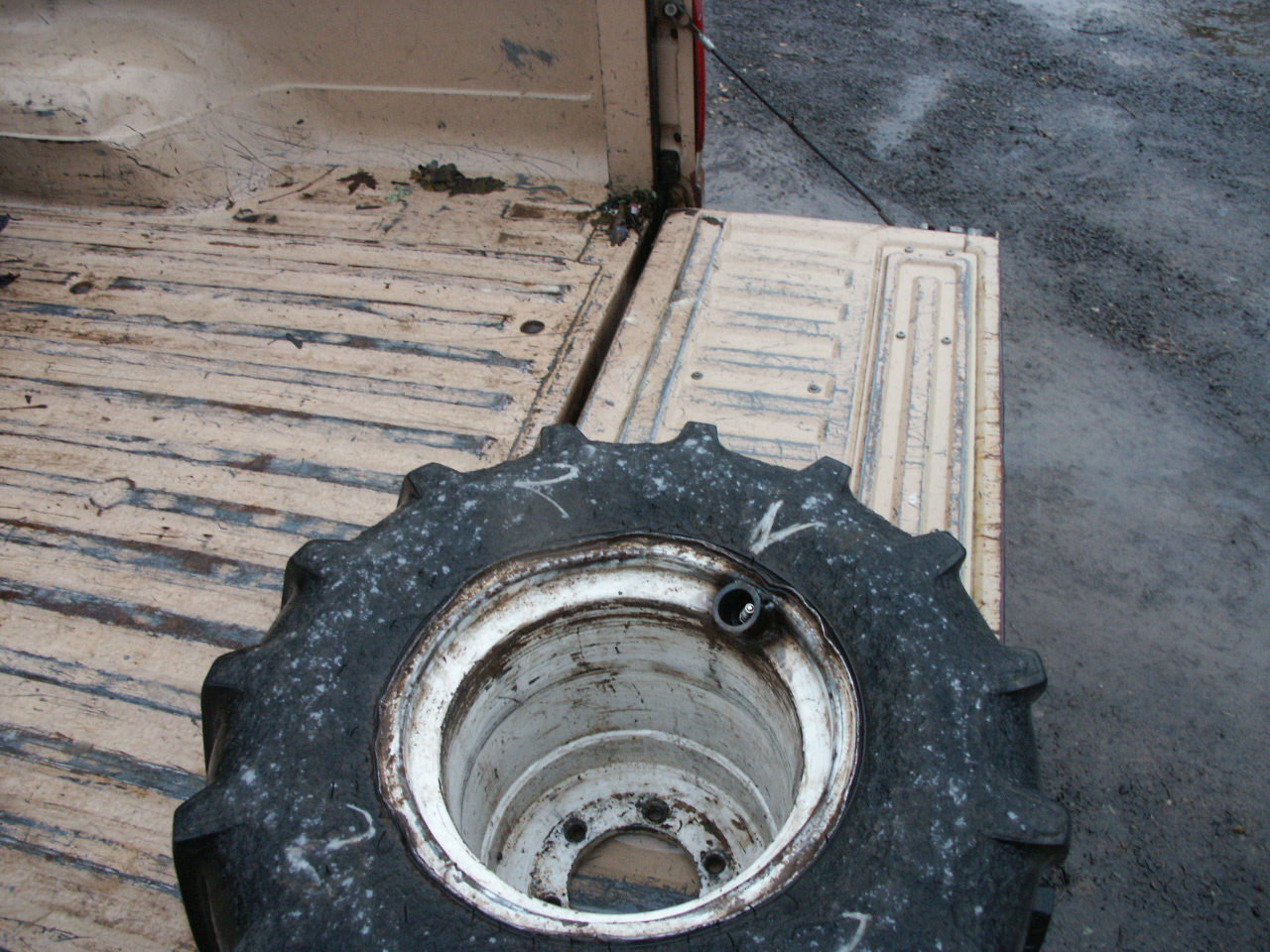

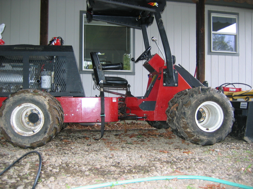

Here is a couple of pix of the rims. It is confusing, but yes, there is a spacer, about 2" thick... Its is easy to miss and tends to stick to one rim so when swapping. The rims are universal (Inside and outside the same).

The people that made my rims are called Southern Wheel and Tire, located in Jacksonville, FL. They take an open center 12 in X 8.5, and weld in the center piece, off-set as to your plan. They can probably weld in the stem protectors. You all do know why there are tire stems on both sides of the rim
My wheels were replacements. I can not use duals on the 1445. Since then, I have found about 4 more wheels, and a bunch of lug tires.
If you have a Ditch-Witch place in your town, take a measuring device and measure their tires and rims.

I think that PT may have changed the design for the dual wheels at some point. On my 1845, purchased in 2002, the wheels have a large offset but also use a spacer between the two wheels. I think the spacer is several inches (a wheel would have to be removed to measure it)--it is not simply a plate.
I think the only way you can get by is with a wheel similar to the bud wheels like on my box van, those go on the hub face to face. On the kind of wheels that we use, you have to have a spacer, because the center plate can not bolt up face to face. Therefore, the spacer.

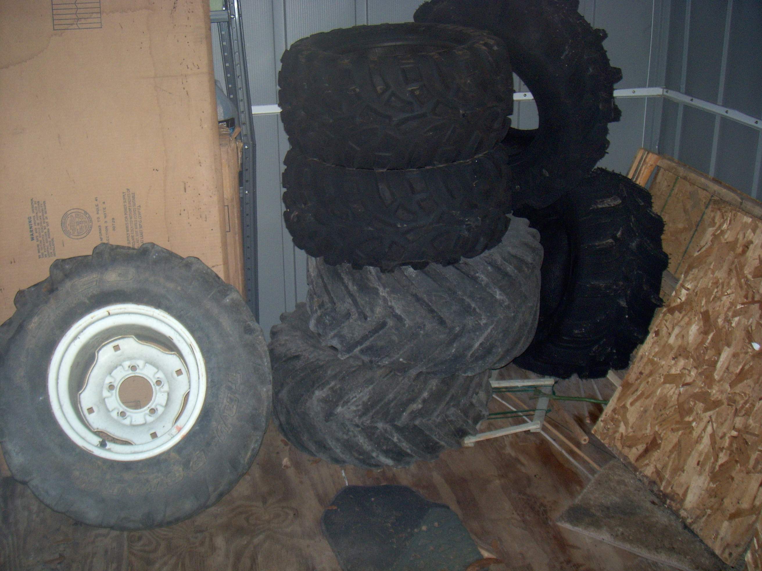

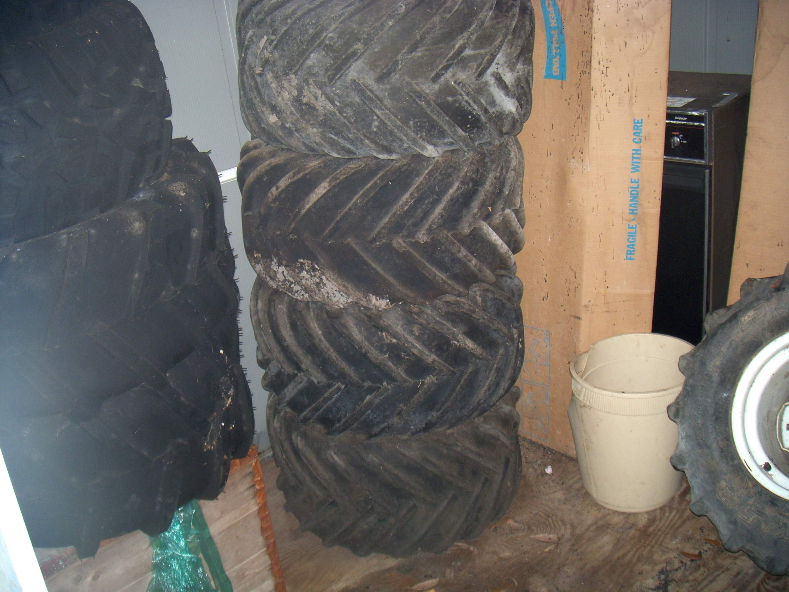

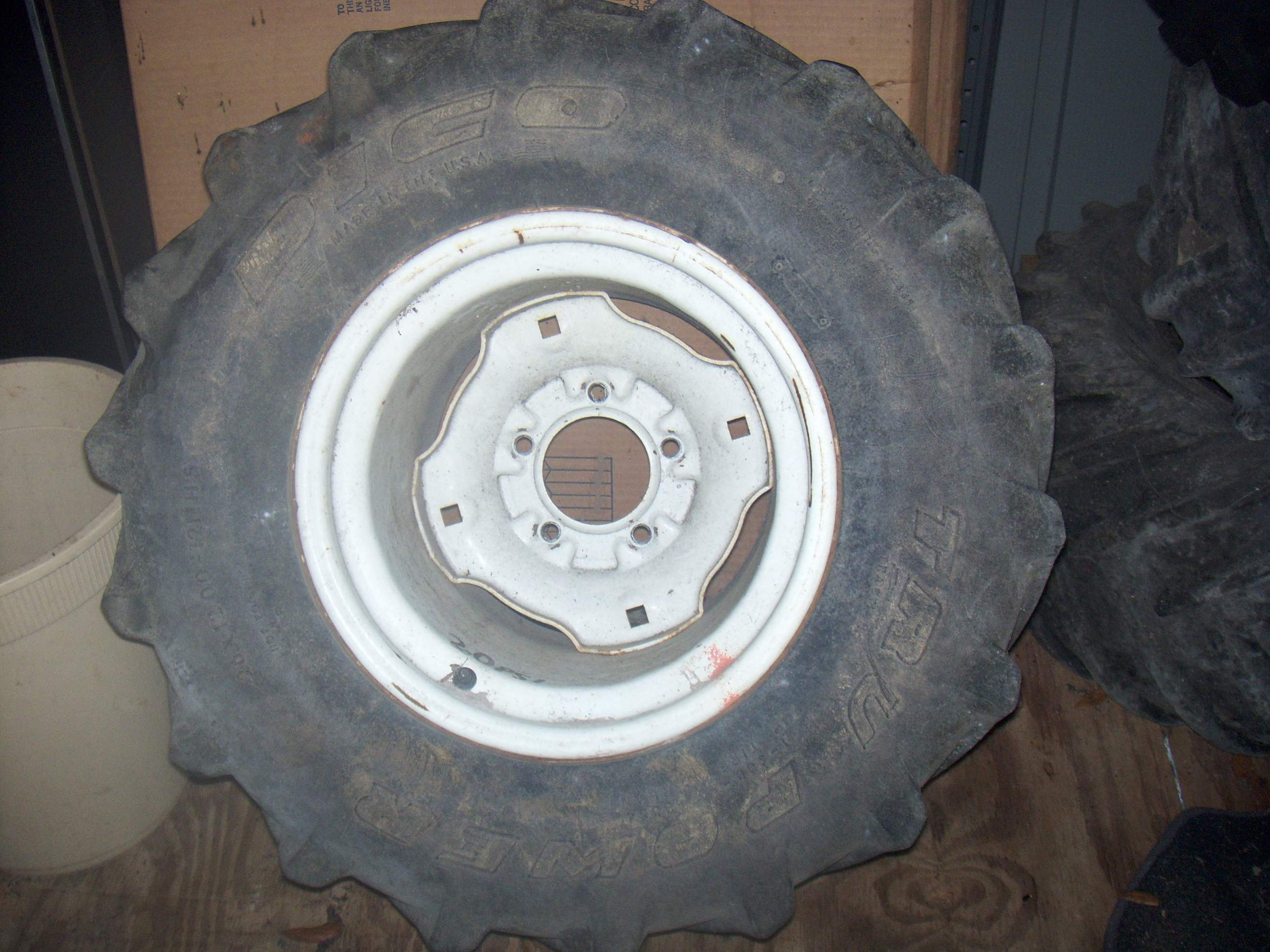

I have been collecting these over the years. Some of them are Ditch Witch tires and rims.
