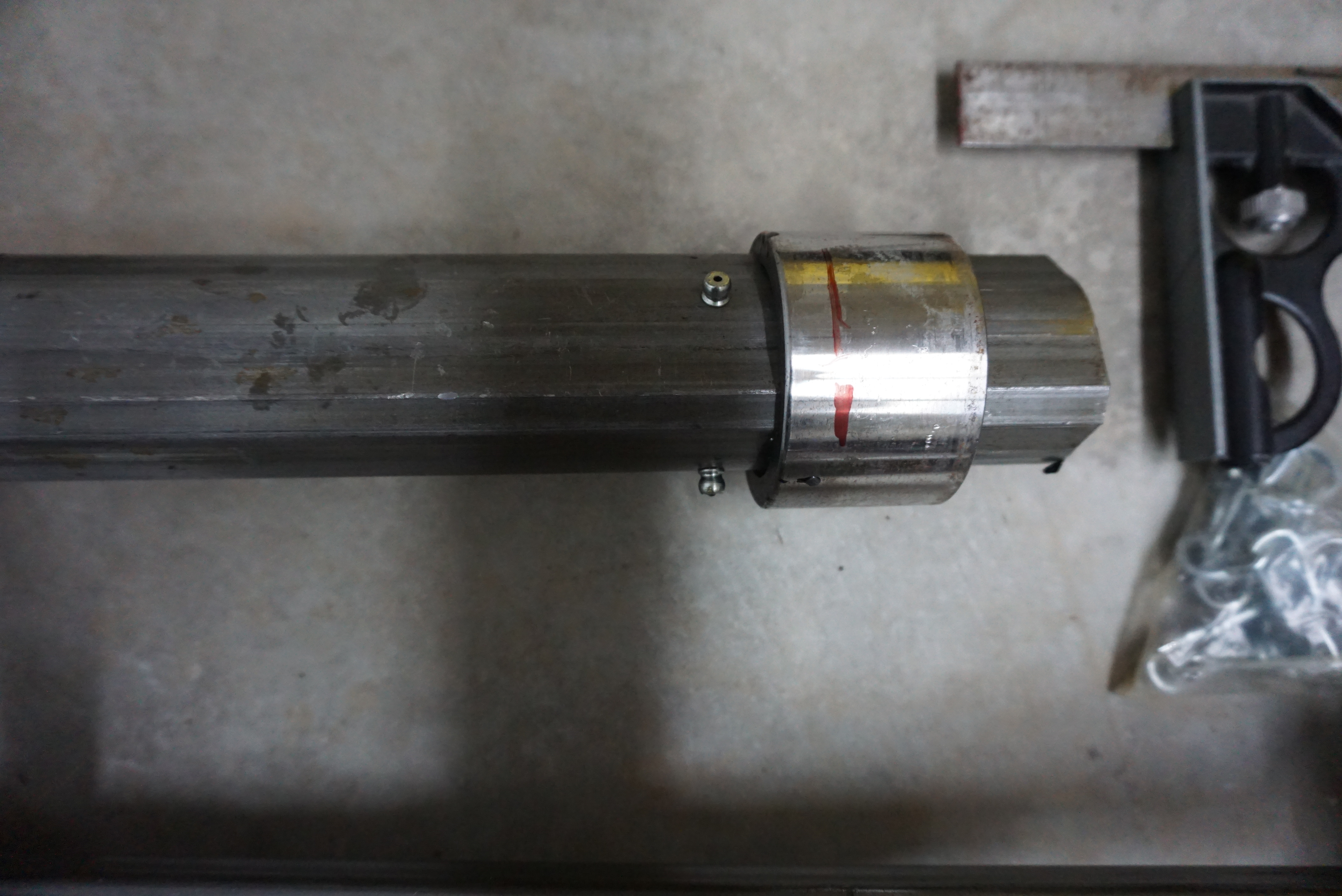

Ive never cut down a PTO shaft before so I'm following the EA video for how to do it; ted makes it look easy enough. I however found a minor complication with the shaft that came with the snow blower. There's a large collar pressed on the shaft right where I need to cut it. It appears to be a dampening weight of some sort. It also has 3 grease zirks right below the collar; those will have to be moved. I intend to just use a press and push the collar down then cut the shaft by 2 1/2 inches. Ill then drill and tap the new holes for the zirks and viola I'm in rotation.

Shaft is cut down and all the hoses are made. I got some of them installed today but its way cold as soon as the sun dropped. Ill post pics tomorrow.
