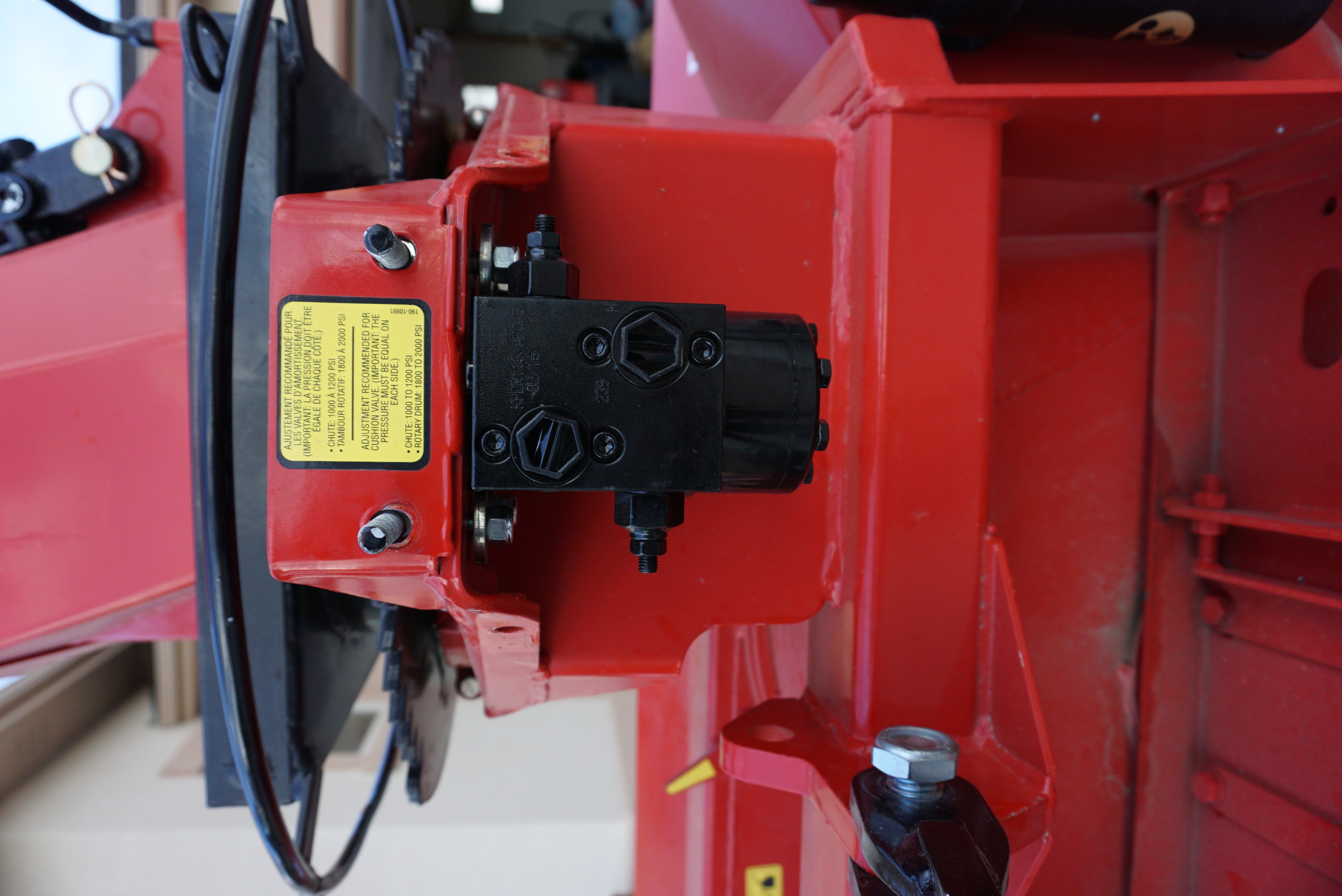

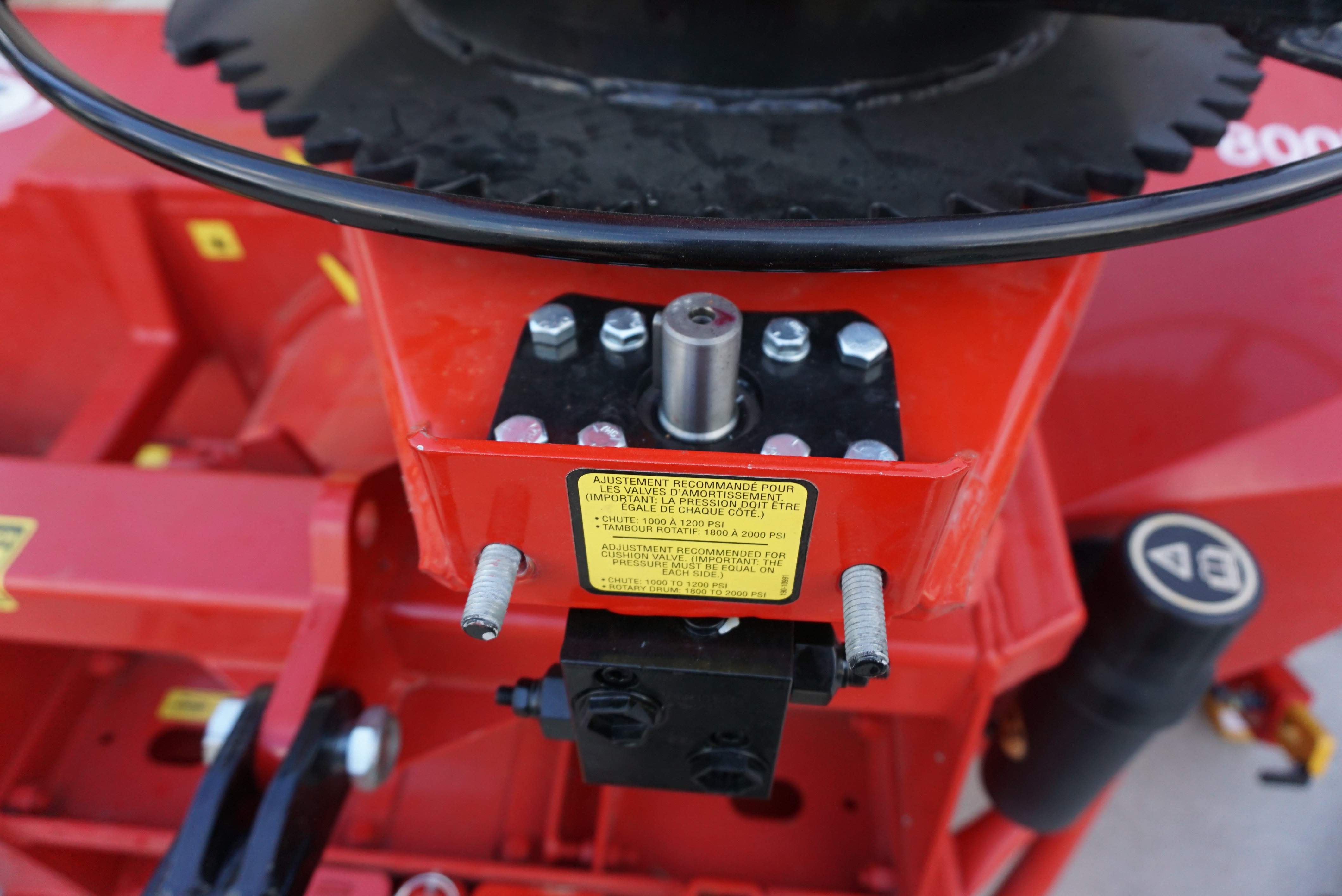

Mounting the hydro motor for the TRC chute today. Quick note: It can only go in one way. Ill show you why.
The motor and the shaft for the auger drive live behind this cover DSC01676.JPG
First thing to do is remove the adjuster plate and install the other adjuster nut. In this pic you'll notice I have the motor installed and the second adjuster nut is not on. Learning has occurred. Then you can bolt the motor to the adjuster plate.
The motor can only go on one way: with the hose fittings facing the left. If you orient them in any other way the securing bolts wont go in. More learning.

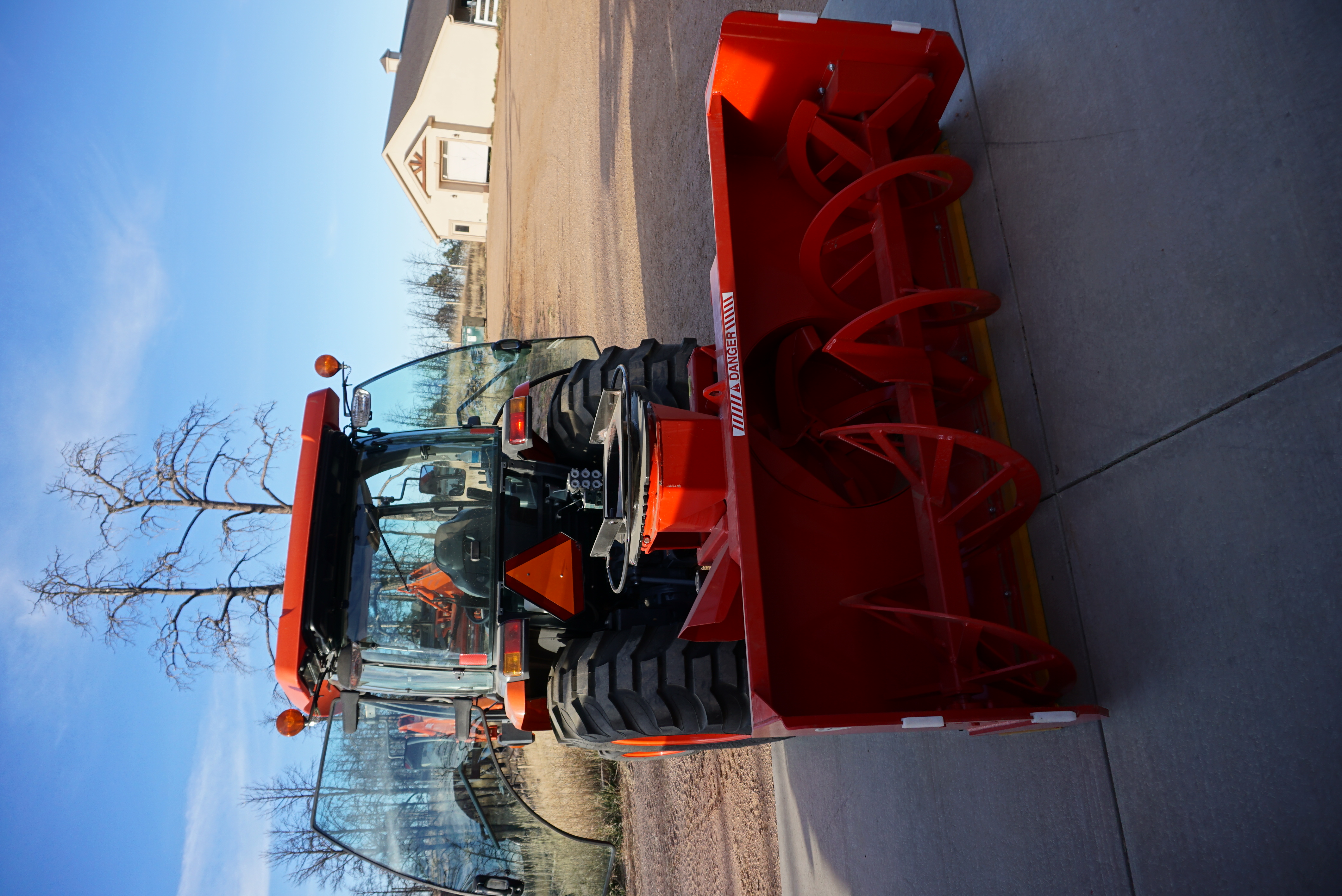

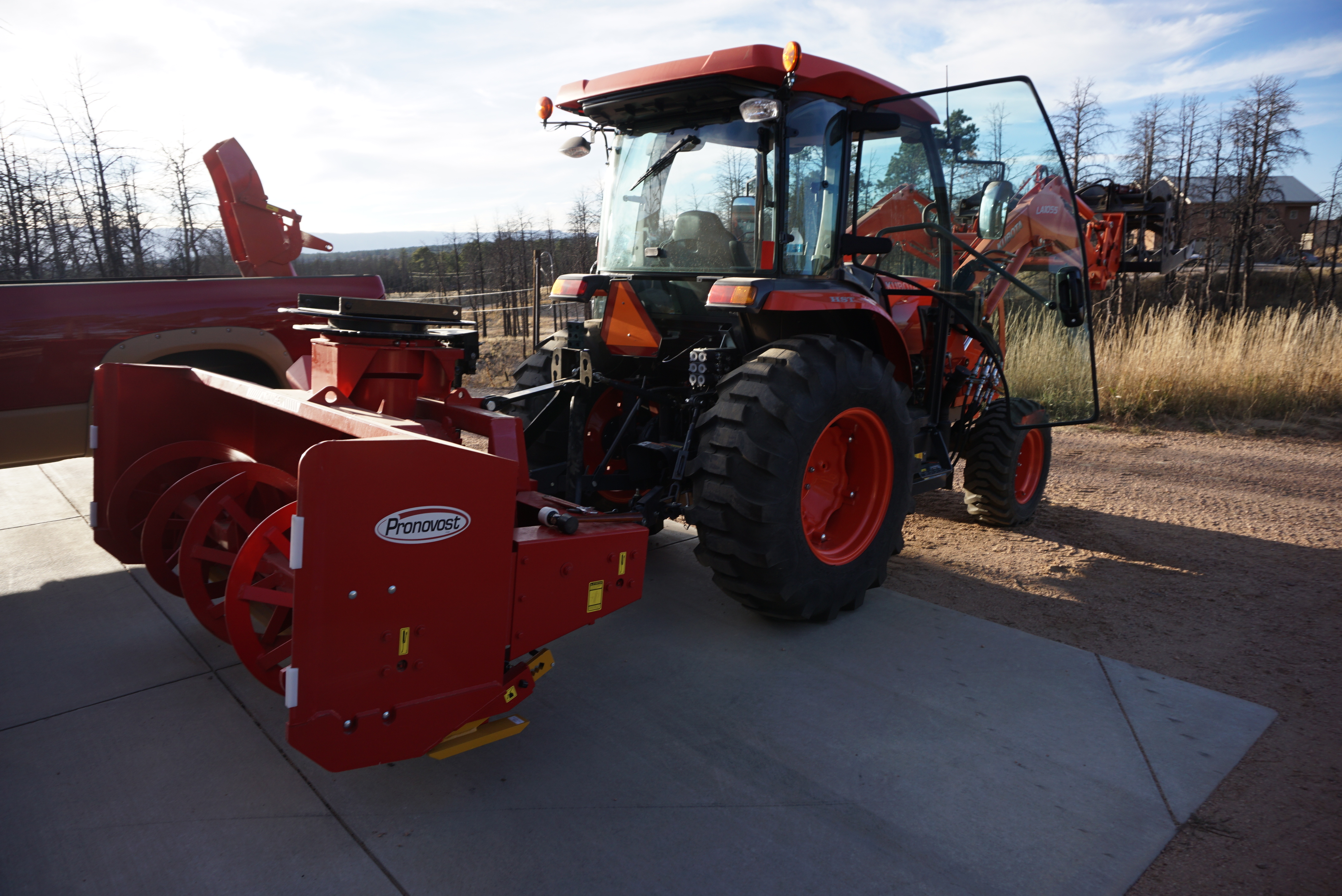

#31

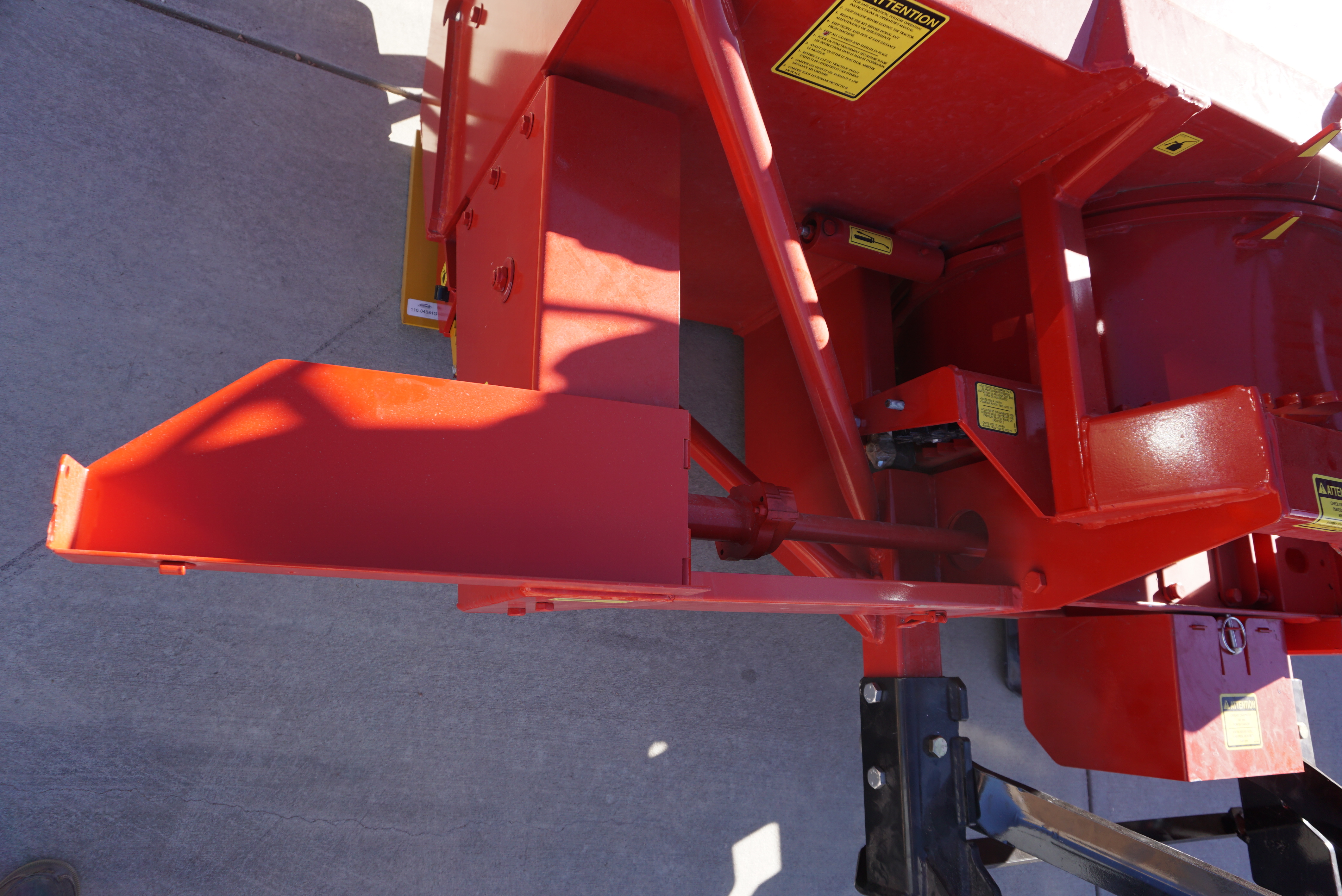

so heres a couple of pics of it behind the tractor. Man this thing has some weight to it. If I bounce it I think I could probably get the front wheels off the ground.

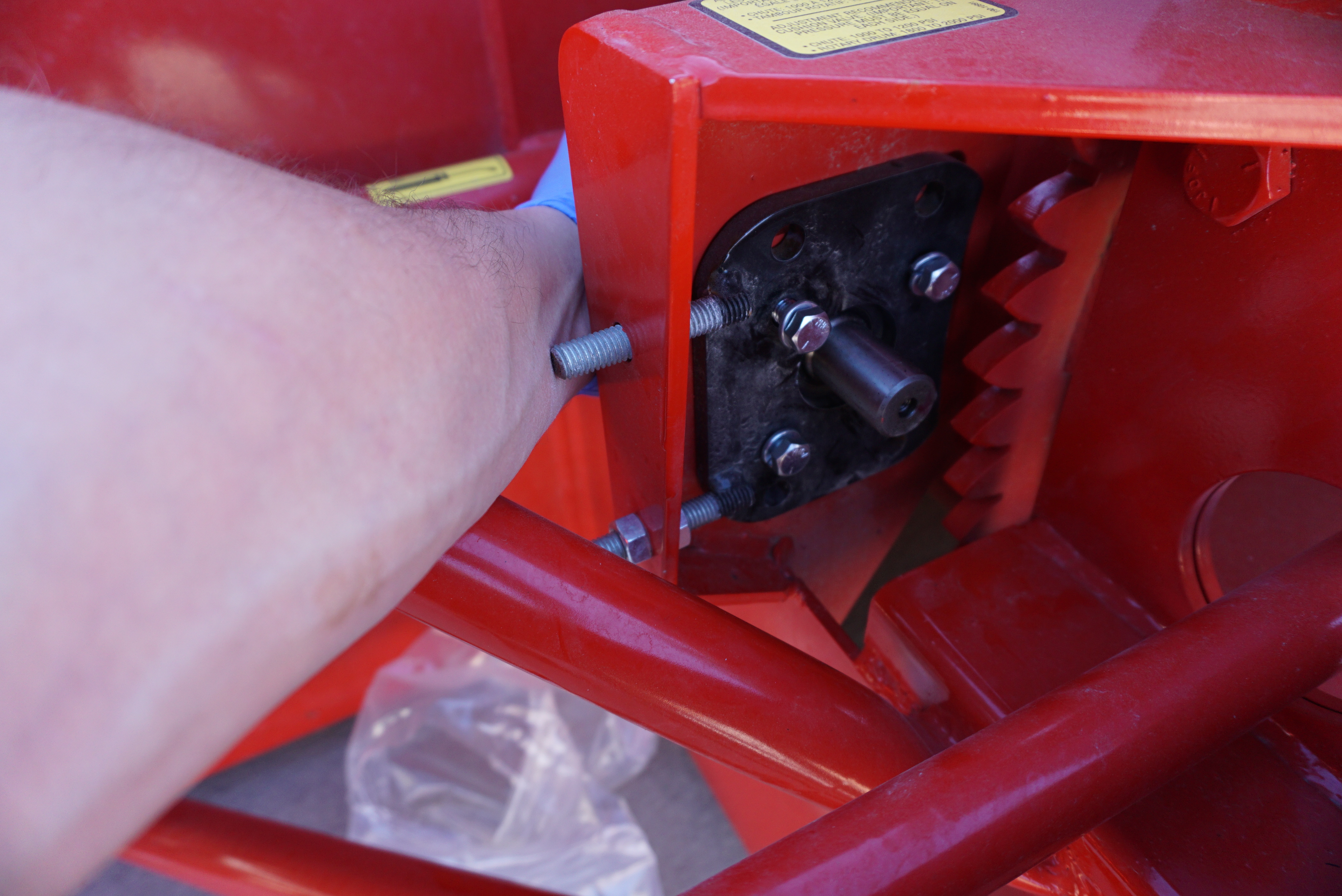

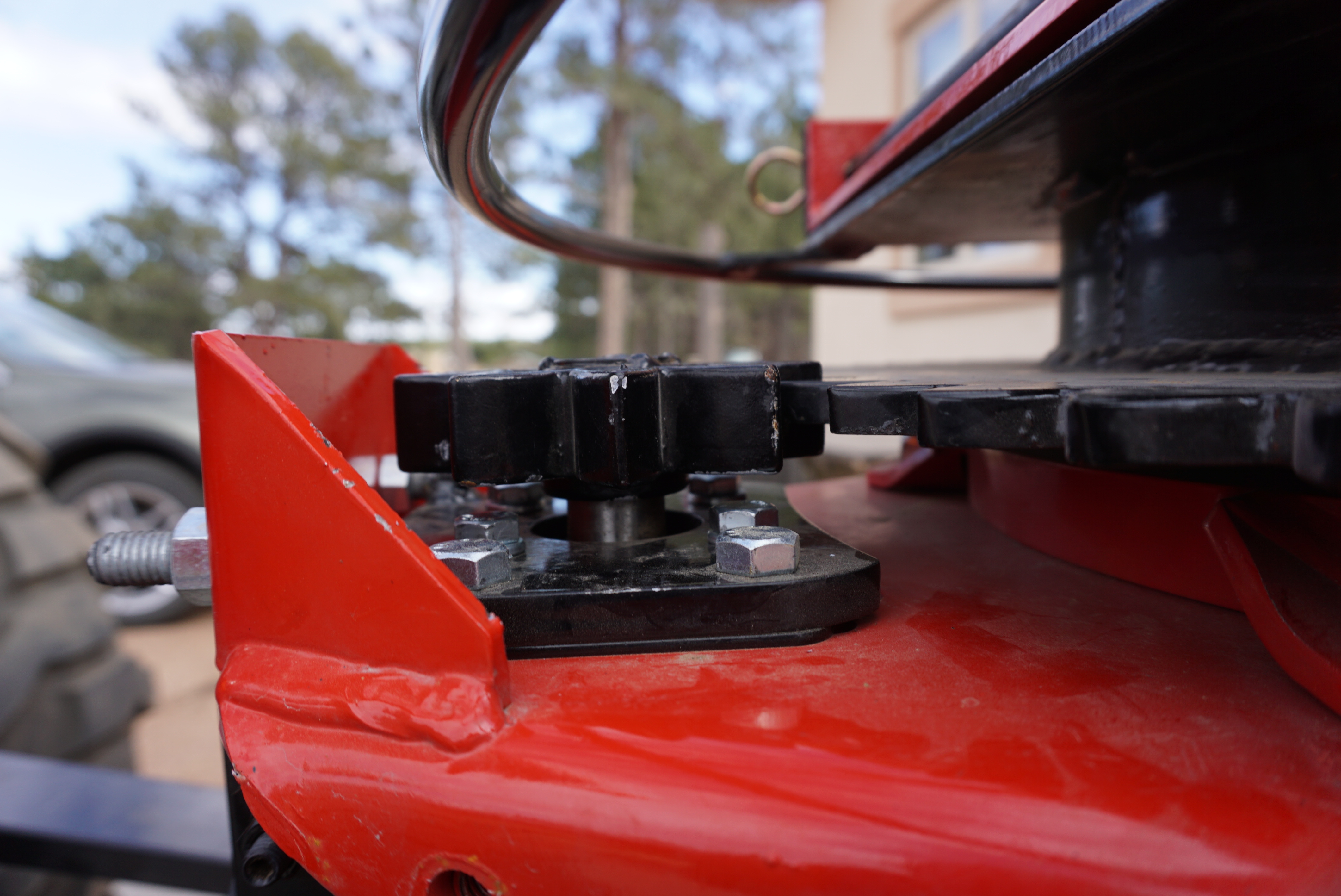

#40

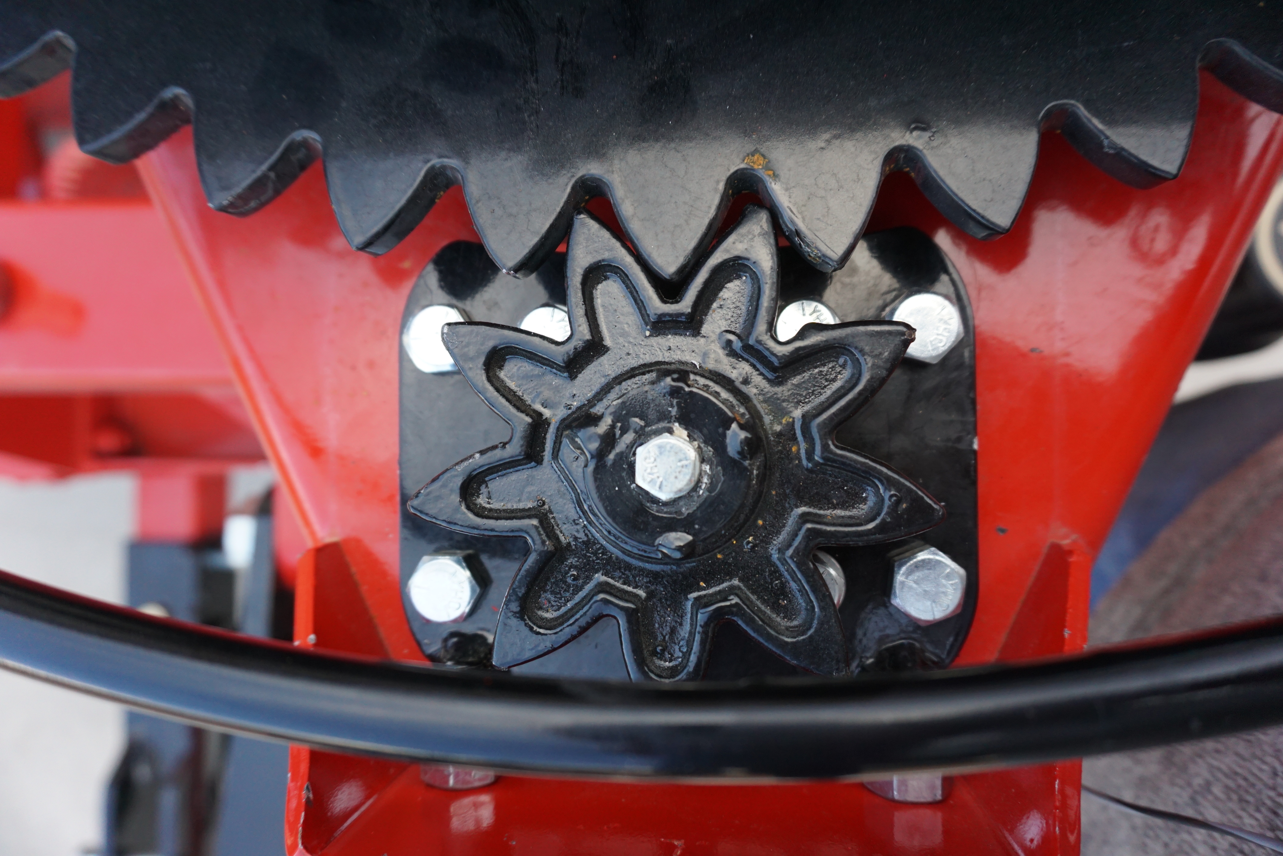

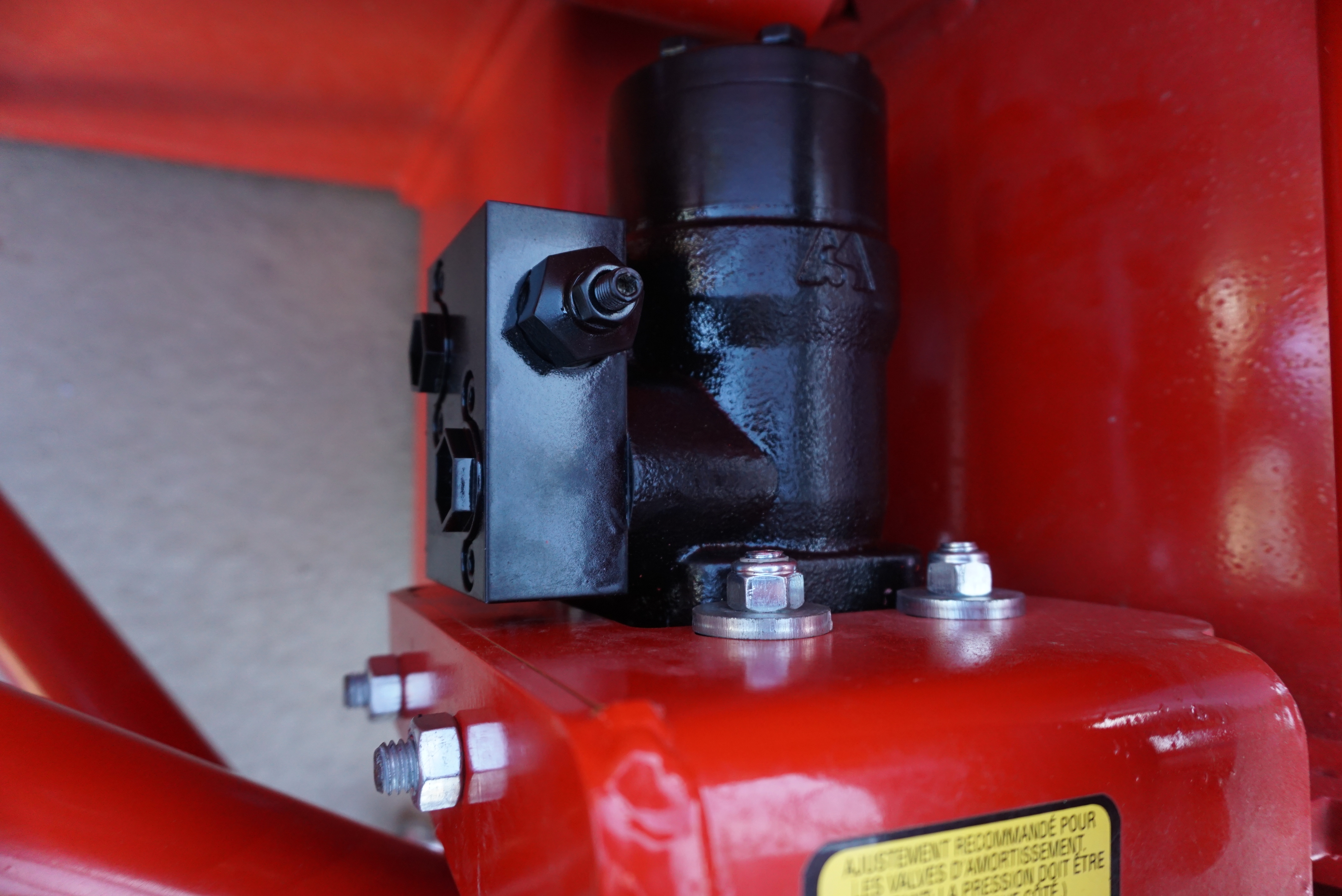

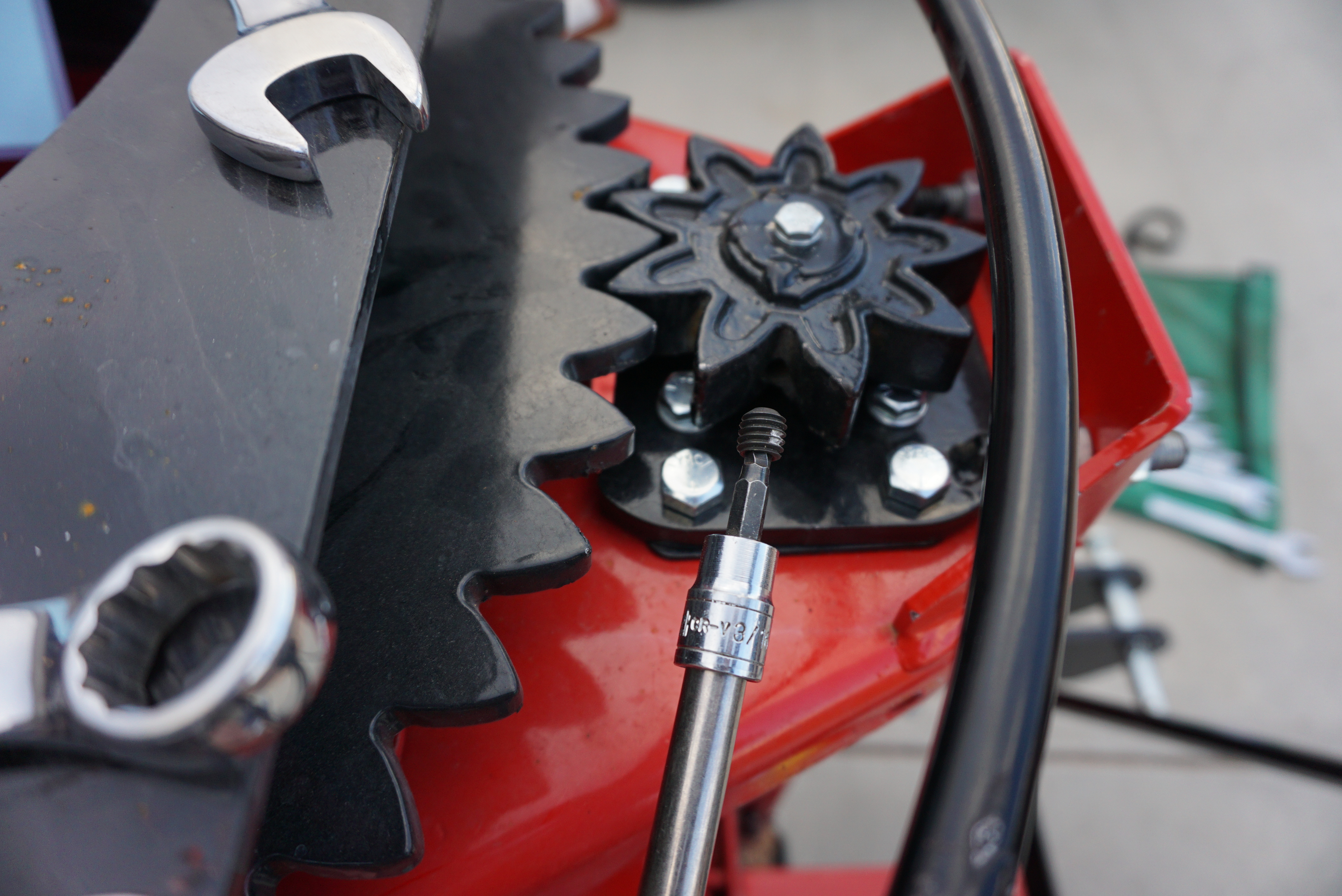

When I first put the chute rotate motor on I noticed it sat really low. The manual says they should sit relatively centered on the gear theyre driving. I adjusted mine with a couple of fender washer to raise the height. In the first pic you can see how flush it was then in the second you can see the new height.
