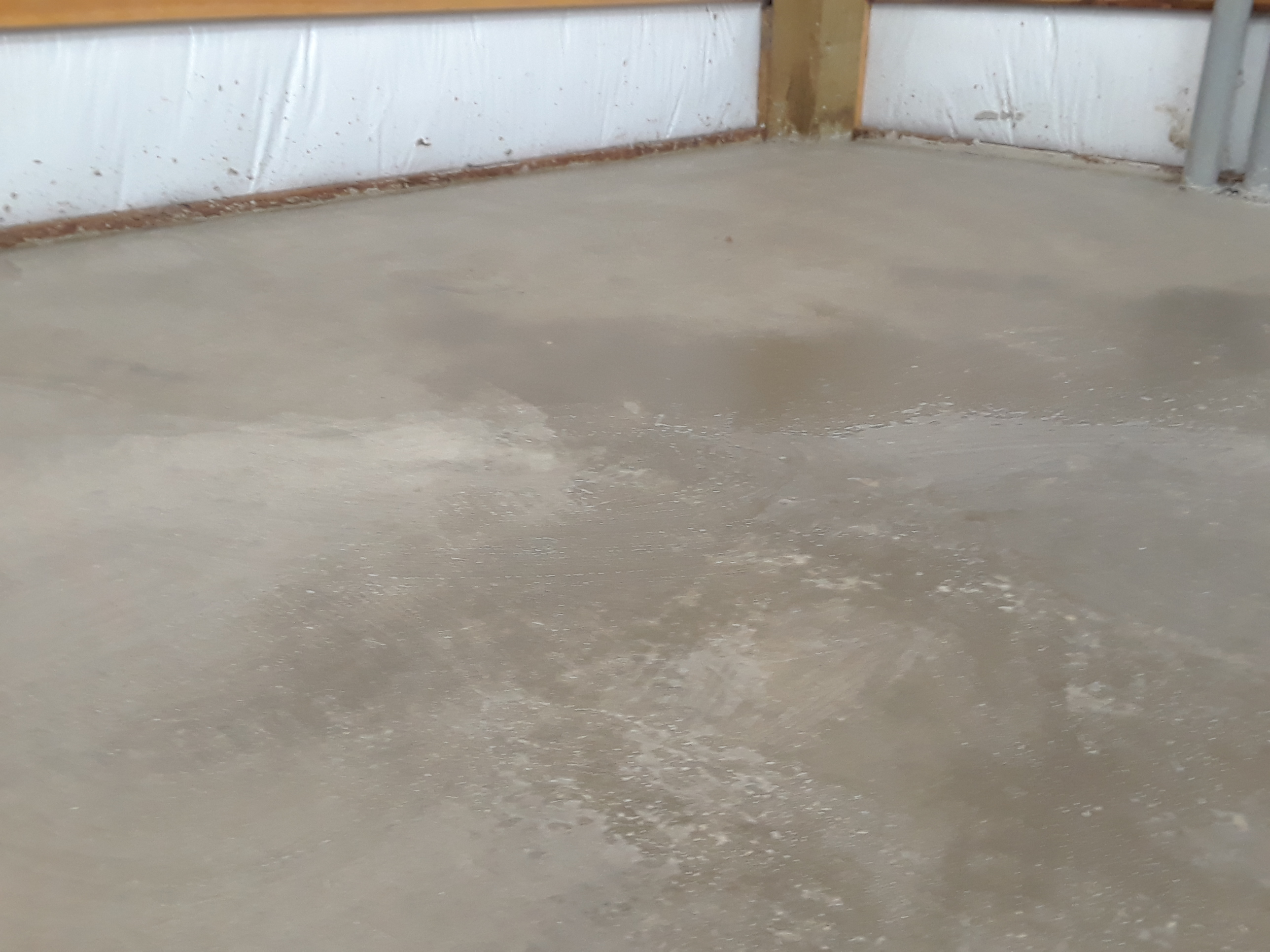

The above picture does look bad, holy cow... I need to stop using the stupid phone... I tried a couple tonight but they didn't work great either...
   / New shop build, beginning stages with questions
#254
Ok, I think these are better...
It looks much better after I mopped up on Thursday night...

You may have mentioned it but how far apart are your saw cuts on the floor?
#256
I don't think I did, but they're all close to 12' apart which is on the edge of recommendations I think... For the most part I just went post to post, around the lift area I skewed that a bit further out...

If it makes you feel better although they recommended closer cuts here I did 12 feet spacing on the cuts. After nearly 25 years only one tiny hairline crack and everything is level and no spreading etc.

I'm not worried about it or I wouldn't have done it :). That is good to hear though. I'm pretty sure I won't have too bad of a cracking problem with a ~5.5" slab with rebar and cut on top of a native soil base and the gravel had the jumping jack ran over it 3 times...

"Final" inspection was a flop, they want more money... apparently there's no "for future use" in the plumbing world and apparently I need a permit for the radiant heating... Apparently the plumbing permit is $250ish and the heating permit is $54ish... so I have that to deal with, and I didn't realize the electrical permit stuff has to be done first... apparently this county is more stringent than some... Whatever, that's not too bad
Anywho, that said it's now been 4 weeks since the slab was poured, I put backer rod down into the saw cuts then put in 10 tubes of Siki Flex self leveling goo then put a coat of "25% Cure and seal" over the whole thing today. Now that it's dried I plan to start moving some stuff in to it tomorrow assuming it doesn't rain too bad... I have the forklift deal on the tractor so I can move the tool box over...
