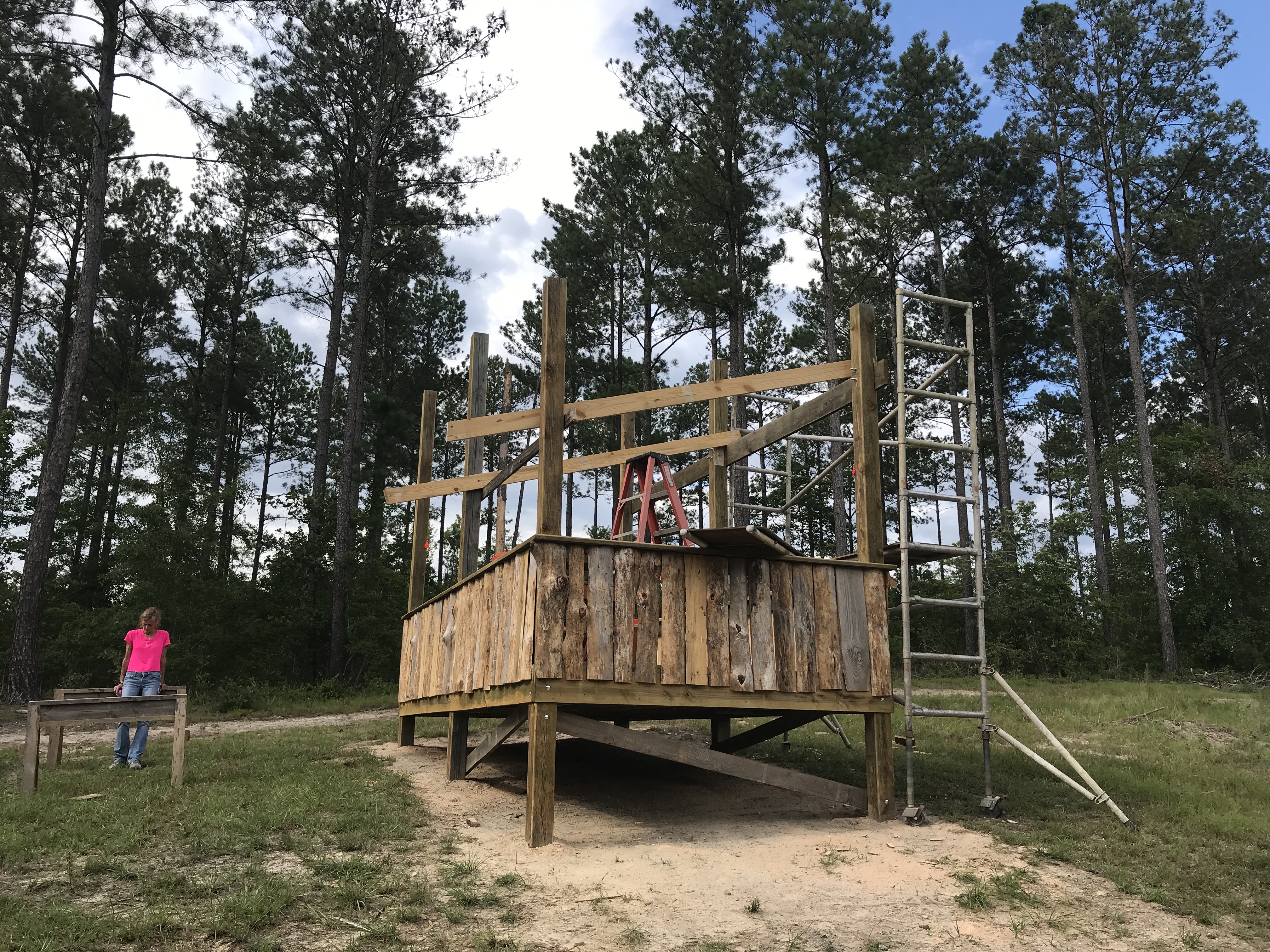

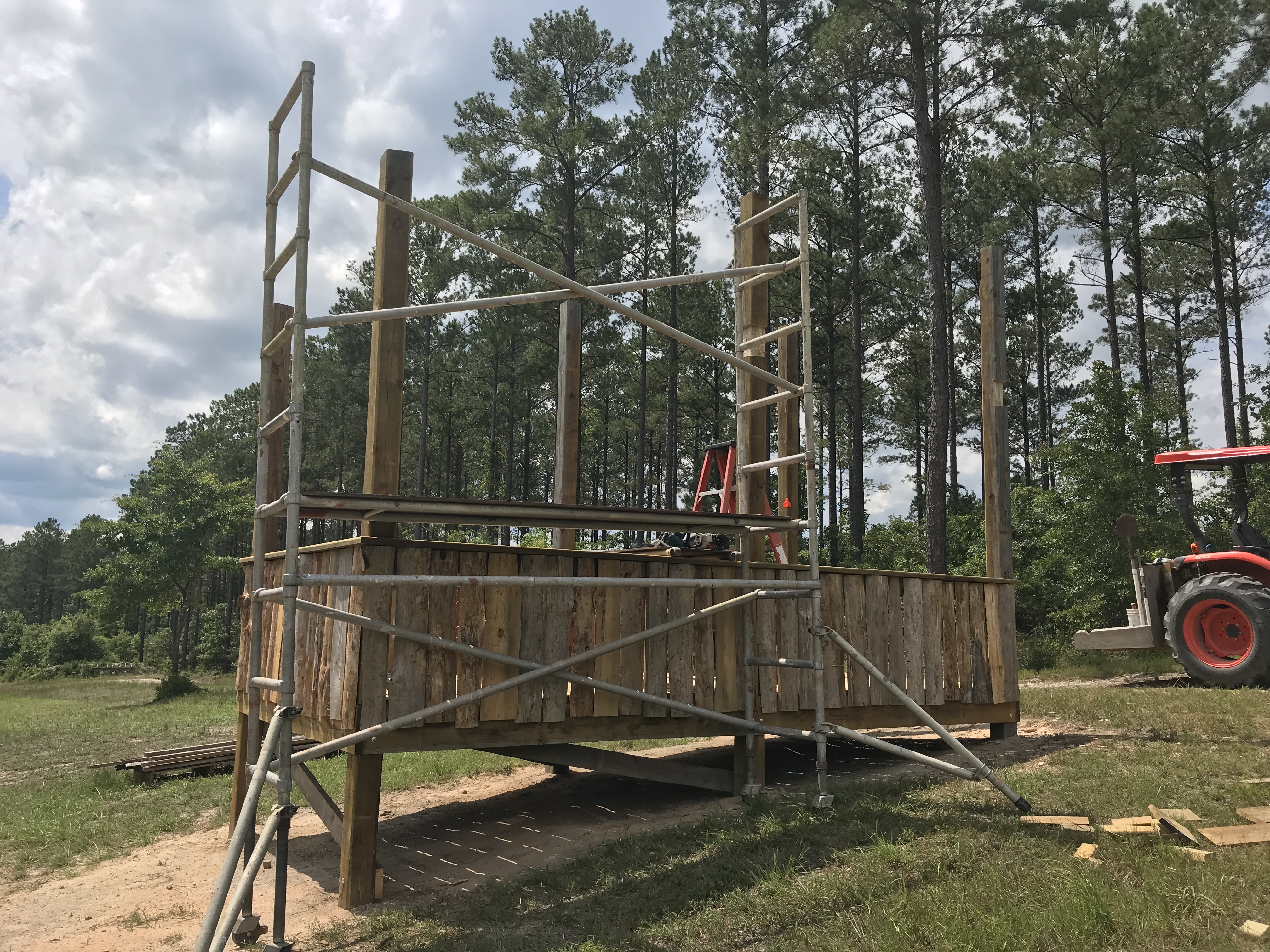

Ok, I got out and got some more work done on the range..
Got out the scaffold for some higher stuff

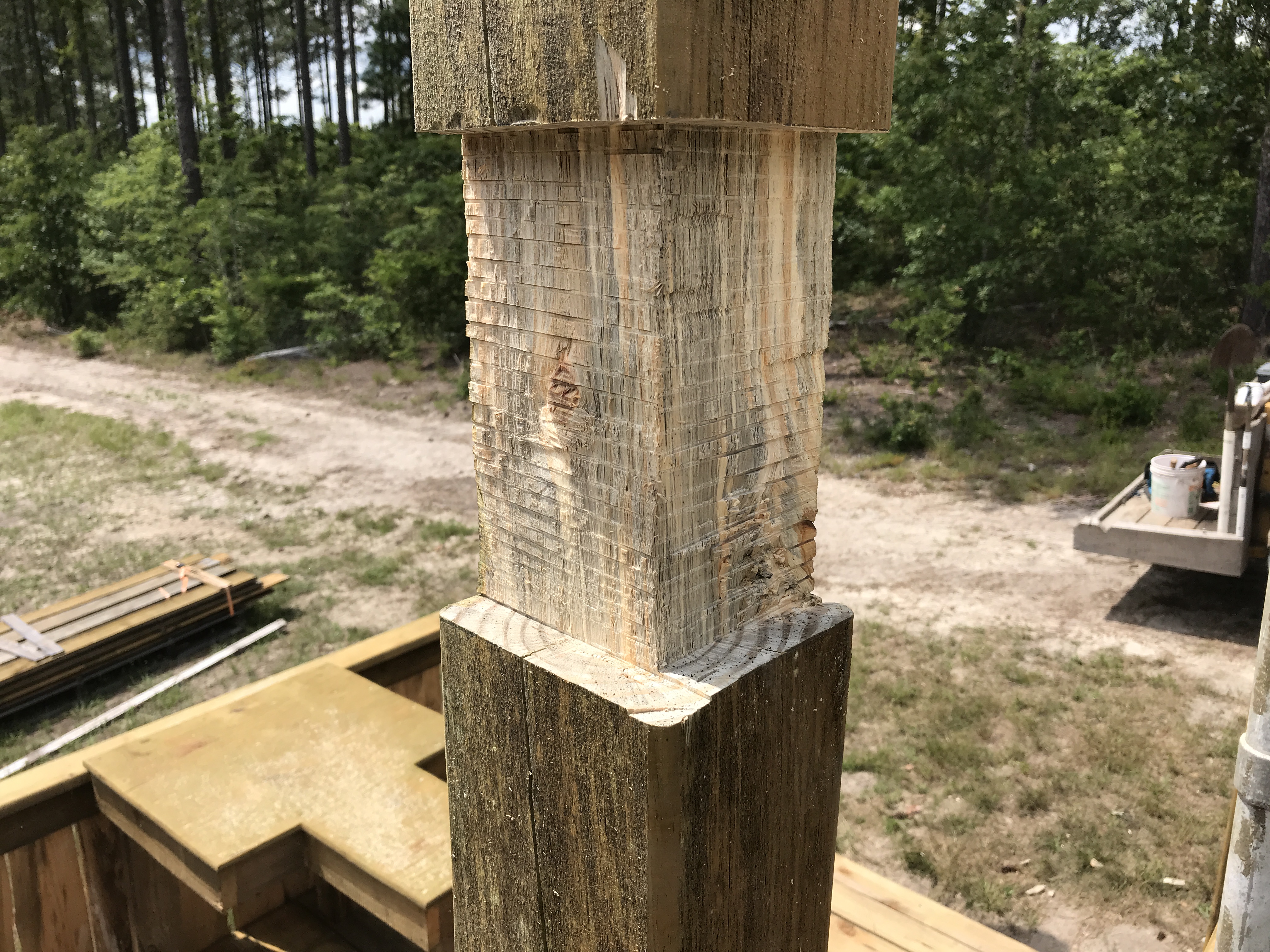

Yup, a bit more notching.

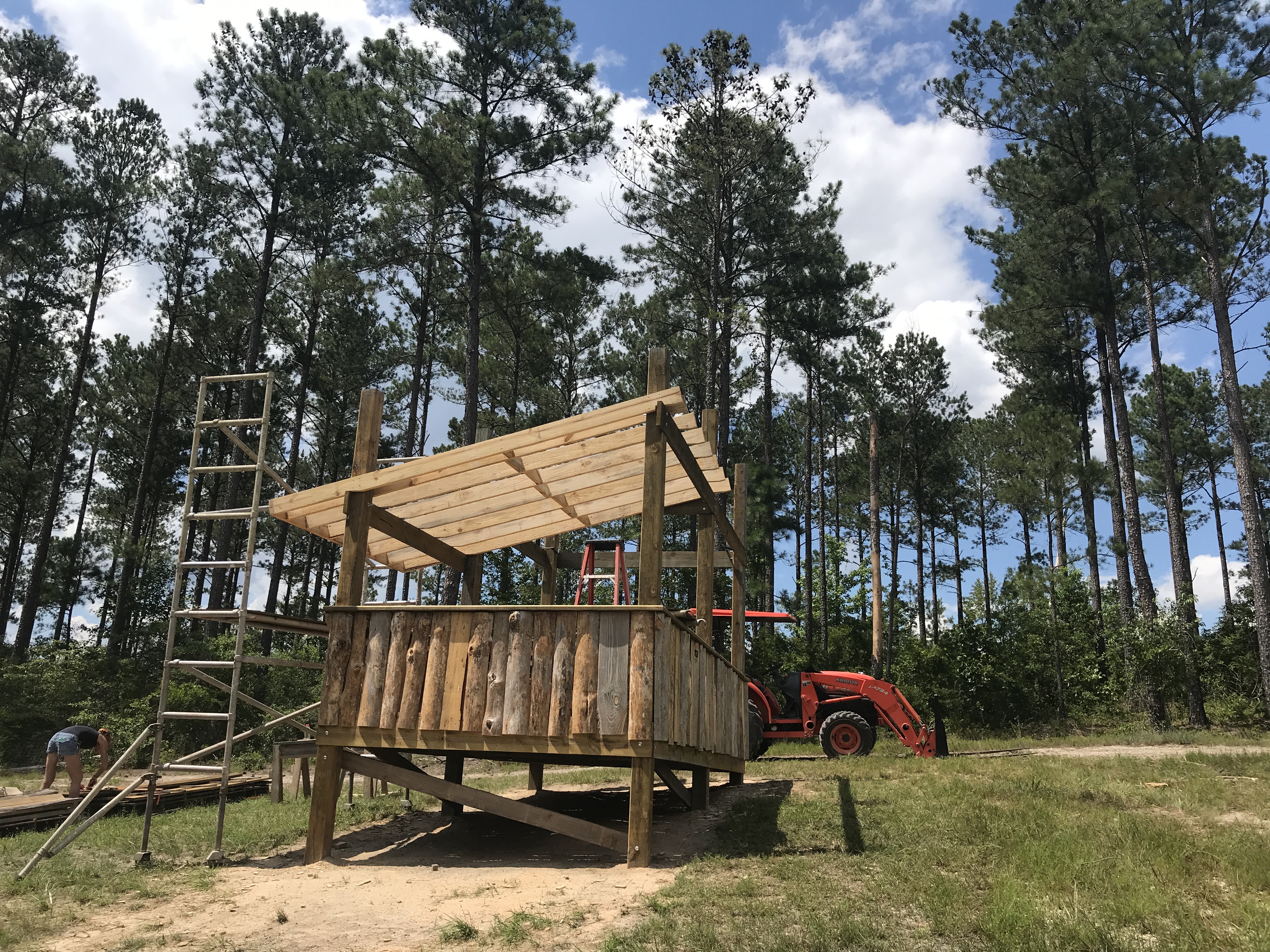

Playing with angles for the roof pitch
Roof mostly done on the one side
If you look at the right side of the structure you can see the rim joists for the elevated part of the stand.

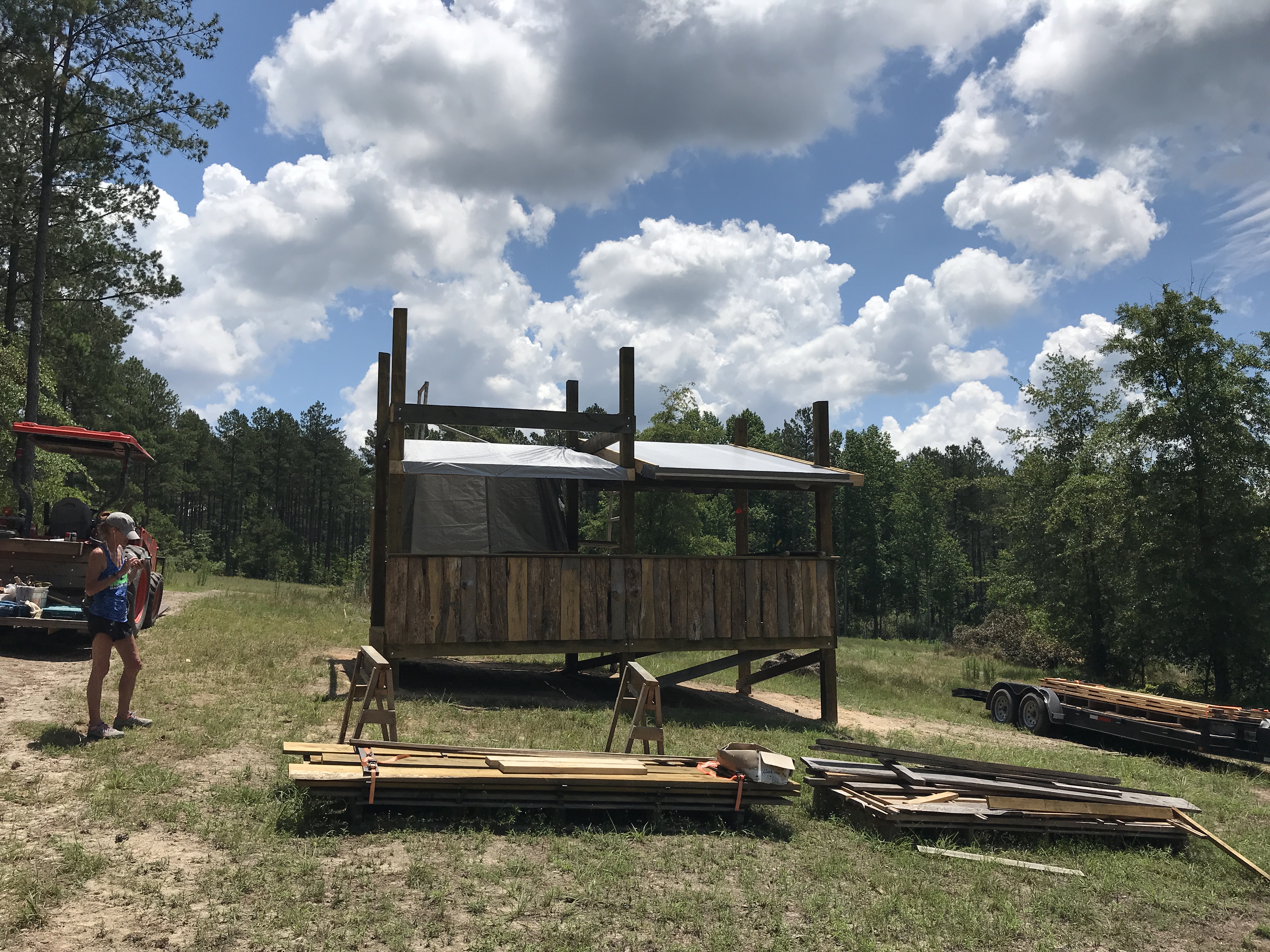

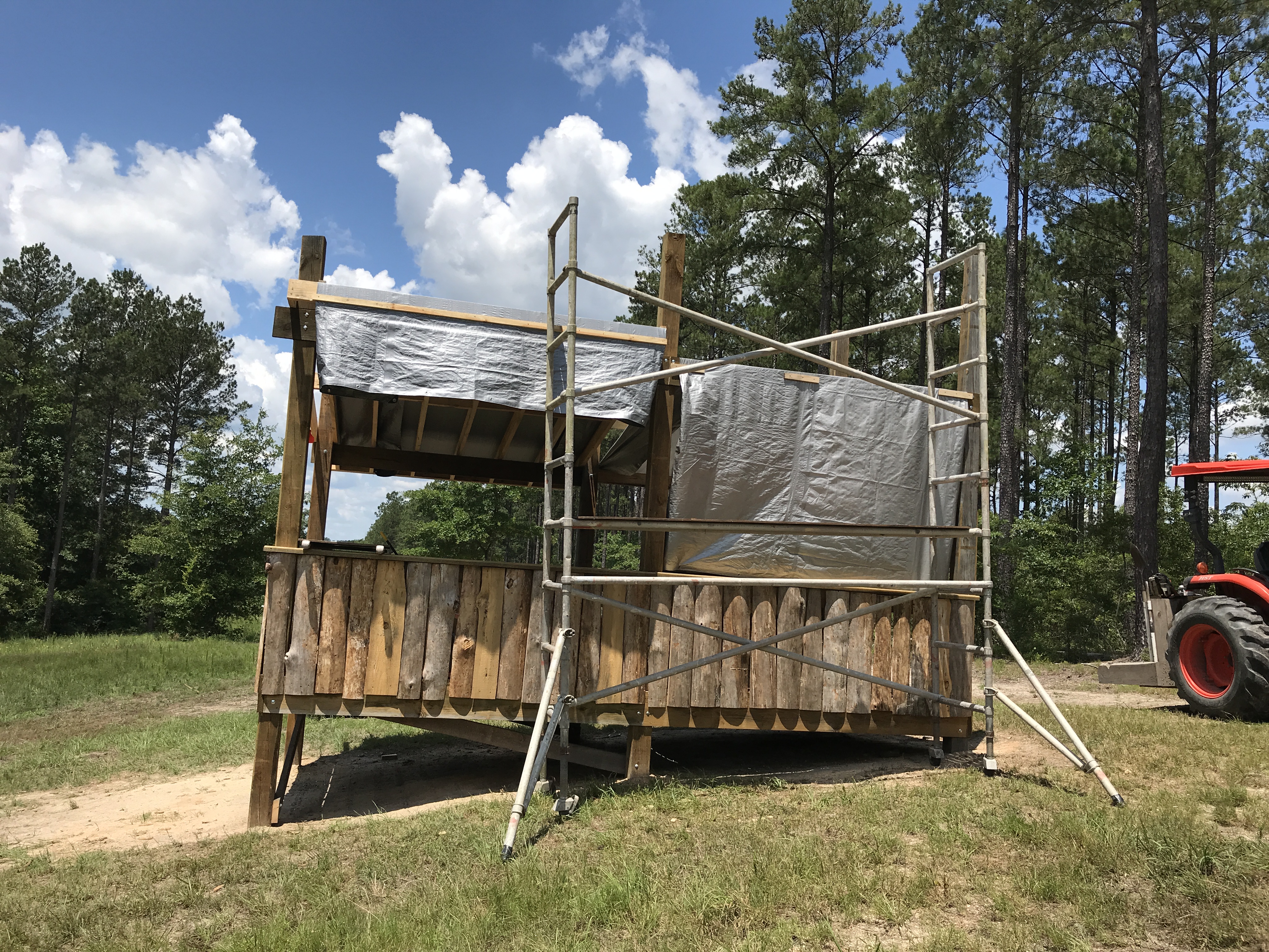

So I'm running out of time before my family gets here for vacation, and I need shade out there so I installed a deluxe genuine Harbor Freight temporary roof till I can get the upstairs built and finish the roof proper like.:laughing:

Coming along nicely. Will you be adding another board to your beams that support your roof so it's a lot stronger?
   / New shooting deck
#88
Explain what you mean please..
I have 2x6 rafters sitting on 2x10 notched in "rim joists" with only a 9 foot span either way and thats plenty strong. If I lived somewhere that might get a couple 3 feet of snow I may need more, but I don't get that here(I would move if I did). Most I've gotten at one time here is less than an inch.
   / New shooting deck #89
A single beam is much more prone to failure over time. If it was mine, I would add another beam to the inside of the posts. It's cheap insurance and easy to do now. All it takes is one defect in one of those beams to cause failure.
   / New shooting deck
#90
Na, it'll be fine.. but thanks. Defect in one of those beams you say?? HA!! I grew those trees myself!! :laughing:
(I might ) Thanks.. a little backup never hurts.
