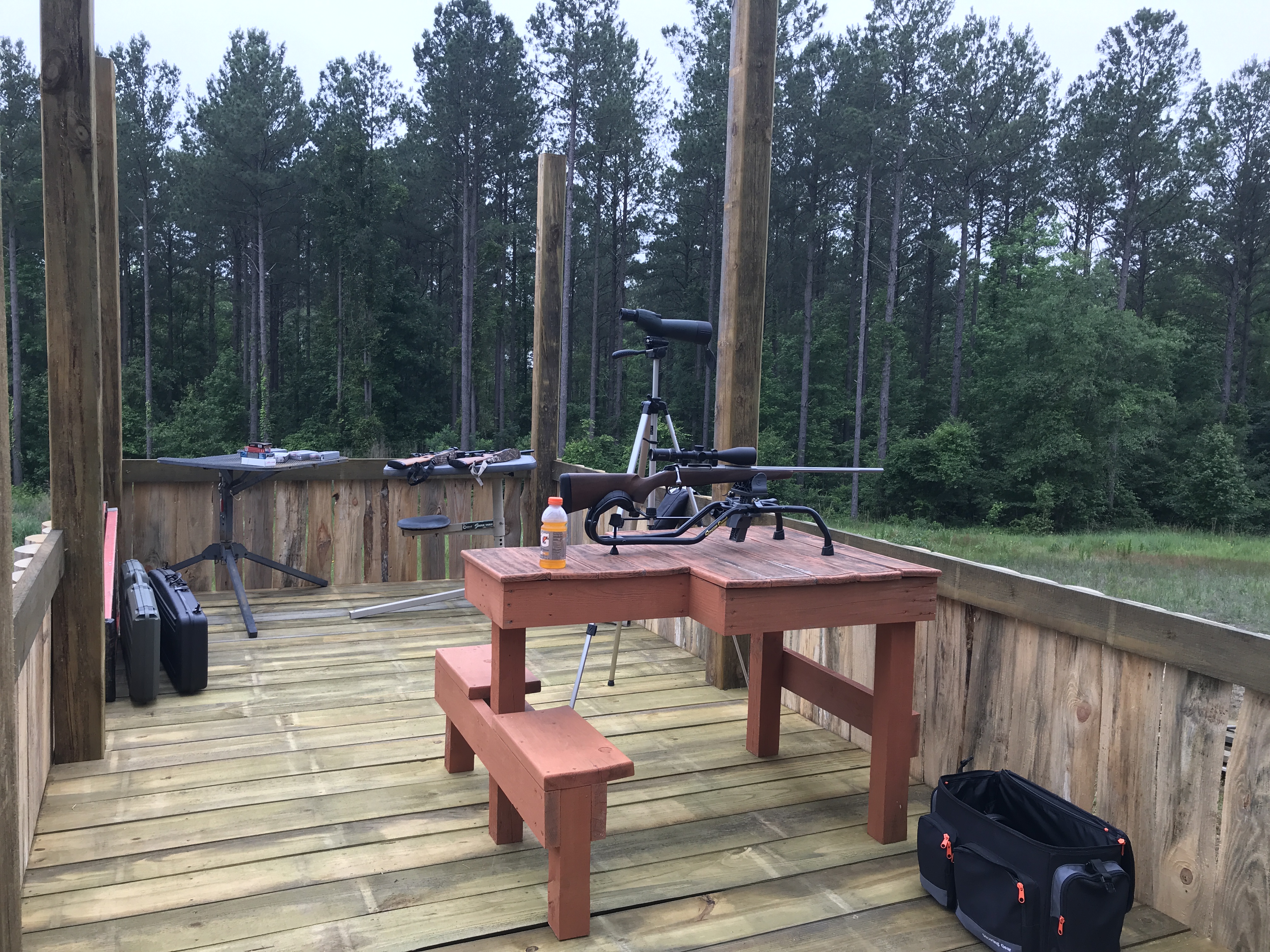

Went out shooting yesterday morning.. 94% humidity , I was dripping wet by the end.
Some prerequisite thumpers

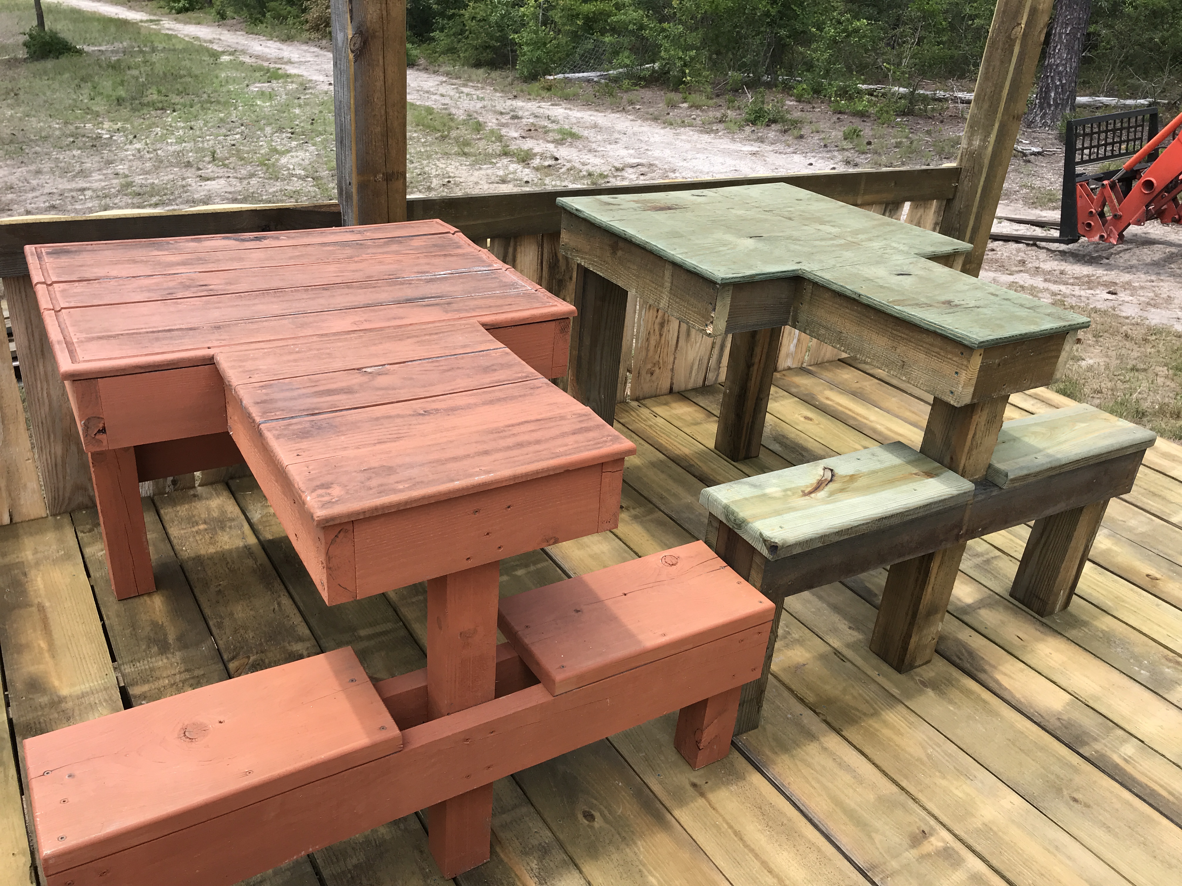

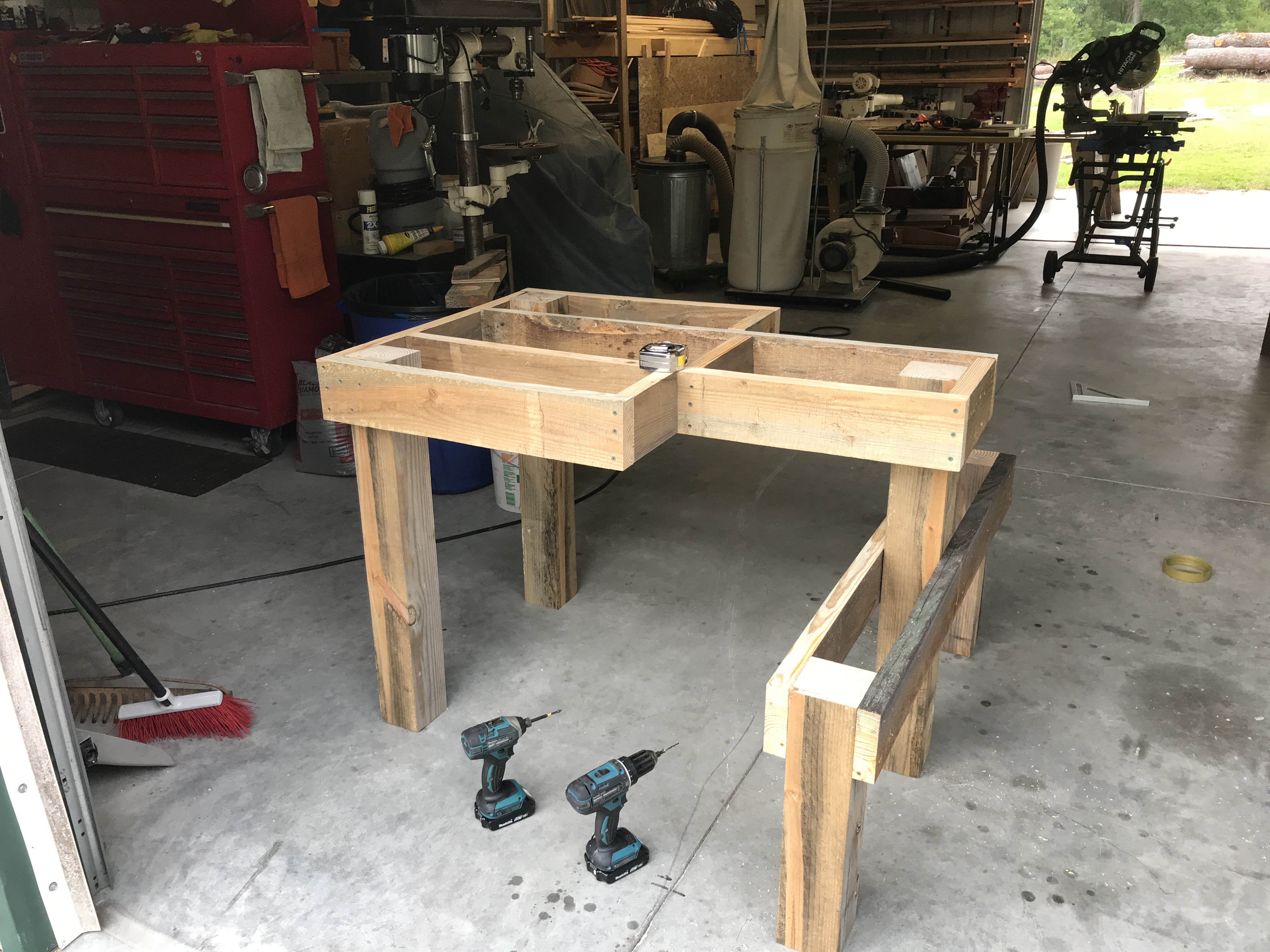

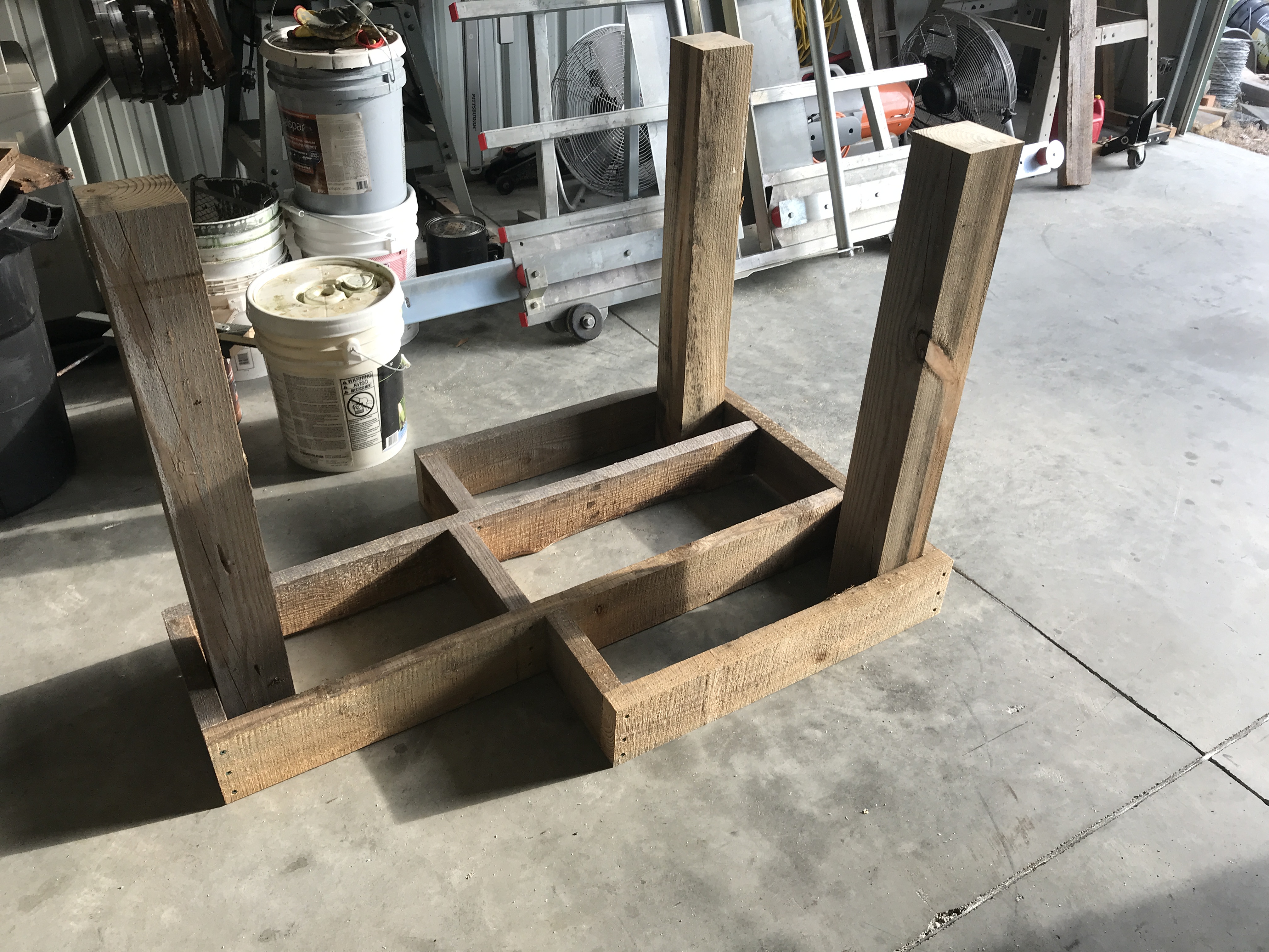

Wasn't real pleased how my little bench was working out with my new rest... so I built a new one this morning (just needs final assembly after treating it).

What is different about the new one vs the old one?

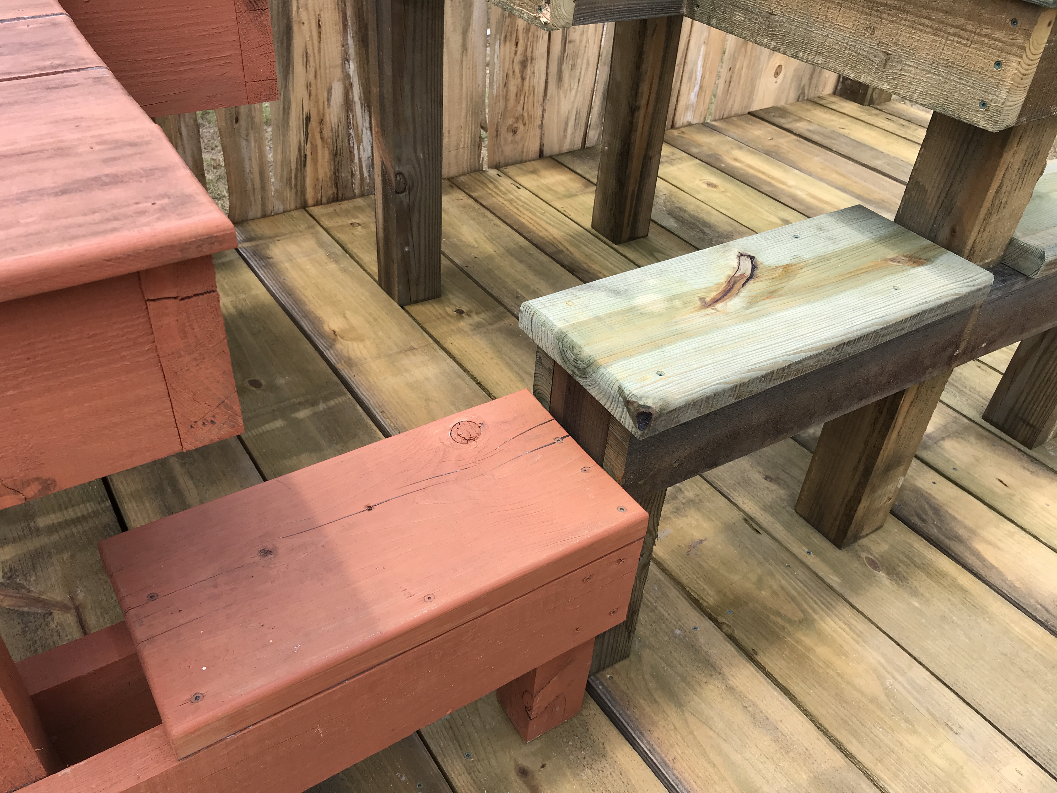

First one has a sectioned top, gave me some problems with moving the rest around. Second one is getting a 3/4" plywood top. I'm not big on using plywood outside, I triple coated it with preservative we will see how it does. May add a coat of paint.. maybe
Changed the leg height to give me a better sitting position..
Changed the distance between the seat and the top to better facilitate a better shoulder weld on the gun. Less of a crouched feeling.
And made the whole thing 5" narrower, did not need all the width of the first one.
The other day when I was shooting ,I took a tape measure and took measurements and notes on things that concerned me.. hoping this is a good improvement.
So I got the measurements/plans for the first one (brown) off the internet, and as I like to do with everything I altered them to fit my purpose better.

I like the bench, but that makes me ask, do you know a lefty that uses the other seat of the bench??
I do not, but you never know. Also someone can sit there and catch the hot brass!!:laughing:
The width gives the bench more stability also.
