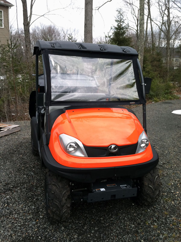

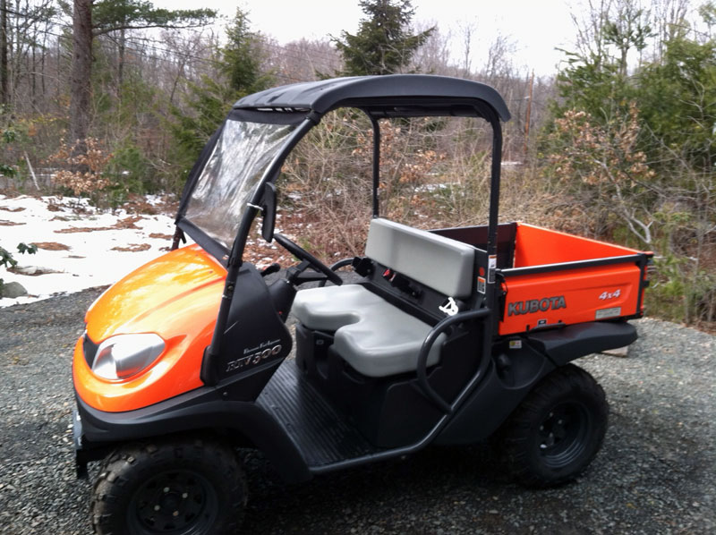

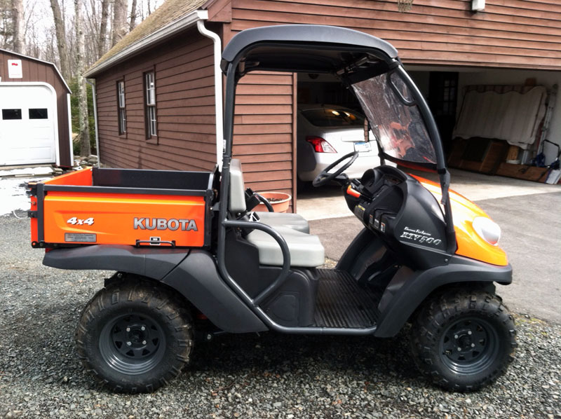

Another happy Barlow purchase. This is the third item I have purchased from Brady and they all went smoothly :D
I actually took delivery the middle of January but I wanted to clean it up before taking some pics for TBN. It got pretty dirty in transit from Kentucky to Connecticut. The weather has not been good enough until this weekend for me to get the hose out and clean it up.

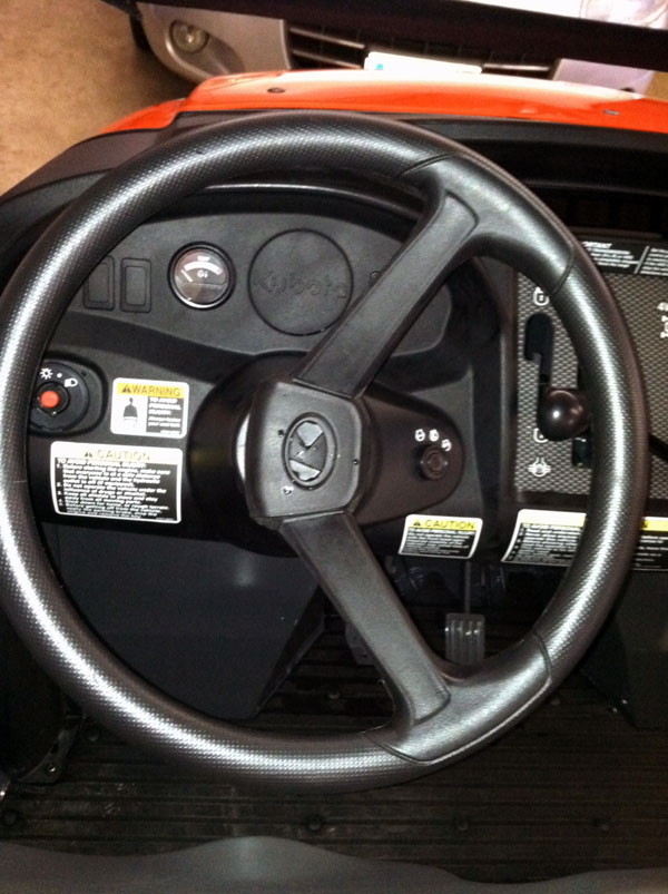

The only weird thing is the steering wheel does not appear to be centered? I know with tractors the streering wheel basically spins due to the way the power steering works but I do not believe the RTV500 steering works the same way. I need to find out how to remove the wheel to correct it. Anybody know how to do it?

The steering wheel pic shows her Sebring in front of the RTV in the garage.

Very nice...I loved my 500...Centering the wheel is easy, lift pull the plastic cap, remove the wheel nut and pull the steering wheel off, might might some very light "help".....Make sure you're tires are straight and re-install..Might take a couple of tries if you're going for perfection.

Will attempt to align the steering wheel this weekend. Brady sent me the same instructions and it sounds pretty easy.
