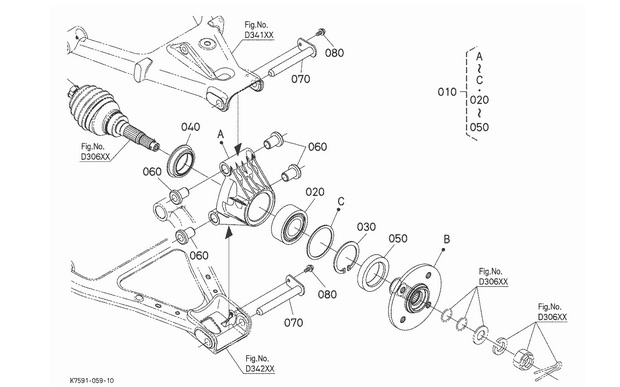

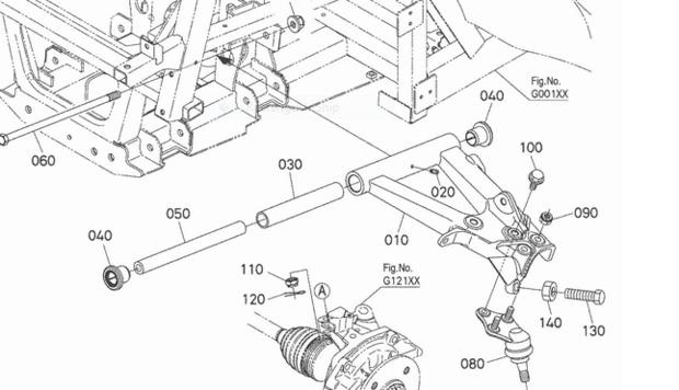

Can someone please post pics of the rear suspension and driveline? Also pic of aluminum hub carrier would be great!
   / New RTV-X1100C clunking wheel noises. #85
Papa see if this helps first pic is of front second is rear.
   / New RTV-X1100C clunking wheel noises. #86
From what I have observed the play is in the bushing #60 and the pin #70, both top and bottom pins
   / New RTV-X1100C clunking wheel noises. #87
Hey rap it's hard to tell without hands on disassemble it could be were the bushing goes into the hub and is working between the bushing and aluminum hub.

I reviewed the prints above. The dealers claim saying the suspension needs play to prevent the "u-joints" from binding is complete HOG WASH!!!
The assembly uses CV Joints. It will have a fixed and plunge joint on each half shaft. The plunge joint will take care of providing any slop required for suspension movement. I can't believe the dealer said that!
The assembly show above depends on the bushings inserted into the aluminum upright not wearing. It's a good chance Kubota used the wrong material type here and it is wearing very quickly or the bushings were bored to the wrong diameter.
If a person wanted to fix their machine themselves they could remove old bushing and press in bushing turned on a lathe from nylon.
A fix for the issue shouldn't be all that difficult and certainly within Kubota's ability.
   / New RTV-X1100C clunking wheel noises. #89
I just looked at a newer RTV 1120. It has slop in the rear hubs... It appears to be the bearings that the half shafts go through... Either CV joints arent tight or hub nut is loose.
Once again this assembly should not have any slop!
The suspension bushings look tight but without having machine in the air I can't tell you all for certain what is loose. There's only really a couple things it can be.
If this existed on a road vehicle it would be very dangerous due to changes in wheel camber while turning, etc!
