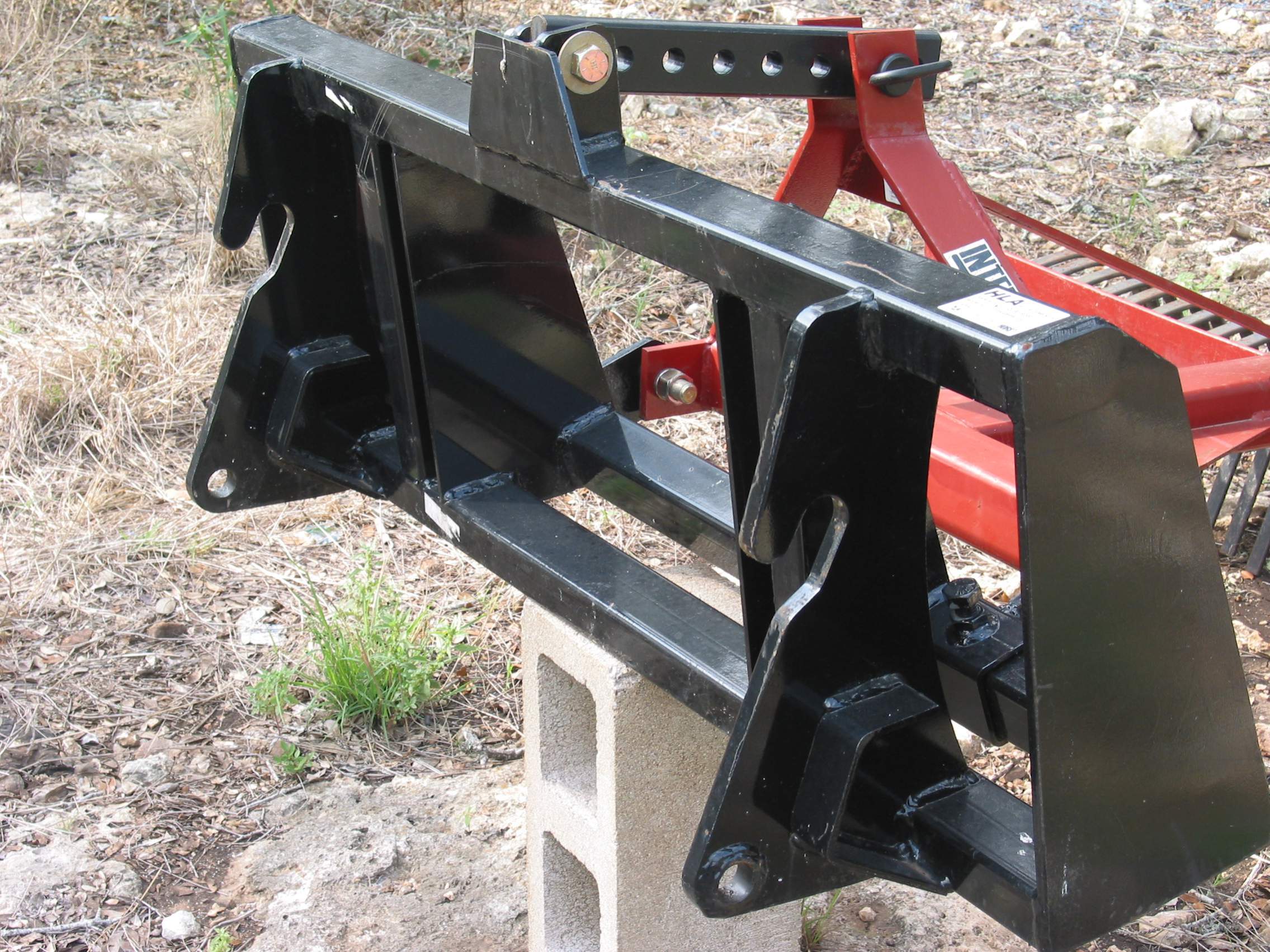

#12
I've been using this attachment to drag out many of the pear. It's a 3pt adaptor for the FEL which has a 6' rake attached. I can reach in under trees and brush, drop the rake over the pear and back out. It tears them out by the roots and I then push them into a pile where I can pick them up with the bucket. It is time consuming but is the best way I've found to get at the hard to reach places.

I took it to the property this weekend and hooked it up. I was concerned about my measurements on the QA brackets but they worked. I dropped it in front of a few pear and put the FEL in "float". Being that heavy, the bucket lies flat and catches the root as low as possible. It works great. I even pushed out some Holly. Now to find some time to use it. These days, by noon it gets too hot to stay on the tractor and bake.
