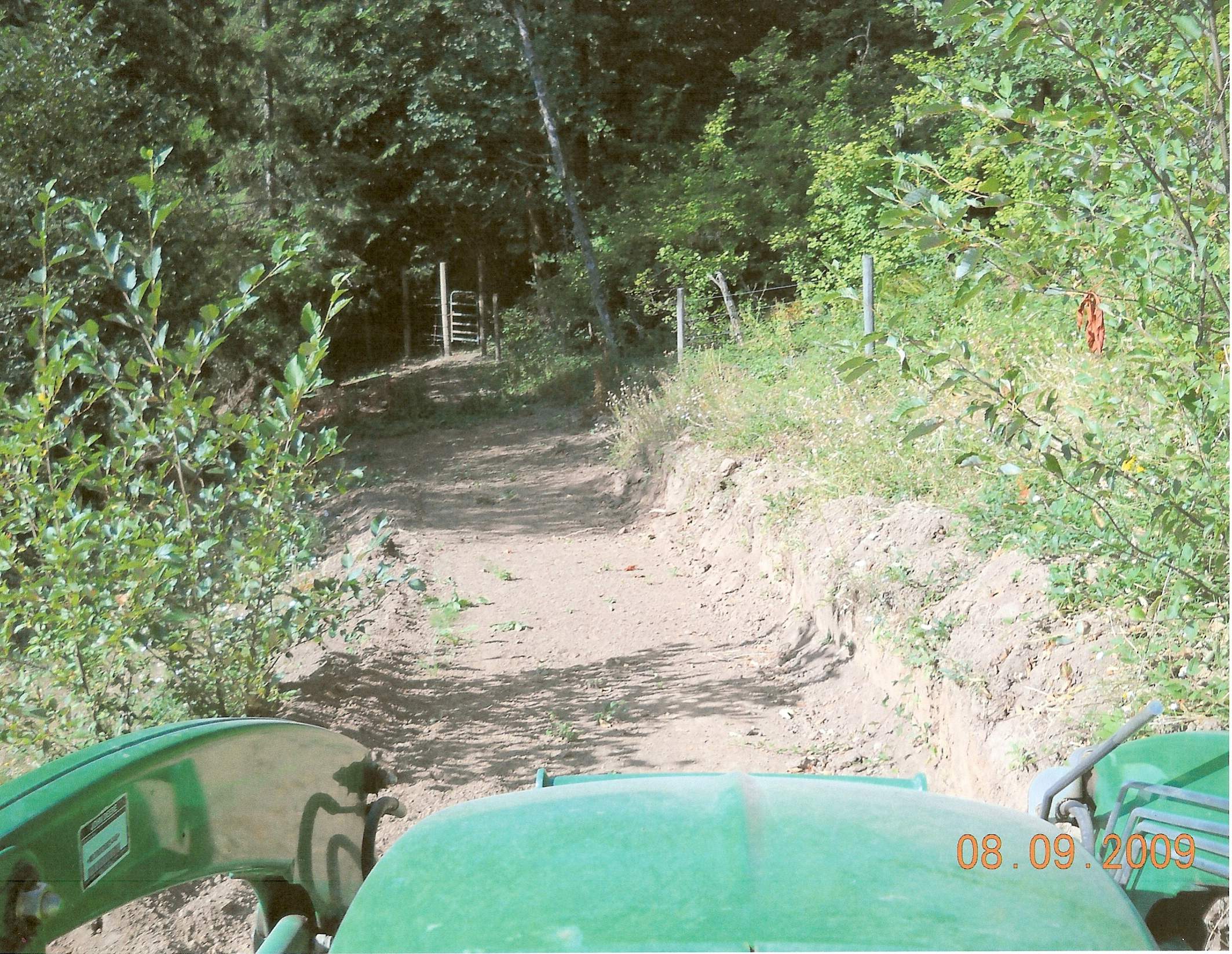

All this time, people have tried to imagine what the road looks like. Well, last night I went out there with the tractor to grade it and to take pictures. The ground is pretty hard since I dug down last time to get to solid ground. There is a but of a lip on the side but the ground is not stable enough there to use the tractor. The road is much longer than in the picture but this was the steepest spot.

Jacob, I am not sure how you plan to hold the bank back? Maybe a stone type retaining wall?

From looking at your picture I suspect your little road will be gone after the first winter. You get a lot of rain, right? The soil looks pretty crumbly? Your steep slope will reassert itself quickly. Road gone.
Don't know how much trouble you want to go to keep that path open but, in my opinion, you will need a combination of all that has been suggested so far: ditch, culvert(s), sloped hard surface, and retaining wall. Wider too.

So it sounds like i need to make the road wider with a slope on the left side so the water runs off the hill. I dont have any rocks except a small pile that is probably under a million weeds now. My step mom is worried that it will be muddy on the road in the winter, it is kind of obvious if the horses use it to get from the back corner to the barn. Some of the road closer to the barn has grass growing which will hold that part together this winter. Maybe to get that excess dirt off of the left side i can use my grader blade to pull it up onto the road, scrape it off and put it by the gate in the picture. Then I will use the skidsteer to dig a little deeper to make the road wider and on solid ground which the road is currently on 90% solid ground. I will also take pictures in the process. It will be a few weeks though since im going horse camping with my grandparents. Oregon is kind of weird, winter has mud and 3 days of dry and its all dust.

I don't know your soil type, but around here we certainly don't need retaining walls.
Yes, the bank on the right will erode some and will eventually reach an angle. I try to dig a bit extra to leave room for that. Eventually I will make another run down it to clean it up some, but I have hillside trails like that that have lasted for years without problems.
Your road looks good to me except that I would grade off the left side so that the water can run across the road and off, rather than being caught and forced to run down the road.

hear is were a good qualty rear blade comes into play.
offset it to one side with a slant and you can easly and saftly drive on the road while the 2-3' of blade reaches past the edge of the tractor and grades the material off the edge for you.
that job is one that a box blade cant do no matter how skillled you are.
