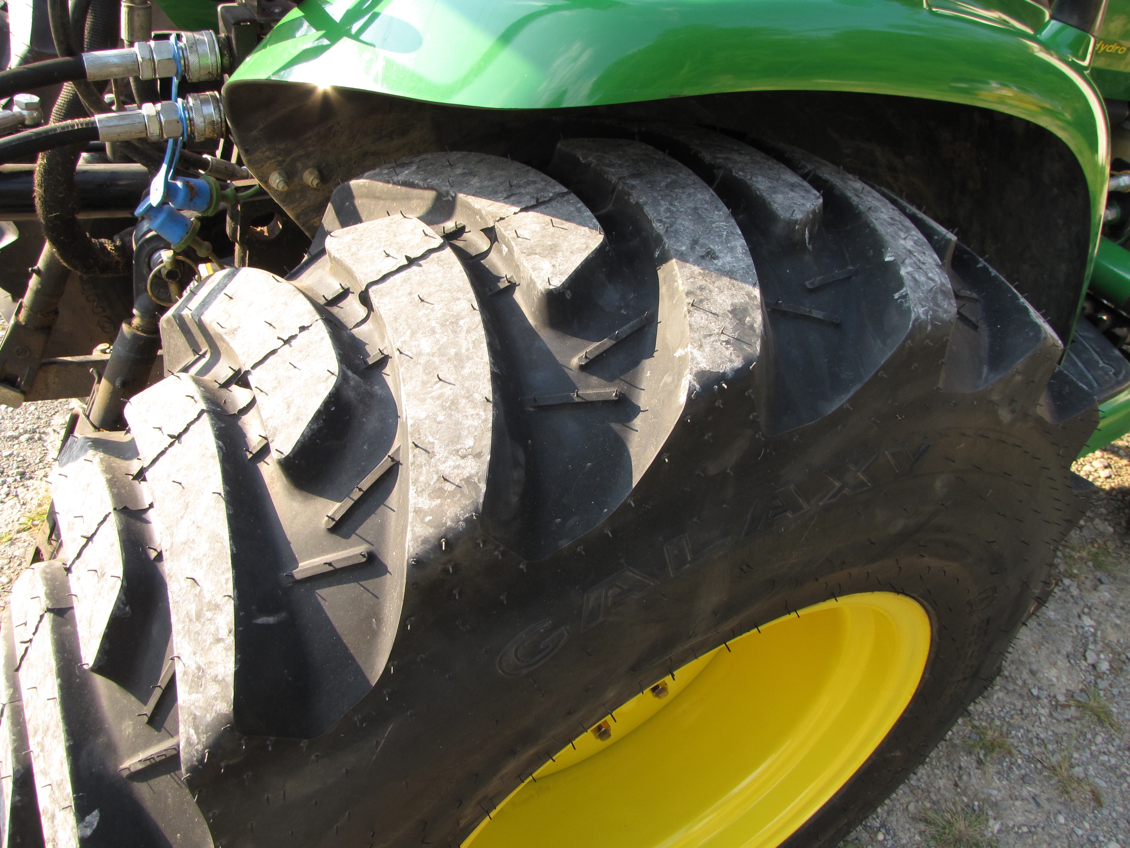

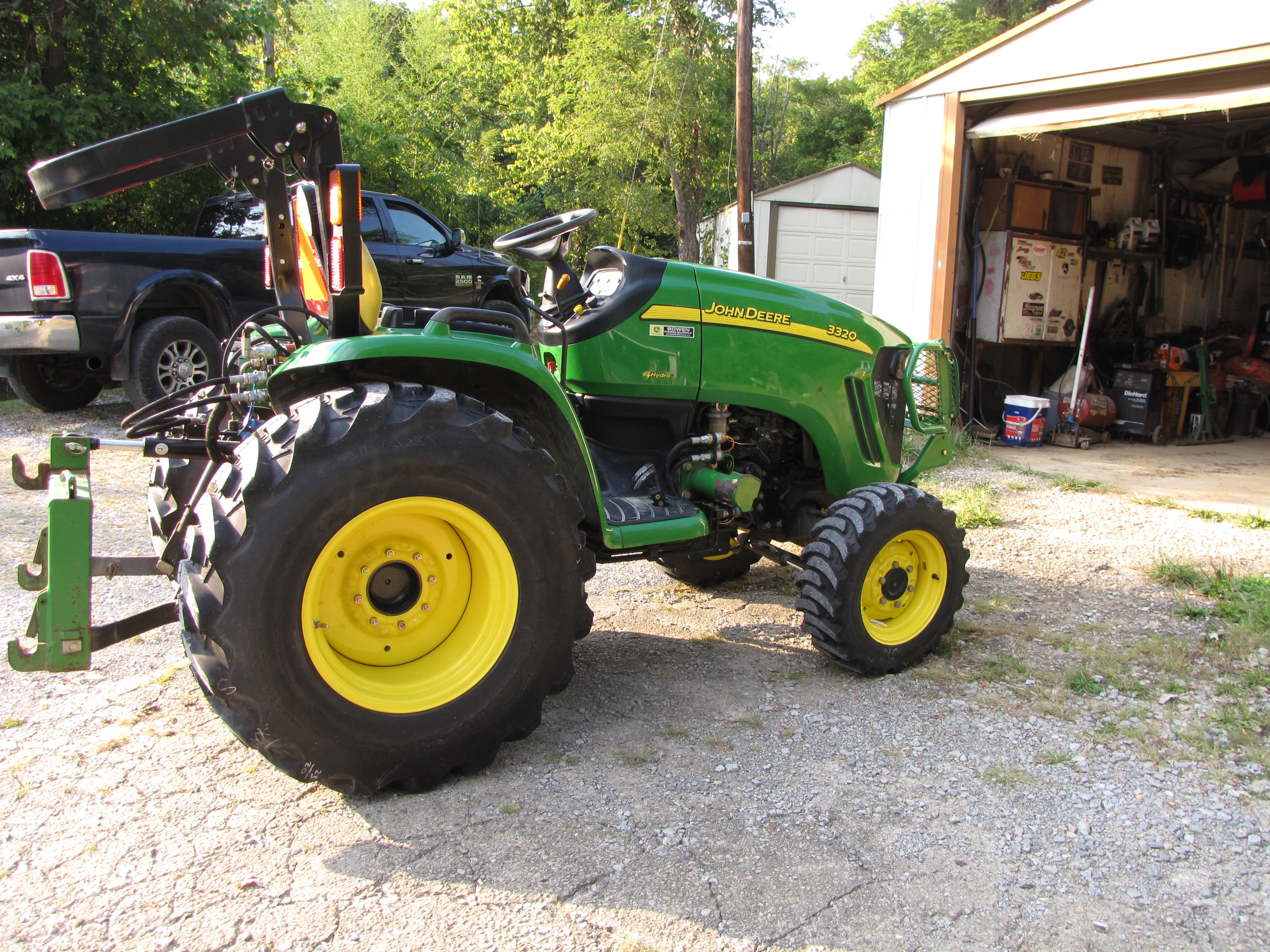

Installed my new R4 take offs today. I found this complete set on Machinefinder a couple weeks ago. Brand new with rims. They still have the rubber tips on them. Upgraded from the 19-5 R4's.

What's the upgrade? Are these larger/wider than the original R4's?
Did you get a good deal? That's a smart way to buy tires -- dealers do a lot of swapping around with new wheels and tires. Takes some time to find them but it's way better to buy a complete rim and tire!
Very cool!

Yes. I think so. $1700 for the complete set.
/ New R4's
Yes. They're the larger R4's. These are the 43-16 x 20 rears. I had the 15-19.5's before. I had one rear rim with some Calcium rust that was getting kinda bad. New rim from Deere was around $500. So, I started looking for replacements when I came across this complete set from Akrs JD in Seward Nebraska on MachineFinder. Ian was great to work with and went the extra mile to get me a great deal. I am completely satisfied. I had the rims ceramic coated for protection. I think I'm going to load them with RimGuard.
