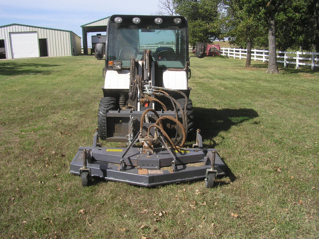

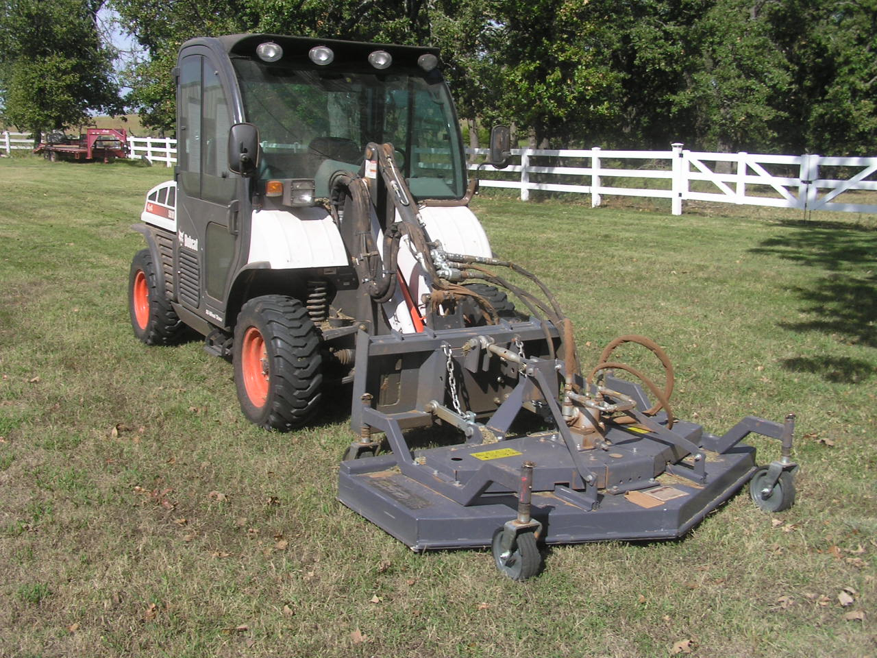

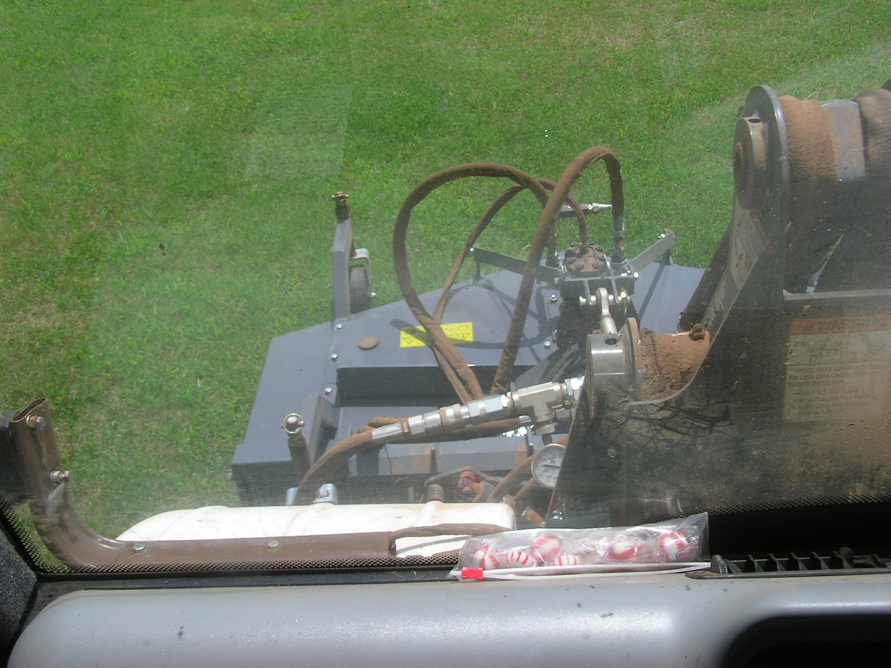

Trying to “finish mow” with a 5600lb machine would destroy my yard.
Wide turf tires are an option. No problem here with the red clay as long as it is dry:

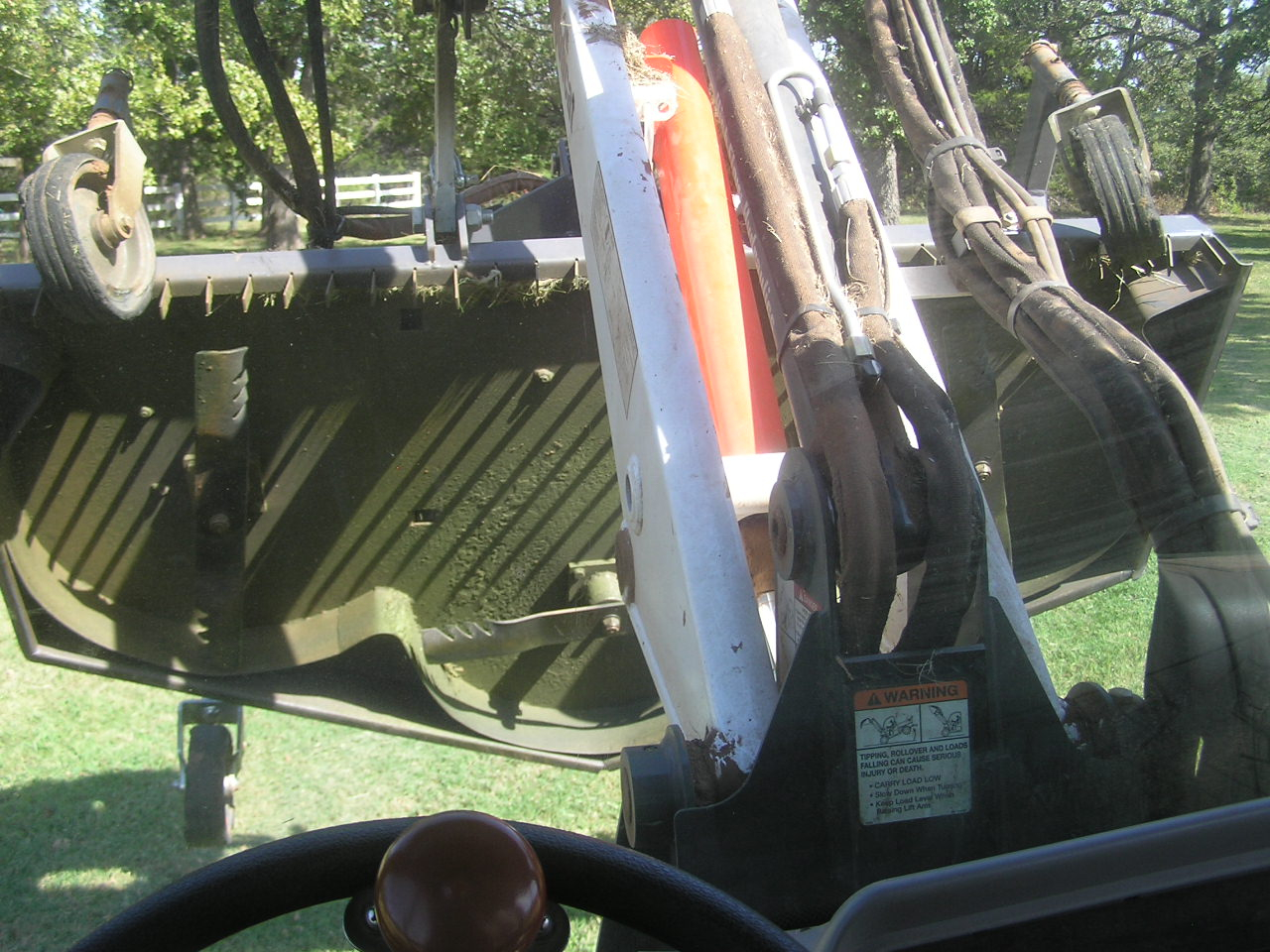

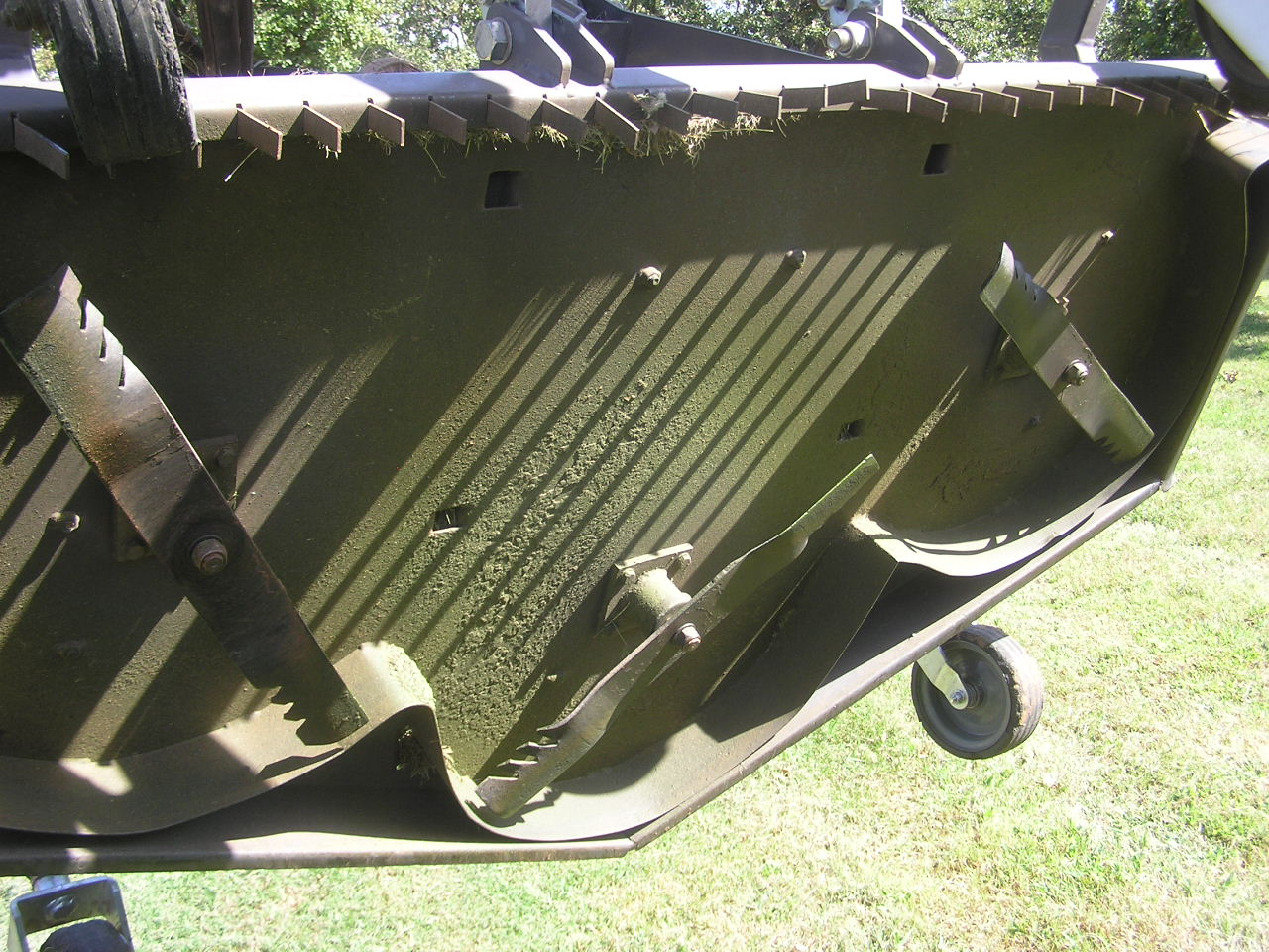

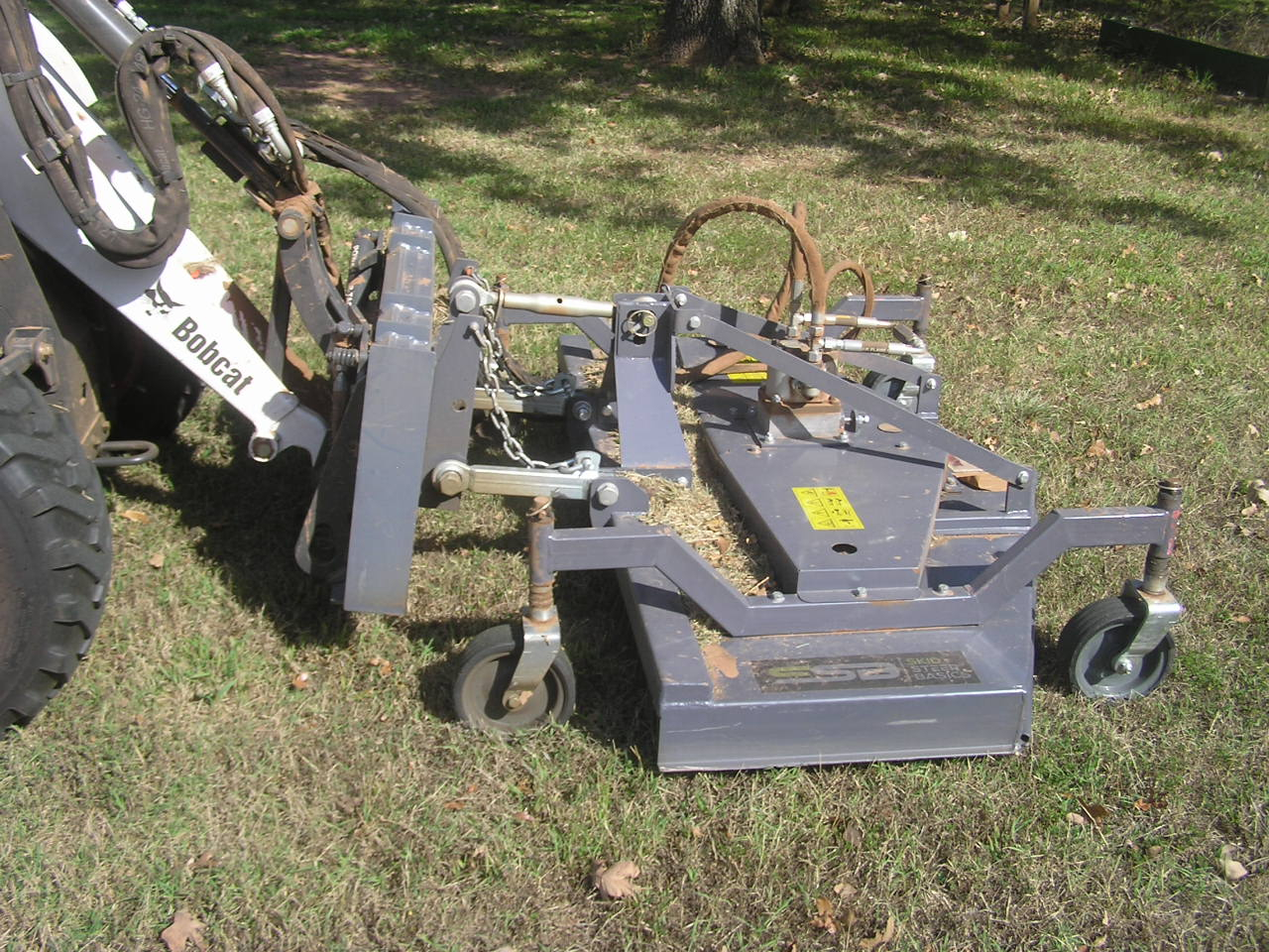

Easy to check under the deck:

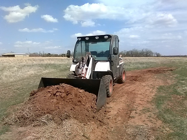

Moved some of that red clay yesterday with the 6 foot wide, one cubic yard bucket:

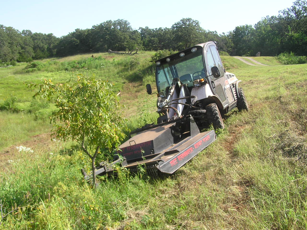

That land looks flat!
If the OP really has 17 degree slopes, I'm thinking he needs some horse drawn implements.
/ New Purchase #129

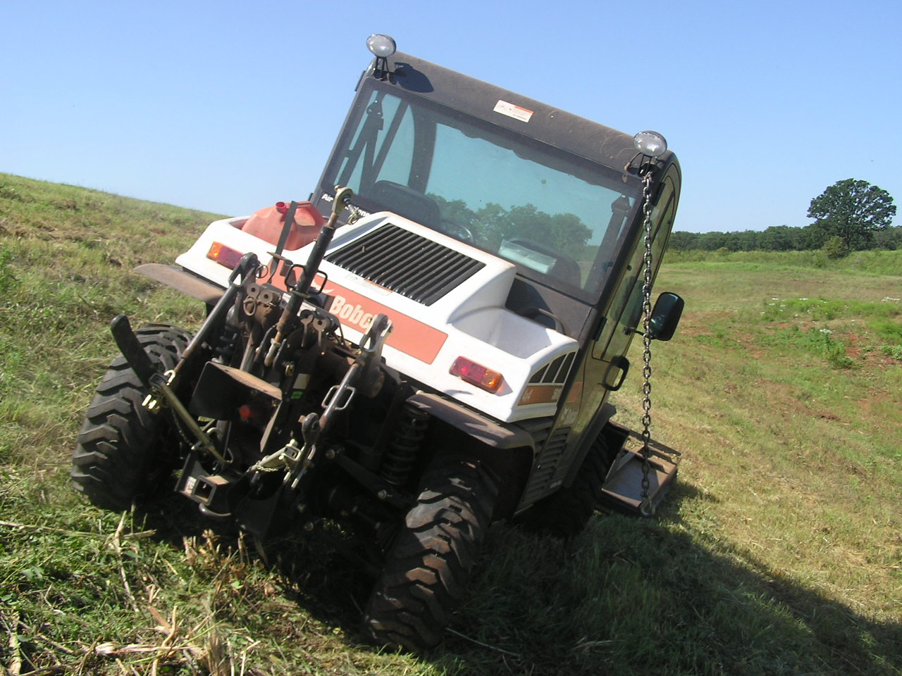

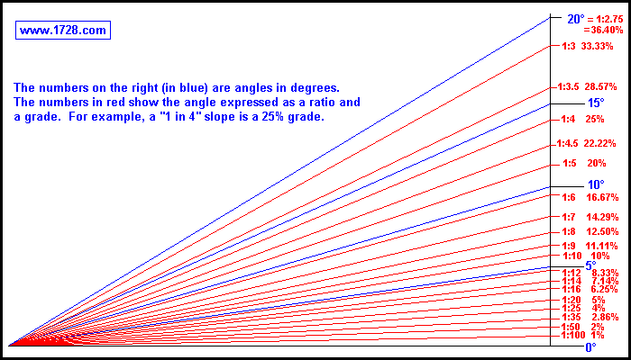

Here is the Toolcat and brush hog on a 18° slope. The chain hanging from the work light shows true vertical, even if the camera is not level:
I usually offset the rear a little, felt better with the out front weight farther downhill:
