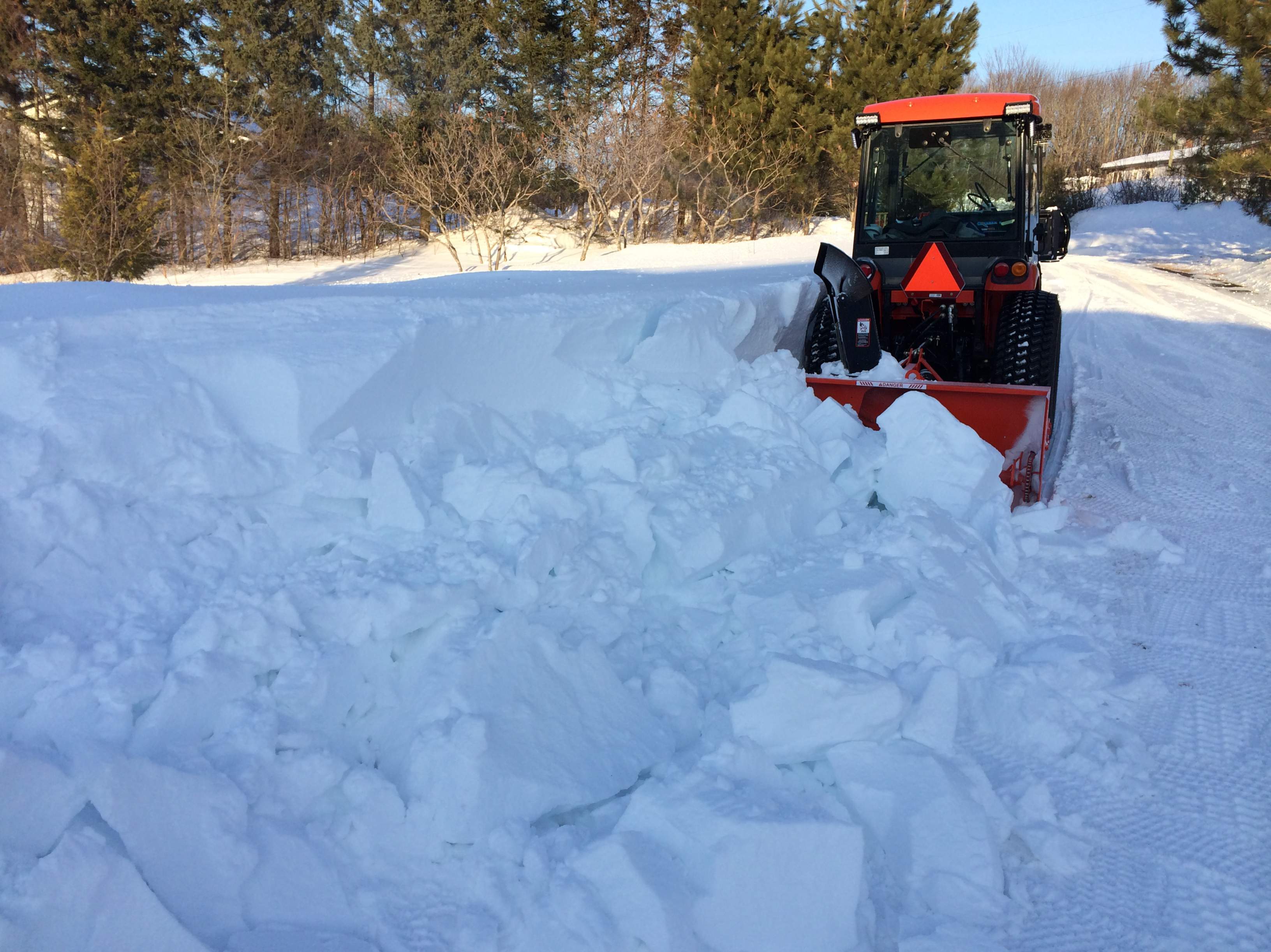

A pull type Blower would be a waste for me, I regularly get 4' - 6' drifts all the time. A pull type Blower would be useless. Even a regular Blower needs help with big drifts. 001.jpg
/ New pull type blower #54
Rear pulls are not for the little machines, you need a good "L" or above with weight.
Having pulled those banks down like you have, there would be no problem for a rear pull and
the proper tractor to drive through that. With a front blade about 1 1/2 feet up, no problem.
My L4200 would have ate that for breakfast. Sadly, it's sold.

Not so!
Here is an example of a fairly small Kubota B series with front mount blower handling 24"+ of snow with zero issue!
http://youtu.be/BGa_VbKfK8I
Obviously the travel speed is slower as it has lower PTO hp than a bigger tractor but handles well regardless
Sent from my iPhone 5s 64Gb using TractorByNet
That snow isn't even over the center hubs of the front tires on that tractor. And those front tires are not 48" tall.
