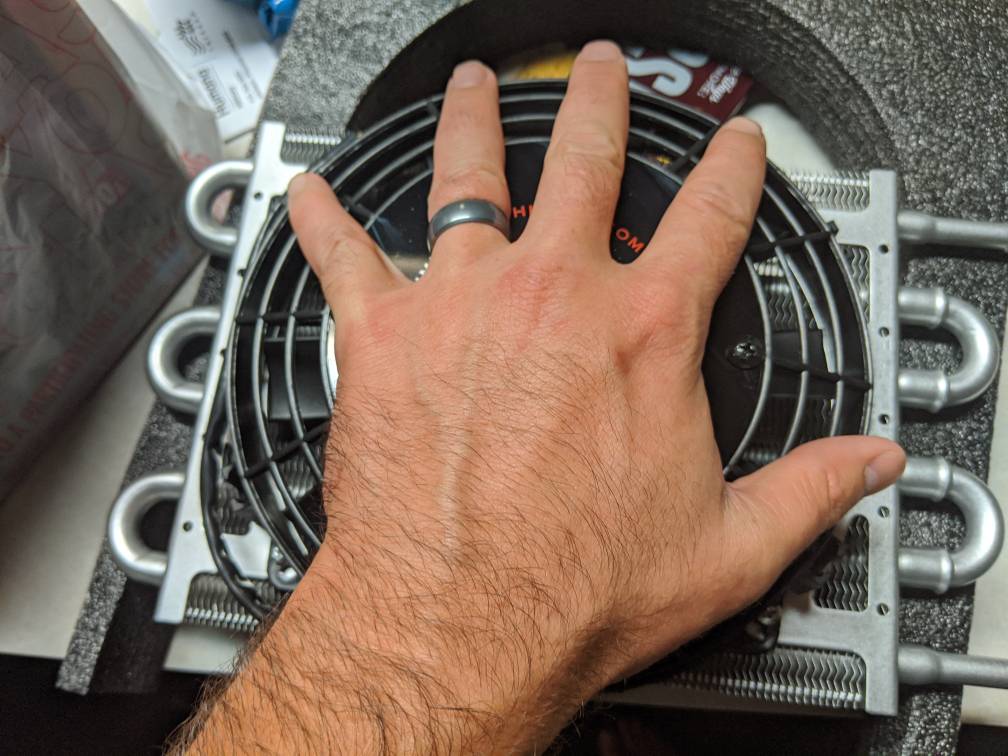

Well,
The cooler has arrived. It is smaller than I thought... View attachment 666159 MVIMG_20200813_204318.jpg
   / New PT-180 owner #138
It will make a good heater core when you build a cab.... ;)
   / New PT-180 owner
#139
But I live in FL and definitely don't need a cab for the two days we get in the 40's, LOL. I'm gonna slap it on and since the fan is only 4 amp and its 7 inches wide I should be able to fit a second one on there.
