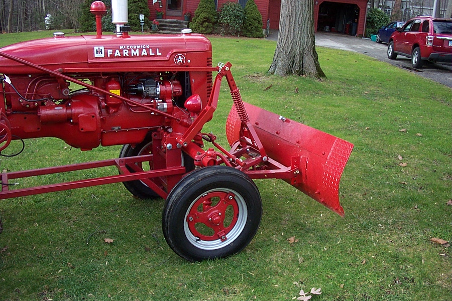

A great time of year for another snowplow ! :) I adapted an old 54" Cub plow to my Super A by extending each side of the plow out an additional 7" for a total of 68" I believe along with raising the height for additional capacity ! That may be an option for you !
In any event good luck, and I will be following along !

Scott, great pic, thanks!!
Yeah, I thought about adding a few inches to each side, didn't really want to go much beyond 60". I think at this point, I'm going to get the thing adapted so it will work, then, I can always look into adding a couple of extensions. I do like yours, they look as strong or stronger than the original blade.
