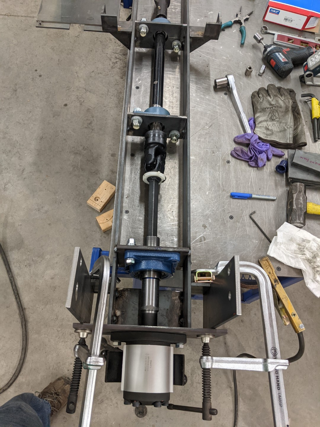

I got it apart and had a good look at it. The splines on the coupler are totally sheared off clean. You can see them down farther inside the coupler but they should be out to the end all the way:
I have read all the comments, and thank you for the suggestions and compliments on the work. I made it this way so there would be no loose parts. The pump does slide right into the coupler as I carefully aligned it during final assembly but it is certainly possible to be off a fraction of a degree (actually likely in reality) and that may contribute to it. I am also thinking shock loading may be an issue.

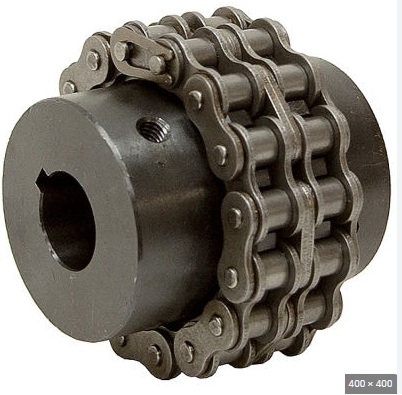

There is not enough room for another Universal joint and I don't think that is the solution. A few of you mentioned a Lovejoy coupling and I had been thinking along those lines too. Unfortunately that leads to loose pieces that I could lose but it is all secured in place at the end so there is no longitudinal movement within the shaft that should cause the spider to fall out, so I think that is the way to go to deal with any slight misalignment and shock loading. Now I need to find one rated high enough that fits. I have 4.5" to the front of the bearing (the blue line), and a ~40-45ish hp PTO rating:
The pump shaft is a bit beaten up but should be fine. And no I won't weld on the pump shaft at all. I have found lovejoys with the same 13 tooth 7/8" spline, so I just need to find a 1.75" dia keyed half for the shaft or modify the shaft end, which may be very tricky to pull off.
A couple mentioned grease and I had put some grease into the coupler but it was just regular bearing grease. I think I will get some of the Moly paste and use that in Version 2.
Here is what the pump shaft looks like.
The only nagging question I have is if something in the hydraulic loop jammed and caused this to shear or if it was just shock loading or the like that lead to it. If there is something in the hydraulics that caused this, the new coupling may last 0.1 sec... I guess I will find out...

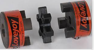

My lovejoy showed up today. It is BIG. See pic. I sized it up with the space and you can see how it is about 1/2" too long to fit in between the bearing collar and the front. So I need to shorten it, which I was expecting, shorten the old shaft that it goes onto (sticking through the bearing below it) and cut a matching keyway in that shaft. Plus I need to cut away much of that plate you see down below. Interesting tidbit is the stub of the coupler on the right fits very nicely into the opening for the pump, so I can use that to align it all pretty darn close with the pump shaft. Oh and I need to come up with 7/16" key stock for the keyway.

The spline has an interesting way to lock the splined shaft to the Lovejoy. You see thsoe goofy looking holes next to the spline there? The holes are basically relief so that the set screws on the outside of the coupling can squeeze down on the spline a bit to give it some friction.

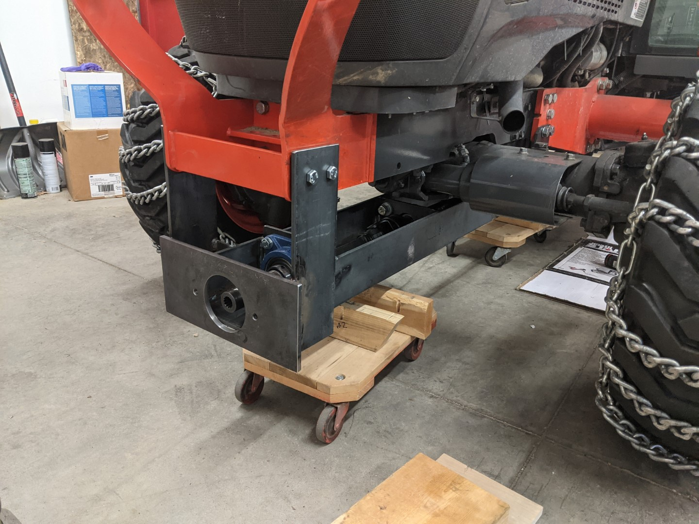

Back in business! Finally got the PTO subframe remounted yesterday and got the broom back on tonight and tried it out. It all lined up quite easily and I really didn't have to do any adjusting, which surprised me, but I'll take it. Seems to work fine again. After an hour of brooming off the ~1" of powder we got yesterday, I put my hand on the coupler and it was warm to the touch, but not hot. Some of that may be heat transfer from the pump/fluid too. Dunno. So here are a couple shots of the PTO coupling in place and the pump attached, and a short video from the cab of it throwing snow.
