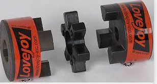

Another alternative to a u-joint could be to install an elastomeric coupling between the pump and the bearing. As long as your misalignment between those two shafts isn’t significant, a coupling with an elastomeric center could work.
The other advantage of a coupling is that it is very configurable. You find one hub that matches your pump spline and the other that fits your stub shaft coming through that last bearing and then the elastomer connects the two together.
Lovejoy or Rexnord would be two coupling manufacturers that you could investigate further if you are interested in that path.
/ New problem with broom - lost hydraulics #19

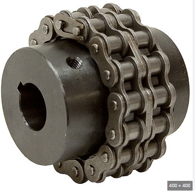

That's an even better alternative, or a chain coupling. I believe a Lovejoy is more forgiving tho:
