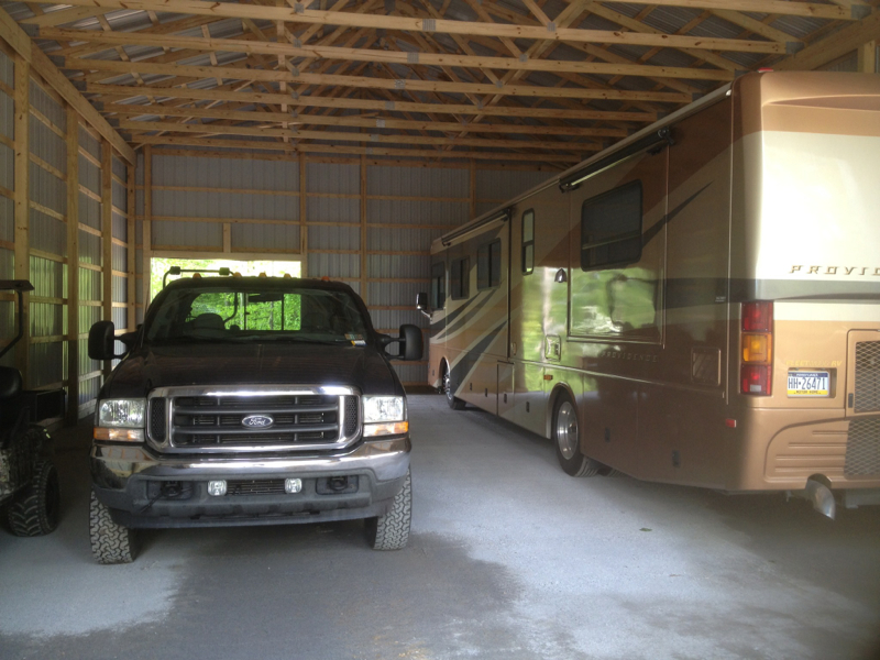

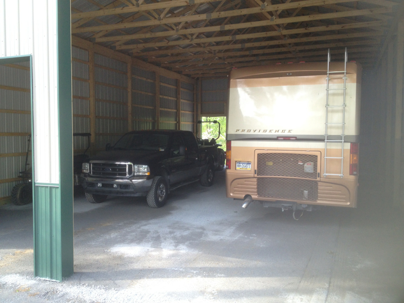

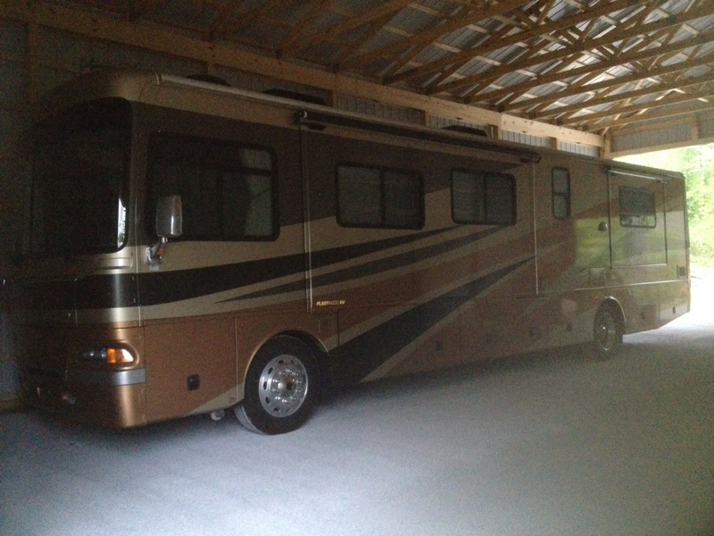

Well I finally was able to put a few toys in the new building. I had 30 tons of crusher run hauled in and spread level using a transit. Then I compacted it using a plate vibrator for a nice packed level floor. Eventually I will get concrete but this provides a nice flat floor in the meantime. Doors are next on the list.

I'll bet it is nice to be able to put such a fine motorhome in out of the elements. Looks great.
BTW What part of PA are you located in?
/ New Pole Building #18
Nice looking job on the laying & leveling of the CR & that will make one NICE base for the eventual concrete! Good to not have to RUSH to try and get some fill in and will give it some extra time to self compact so eventually the concrete will hardly move or crack when done in future. My barn took 10 years to get the concrete $ saved up in the mean time I wish had a floor in there that was half as good as one you now have. My concrete was done in Sept 11 and so far only cracks that showed up are at the very ends of the expansion joint cuts outside on the pad. This area had some last minute fill added & compacted but just the final bit from the cut area. the other area is at the Garage Door where the inside and outside pads meet. There are some rebar reinforcing in the area & the cracks are hairline inside around the closest post. none of which will ever effect anything, I did NOT cut the inside floor either as I didn't think it would be worth it. WHY CUT and have a 1/4" dirt trap when/if it cracks it should not move more than a hair. I used Remesh and fiber in the 6000psi x 5" thick slab. so far it is holding up great (one problem I did/so have) is I STAINED the inside concrete but the stain peels off with any heavy traffic or metal wheels on it. Rustolium Stain was on clearance and I know why it was junk...
M
/ New Pole Building #19
Really nice looking, actually that floor looks better than some concrete floors I've seen. Sure bet Mr.Motorhome is breathing a sigh of relief in its new accommodations
