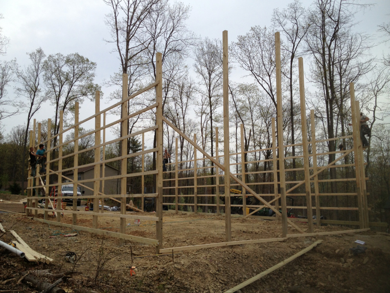

Well finally the day has arrived. I have been saving for 2 years for this day. They began construction today on my 32'x56'x16' eve height pole building. It will have a 14'x14 door for storage of my motorhome and two 10'x9' doors for the truck and tractor entrances. They are setting trusses tomarrow and starting the metal too, then supposed to be finishing on Friday. I will continue to post progress pics.

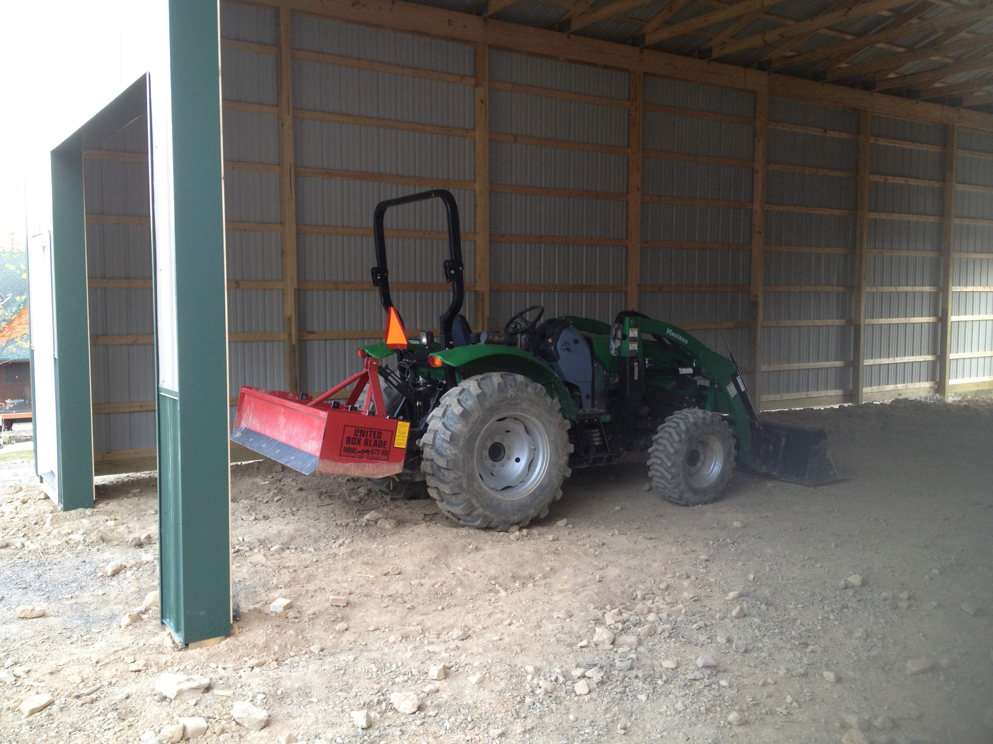

jmusser15,
Does your tractor have ROPS and will it clear the shop door when it is all the way up. Saw this happen and they have to drop the ROPS to clear the raised door!

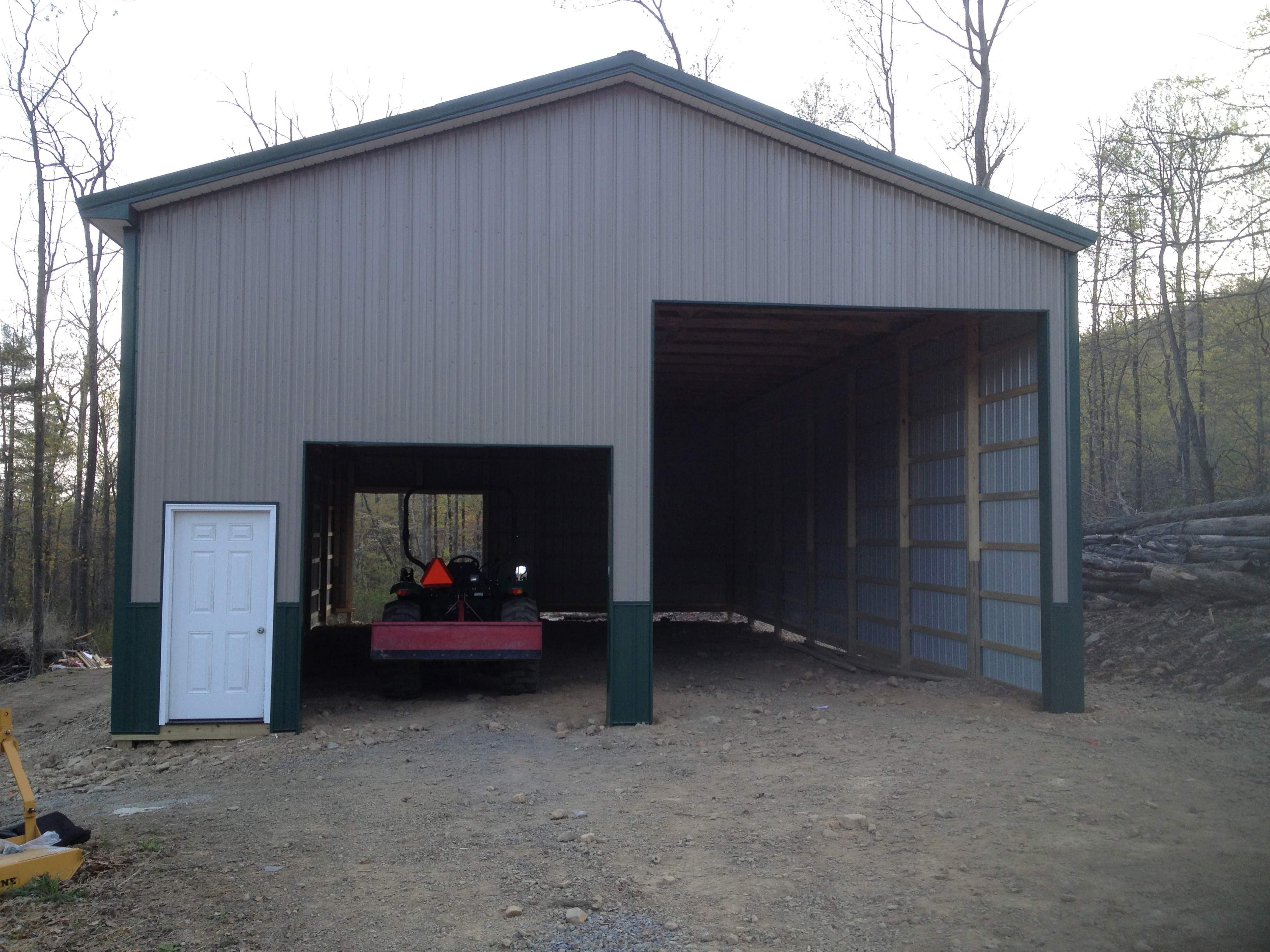

Congratulation on your new building!:cool2: Were are you located? I think 10x10 doors would be minimal size, unless there is a clearance issue. You need to think about future use's also.
10x9 is an odd size, 10x10 may be cheaper? :2cents:

Unless there is a tricky access to the large overhead door, paying the huge premium for a 14' wide door, rather than the more standard 12' wide is something I do not understand either. For the cost of 14', one might as well pay the few extra dollars and go with 16' wide, which at least would allow for two cars to enter side-by-side.

Actually 10'x9' and 10'x10' are usually pretty much exactly the same price. They use the very same tracks and hardware, the 9' tall doors just use four 21" panels, instead of four 24" panels.

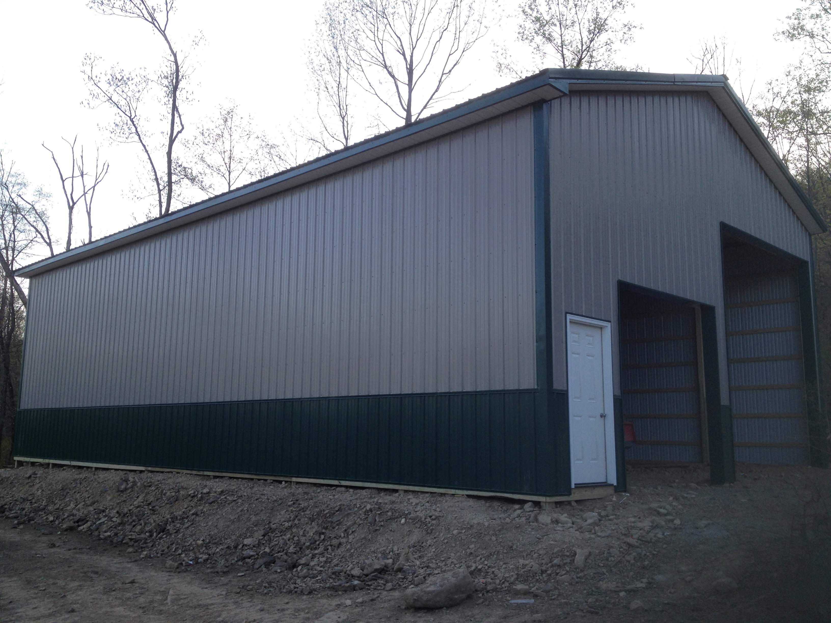

Well the building is complete. Now for the doors to be ordered and installed. I am happy with the colors and the contractor that built the building. I have to do a little grading and then put stone down and then I can start filling it with my toys. I will eventually concrete everything except where the motorhome is parked.

Good job on the building. How long did the building take? What was the cost? And, do you have a link on those beams? I haven't seen them used before. I need a hay building, and as most farmers, I'd like to spend as little as possible on it.
/ New Pole Building
#14
The building took them 3 long days. I had the site prep done when they arrived and started. The total cost of the building constructed was $16,370. The posts are spaced at 8'-0" on center and drilled to a depth of 36" and set on 8"x18" diameter concrete. They are (3) 2x6 Glue Laminated with the bottom portions treated for earth contact and that is why they are green on the bottom portion.

Well I finally was able to put a few toys in the new building. I had 30 tons of crusher run hauled in and spread level using a transit. Then I compacted it using a plate vibrator for a nice packed level floor. Eventually I will get concrete but this provides a nice flat floor in the meantime. Doors are next on the list.
