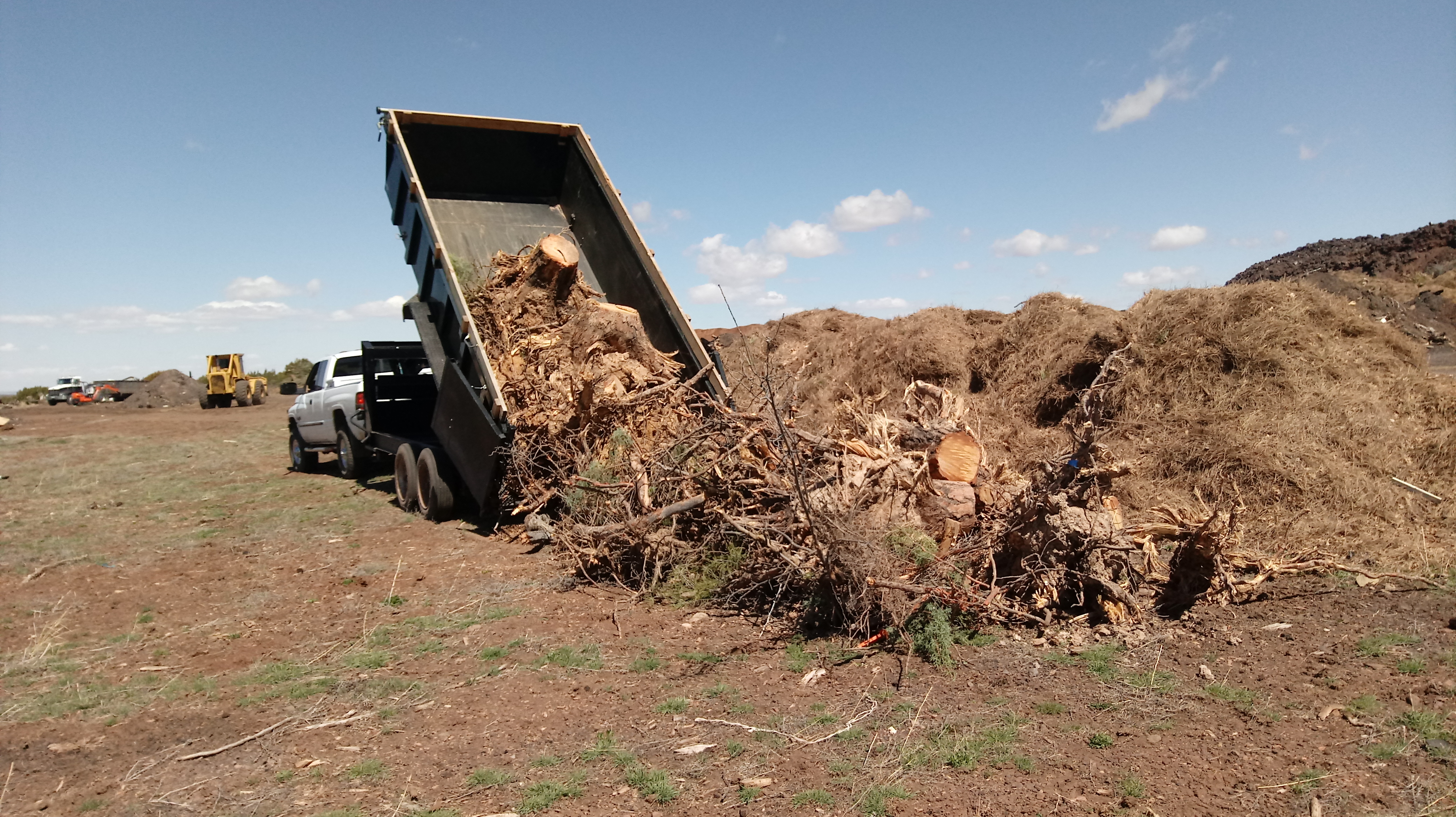

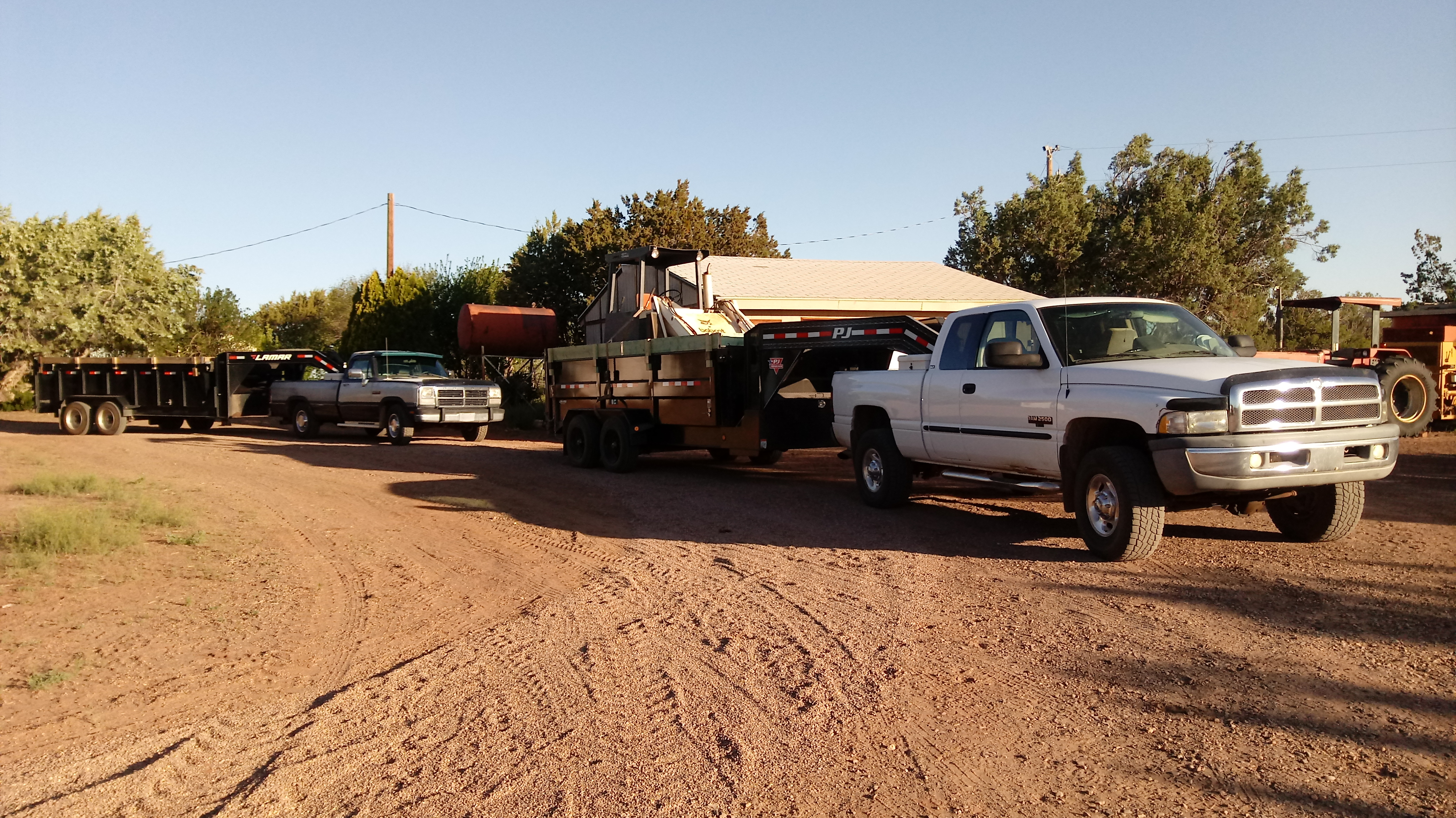

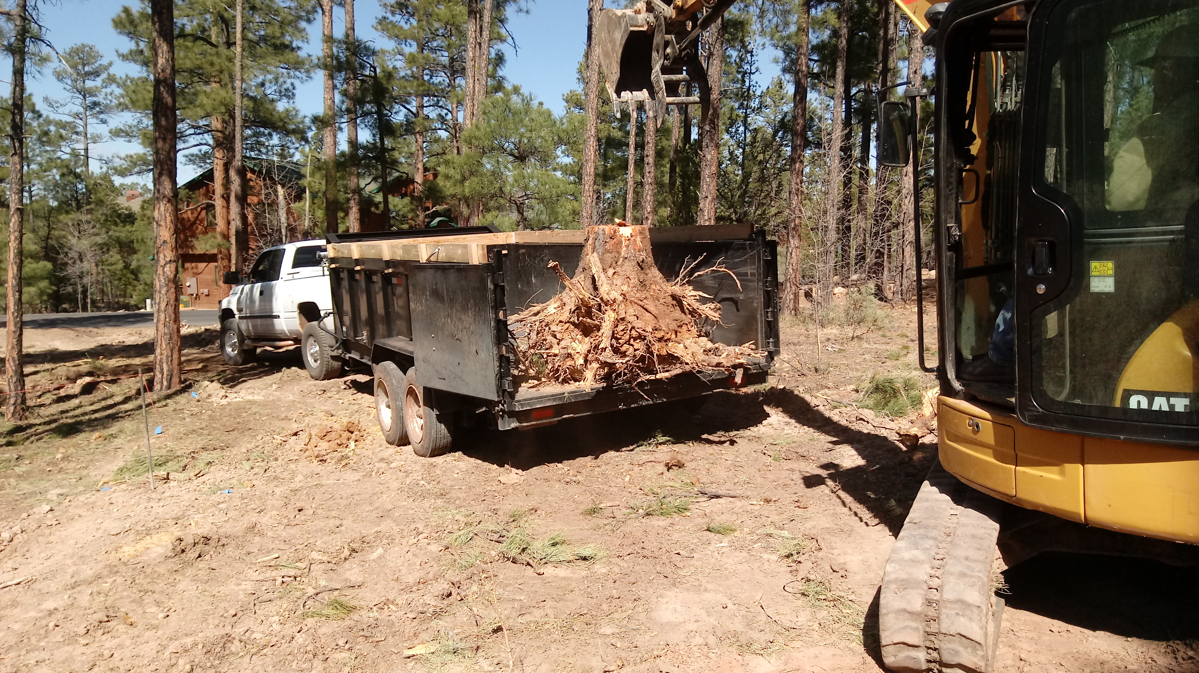

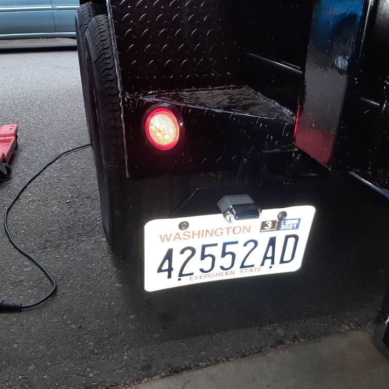

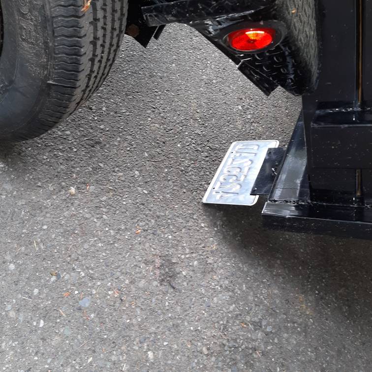

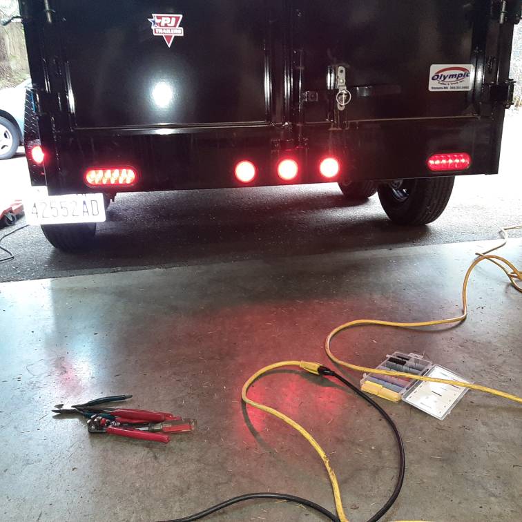

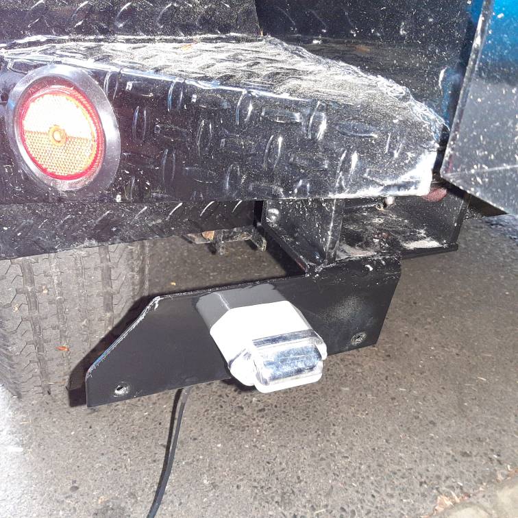

Getting busy so I put both trucks to work yesterday. I will need to check the Lamar, after 4 loads dumped, the batteries were weak. I have one or two bad ones or the charger is not working. Broke the license plate bracket off already on the PJ so I need to fix that, maybe like Rich said and just attach it to the tail gate. I think per Arizona it should have a light, but..... Deleted the door latch pins and made my own, the oem held the doors almost straight out from the bed sides. I get in tight locations with home deliveries so they had to go. Also installed 3 steps, mud flaps and two outside the bed tie downs.

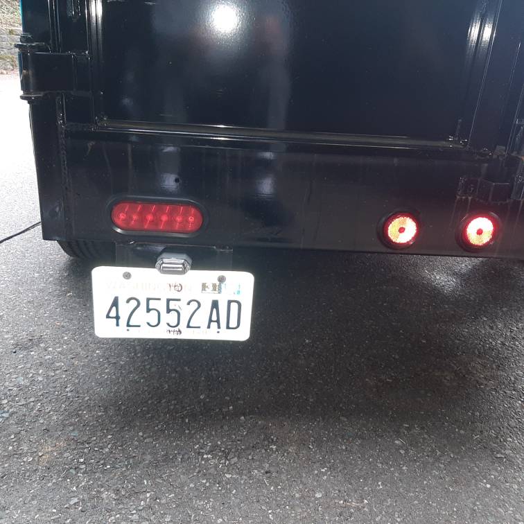

I thought about the door as well. But the light is required by federal law. I don't know about AZ but WA cops will stop you for that. Here it's improperly displayed plate and it's an expensive ticket. A lot of people have cars that they don't want a front plate. Including me. I don't have one on my Corvette. Some guys put them in the front windshield. They get tickets. But no front plate is a much cheaper ticket so they don't bother unless you have one in the windshield. On another note I hauled 2 loads of gravel with mine yesterday. 2 yards per load. It's a 7k trailer so that's about 1000 pounds too much. It was loaded to the front so the truck would take most of that extra so as not to overload the trailer axles. With 1000 extra pounds forward I thought it would not dump. I was planning to scoop some out with the tractor. But it dumped it with no problem at all. I think having cables between the truck batteries and the trailer battery may have helped. With the truck running it would give 14 volts to the pump. But it did it easy so I think it would have anyway. I am pretty impressed with the PJ trailer. It pulled nice with that large for it load. The place I normally go is following the stupid shutdown so I had to go a lot farther to get it.

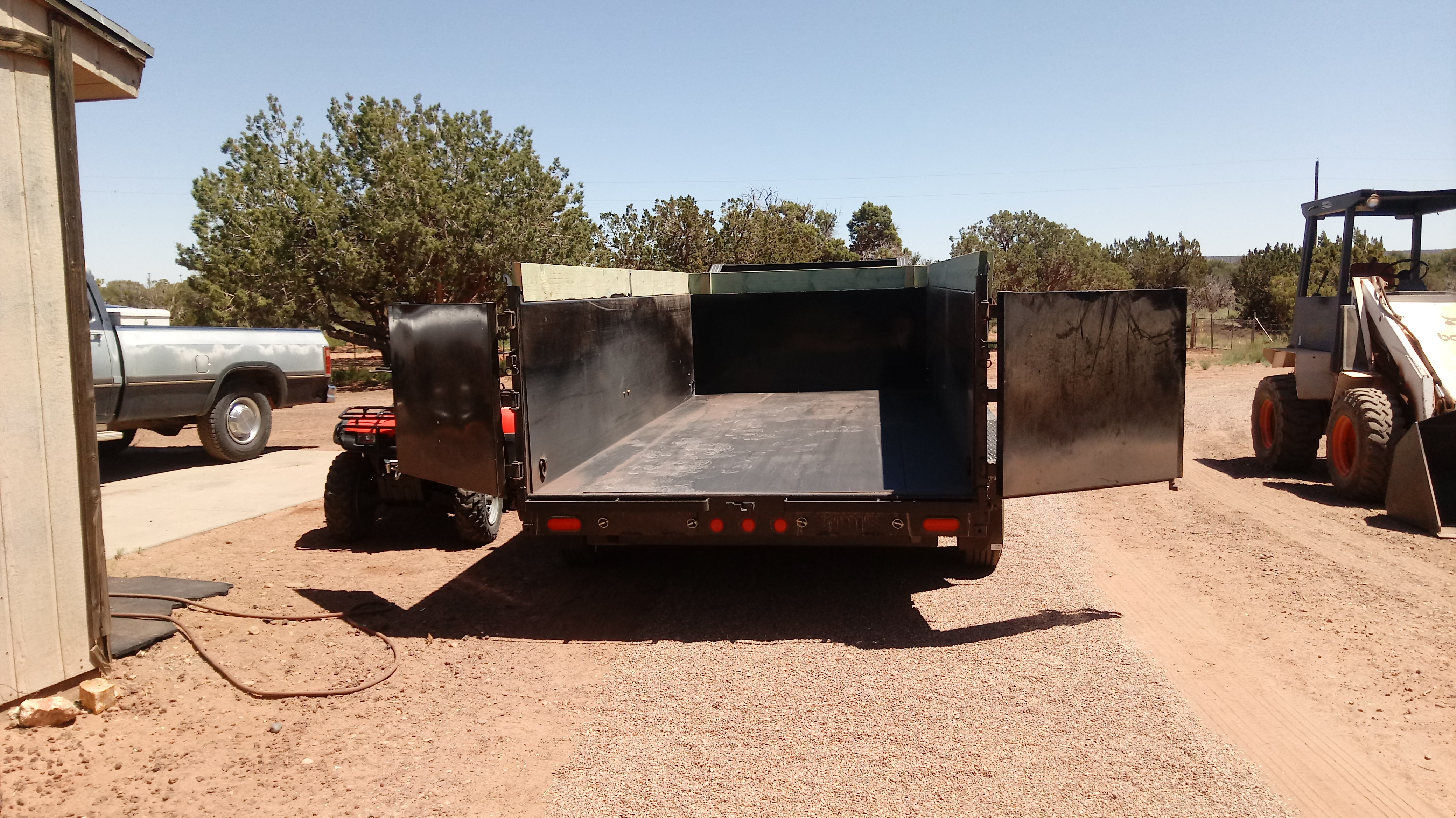

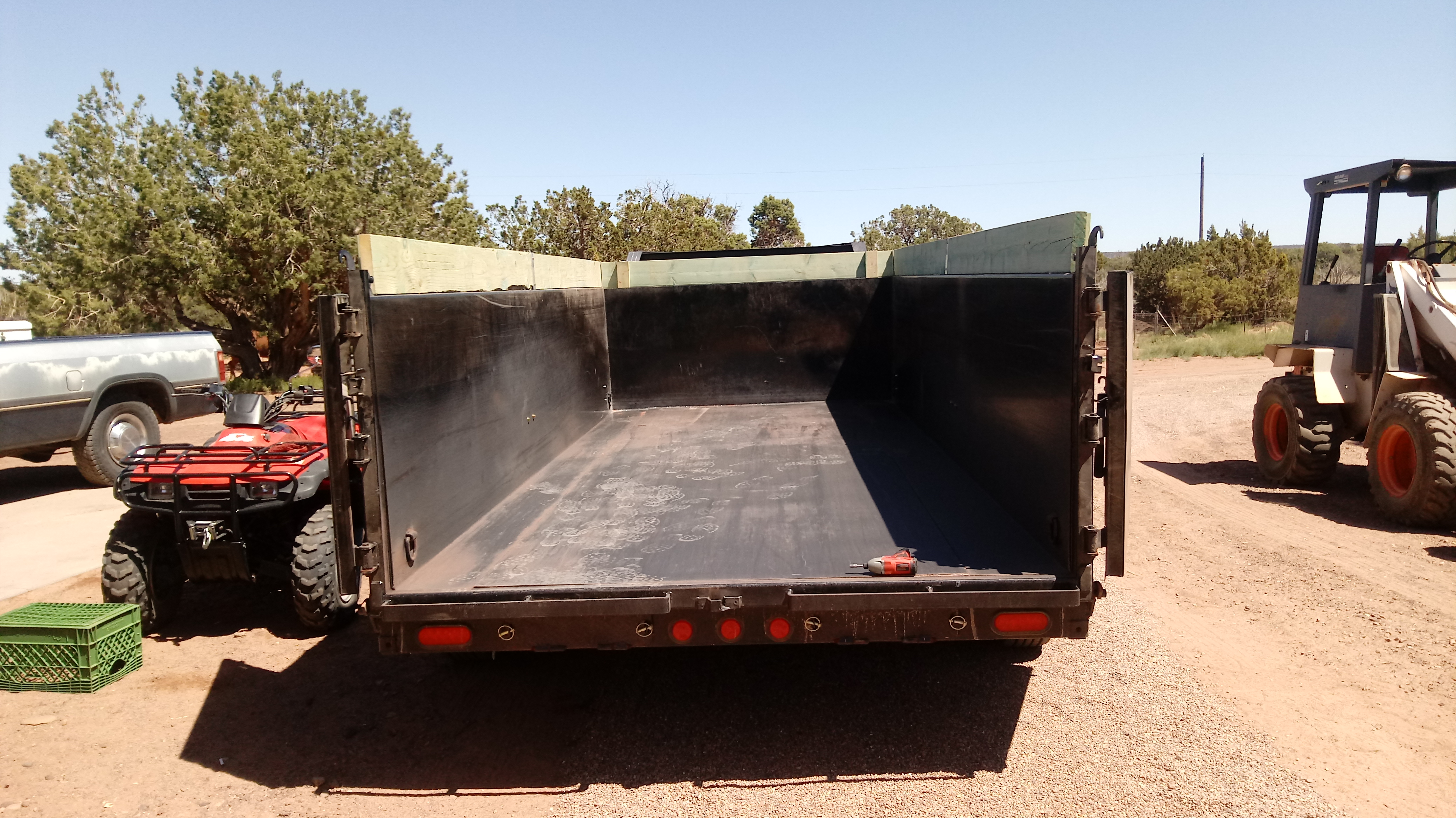

I don't use anything, but the first load is hard to watch:) I do load from the rear until I get a layer down, then dump in from the side. I would think you could line the bed with something, but keep in mind, you want a slick floor for most material so it don't stick. What I have found to be the hardest on the bed are logs with pig ears. If one of them gets dropped it will dimple a 10 gauge floor or sides. So far so good on my PJ with 7 gauge bed.
