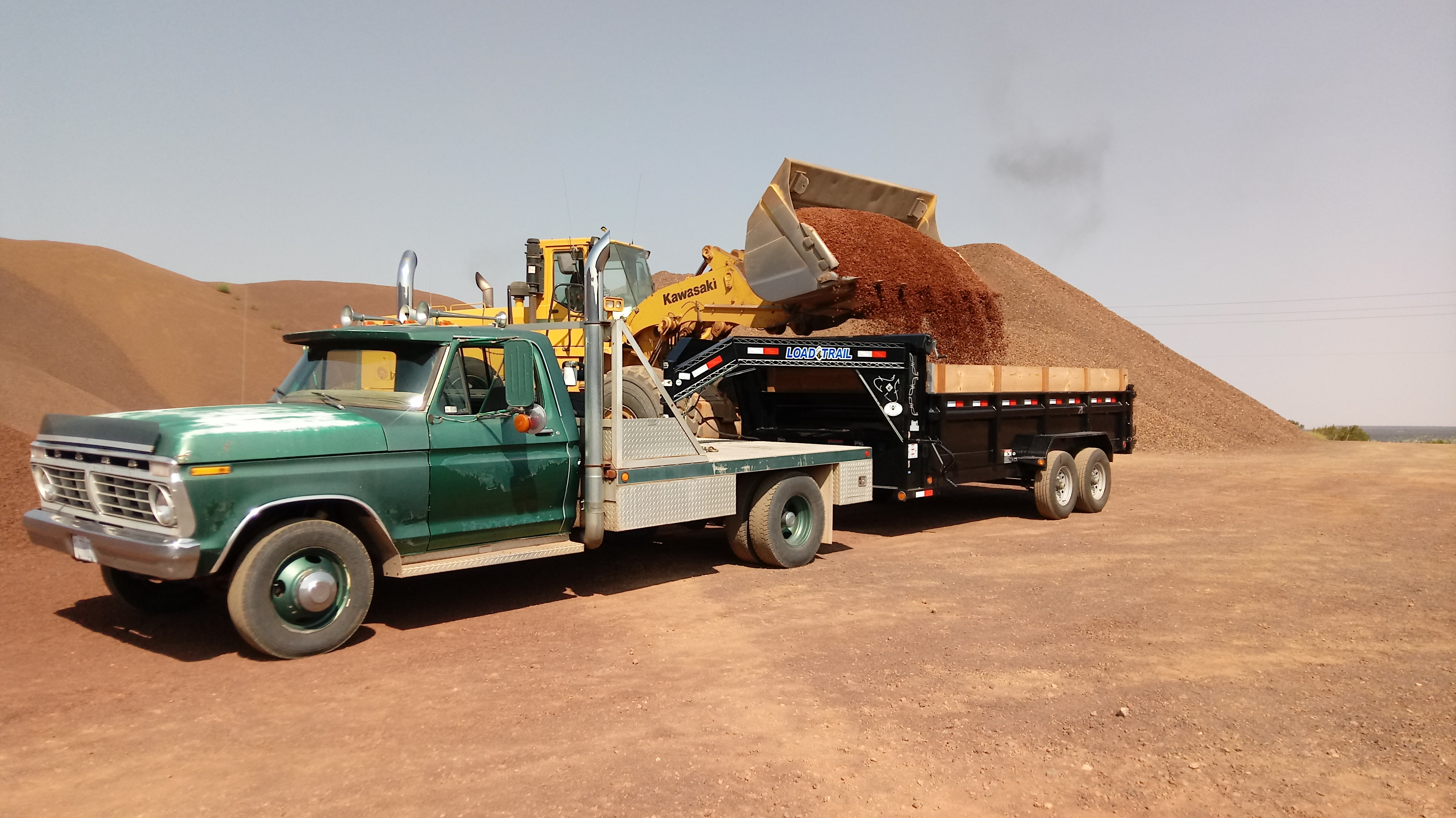

Picture of my haul trucks when I still had the Big Tex 14LX.

Your old ford is still one of the coolest builds ever!

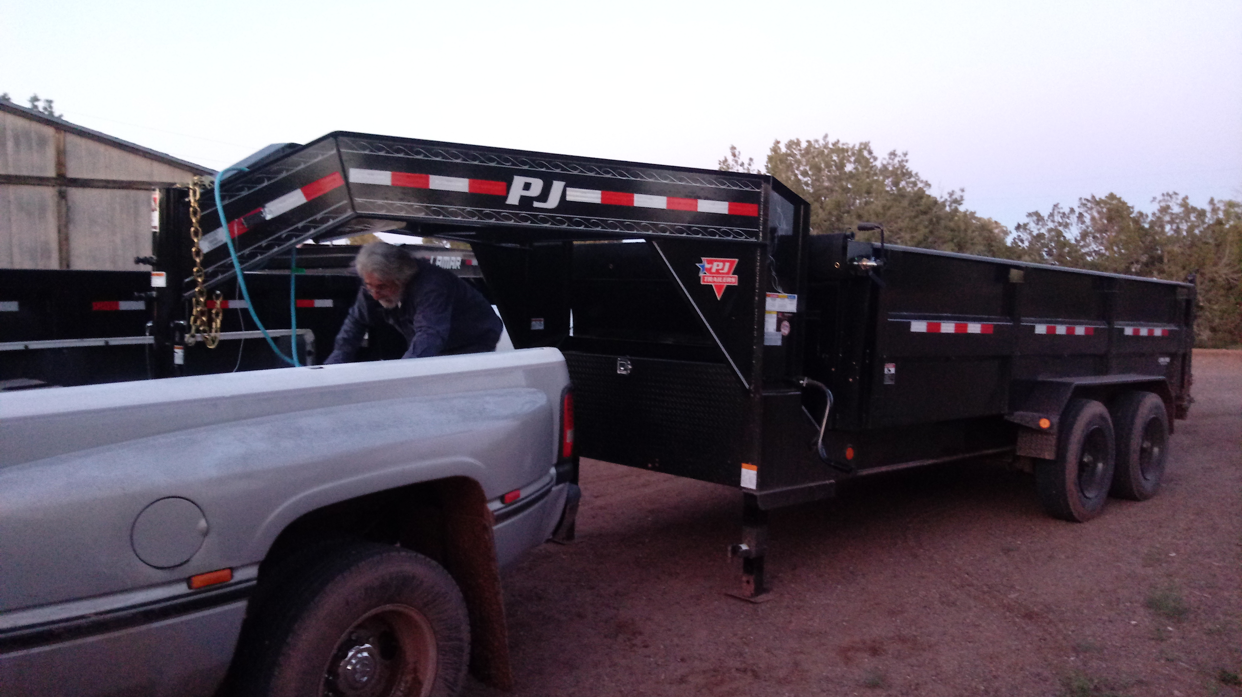

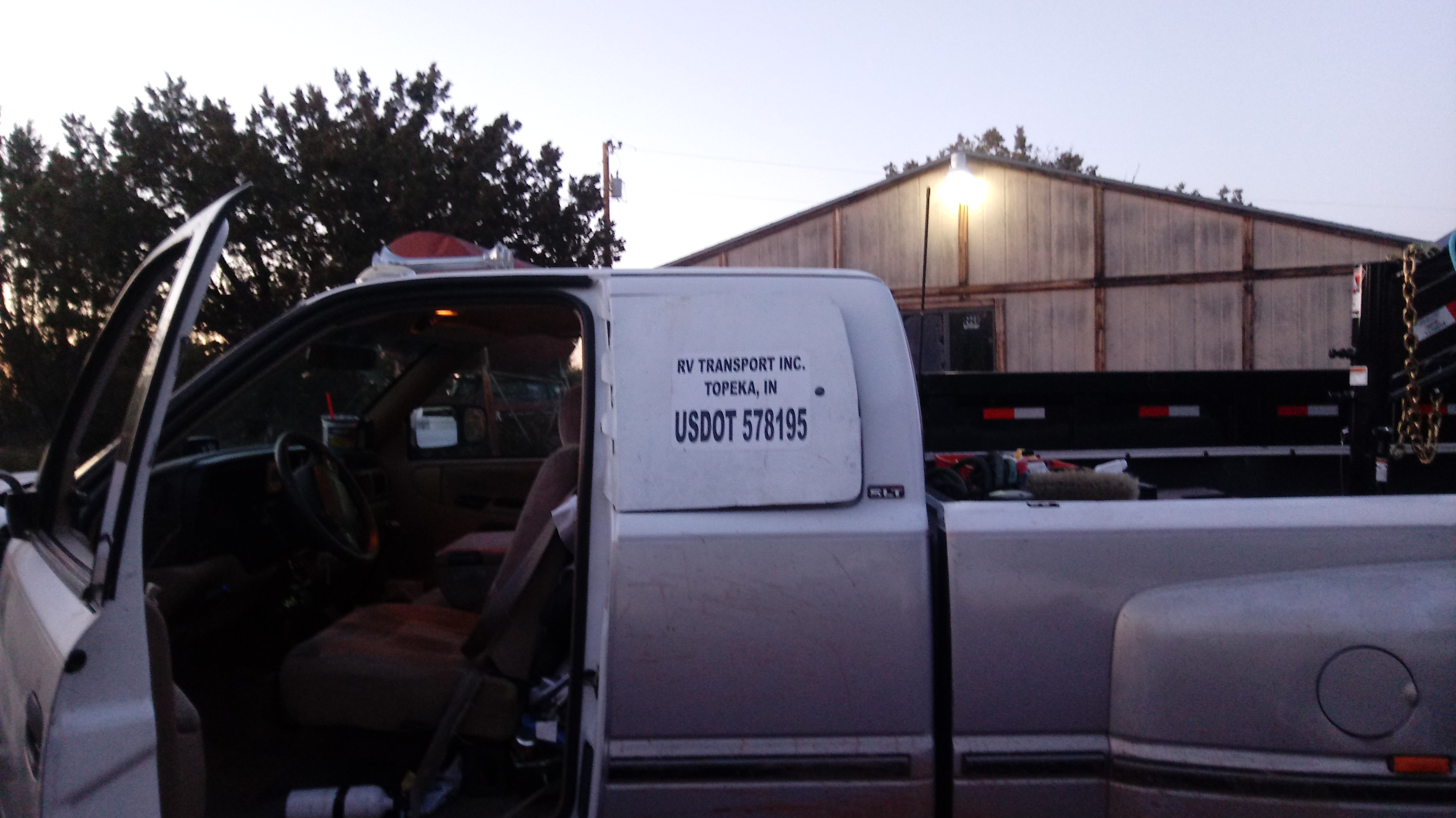

My new trailer showed up last night, I am already irritated at PJ and I haven't even looked at it yet :D The jacks (pro series, not bulldog) sound like a pig eating marbles and you can barely crank the handle. You can't tell me someone at the plant didn't feel/hear them. I hope it is just lacking grease because they are welded on. I will take more pictures in the day light.

The newer Jack's on semi trailers sound like that and are hard to turn compared to the older ones. The noise on them is the shaft between them in high range because it turns so fast it rattles. But they go up and down much faster in high than the older ones. I don't even notice it anymore on my new trailer at work.

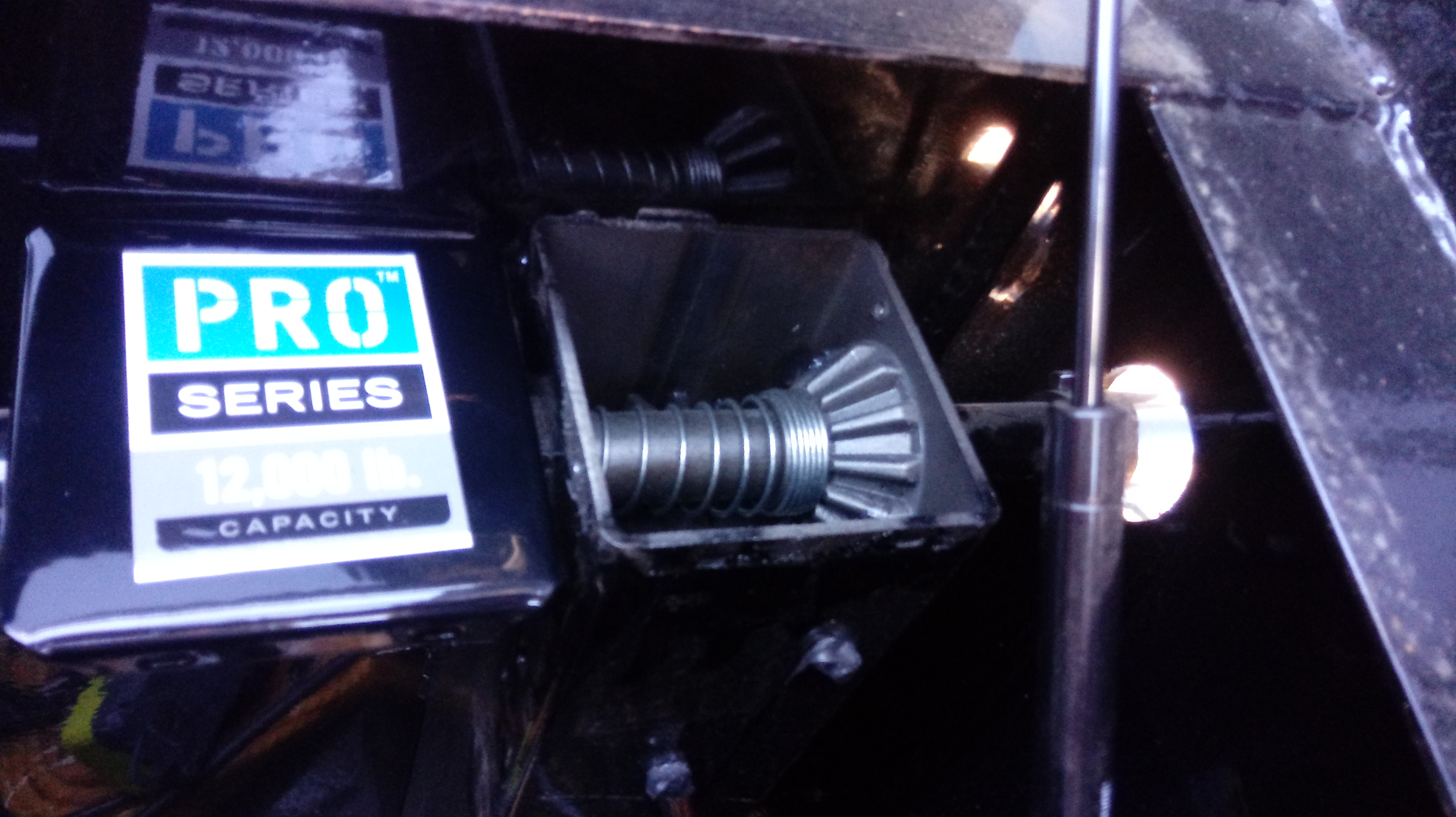

These are just the standard single speed 10-12k jacks. I pulled the top cover off and the gear set was completely void of any grease. I would say that was the jack manufactures oversight, not PJ. They did (PJ) pump a small dab with the zerk but that didn't even reach the gears. I packed them and all is well.
I did measure the hoist mount. It is 1.5' ahead of center while the Lamar is only 6", so this lift should lift a heavy load. They both use the 6" cylinder. The hydraulic tank only has about 2" of fluid....Grrr and they didn't de-rate the GVW like I asked. In all fairness, the plant is running on a skeleton crew...but still.
